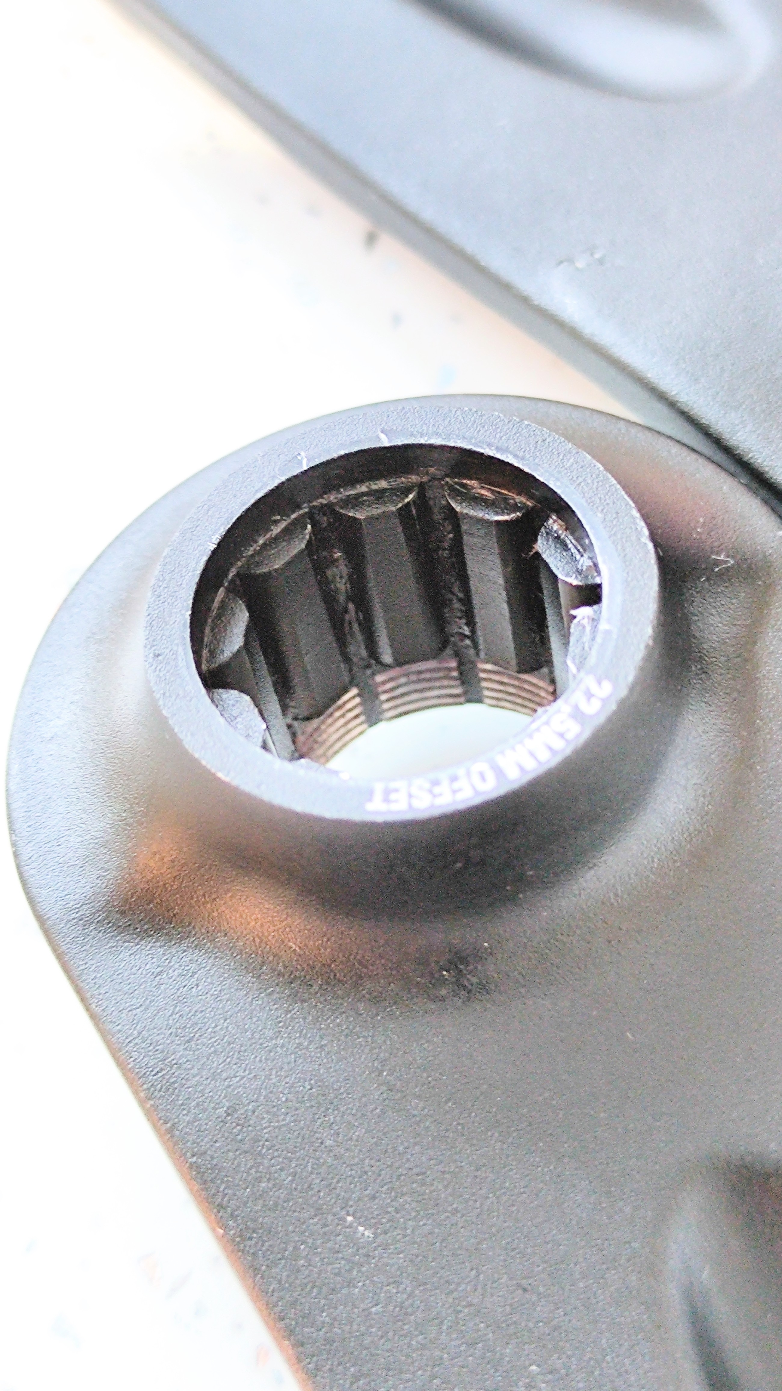

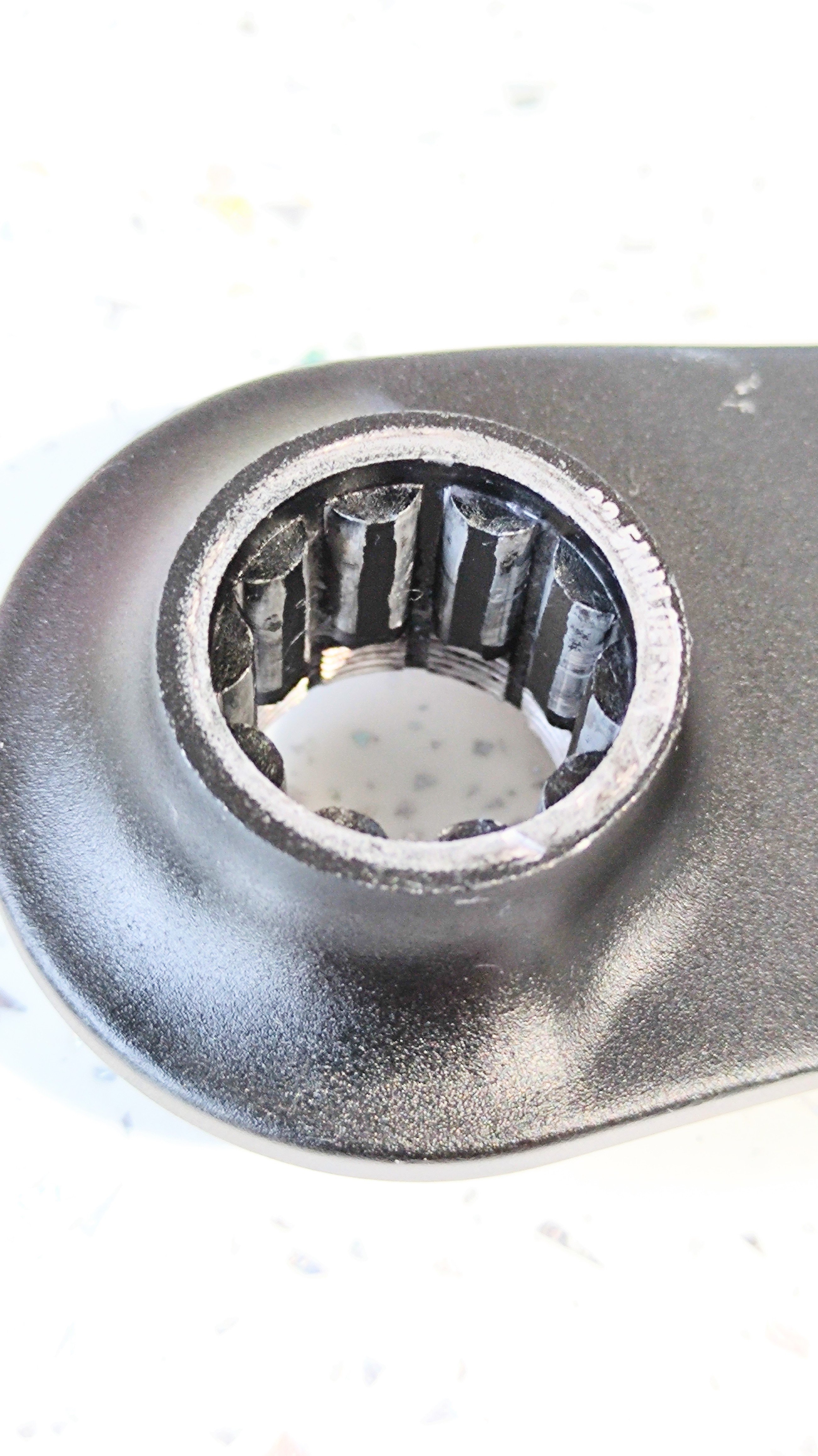

A visual check of the crank arm splines Will tell you if they are worn. They should all be uniform in shape and size, if you see any that are rounded at the sides or odd looking to the rest they are worn.
I'll see if I can dig out a picture of mine which might show it 👍
Hattori-Hanzo
Apr 10, 2023
437
584
These were the worn ones, you can see how rounded each spline is and out of shape they are.
These ones are in good condition, notice how the edges are sharp and they are all uniform in size.
Hope that helps 👍
These ones are in good condition, notice how the edges are sharp and they are all uniform in size. View attachment 147745
Hope that helps 👍
Massive help buddy, thanks, I really appreciate you sending these pictures, I’m not so good today but I will have a look when I’m up to it 🙏🙏
