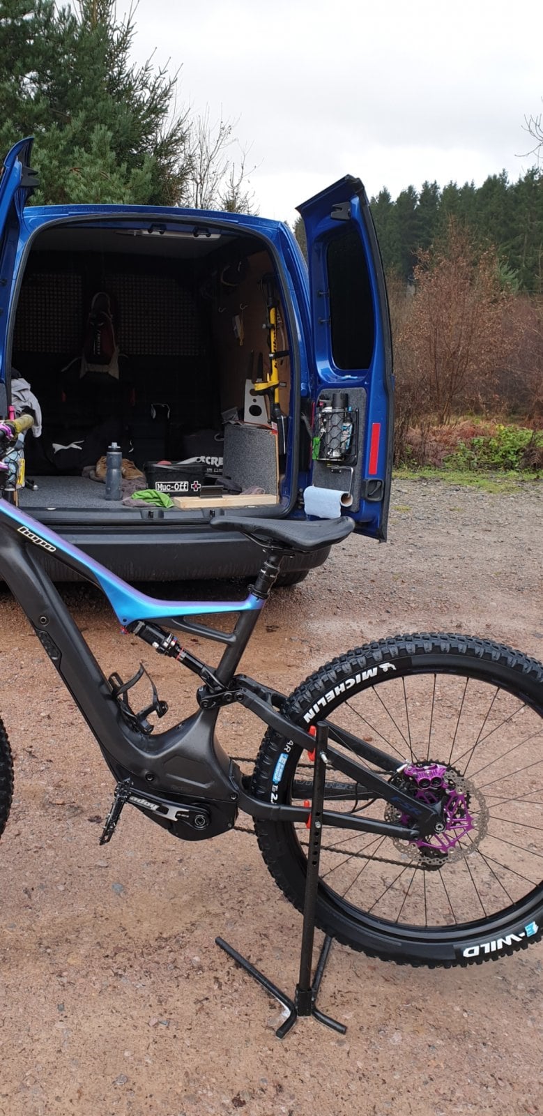

Maybe teaching grandma to suck eggs? regardless ......Re lifting the bike onto a bike stand or into the back of a van/car it is worth experimenting on your specific bike which are the best points on the frame to use....the key thing being, the lower the better/easier and achieving a balance.
Typically the seat stay at the back of the bike and a point under the down tube level with that, gives you not only the best leverage but also enables the bike to be lifted to a reasonable height. If you are using the seat post/dropper post as the attachment point on a bike stand, the easiest method is to first lift the front wheel onto a box or chair so you can then just lift the rear of the bike to the bike stand clamp, leaving one hand free to secure the clamp...obviously the box or chair can then be removed. If you are clamping to the top tube then you only need to hook the top tube into an open clamp and tighten afterwards. Personally I dislike both methods for an EMTB and use a bike stand that clamps the front fork axle. I can put both my bikes on this stand single handed with no problems.
