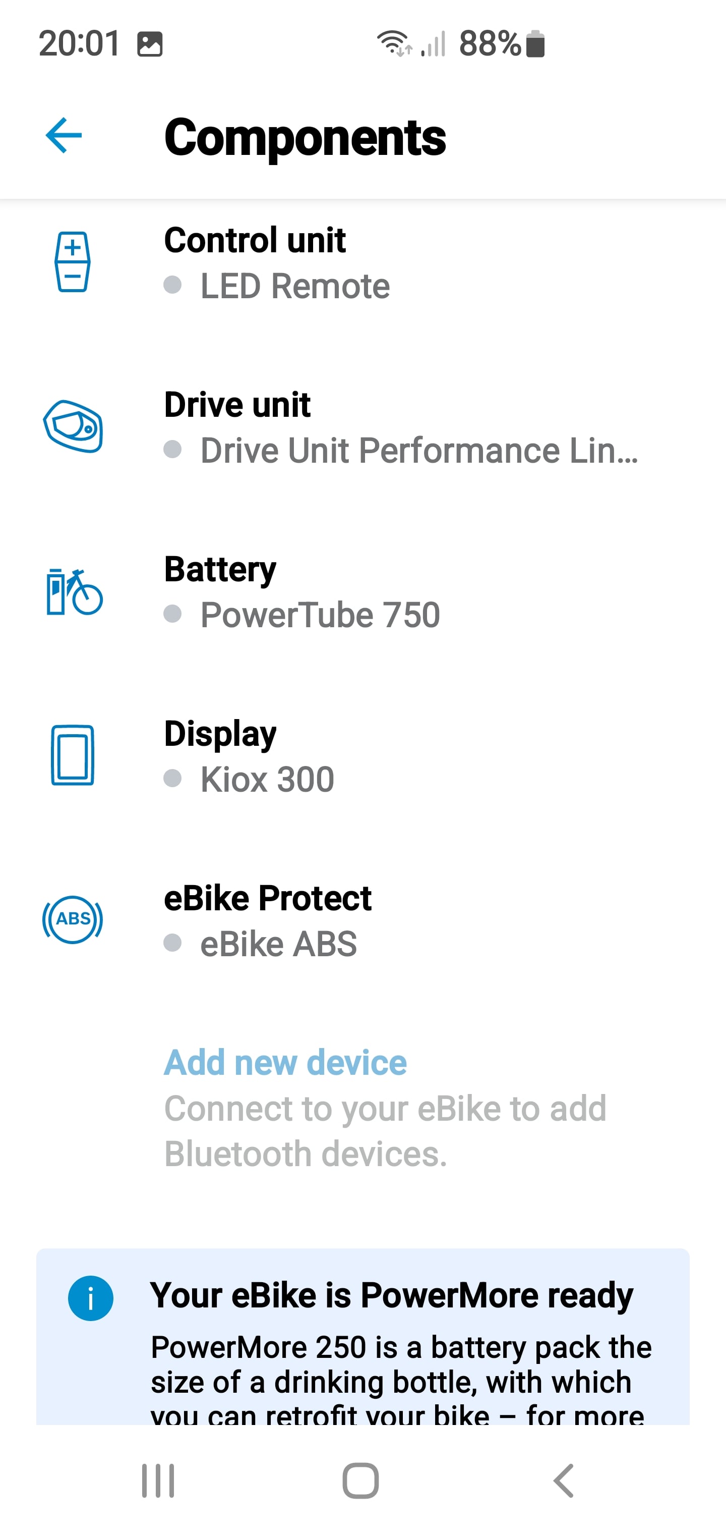

For the smart system you will need to connect the hr monitor through the Flow app to your bike. You will have to be next to your bike, the bike turned on, Flow app on the smartphone open and connected to the bike. In Flow app go to „Settings > My eBike > eBike Pass > Components > Add new device > Other“. After the initial pairing the hr monitor will automatically connect to your bike. To actually show the heart rate on your Kiox 300 you need to add a heart rate screen to the display configuration which is also done through the Flow app.

I have gone through that with the Halfords HRT10 chest strap transmitter but it didn't recognise it.
This will be me being useless with technology.
