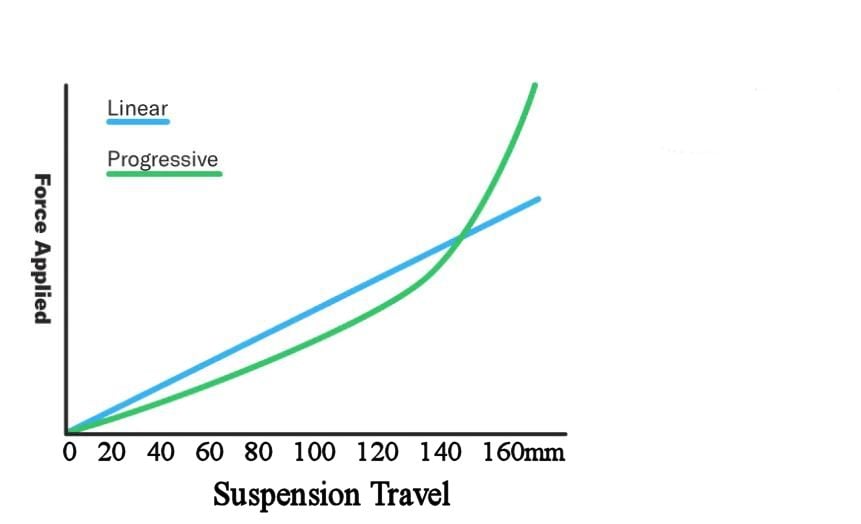

You will often hear YouTubers and other bike reviewers describe a bike's suspension as "Linear" or "Progressive." These two terms are used to describe how a suspension component's air spring reacts to compressive forces.
When we describe an air spring rate, we are referring to the force required to compress the fork or shock. In a perfect world, when a fork or shock compresses, the force required to compress the component is the same from initial compression to full bottom out compression. This rate of compression is what's known as "Linear" i.e. straight compression through the component's stroke. Most mountain bike suspension components will have what's known as a Progressive air spring rate of compression. A "Progressive" rate means that the force required to compress the suspension component increases in a curve at "Mid" and "End" stroke.
The air spring ramp up rate on your mountain bike suspension can be custom tuned by you to make your suspension more Linear or Progressive. Why would you want to change your air spring's rate of compression? In some situations a rider may prefer to have their fork or shock ramp up more quickly at mid and end stroke. As an example, if a rider is hitting big jumps and compressing his or her suspension to the point of bottoming out, then the rider would benefit from a firmer mid and end stroke to avoid suspension bottom out. On the other hand, if a rider predominantly rides smooth or less aggressive trails, then that rider would benefit from a more linear rate of air spring compression as this would offer a more plush, less firm ride at mid and end stroke. Every rider should tune the air spring ramp up rate on their suspension to what suits the area they ride and riding style.

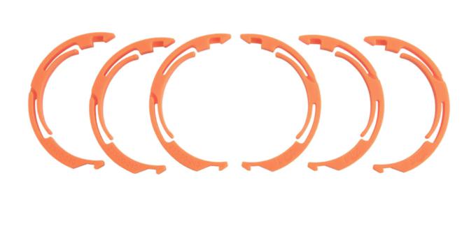

To tune the air spring ramp up rate of your Fork and or Shock, Fox utilizes air volume spacers. Rockshox uses the term "Tokens." The purpose of the air volume spacers is to "Decrease" the interior volume in the air chamber on a fork or shock. Air volume spacers/tokens can be removed to increase interior volume in a fork or shock's air chamber. By adjusting the air chamber volume you can fine tune the air spring compression rate on your suspension.
Adding an air volume spacer, will affect the air spring "Ramp Up" rate on your suspension. Seen below in blue is a Linear rate of air spring progression. You can "Decrease" the air chamber volume in a suspension component by adding an air volume spacer to the air chamber. When you decrease air chamber volume, this causes the air in the chamber to compress quicker and you thus alter the air spring's ramp up rate at mid to end stroke. The air spring rate becomes progressive as seen in green. Note the ramp up rate of the green graph line at mid and end stroke. You can fine tune the ramp up rate by the amount of air volume spacers which you add or you "Remove" from the air chamber.
There are various reasons why you would want to add air volume spaces. Here are some typical reasons:

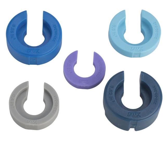

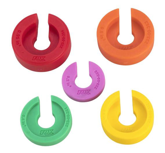

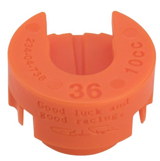

Fox 36 Air volume Spacer. The "10cc" refers to the amount of spatial volume lost in the positive air chamber when installed.
Fox Float DPS air volume spacers. The color signifies the amount of volume lost in the air chamber when installed. A volume chart is provided with the air volume spacer kit that identifies the size of the spacer. Instead of using CC's as a means of measurement, Fox utilizes thickness for shock air volume spacers, i.e. 0.2 inches, 0.4 inches, etc.
Fox Float X Air volume spacers (Note the difference in color as compared to the DPS spacers.)
Fox X2 Air Volume Spacers

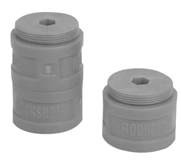

ZEB tokens. Rockshox uses the term "Tokens" when referring to fork air volume spacers

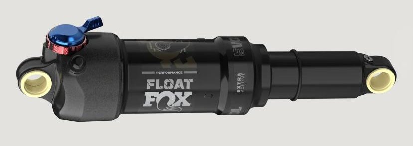

When looking at Float DPS you will find the shock has no piggyback reservoir which can store extra damper oil. Try touching your rear shock after a hammering downhill run. If your bike has a Fox Float DPS, you'll find the shock is very hot to the touch. Due to the lack of a piggyback reservoir, the Fox Float DPS has a limited amount of damper oil. While riding, the oil is in a constant state of motion as it flows back and forth through piston ports, past valving and shims. The harder you push the shock, the faster the oil flows and friction soon develops. Friction will cause the oil in the damper to get hot. Oil when exposed to high heat tends to loose viscosity, i.e. oil thickness. Reduced viscosity impacts the effectiveness of the damper to control compression and rebound. Don't get me wrong, if you are riding mellow trails, it's not an issue, the shock is brilliant. However, if you routinely take your Rise/Wild down chunky black trails, or you're a heavy rider and like to spank the bike, you may want to consider upgrading to a rear shock with a piggyback reservoir.
Fox Float, Performance Rear Shock. Note the lack of a piggyback reservoir.

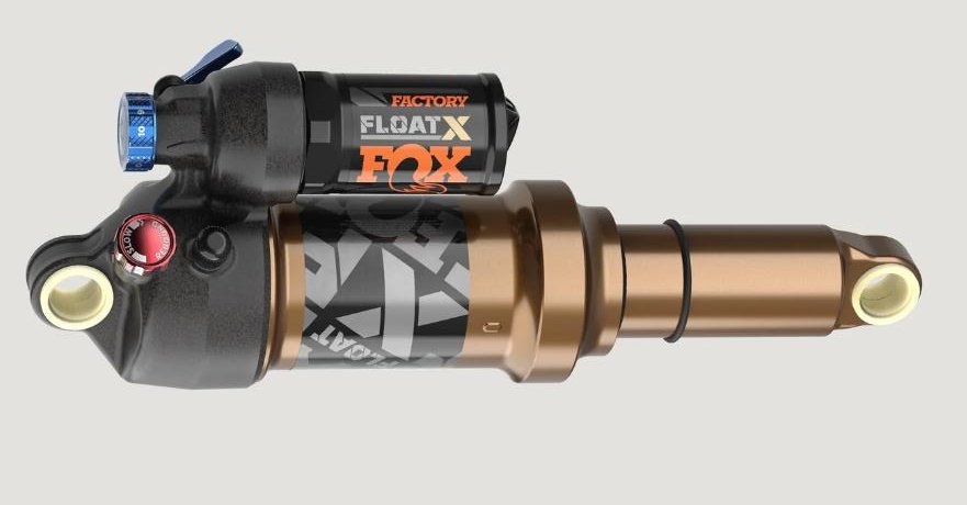

Fox Float X Factory with it's piggyback reservoir

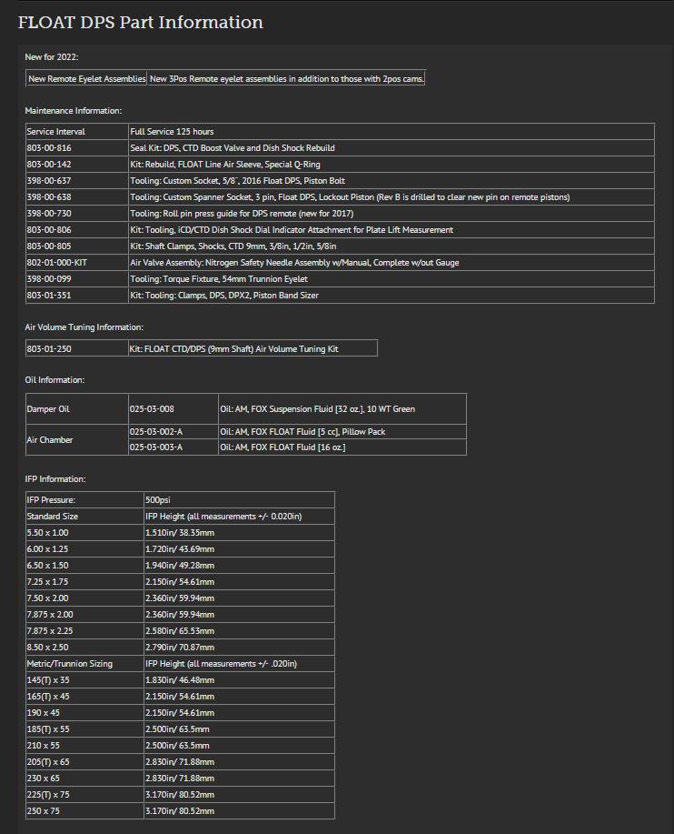

We discussed previously that "Air Shafts" can be replaced on a Fox fork to increase or decrease travel. Damper's on Fox forks can also be replaced. As an example, say you bought a budget generic Fox fork and wish to change the FIT GRIP damper to a GRIP 2 . This is an acceptable modification and easily done. However, you must purchase the correct part for your fork. Note that dampers on a shock can be modified also, but modifications to the valving or valve assembly requires special tools and knowledge.

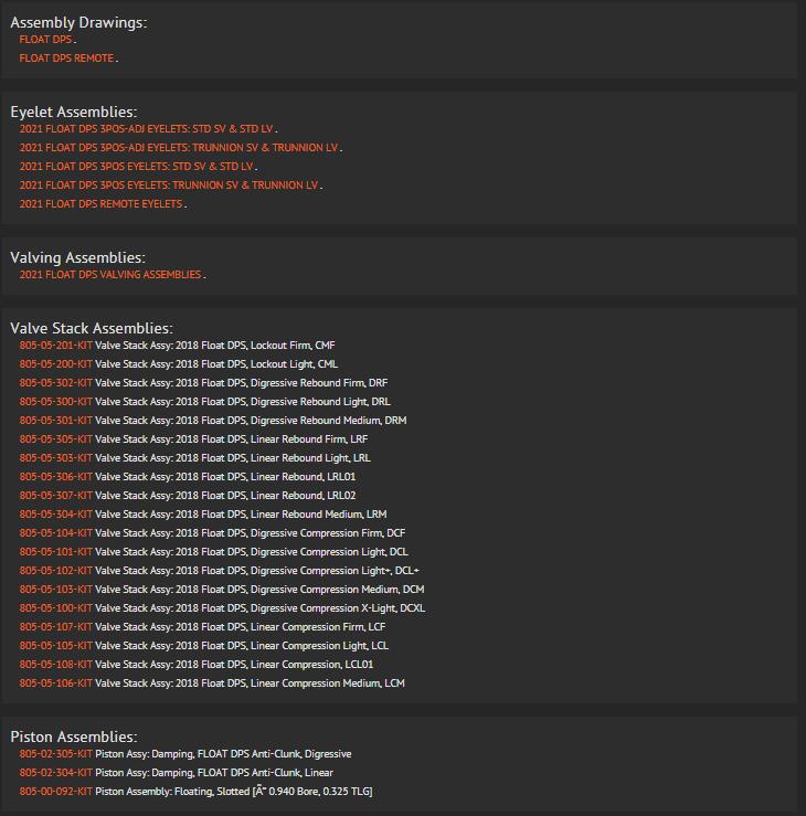

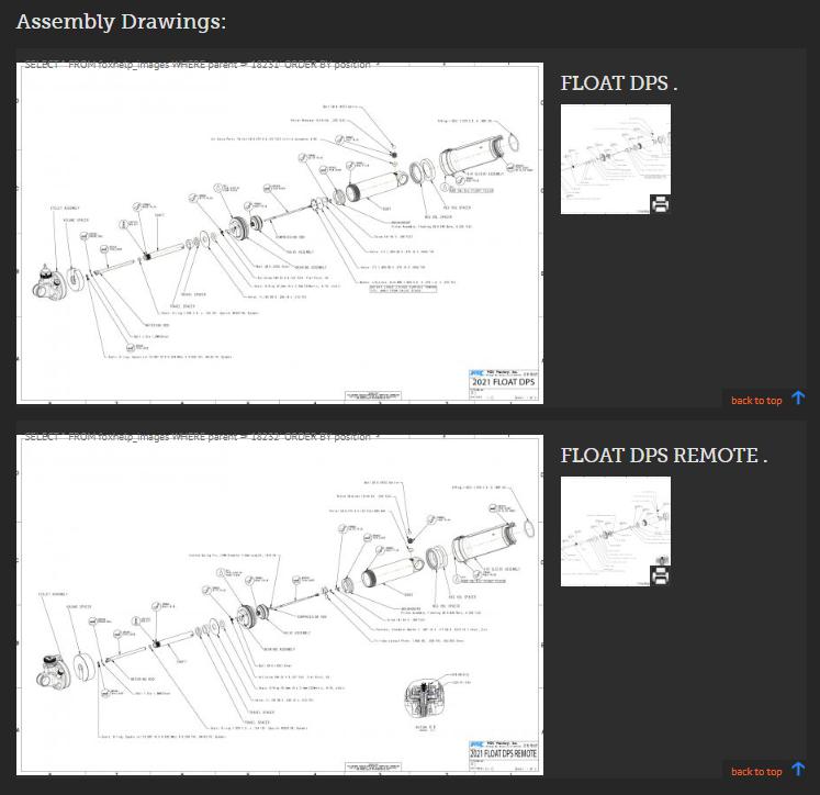

To determine which parts will fit your shock or fork, you will first need to run the fork or shocks component serial code on Fox's "Tech Help" page. After identifying your fork or shock's year of manufacture and model, you can find a parts list and diagrams detailing the correct parts and part numbers. From there you can go shopping online to purchase the parts.
Here's an example of a 2022 Fox Float DPS parts page on Fox's website:

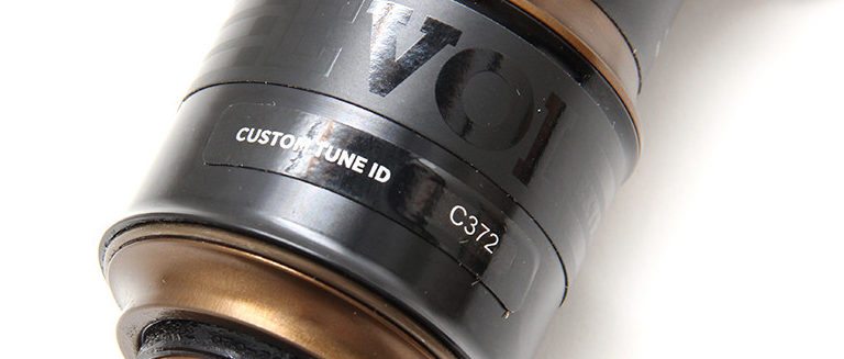

When Fox develops a shock or fork, they attempt to tune the fork or shock so that the damper works for a wide bell curve of riders. The bell curve is based on rider weight and how Fox wishes the generic shock or fork to perform on a wide range of bicycles. If you are a 95lb. rider, you may have difficulty setting the shock up and reaching correct sag. If you are a heavier rider, i.e. 260lbs., you may have problems setting the shock or fork up. Ideally, you want to be in the middle of the bell curve to get the best results from a generic fork or shock.
Manufactures often times will have Fox create a custom damper tune for a particular bike model. Manufacturers spend a lot of money on bicycle design and handling. They want the bicycle to perform to the best of it's abilities. Manufacturers will often ask Fox to perform a Custom Tune which the manufacturer specifies in order to enhance a bike's handling. You will often see a sticker on the side of a bike's shock proclaiming "Custom Tune."
Suppose you are at the outer fringe of the bell curve and you're having issues with setting the generic shock or fork up? Fortunately, there are numerous suspension specialists available who can custom tune a shock or fork's damper to work specifically for your weight and riding style. The suspension expert will typically meet with you in person or via phone. The tuning specialist will discuss with you in regards to how you ride and what specifically you are trying to achieve. As an example I met with a tuning specialist and explained that my ankle was toast and I needed a plush damper, but with a more progressive spring rate for my trips to Hurricane Utah. Once the expert has an idea of what you are trying to accomplish, he'll discuss shim stacks and tuning. When you both agree on a course of action the tuning work is performed. This usually takes on a few days if your tuner is local and works out of a bike shop. The results of a well tuned shock/damper are incredible.

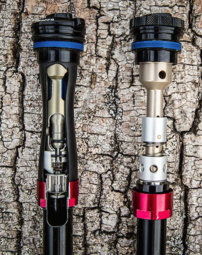

Pictured are several cut away examples of Rockshox damper assemblies

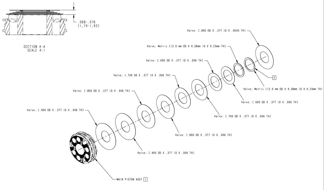

For this next exemplar, I am going to use a Fox Float X shock to show a shim stack series for the main piston. Fox offers numerous shim stacks for all internal areas of the Float X. The shims also known as valving, come in various thicknesses. It's the thickness of a shim/valve which determines the rate of oil flow.

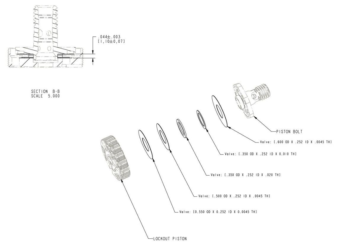

Depicted in the photo below is a Fox Float DPS shim stack/valve for the lock out piston.
