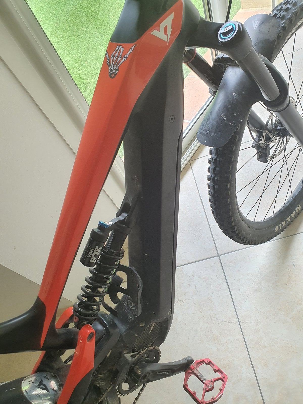

Hi, I weigh 229 lbs (without gear) and I have the Rockshox Deluxe @ 250-260 PSI (with gear), rebound 5-6 clicks from full fast depending on terrain and no volume spacers. Ride at 30% sag, dynamic I do not know. It functions well and happy with the performance. I used most of the shocks range during an alpine ride. Bigger drops (>0.5m) to flat and I am getting full travel. Mind you I am NOT a super aggressive rider, no large jumps, no DH races and so on. I usually do technical ups and down (slow). Not sure if it helps :)

Hello,
I am at 220 lbs with equipment, with the fox dpx2 I need 300lbs for 35 of sag.
fox dampers need more pressure than rockshox. currently I have a dhx2 with a 500lbs spring , it works much better I prefer the velo with a reel, I stay with an unmodified ultimate lyrik ( air) and I find the bike top

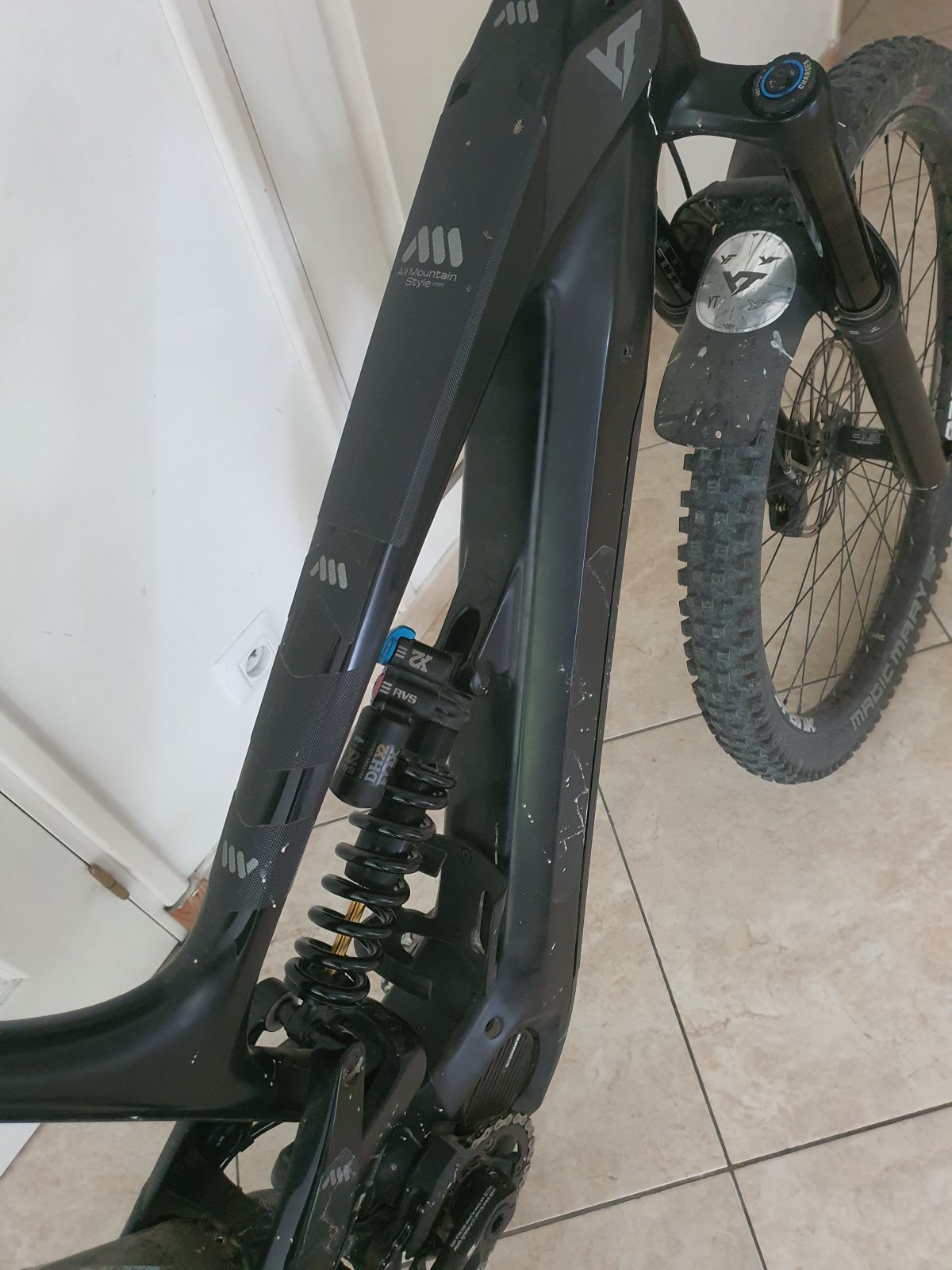

I have lost a little weight but still 270-280pounds
I spoke to Yt an fox before buying my decoy 19 mullet they both said yes the bike an suspension will be fine
My rear x2 is on 320-330 psi with 3 blue volume spacers an rides great for me. Silverfish/mojo suspension told me the shock is recommended up to 350psi but will take way way over that they get tested to something like 700psi

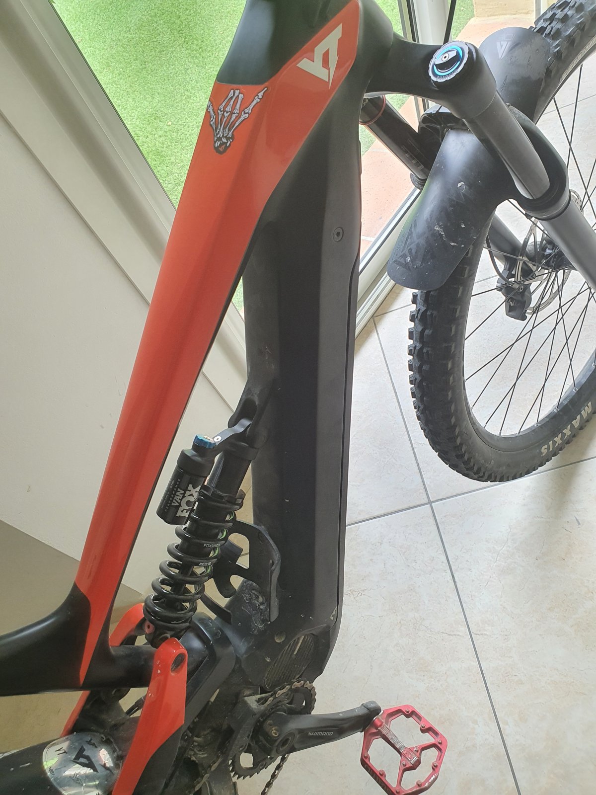

my 2nd is also mounted in spring with the ultimate lyrik my wife finds it better with the spring also

The coil damper is perfect for yt decoy better for low speed, mid-stroke support, or big jumps, but driving is less fun as the bike is always glued to the ground
But is better for comfort and performance

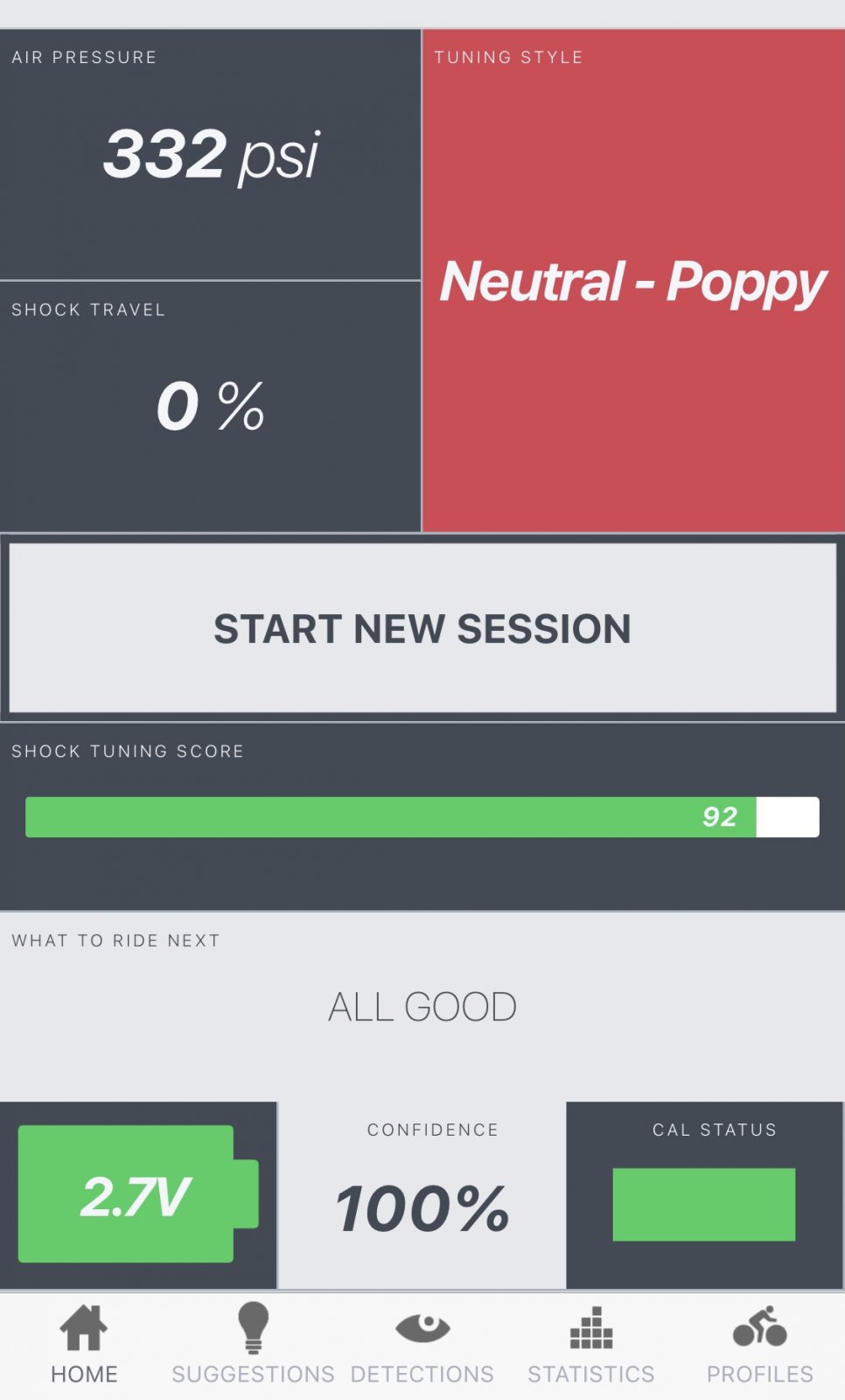

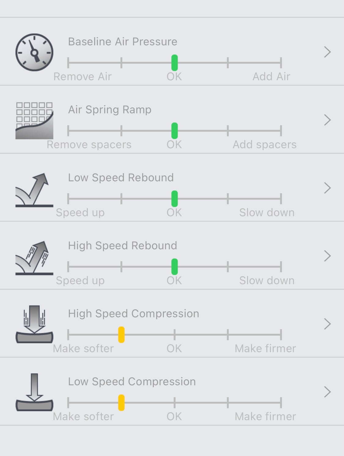

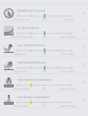

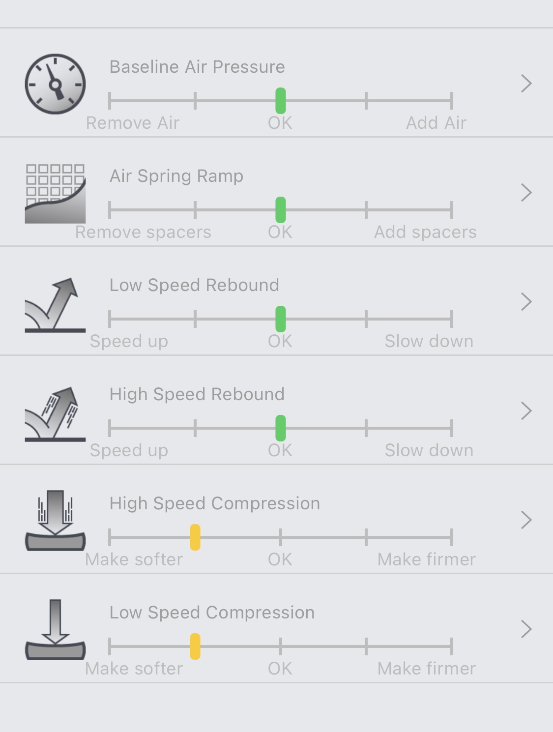

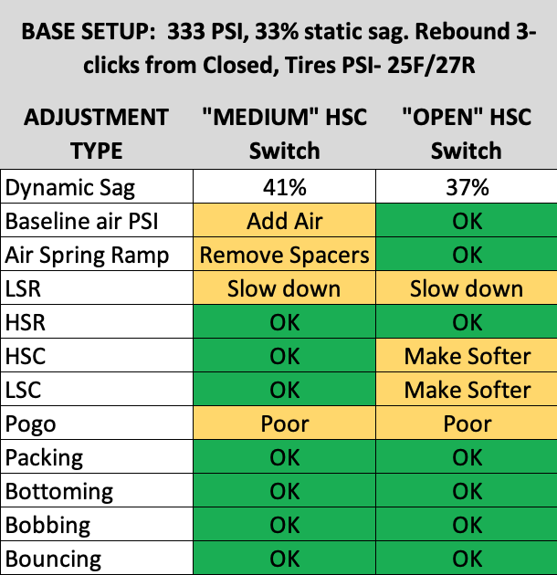

@HOMIE5000 - I originally rode the Decoy using ~ 270psi and would regularly go through full-travel with stock setup (no spacers).
I bought spacers and used the 2nd largest spacer (0.86 cu.in., largest recommended by Fox for 230x60mm) and 2 clicks from closed on Rebound Damping (per Fox's manual for my weight/PSI). I wasn't getting anywhere close to final 1/3 of shock travel with the dark blue spacer (largest recommended by Fox). Went down to the light blue 0.6 cu.in., but that's when my buddy loaned me his ShockWiz tuner and I realized my sag was more like 45-50% (Dynamic). Nowhere near 33% recommended. I opened up Rebound to 3-clicks from closed to get a bit more rebound speed, but it's on the cusp of being underdamped.
ShockWiz kept recommending:
1) Add air - went from 280 > 300 > 314 > 330 psi....finally Shockwiz said it was OK.
2) reduce vol. spacers - I'm currently down to the smallest 0.20in^3 Purple spacer
3) soften LSC and HSC - I always run the blue 3-way in "open". I've already opened up wide the LSC open-mode adjustment. But still, according to ShockWiz, it's not soft enough. This is due to stock valving which is inaccessible without rebuild.
I'm finding just the opposite about using volume spacers, they seem unnecessary with the proper 330psi and sag. I find I'm not bottoming out, even with the smallest spacer. I could probably go back to stock (no spacer) and not bottom out. Again, I think the Decoy leverage progression rules here. I was using spacers as a band-aid fix for incorrect sag and too-little PSI.
I'll try running harder tires and >25psi. That will reduce the undamped 'bounce' from the tire flex and put the forces up through the shock where it can be damped. Good suggestion to try. I personally felt like it made the rear very 'chattery' with higher pressures, but it's worth a revisit.
RE: Rebound damping. I'm just too heavy and 330psi too high to go below 3 clicks from closed. Rebound is easy to nail and very obvious when it's wrong. Fox's manual was spot-on here, maybe a little over damped. But I'm confident either 2 or 3 from closed is right (and makes ShockWiz happy as well). 1 from closed is a bit 'dead'. But I've got 2 usable clicks of adjustment for different terrain.

"ShockWiz kept recommending:"
What shock wiz is telling you is ,
!/ at 330psi your sag is right
2/ bottom out resistance is too firm reduce air volume spacer .
3/ the currant air volume spacer is dampening the LSC and HSC effecting small bump sensitivity and traction.
As you can see spacers effect bottom out resistance , spacers also add dampening to LSC HSC and rebound.
max psi is 350 for the shock , so I feel you should be able to get it right . Perceiver they are very good shocks
Are you blowing you feet off you'r pedals ?

#1) Why would you recommend raising HSC damping when ShockWiz recommends making it softer and I'm already running into compliance issues? The only thing the middle compression knob helped with was reducing bottom out and g-out issues when I was over-sagged (260 psi), but that shouldn't be a fix for incorrect PSI from what I've read everywhere.
#2) I should clarify that ShocWiz was finally all 'good' / green (no suggestion) with the current smallest purple volume spacer. It did not say to remove it. That said, I may remove it anyway due to the progression of the frame - it's probably redundant. YT ships DPX2 empty...so spacers just exacerbate the issue.
#3) I can only imagine the smallest spacer influencing LSC/HSC if I were well into the ramp-up of the pressure curve (60-75+% travel). My suspicion is that a baseline high-PSI is causing the lack of sensitivity (rather than the minimal spacer), and I think removing the spacer may end up with the same situation at 330psi. I'll test to find out.
Funny you mention the feet. I did notice that they are coming off the pedals sometimes...more than before. Even though I'm trying to keep the rebound as fast/poppy as safely possible.
The shock should be set up in the " medium setting " if you are removing all the spacers as I suggested as a base setting start up, and setting up a less aggressive rear shock and softer platform as a base line, The "medium " setting is a balance of LSH & HSC . If the shock is on " firm " the LSC dampening is being added better pedalling platform and less supple . Alternatively if the shock is in "soft " dampening on the LSC & HSC has been removed the bike will track better more supple .
Any volume spacers effect the shocks dampening especially the "mid" stroke . The reason why air shocks are so good , is air volume spacers increase mid stroke firmness giving a more aggressive / firmer platform.Yes the spacers on air shocks effect the bottom out , but the mid stroke is effected far greater. <As an exercise , place all the spacers you have in the shock and you will notice the rebound on the shock will be slower/ damper >
You are blowing your feet off the pedals because your rebound is too slow .
I feel folk governs pop through LSR and LSC far greater than the rear shock LSC &HSC . Less rebound dampening on the rear shock ads the fork and the bike.
If you have time, just try what I have suggested.
Start from scratch , no spacers , the right sag 30-33% , "medium " shock position , a well cycled rear shock and the bike in the low chip setting . Start there as your base and identify what the rear shock is doing.
By putting the bike in " LOW" chip setting the fork will perform differently.

@HOMIE5000 - in the name of Science...I just had to go collect some more data this morning. ;)
I rode the same 4 mile loop that has a good mix of my 'average' ride terrain using "MIDDLE" and then "OPEN" on the blue 3-pos HSC adjustment. Per your instructions, I removed the last purple spacer. I also inflated tires to 25F/27R (they were just 2 psi lower). Rebound was at 3 clicks from closed based on my experience. 33% static sag @ about 333 psi. This was a true A/B test (except for order effect) - nothing else was changed between comparisons. ShockWiz had start new session before each and was at 99% confidence in their suggestions for "Neutral-Poppy". They didn't change much if I selected "Neutral-Planted".
I find the data surprising...and definitely not what I'd assume.
COMPRESSION: Using "MIDDLE", I would have expected HSC/LSC to be in the yellow or maybe even red based on how the bike felt. In "OPEN" setting, curiously, the HSC/LSC went yellow again to "make softer". Very contrary to my subjective observations.
REBOUND: "Slow Down" for both....I should probably run 2 clicks from closed Rebound damping on that trail. Others with playful rollers, I'd run 3 clicks from closed.
POGO: "Poor" for both. Ditto on Rebound fix.
Other Surprises:
  • Baseline Pressure: "MEDIUM" says "add air". "OPEN" says "OK". Huh? Should be the same. Or maybe "add air" for the "OPEN" setting if anything. Seems contrary to my assumptions.
  • Air Spring Ramp: "Medium" says "Remove Spacers", but "Open" does not. Not what I'd expect again.
  • Dynamic Sag: Medium-setting @ 41%; "Open" was 37%. Also contrary to intuition. I take this metric with a grain of salt because I don't think it's calculated over the whole data collection period, but rather the most recent 20 pedal inputs.
SUBJECTIVE:
Running in "Medium" isn't for me on my trails. In the past, I've ridden the Medium setting before as a temporary fix for improperly set sag @ 260psi. It was harsh, busy, noisier, and lots of carbon frame 'ticking' sounds. Supportive as heck (I literally felt like I was riding higher). It felt like a perfect setting for a pump track. But it was scary going my typical speeds down some gnarly stretches. If anything, my feet left the pedals more-often in this setting than in Open-setting. Usually from a larger square-edge hit, my body gets pushed up on compression, but the bike comes back down and I'm still in the air. Need more knee flexion a-la hardtail style.​
"Open" - still had some small-impact harshness that I originally bitched about, but way, way better than "Medium". I felt much more settled over progressive hits. My body motion was more stable. I found no deficits in climbing due to the more supple planted rear. I didn't really notice the Pogo issue either. I suspect 2-3 clicks from closed rebound damping is the right place for me.​
LEARNINGS?:
  • I like HSC "Open" mode better than "Medium" for my trails/style
  • I really do need 325-330 PSI for 30-33% sag
  • I don't need spacers, but removing the Purple spacer had no measurable (5%) effect on HSC/LSC
  • +/- 2-3 PSI tire pressure yields the same ShockWiz data with no measurable effect on HSC/LSC
  • A heavy rider on high-PSI sag point doesn't allow the suppleness I'm looking for with stock shock valving but completely ridable.

Avalanche Racing flat-out refuses to do an air shock for a Decoy client. The owner Craig says the Decoy frame leverage ratio is already so progressive that an air spring is simply the wrong type of spring to use...period. For any rider weight, in his opinion. Decoy sag requires a LOT of spring force to settle at 33% and in my case that happens to be 330psi. He predicts at that PSI, my shock is a ticking time bomb and that adding volume spacers are going the opposite direction of what's needed.
His recommendation is 650# or 700#/in coil on Bomber CR or Fox Van RC, custom revalved by his shop. Details of what they do are listed here: Fox Van Rc and Bomber CR Speed sensitive Damper SSD mods.
The cost is something like $730 for the shock, spring and custom valving . This seems very reasonable given the price of say Push 11.6 options and just a hair more than say Fox DHX2 with standard spring.
He does warn that doing a coil out back and standard Fox 36E air spring up front may be wonky and out of synch...he recommends coil on both ends.
Before pulling the trigger and waiting 3 months - I wanted to see what you other heavier riders are doing out there faced with this situation. He mentioned one other guy that's 300# on a Decoy, so I'm not the only one out there I'm sure.
  • Has anyone had experience with a re-valved DPX2 off a Decoy? Did it help?
  • Is air really the wrong spring for the Decoy?
  • Is 330 PSI really that dangerously high? (even if I'm willing to tolerate the lack of suppleness) - Craig says "it's a time bomb" while Fox says max psi is 350. I want to avoid a blown shock given COVID inventory backlogs.
  • Would the new Float X (also 350 psi max) be a better option for heavier rider, or will it be the same story since it's air-sprung?
  • Have any of you coil-converted riders looked back and missed the liveliness of your air shock?
Am I missing something or is coil the smarter way to go with this bike and my weight?
Thanks in advance all!
View attachment 61582 . View attachment 61585
I am not a Clyde (205 with gear on), but I do run an Avalanche tuned Bomber CR on my Decoy. I have had 3 shocks tuned by Craig on different bikes as well as a couple of EXT Storia shocks. Craig knows what he is doing and has gotten the tune correct every time. Nothing beats a shock custom tuned for your bike and you. The price of a Bomber and Craig’s tuning is less than any of the high end shocks and will perform better.
Jeffsy29
May 6, 2020
186
85
Rockville MD
@Endoguru
That’s great to hear that Avalanche wins return business.
what are you running up front? Any customization?
Endoguru
Aug 21, 2019
142
131
Usa
@Endoguru
Not yet. I’m cons
@Endoguru
Not yet. I’ve been able to get acceptable performance from the stock fork with a little fiddling. I am considering an Avalanche coil conversion for the fork, but am concerned about adding more weight to the front of the bike. I like to jump and Ebikes are already a little front heavy with the battery.
