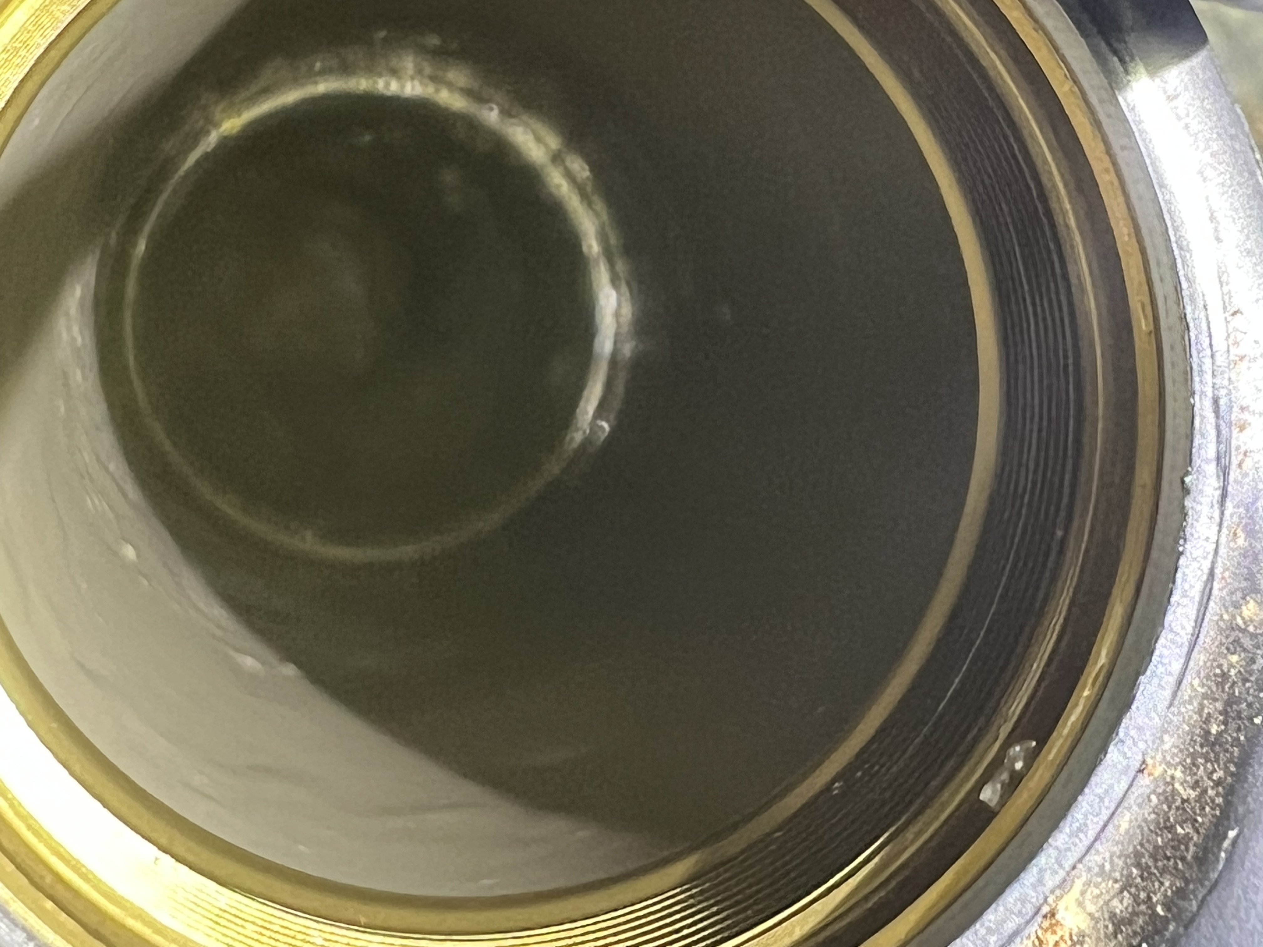

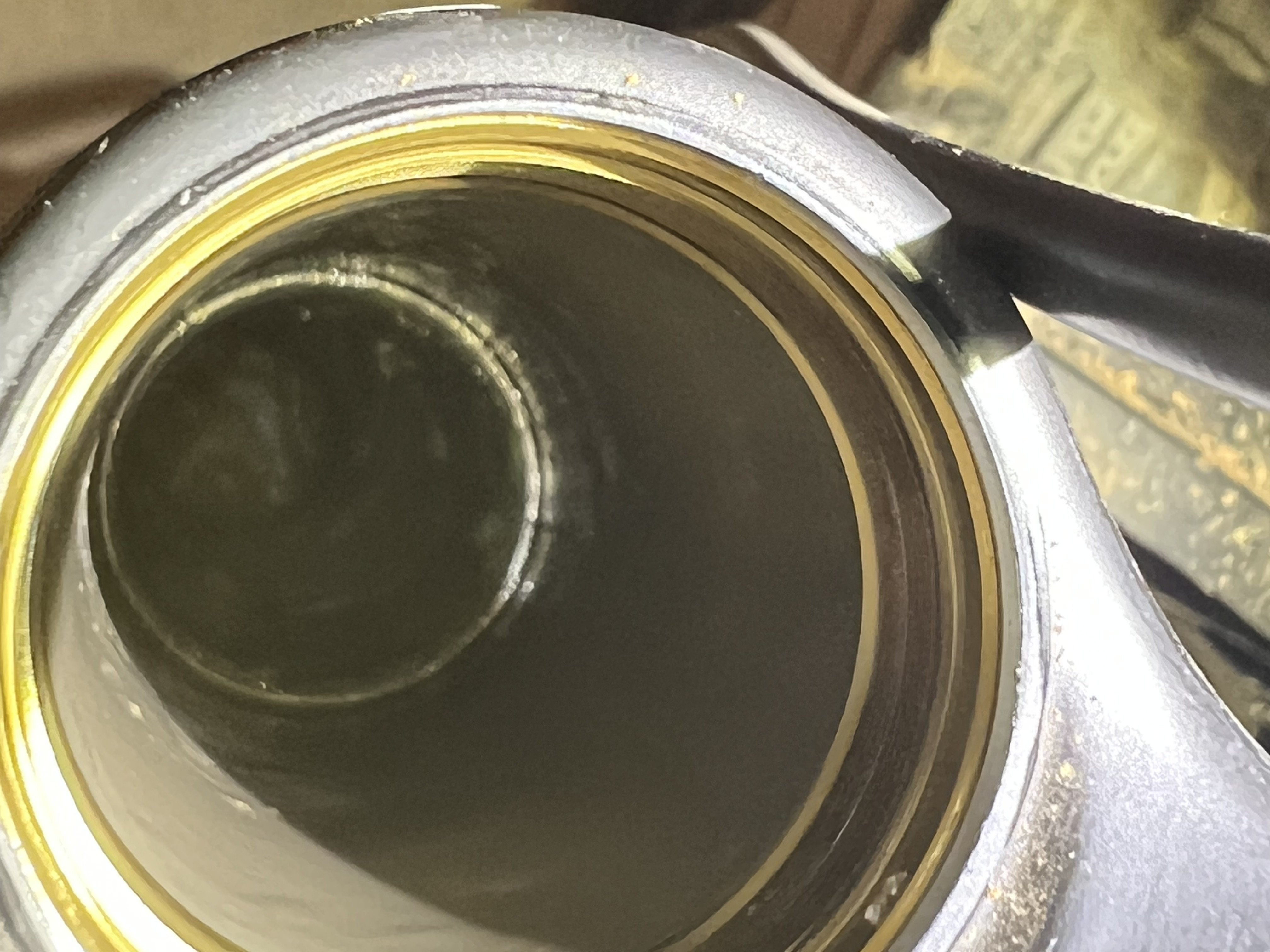

Keeping this thread documented, decided to give AI and a few things new things I’m trying. First just pushing down on the forks just didn’t feel that smooth, even lowering the air pressure. So I put some teflon lube around the dust sweepers and worked the forks some and that seem to help.
Also, there was a suggestion of going to one air spacer from two. However, I found mine had 3 and it’s 170mm. I removed them to test this week.
Read an issue with grease and there was globs of grease inside. I got it out and then used a clean paper towel to put a light film coating.
Another thing to note, with no air, fork didn’t seem like it would full compress. I’m going to have to research what these look like fully compressed.
Around 60 to 70 psi in the forks adding air back in them, forks at least feel good for as far as I could compress them. 95+ still moved but just still seem overly still and not going to get the 30% sag they recommend. I’m going back to 90PSI.
I’ve been reading different things such as closing HSR and opening up LSR as much as possible so that’s what I’ll adjust on next time on the trail.
Attaching pics of grease, but they don’t seem to show how much was actually inside.

Good luck in setting them up. I've had mine for over 2 years and still adjusting them 😱.
A few things I thought I'd mention is. Fox recommend 20% sag and on the 170 that's 34mm.
With my 2021 factory 38s that's around 110psi after a factory tune. Way to harsh without tokens so currently trying 90 psi.
Also you have to fully strip the air shaft out as the excessive grease is underneath what you have shown in the picture. You need to get some special tools for that job, like a tube clamp and a blow torch to remove the bottom stud.

The grease the pictures aren't clearly showing the amount that was at the bottom of the tube, I'm going to see what this does first.
