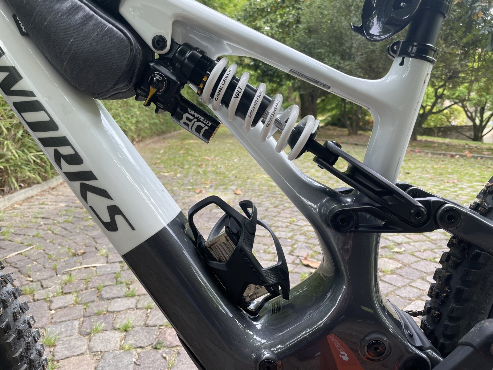

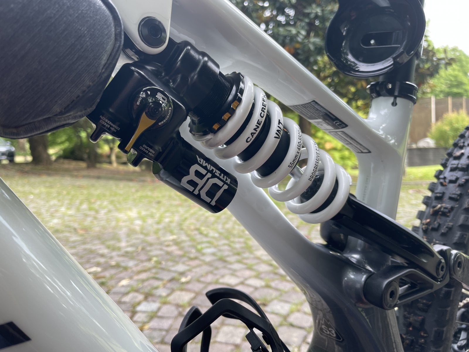

My question was about gen3 and DHX2 compatibility.
For me the link is under the max tolerance, isnt it ?
About leaking, it's to early to say that, but i'm suffering a bit of this issue
Luca
Sorry Luca, not sure really. I think it’s risky.

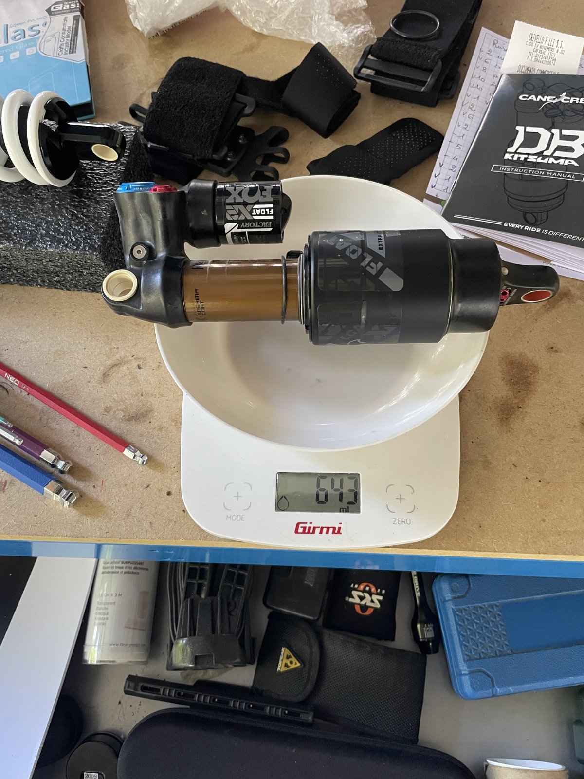

I'd have probably kept the X2 in the Levo, but the shock is now faulty. Air has air mixed with oil. I first noticed a sloshing sound when compressing the rear. After a few more rides I could feel a slight knocking feel in the rear with small repeated kits (for example riding over 200 metres of tree roots, it felt a bit off, slight bumping sensation).
I know something wasnt quite right. So I took it out. Letting out a bit of pressure out and compressing the shock and watching it return, I could see it 'bump' through the travel... ie not completely smooth - it would start smooth and then almost stop, then bump through the final part of the travel.

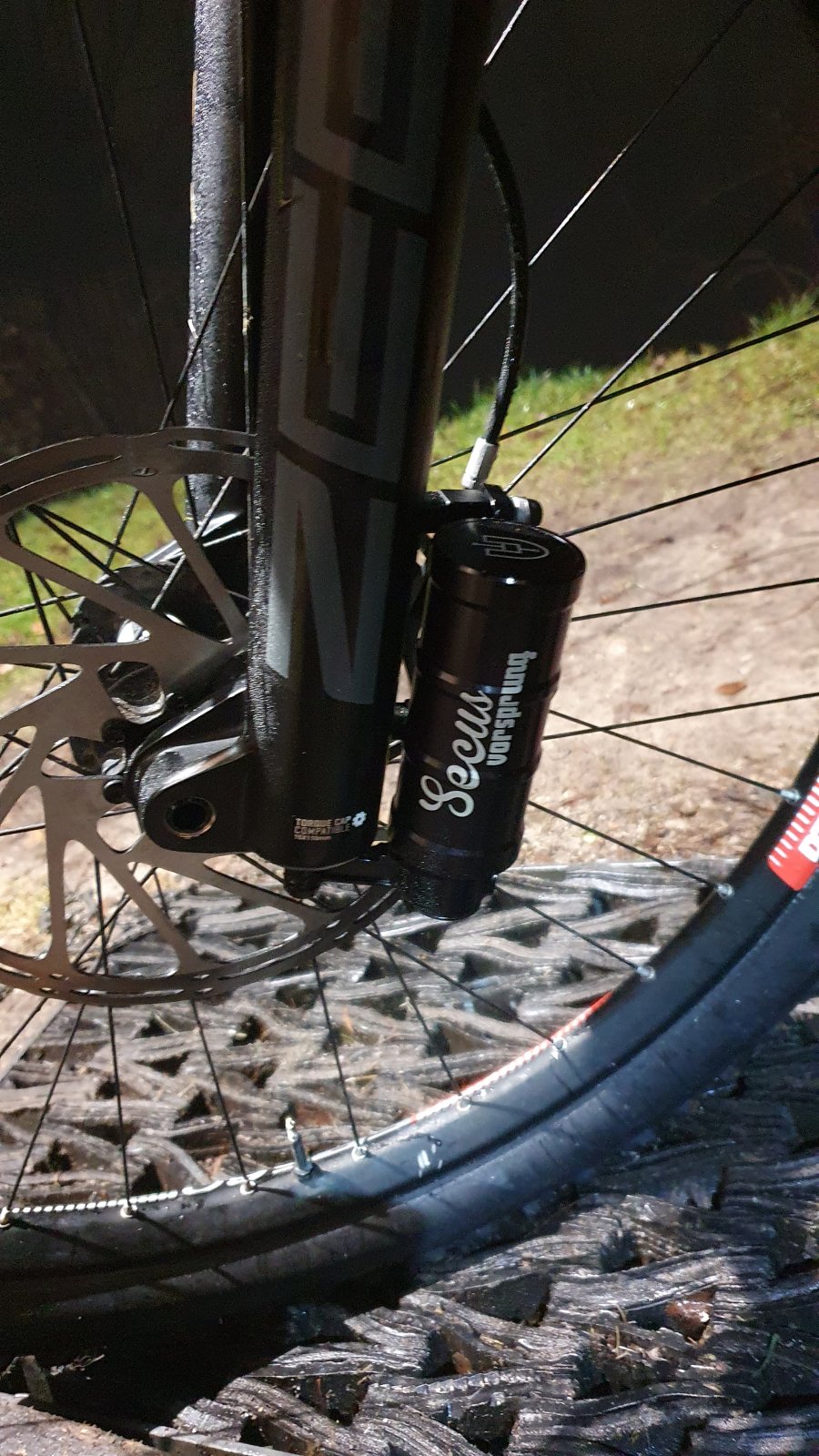

I have the Zeb with Vorsprung Secus with EXT Storia V3 on the Sam 6.8. Works really well and the Zeb gets even better and coil like.

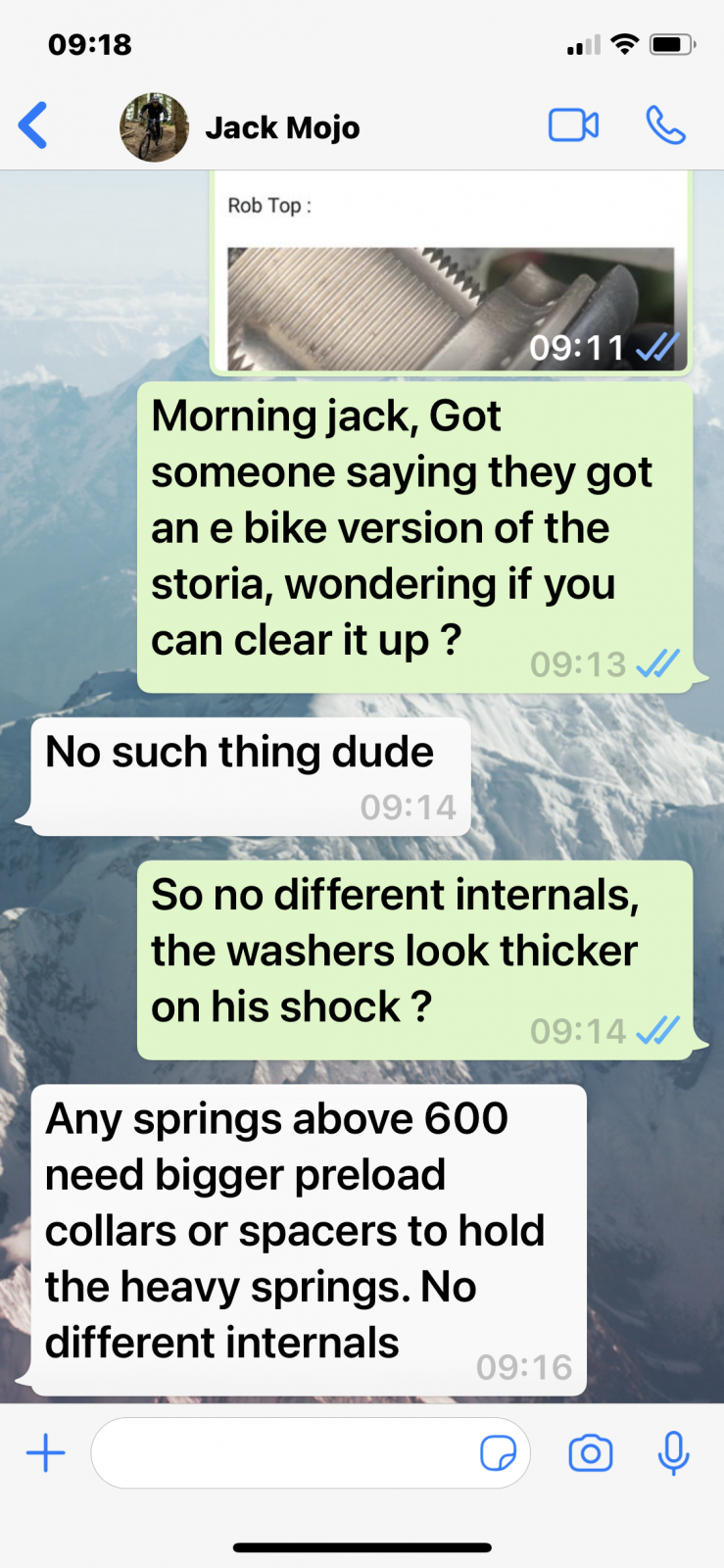

anyone else ext tease an “e-storia” today? Curious if it’s an e-bike specific shock or if it has electronics.
Saw the E bike shock teaser. Yes there will be an specific ebike shock with some smart features:)
