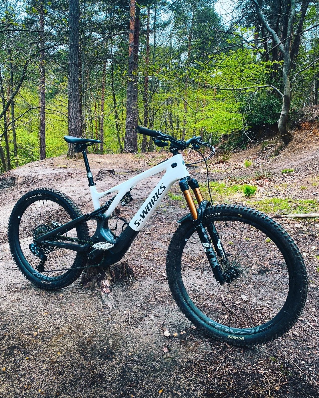

So the stock Fox X2 on my Levo is already suffering from cavitation, sounded awful and erratic rebound. So that’s going off to Fox under warranty.

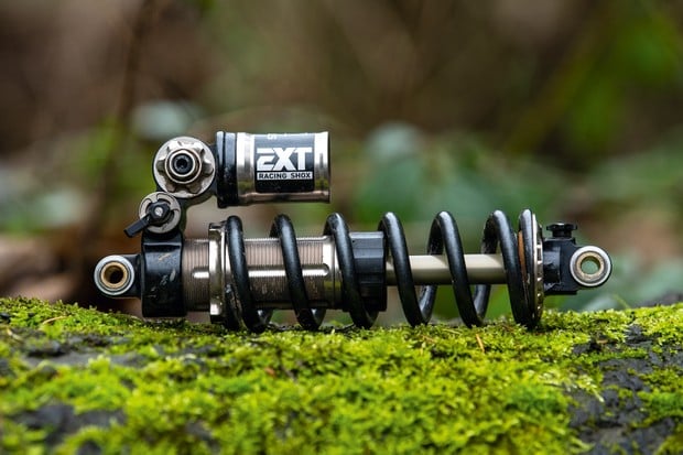

Decided that I’d treat it to a coil, but seems there are only a few options that are deemed suitable for the Levos due to the side stress on a coil shaft.
So yesterday I purchased the EXT Storia V3 from Chris at Mojo. They’ve made some damping changes already to suit the new leverage curve on the Gen 3 - (fromMojo: bit softer on the compression setting but more progressive (more high speed damping) on the rebound settings.)
It should be here next week, I’ll keep this thread updated with progress and Ride reports.

Good choice... Im pretty sure you'll have the same tune as me now, Let me know what you think when you've had few hours on it.
First micro test.... Damn, it’s good! Just a quick 1 hour loop but absolutely night and day difference. Glued to the floor and removes the slightest bit of chatter from the trails.

Why a Storia instead of an Arma? Do you use a climb switch?
(for others who are not familiar, the Arma has a user adjustable hydraulic bottom out control (HBC), the Storia has a fixed HBC tune (adjustable via disassembly) but with a climb switch...which seems wasted on an ebike and just something else that might fail/need service.)
I wonder how this compares to the ohlins coil.
I haven't ridden Ohlins, but have ridden a couple of other coils. The EXT Coils are significantly different than Fox and Cane Creek. Much more "racy" feeling. They ride very high in the travel with excellent support yet still manage to suck up all the chatter. Very nice. One thing to be aware of is they are quite noisy.
Didn’t really consider the Arma to be honest. My assumption was the Storia would be more appropriate for my bike and riding ?

Agreed, The ext feels like the Zeb forks, in that it manages to stay high in its travel without that harsh rebound feeling. I went with the storia as that is what mojo recommended for my bike, I’m lucky enough to live 30 mins from mojos so just pop over and leave the experts to make any adjustments

The ebike specific EXT Storia has thicker spring collars and a solid rod within the hollow shaft for strength. Did you get the e-bike version @Rob? Bit tricky to tell from your photo. It’s worth checking.
