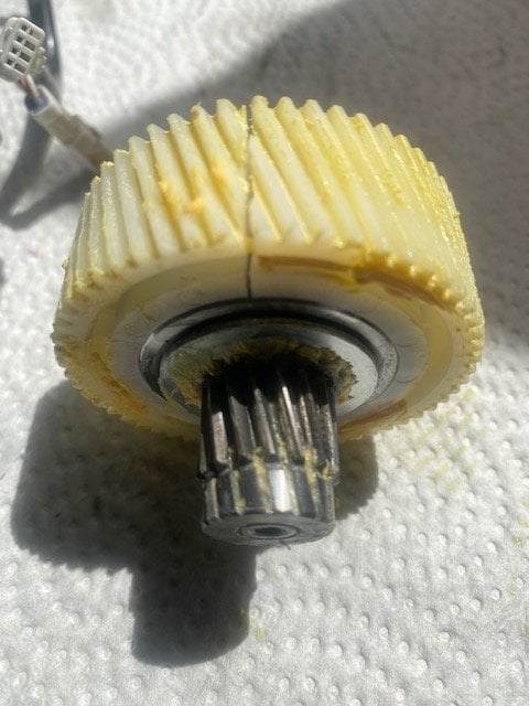

That plastic gear is designed to fail if the load on the gears exceeds the limit to save more expensive components. The lower failure rate of those gears on Yamaha motors tells they they designed that gear the right way.
It would be much cheaper to make the clutch bearing slip :unsure:
I heard Brose used the same system and that the sprag bearings and/or belt are designed to fail when the load exceeds the limit of the motor mount bolts.
You can see from the high failure rate of these parts, Brose clearly designed those parts the right way. o_O

Is there any consensus on motor servicing? Risky question in a thread where Pete, who makes a living rebuilding these things is around, I know 😊 but it's a hard working component to say the least & everywhere I look, I see people acting only when their motor fails. Lots of us service suspension, clean & lube drive trains routinely but I don't see people dropping motors & sending them off for an annual spruce up.
Bearing Man
Ebike Motor Centre
Sep 29, 2018
900
2,159
They crack as well as strip... No pedal strike here!
