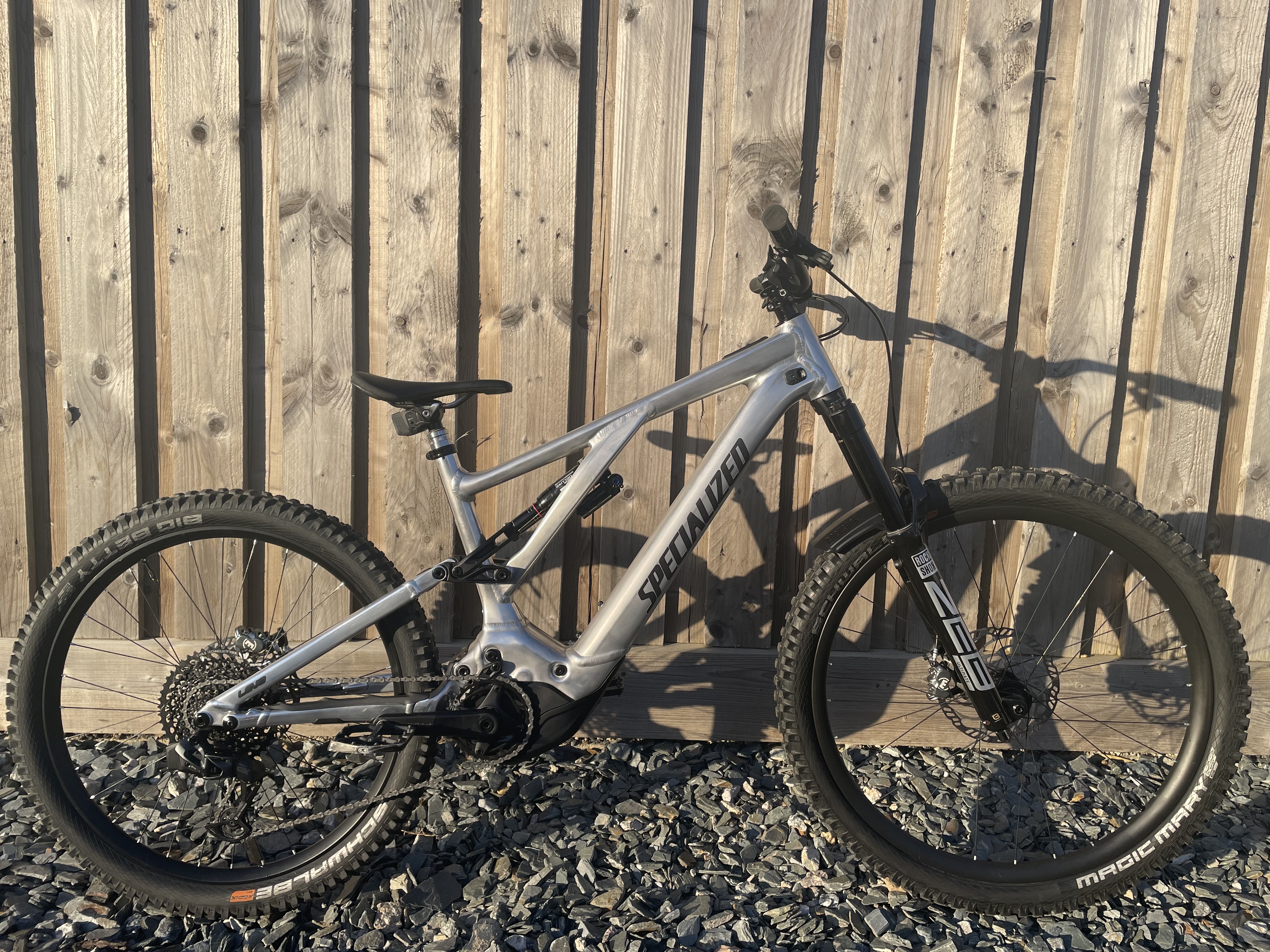

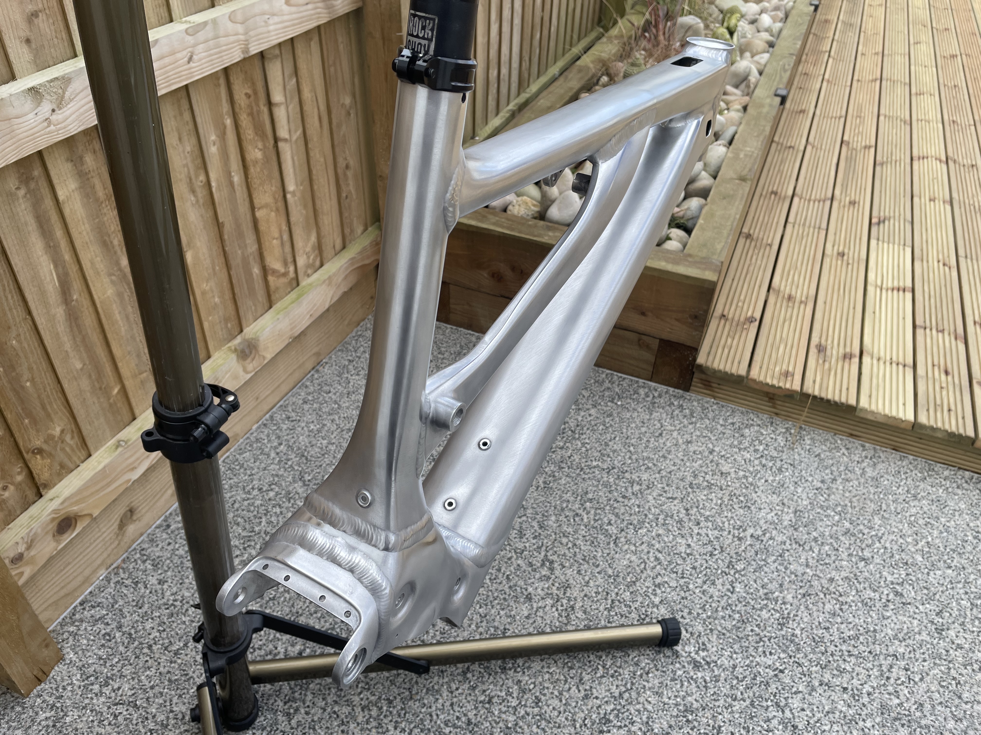

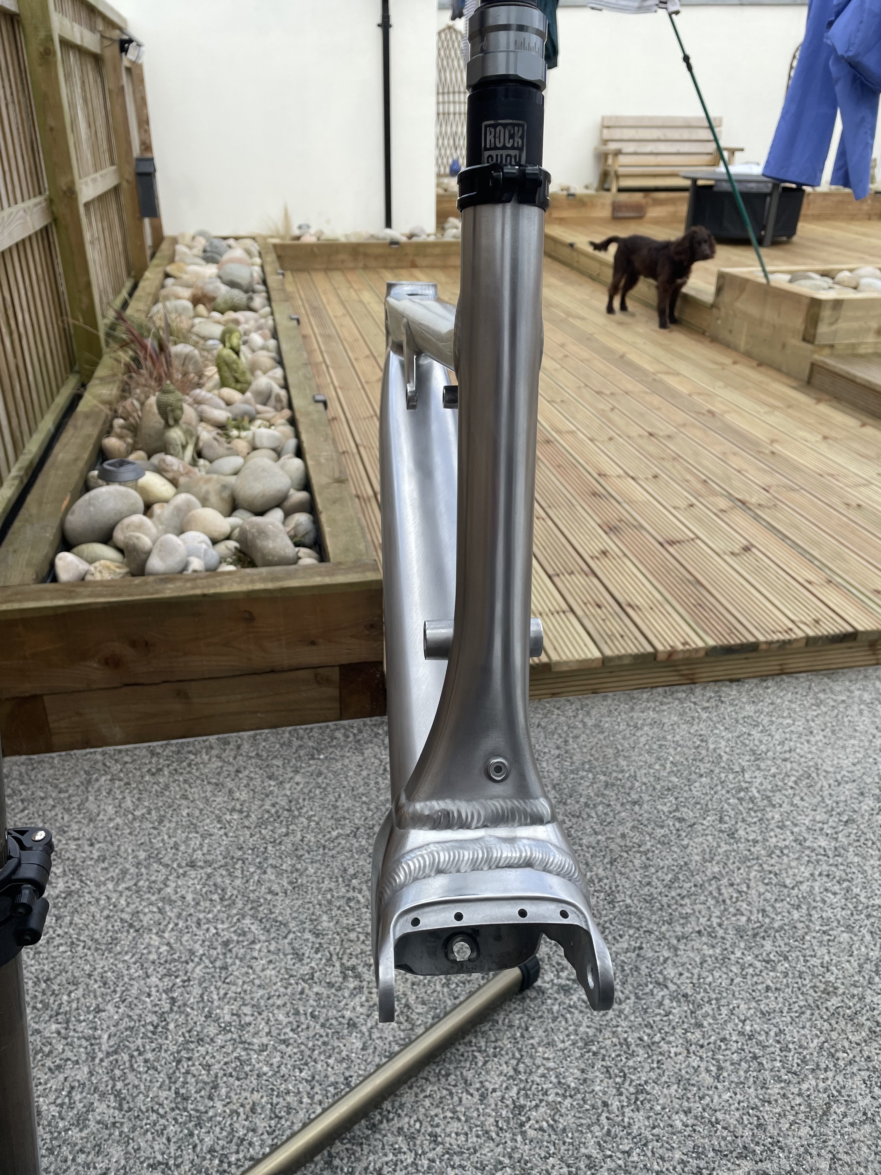

Levo Gen 3 Stripping the Alloy Frame to Raw.

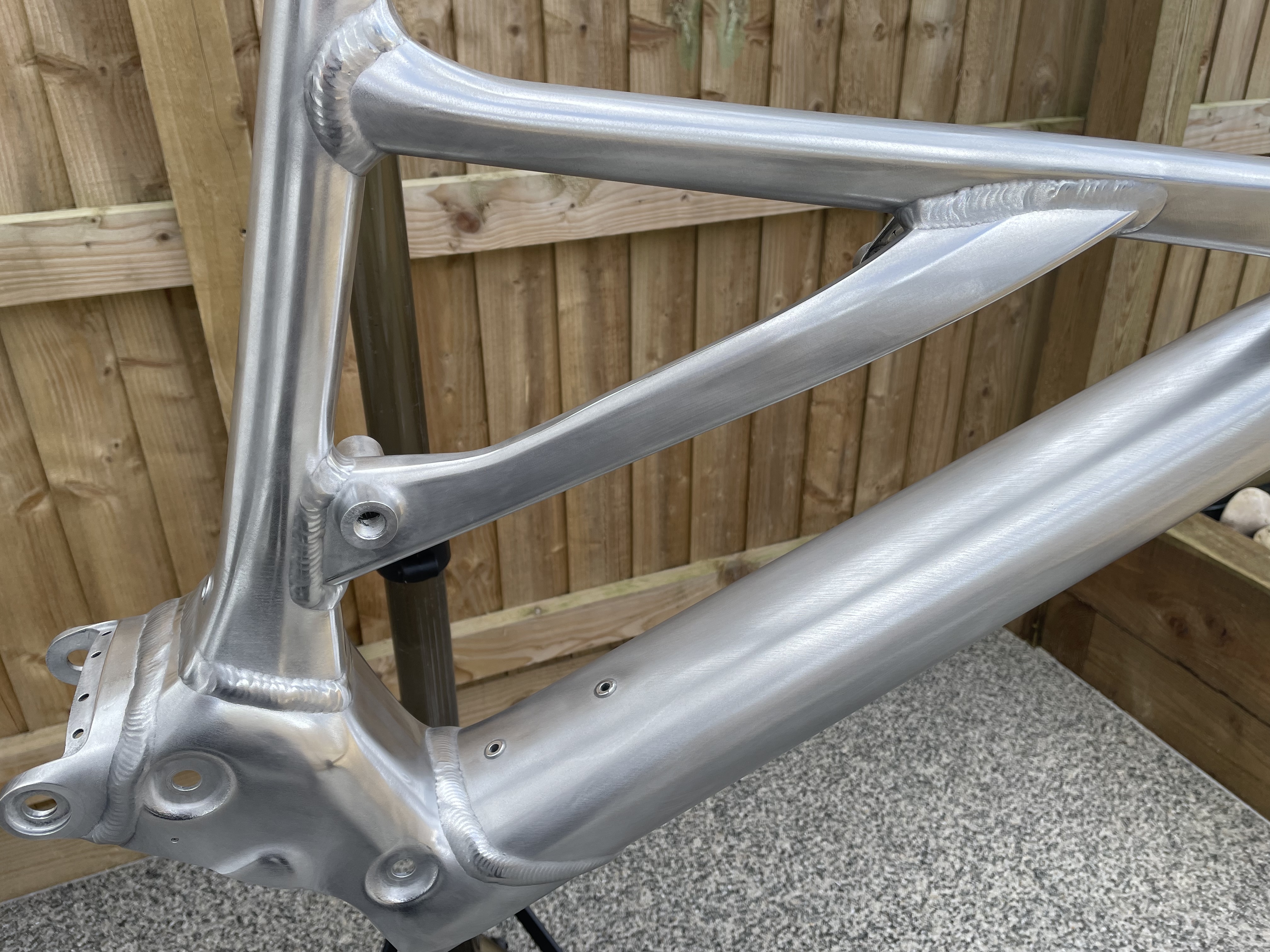

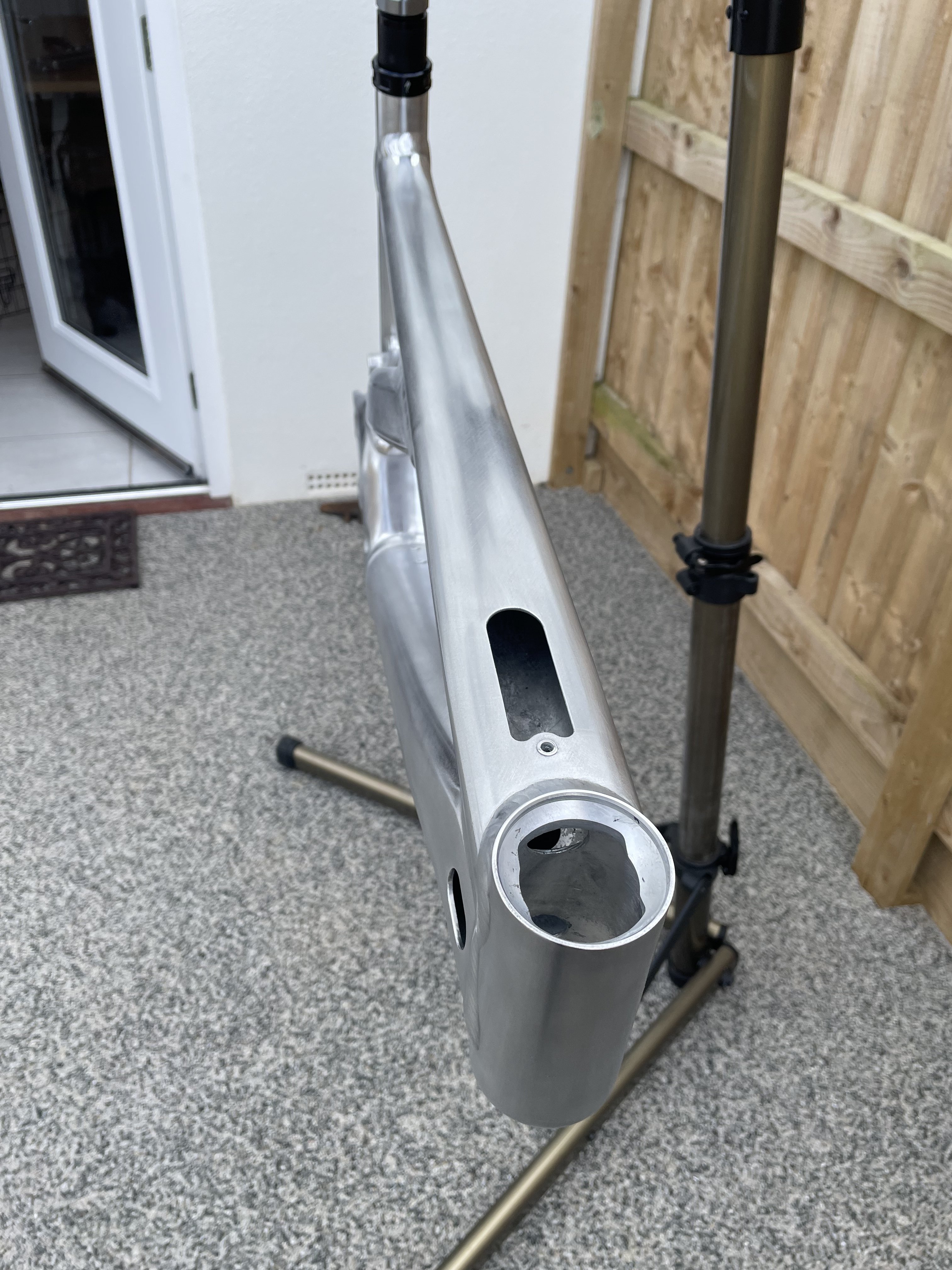

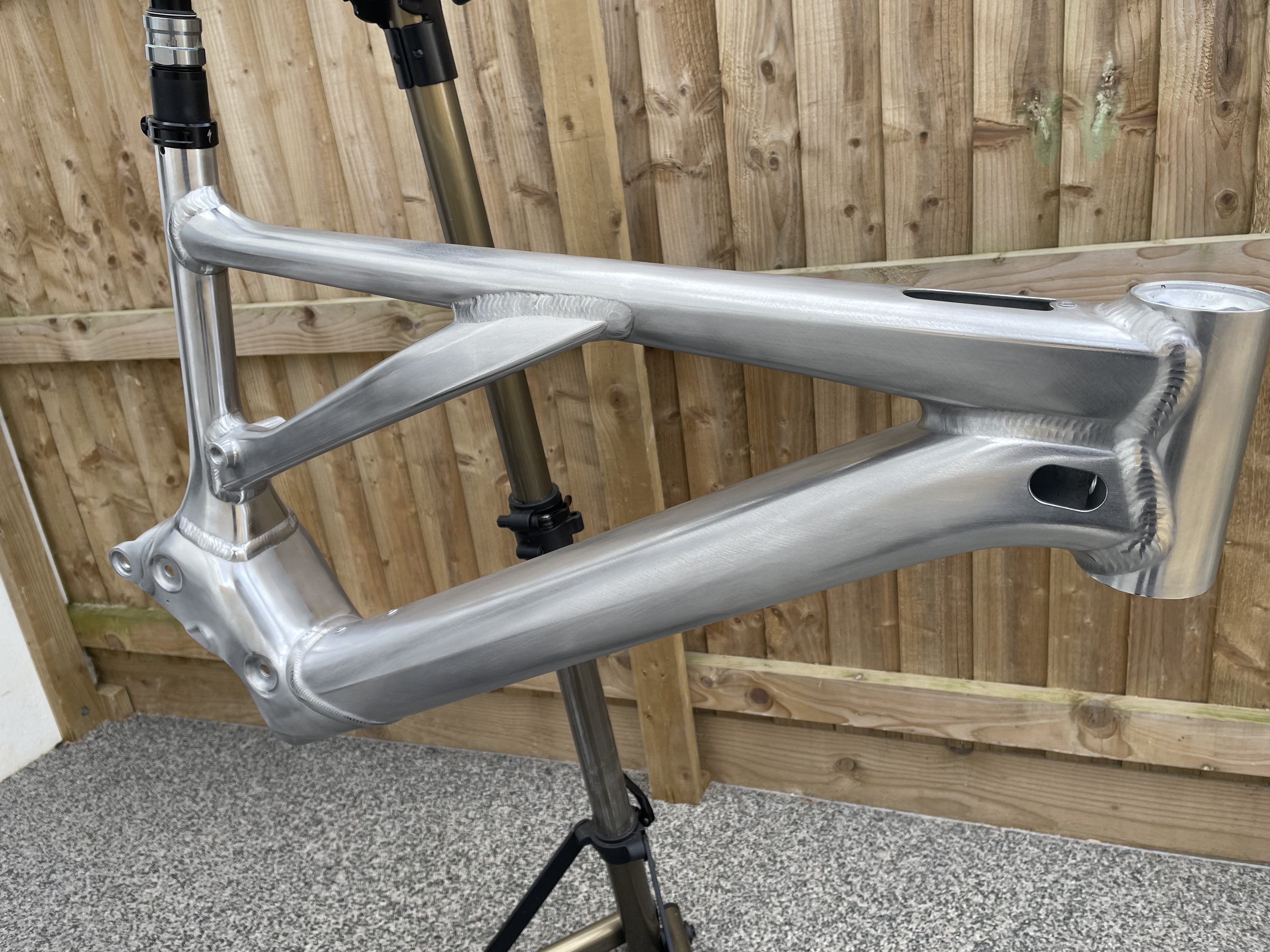

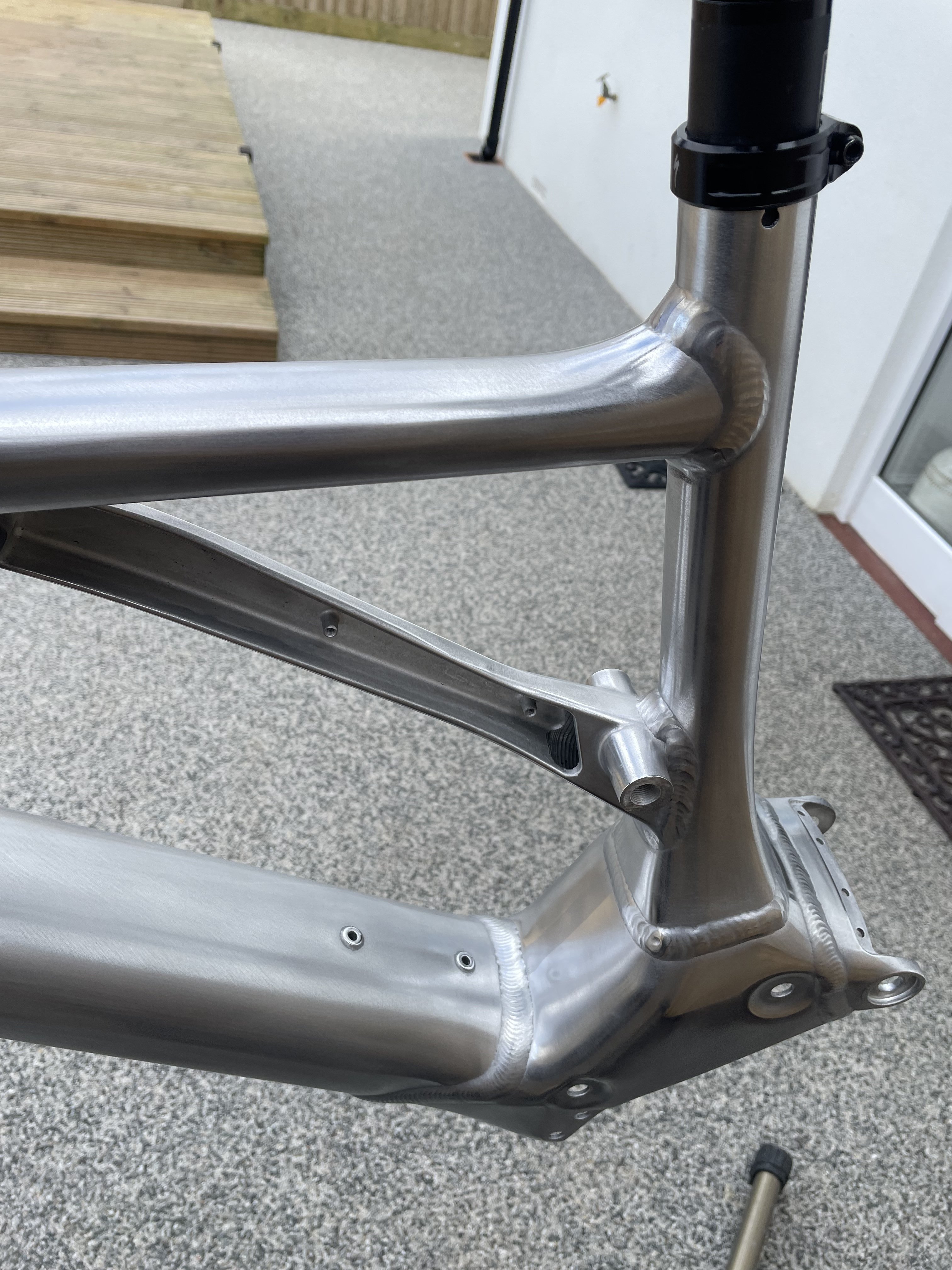

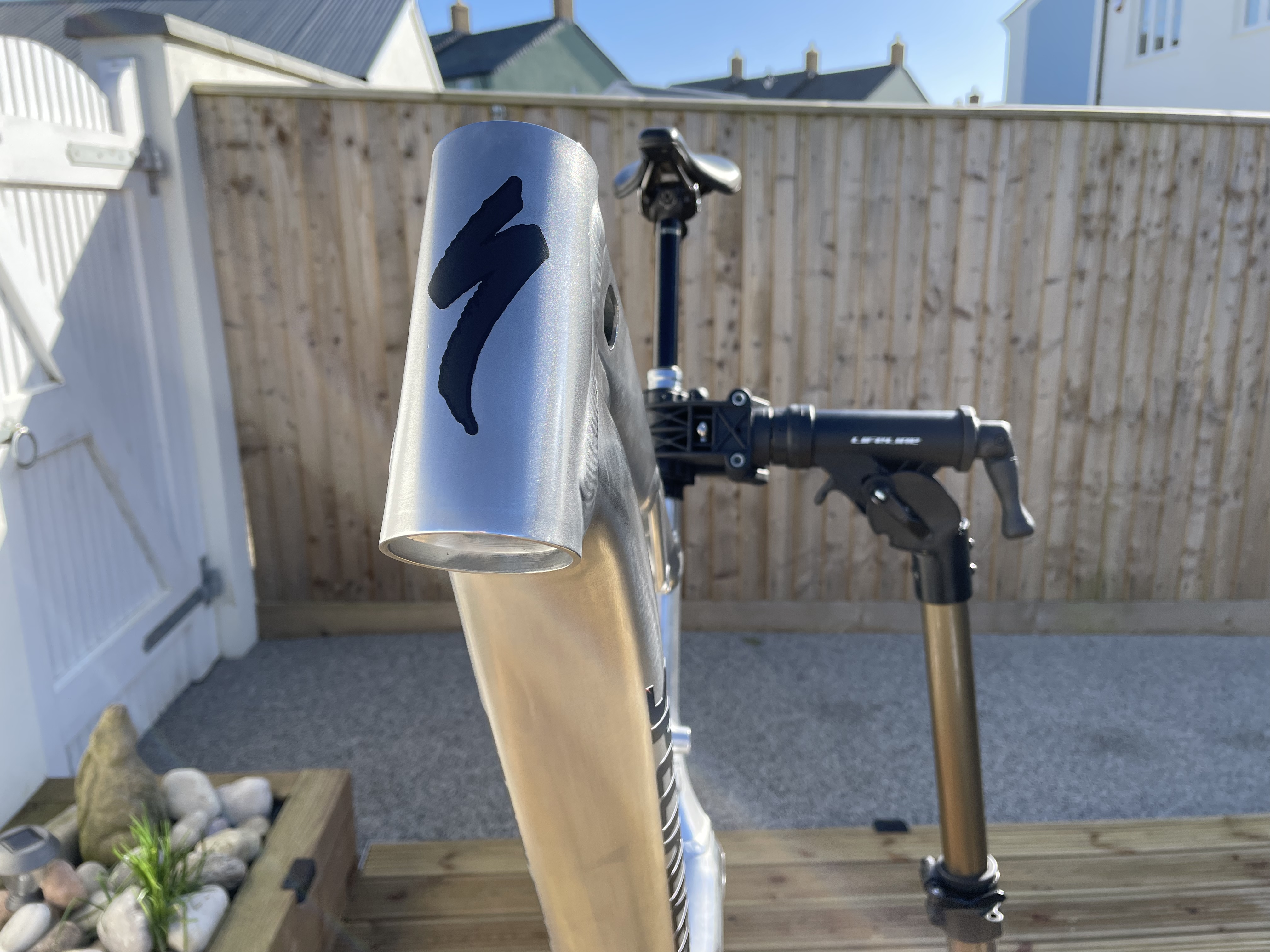

Some outside shots.

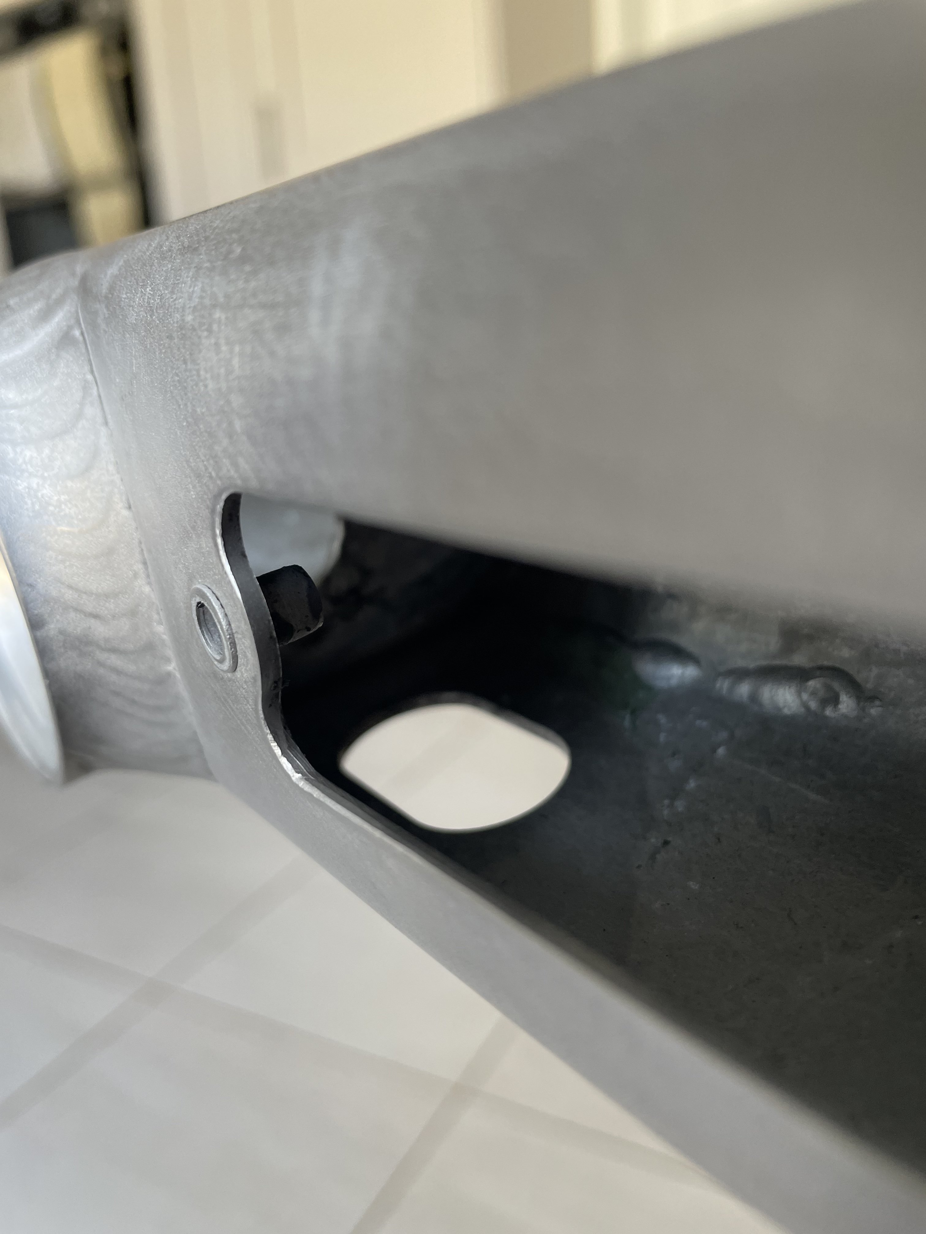

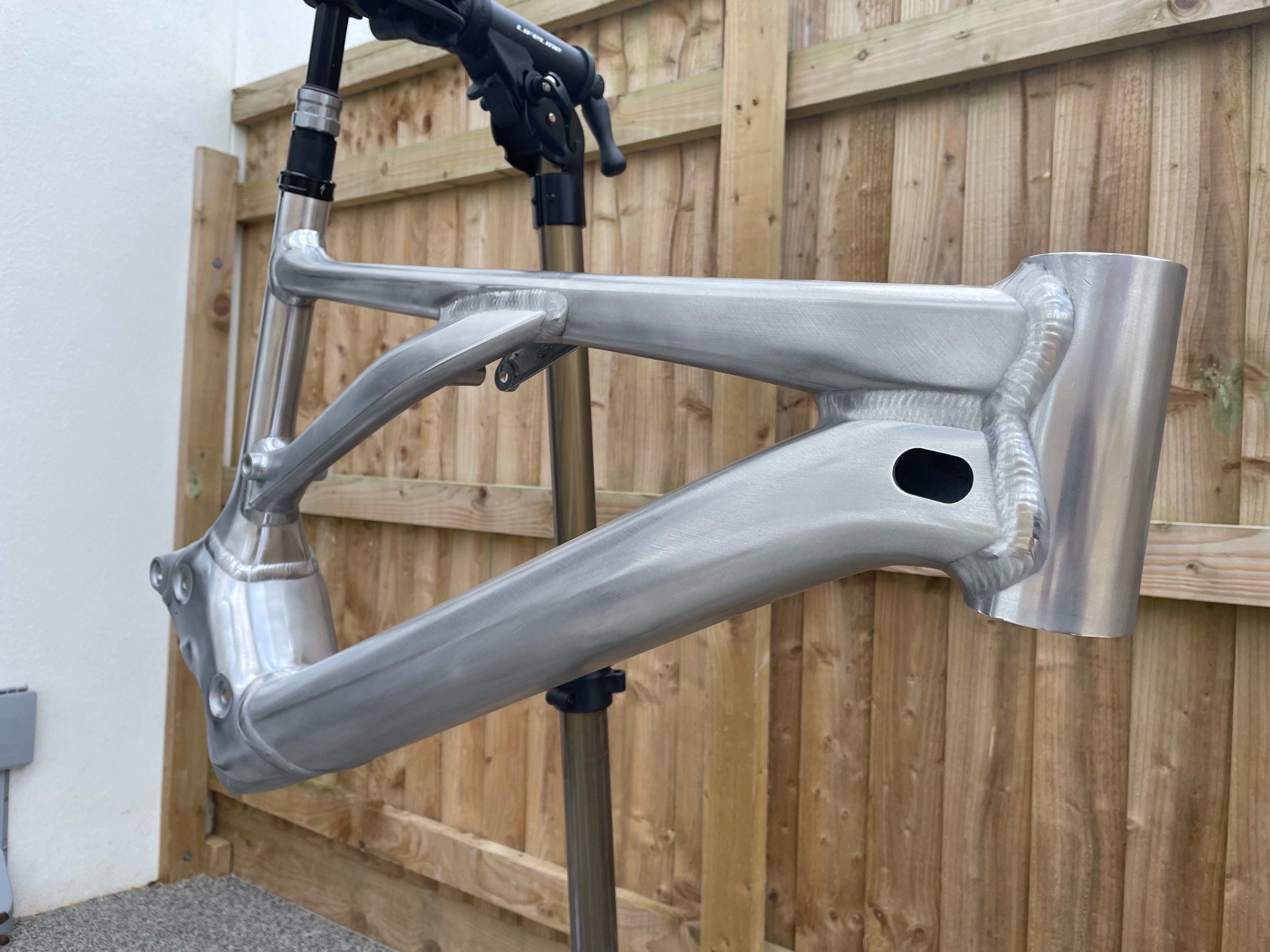

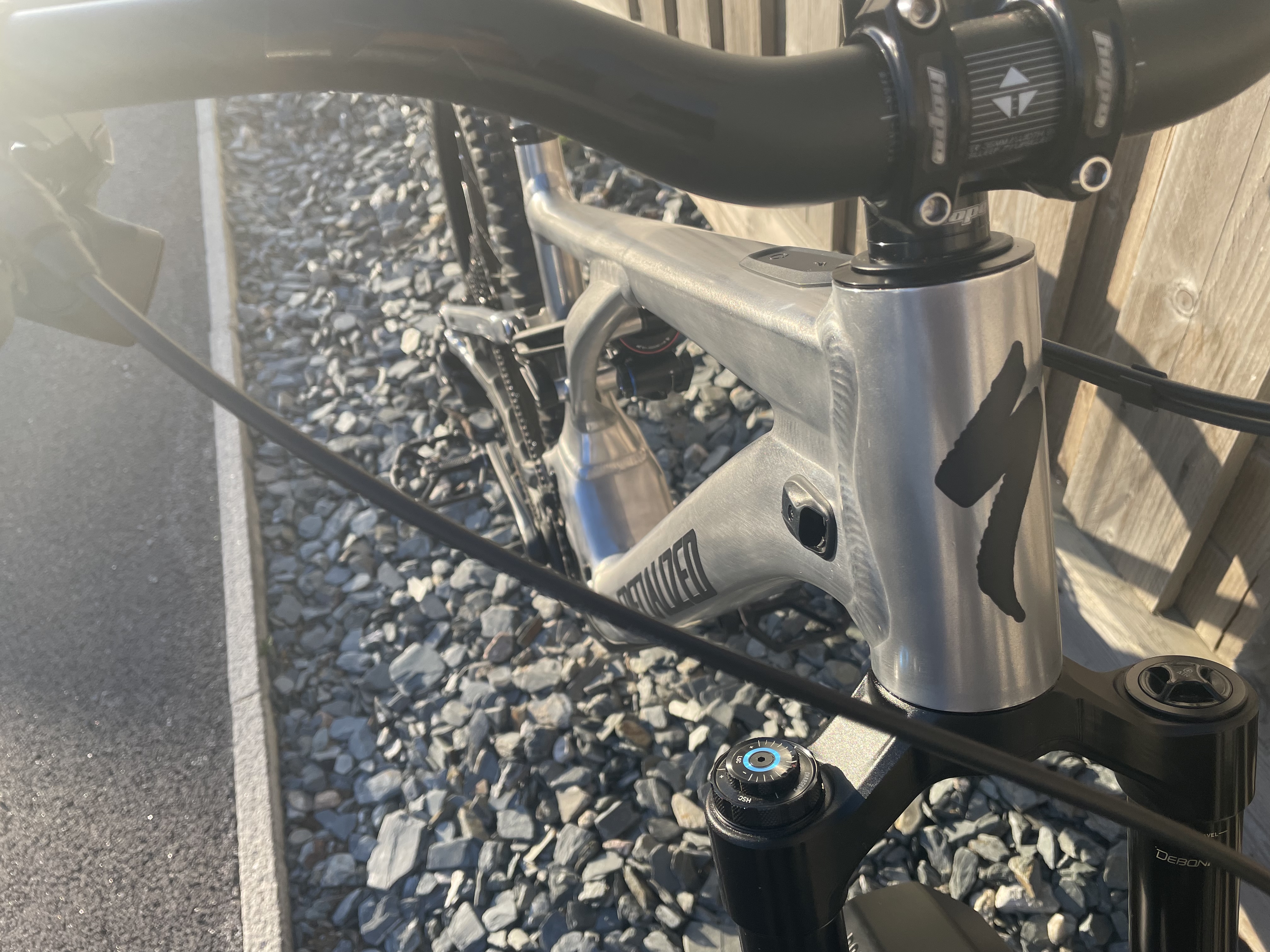

Awesome job so far!
Can you tell me if the hole for the screw that holds the TCU in the top tube is a threaded insert/river or the actual frame is threaded? I have a mate who has a new levo and the screw is spinning, can’t tighten or loosen it
Threaded frame.

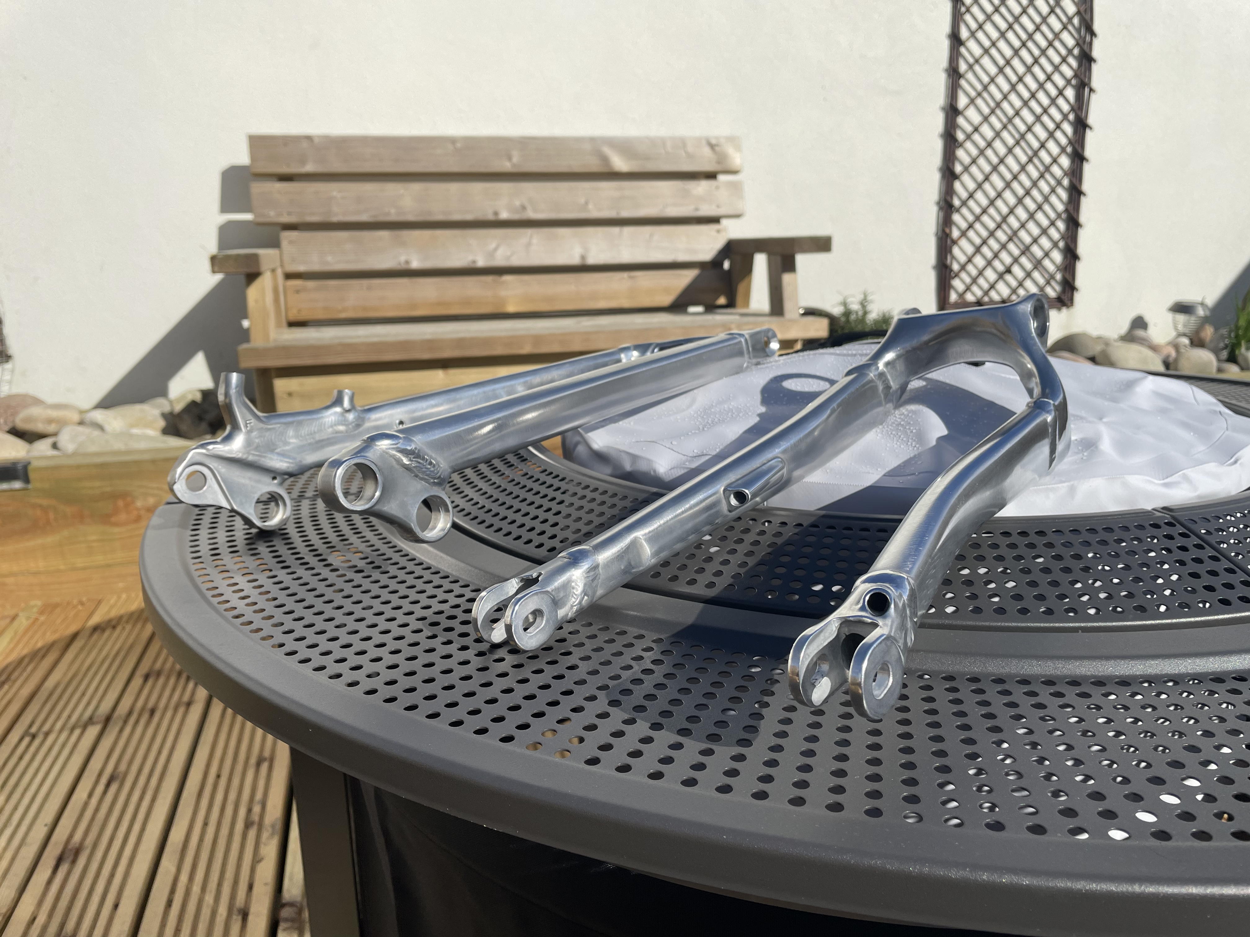

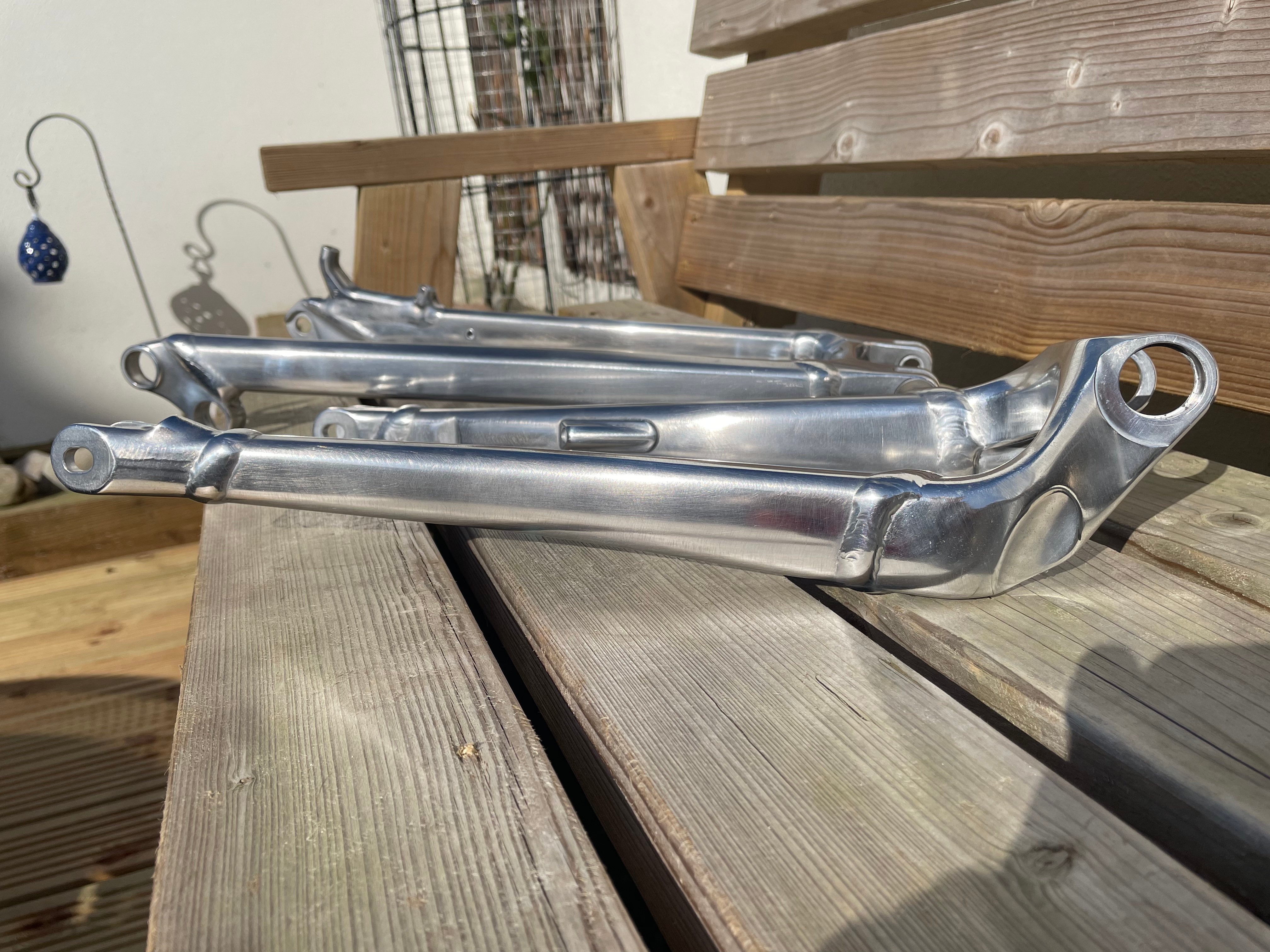

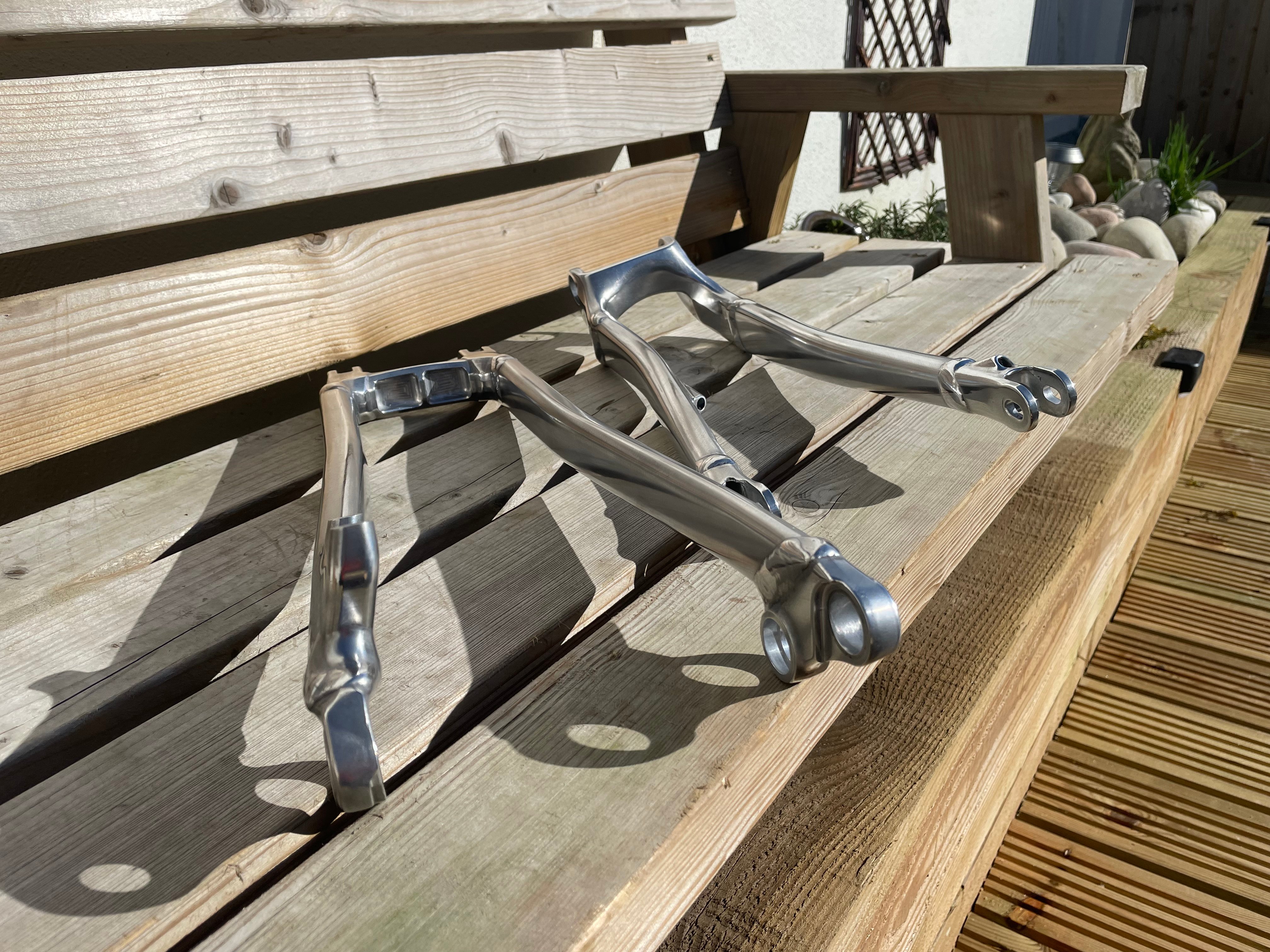

Yeah some alloys just don't come up mirror finish no matter how much time you spend on them. I had a nitrous bottle once which wouldn't get past the level you have despite hours of trying.

Guys these things look great. Has anyone checked with the manufacturers to see if stripping voids the frame warranty. Back In the states Cannondale would generally not honor a warranty on a stripped frame and decades ago Klein stopped making raw frames because they claimed the raw frame alloy metal was leading to more frames breaking and also would not warranty a frame an owner stripped. I have taken two bikes to raw and they look great - nothing better than to be able to sand and then use mothers polish to bring a frame back to perfect, but would like to know about how the process affects a frame warranty before taking a bike to raw.

I know of a guy in Cornwall that strips and paints Spesh frames and retains the warranty. But I suspect my frame will no liner be covered, but hopefully I’ll never have to find out.

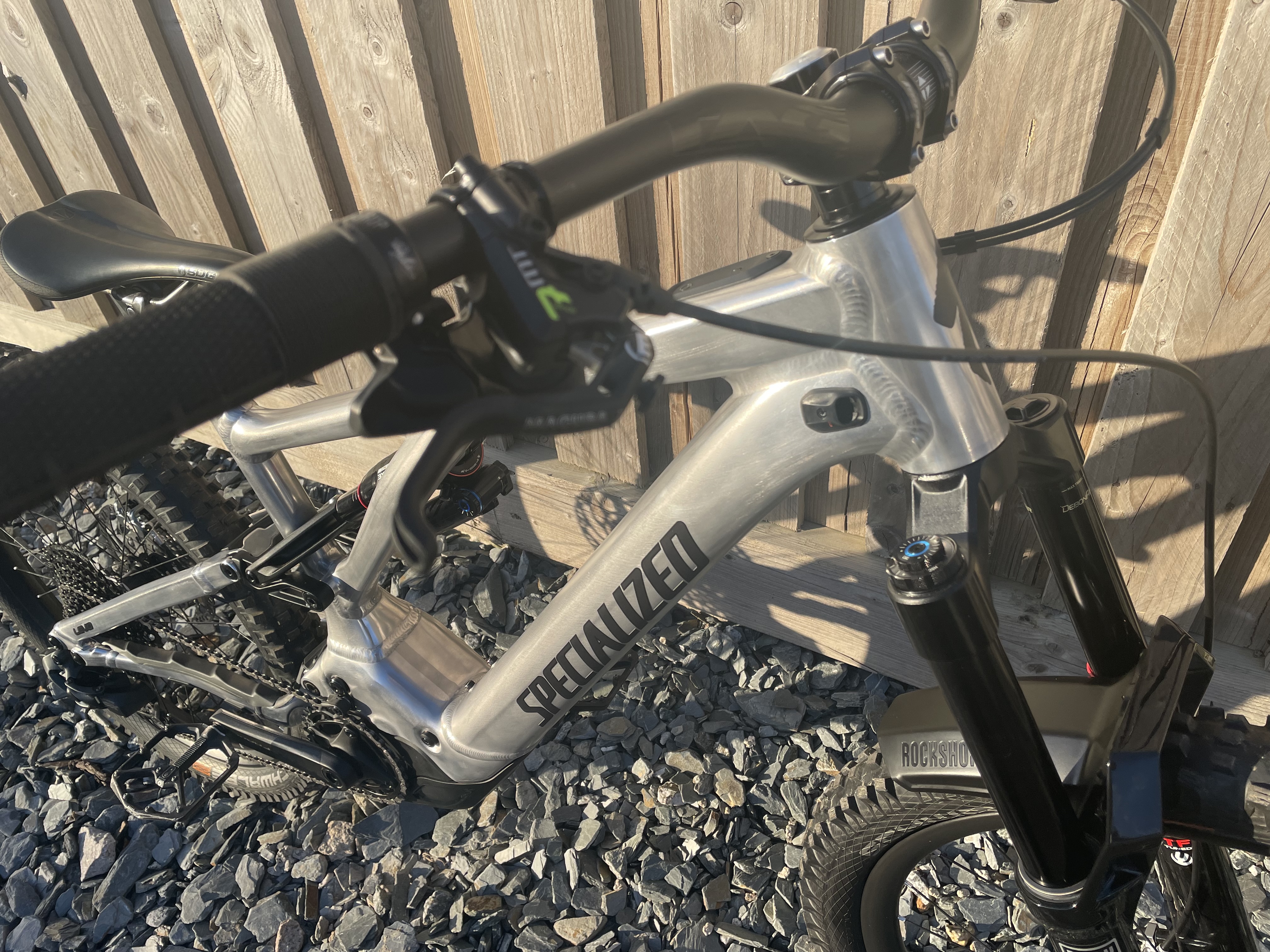

Does stripping the frame of paint increase the risk for corrosion?

No, there is no point. One of the benefits of Raw alloy is that you don’t really need to worry about paint chips or anything.
If you do add a hard clear coat, it will chip and look ugly quite quickly.

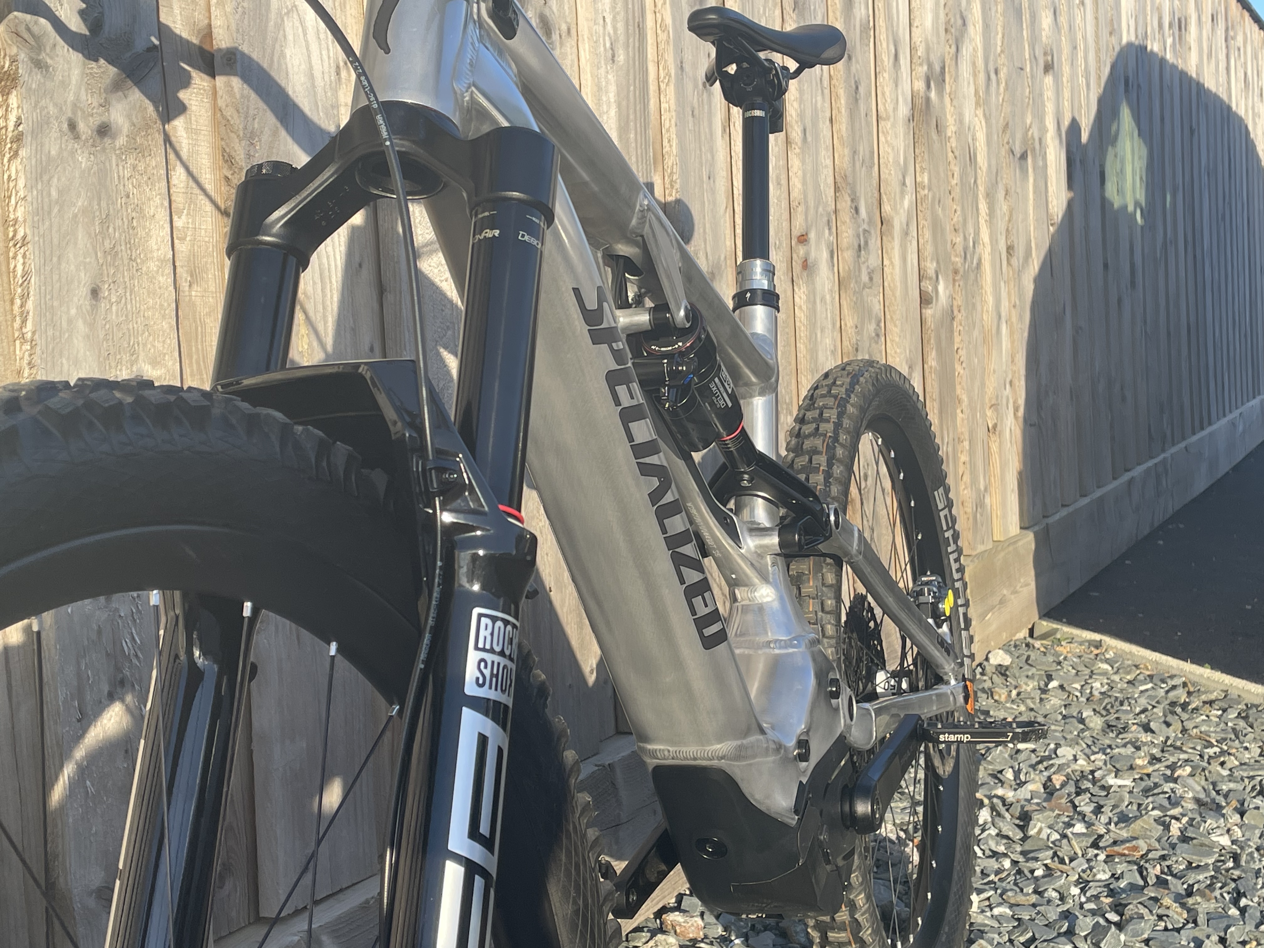

Isn't there a grommet something to stop the cables rubbing where they exit the underside of the top tube ? (Especially as you're a man who doesn't like noises ...)
It does look bloody good ! The welds don't stand out as they did before you polished.

There is no gromet. But the internal
Plastic tubes are pretty solid and held in place by a bracket on the side bar.

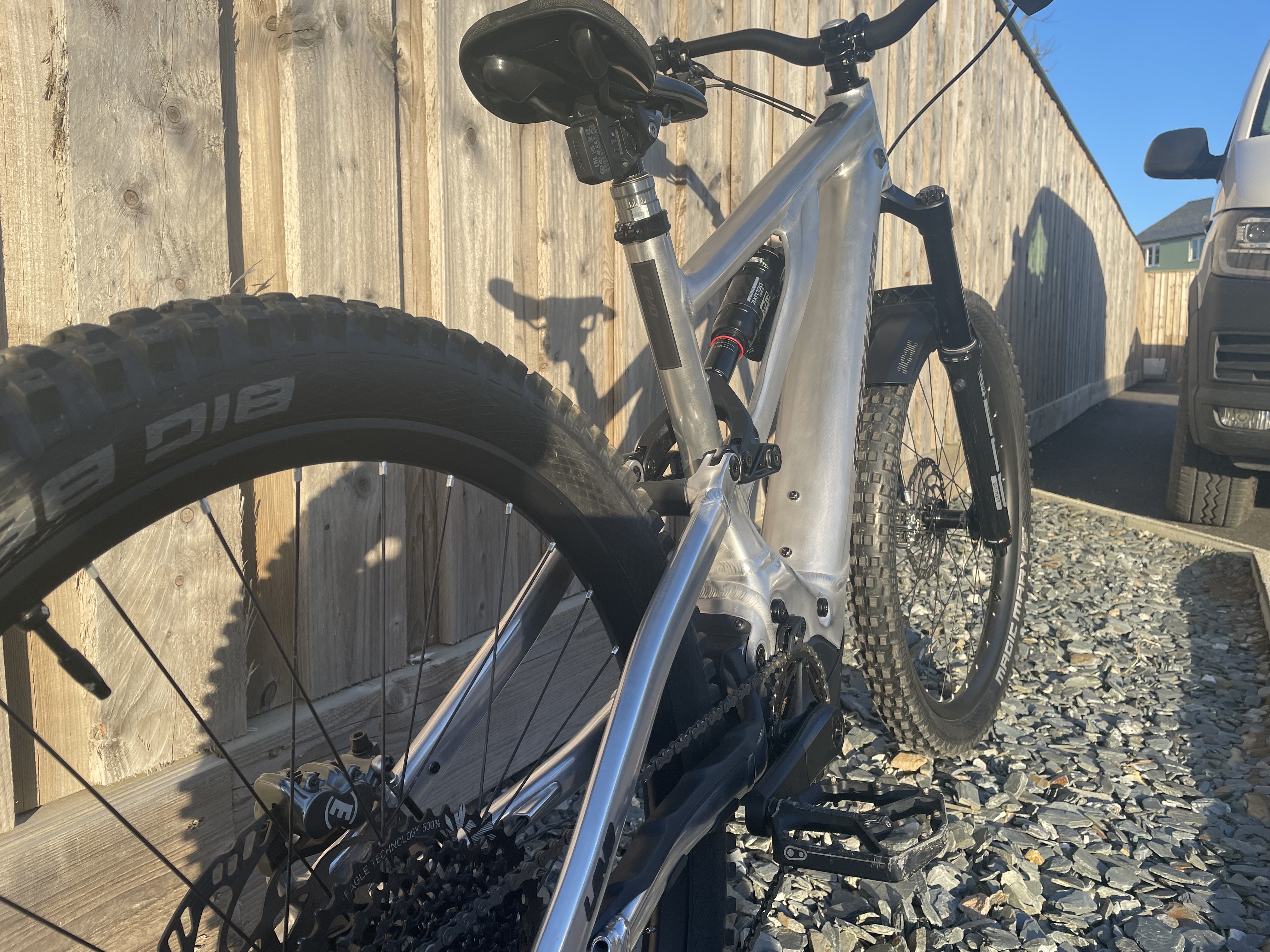

I then stuff bubble wrap around the TCU where I also have a Levociraptor, I can also stuff bubble wrap up towards the TCU from under the Down tube.
The bike was silent around Cwmcarn on its first ride.
So nice to hear the tyres on the trail and no other rattles or clatter.
Astonishing really, still can’t get my head around how riders put up with the noise from the Bosch.

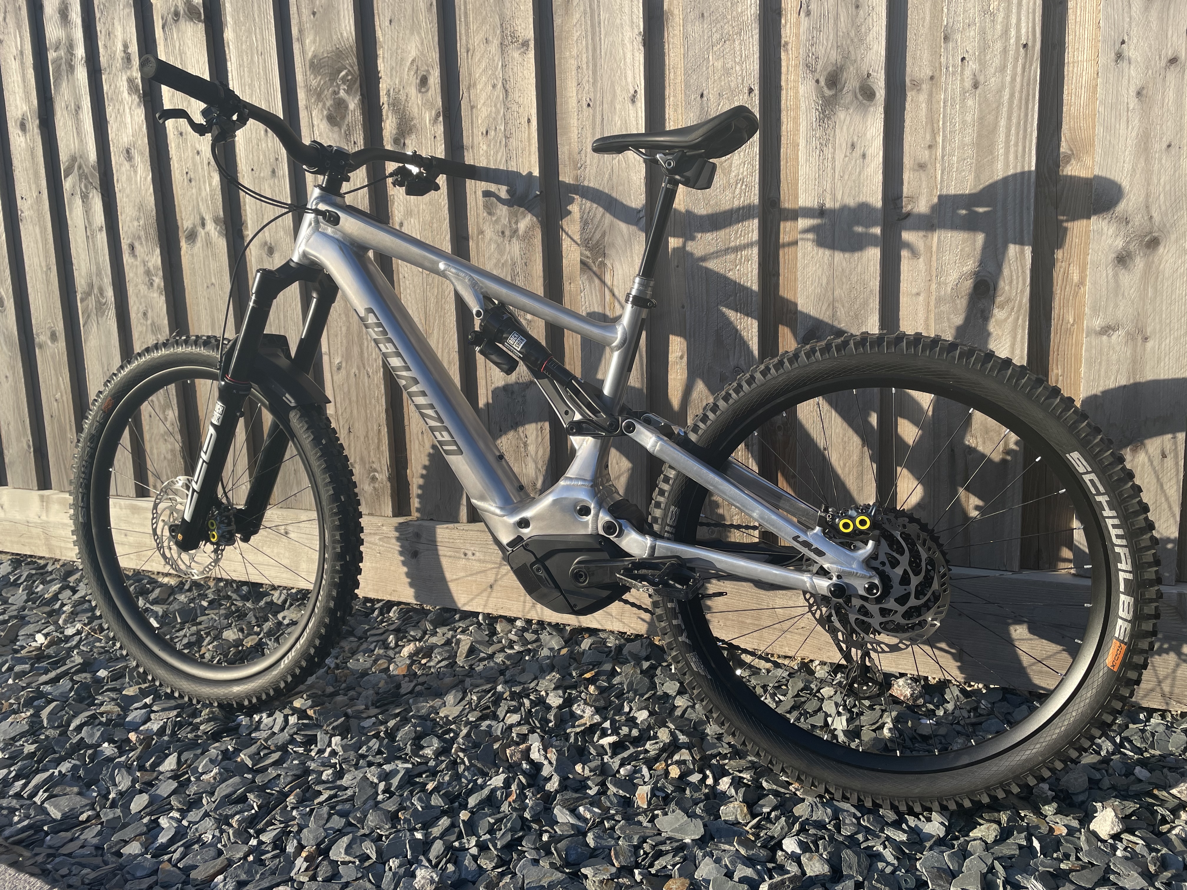

Did we mention that your bike looks freekin hot ! @BAMBAMODA's seen it now and he has absolutely no control over his sexual urges, I would STRONGLY advise spraying the whole bike with some form of temporary protective film.
