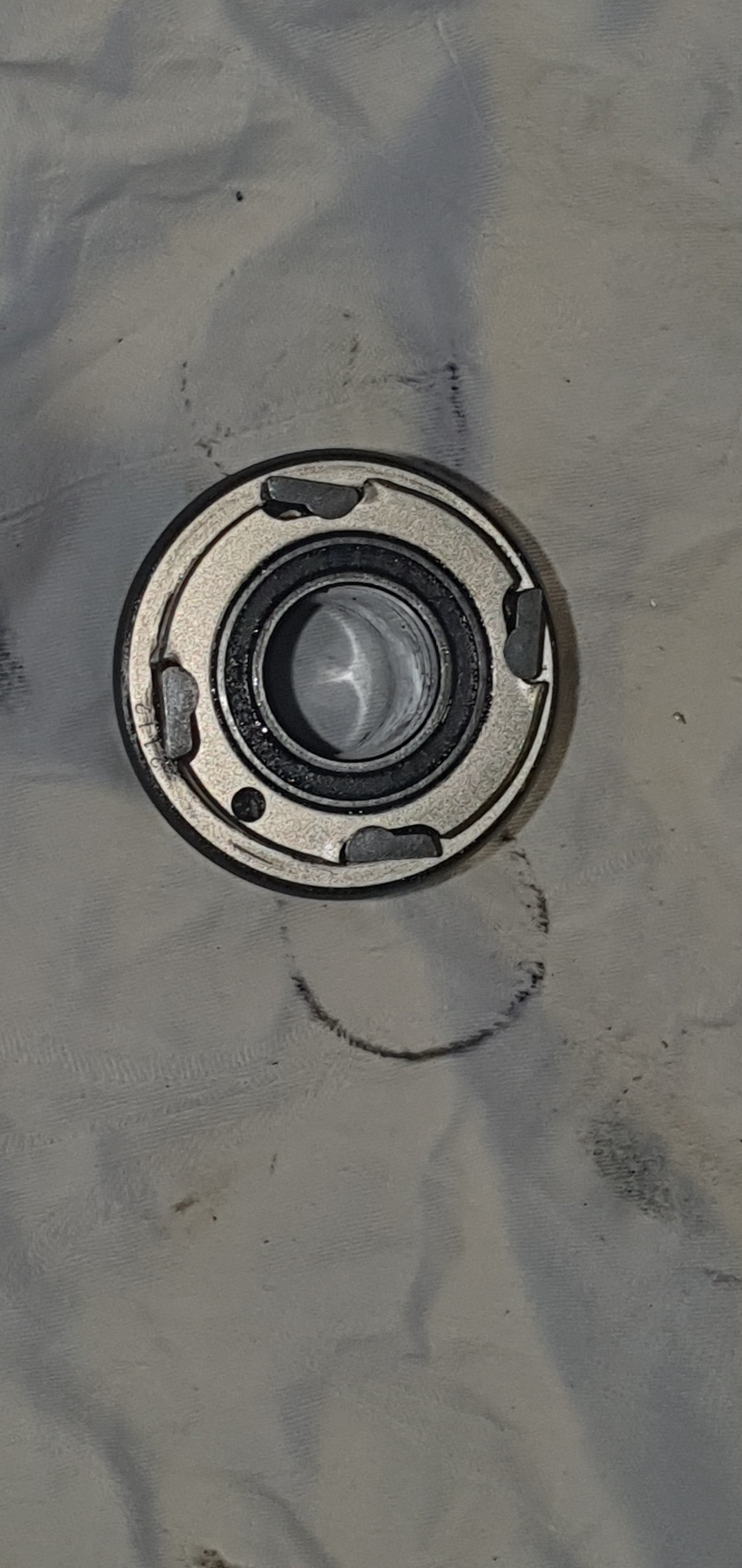

Just had my hub fail on my H15 at 9 weeks/ 300 miles. The freehub locked up and the chain was rotating with the wheel instead of freewheeling. I've stripped it down and managed to free it off but it's definitely toast. The freehub itself is made of cheese and the pawls have eaten there way into it. Probably not up to analogue mtb use never mind emtb use. Definitely not fit for purpose.

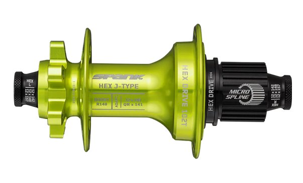

I use standard Spank Hex on my Rise, Nukeptoof Horizon V2 uses same freehub as fitted one to my Hex hub as wanted XD hub
