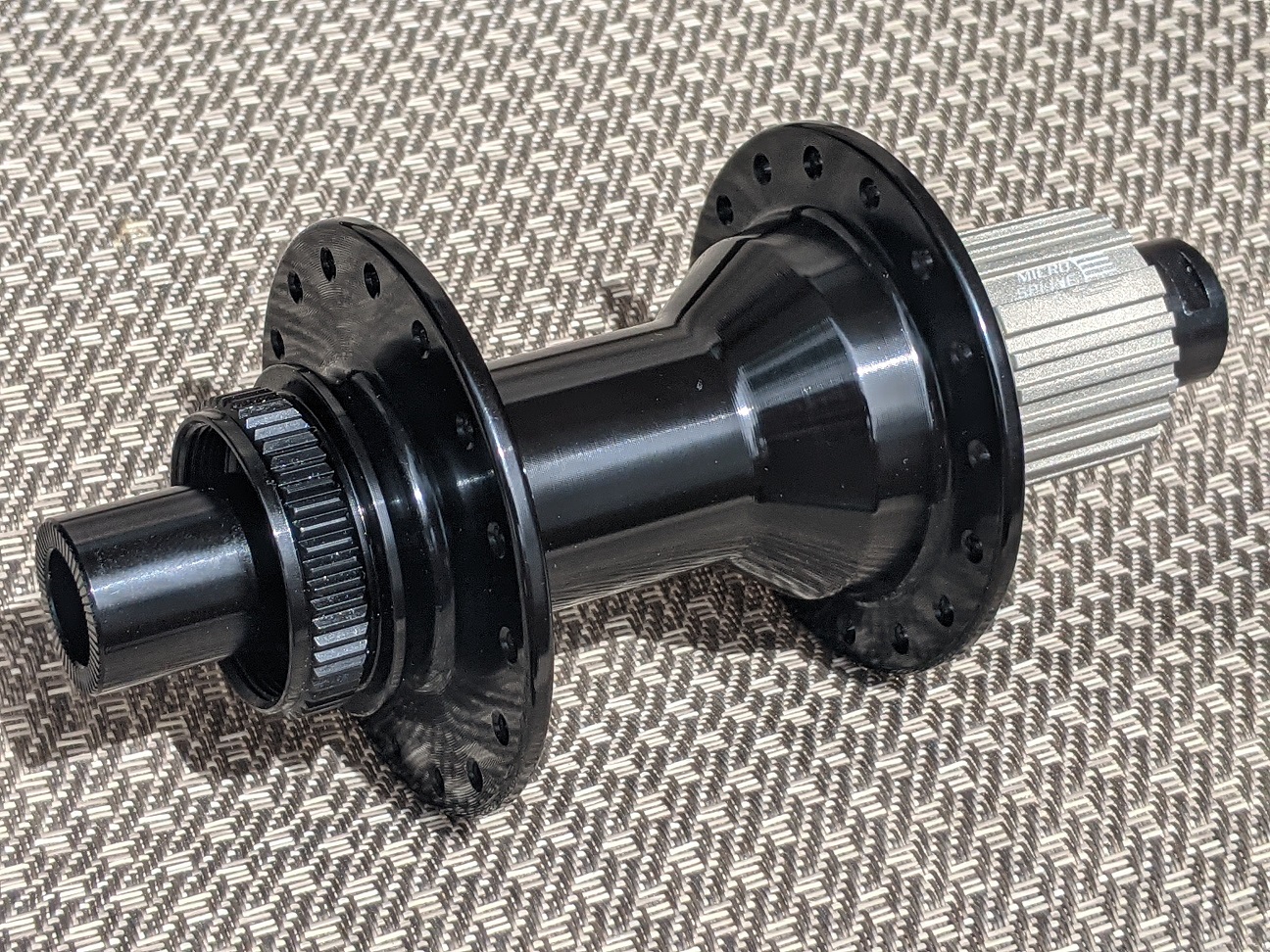

My H15 came with no-name hubs, and in the last couple rides there's been a clunk noise coming from the hub when you start pedaling after coasting. I just got back from the bike shop who pulled apart the hub. They said the notches that the pawls sit in are "ovaling out" sending out chunks of metal aka the hub is completely toast. They are filing a warranty claim.
Has anybody else with a Rise H experienced this? I read in forums that the bike was supposed to come with Shimano hubs so I was surprised to see generic hubs when I picked it up. It's disappointing that Orbea installed some apparently cheap crappy hubs. If yours came with Shimano hubs, can you tell me exactly which model? I might look into an "upgrade."

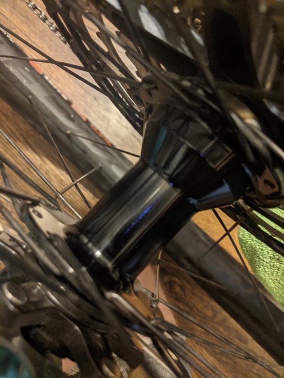

That does look a bit like the Shimano deore. But someone else posted this no name hub on here and one difference besides having no branding was a silver micro spline receiver (the Shimano is black I believe), and they reported the weight being ~200 g less than the same wheel with the Shimano hub. Who know's Shimano's direct to builder options, but I doubt they made a special silver spline version for builders. My guess is this is a no name brand like Sun or something.
Going forward, maybe convincing the shop to get you a Race Face Vault hub laced to the wheel for cost? If not the Deore is a great hub if they can install that on Orbea's dime. Just a bit heavy.

Mine doesn't have the "Shimano" word on it, so I assume it will be a Chosen Hub :mad:
Does anyone know if pawls or pieces from Shimano can be interchanged / used to repair the "Chosen" without having to throw away the full wheel in case it fails? Or are they completely different animals?

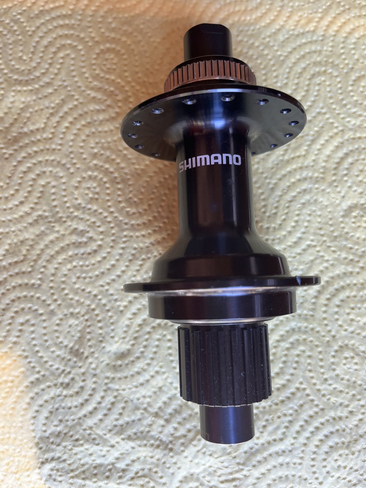

So what I am reading is that people are removing their Shimano hubs to replace with others, and meanwhile I am actually installing a shimano hub ?:LOL:
Replaced with a $250-450 hub, on relatively cheap hoops like the ARCs makes no sense. If you're going that route you might as well get a custom wheel set built or buy the RF Turbines with Vault hubs. You will very likely be just fine with the Shimano hub. I've seen complaints with the newer SLX/XT mechanisms, but from my experience the tried and true Shimano deore design is very durable.

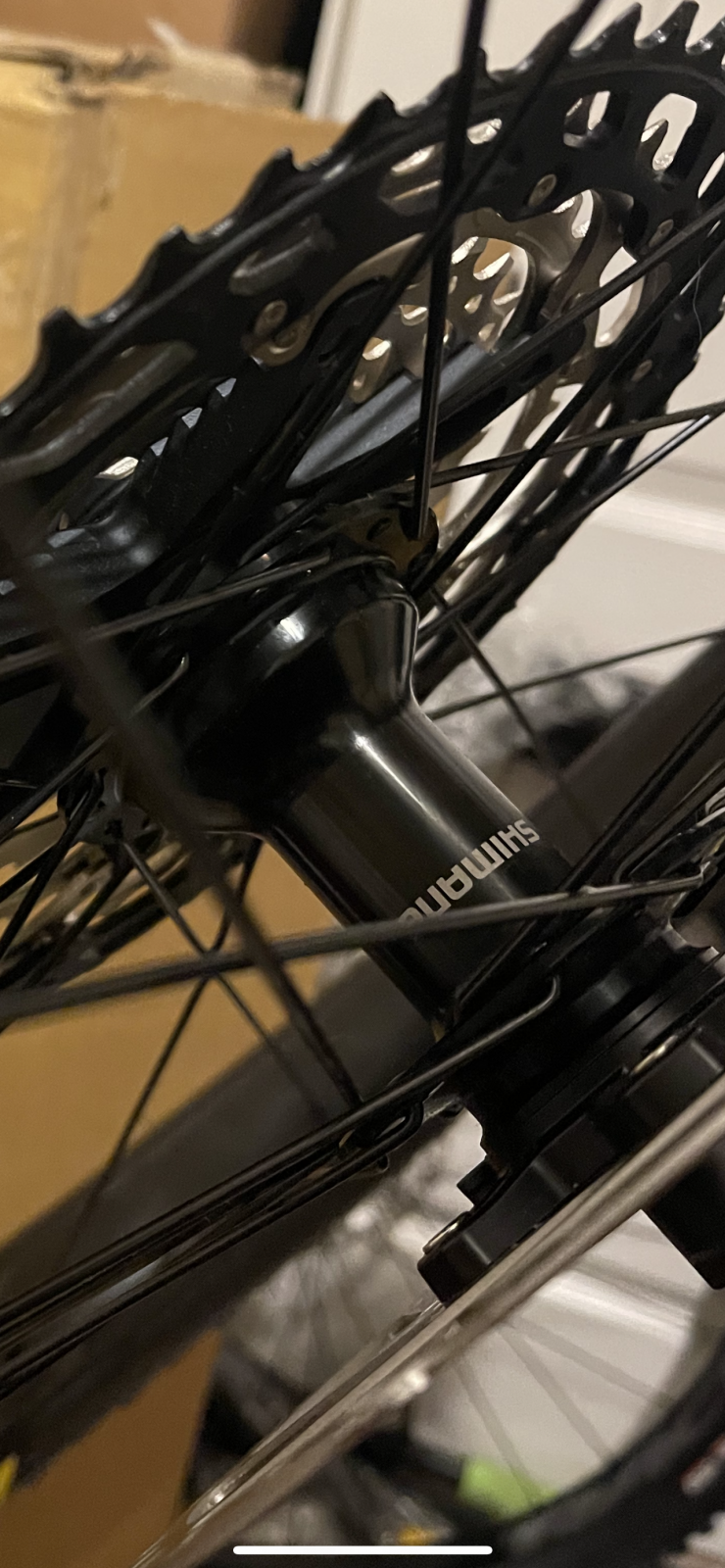

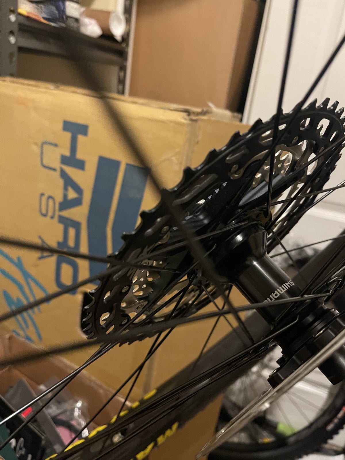

Mystery solved
@Longfellow78 see above. This is probably the hub on your stock wheel set.
Thank you for finding that out. Interesting and somewhat relieved now that I indeed purchased some handbuilt aftermarket wheels. I also guess these shithouse hubs are the reason for the significant weight saving over the stock wheels that I found. Of nearly 300g if I recall.
The stock wheels are sitting in my garage waiting to be sold along with some other stock parts.
Mystery indeed solved, good work.
