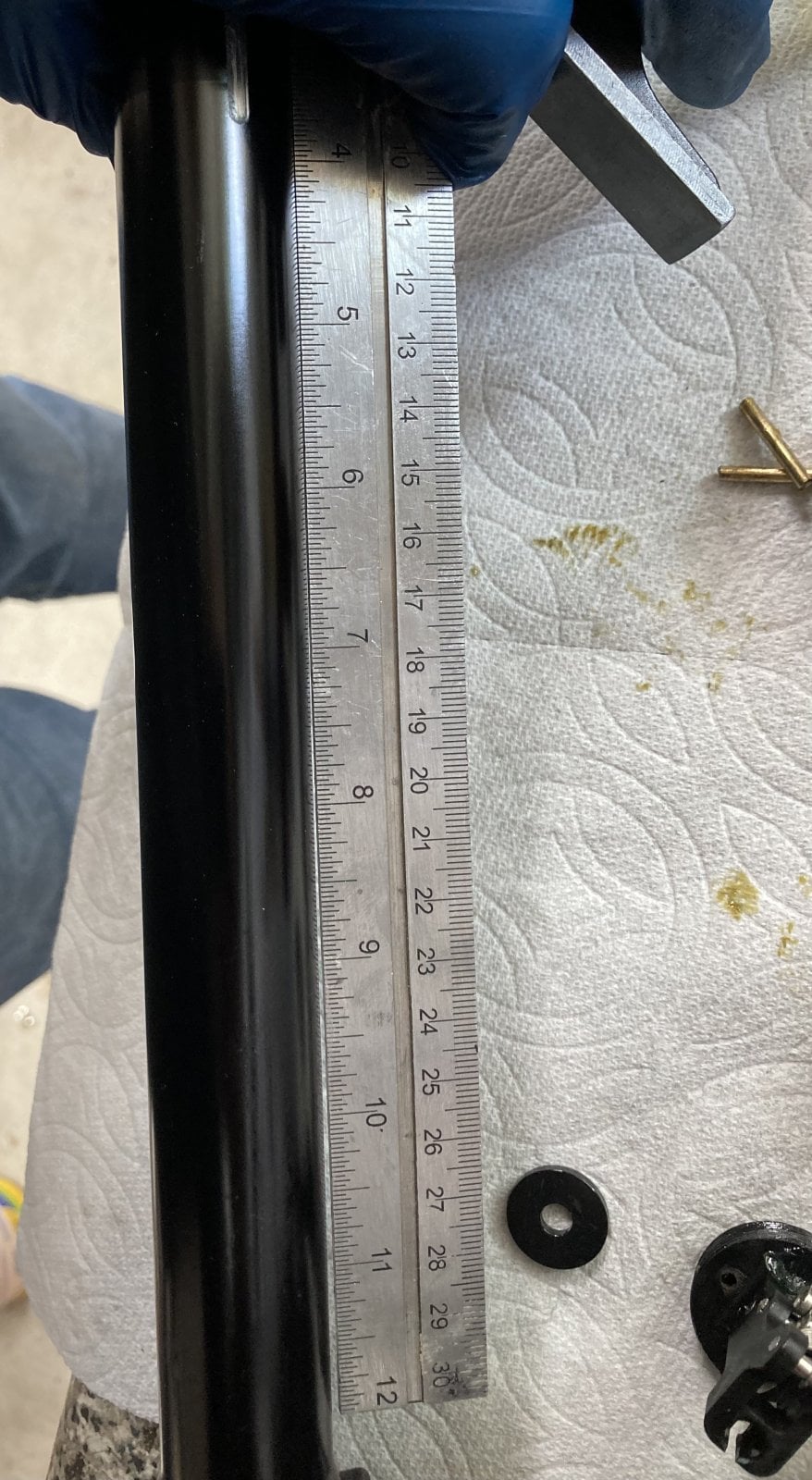

Hi all. I’m about 150miles into my Levo ownership. My alloy comp came with a xfusion manic dropper. I’m less than impressed as I can’t adjust the return speed, but the last 2 rides it’s been sticking in the bottom 1/3 of its travel. If I sit back down with the lever pushed it often comes back up but I’d like it to be reliable.
Am I the only one with issues?
Thanks

Just found my problem. Post is bent. 98.75 miles into ownership.
