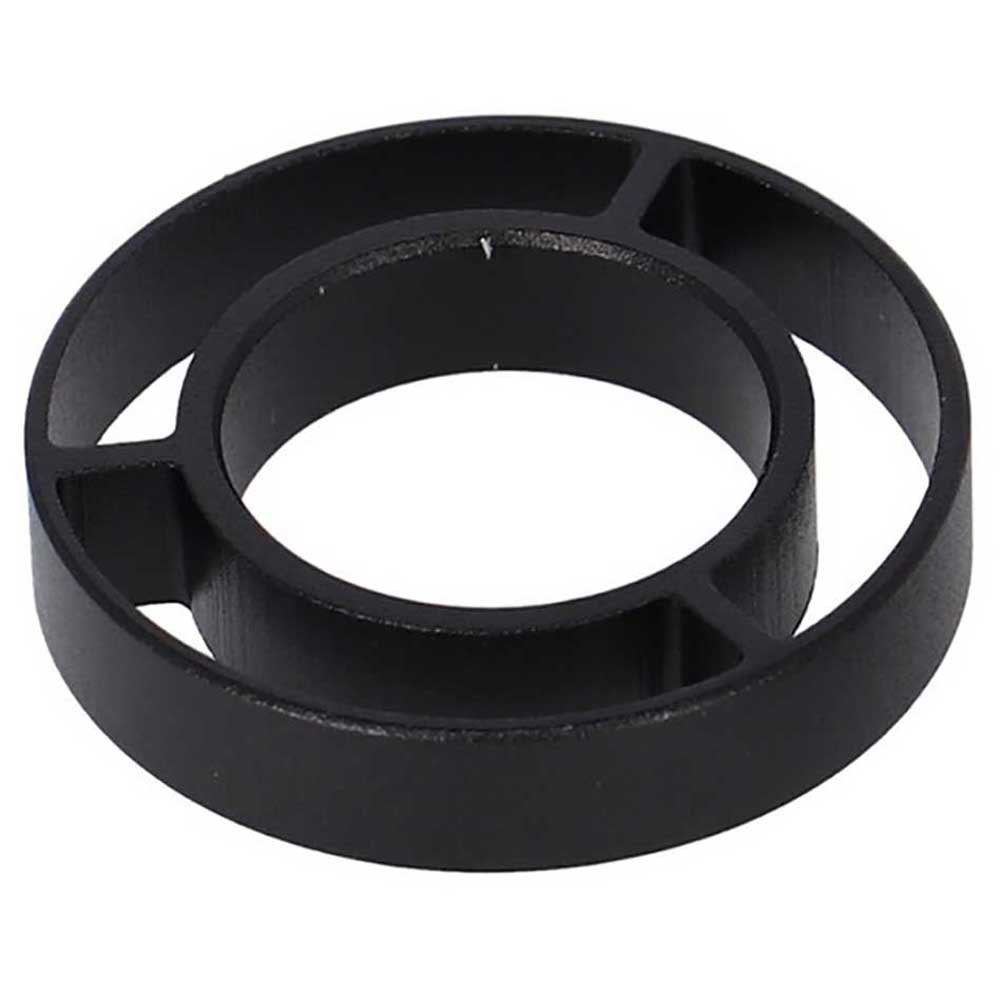

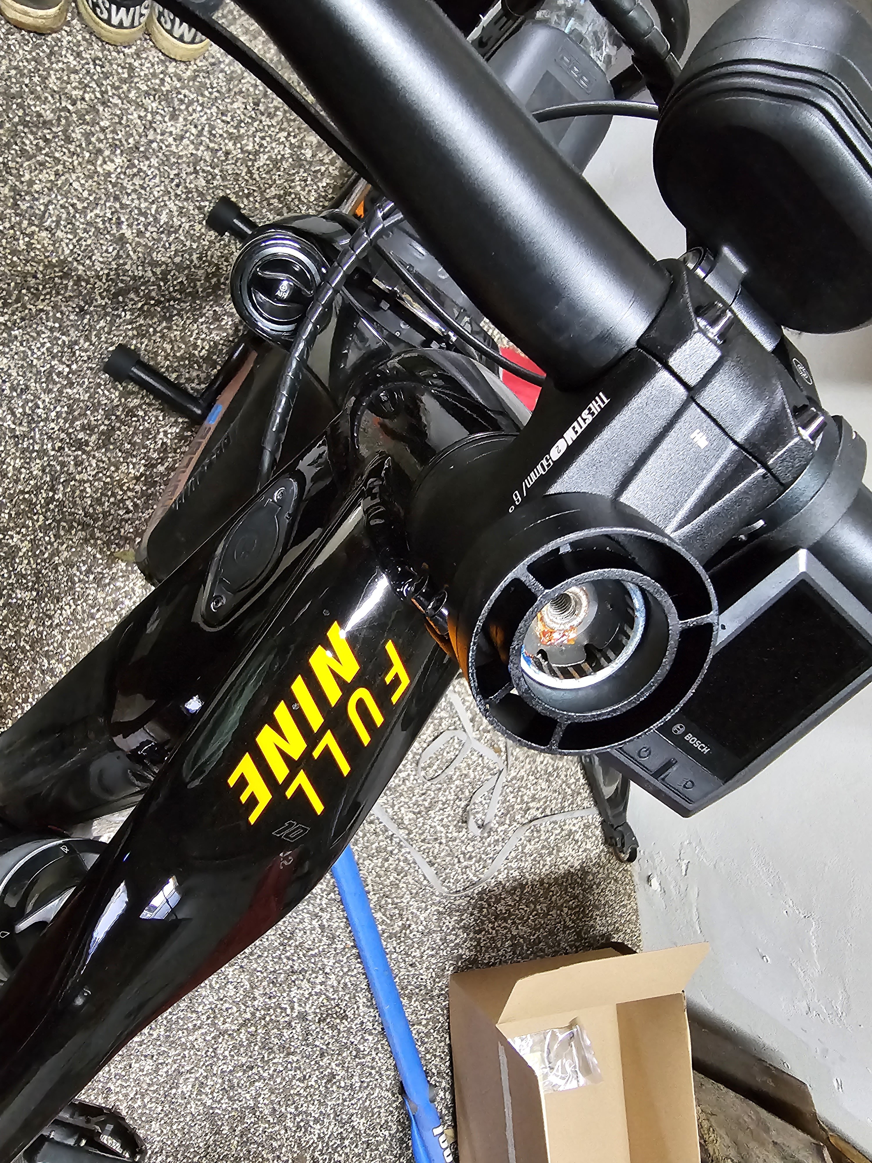

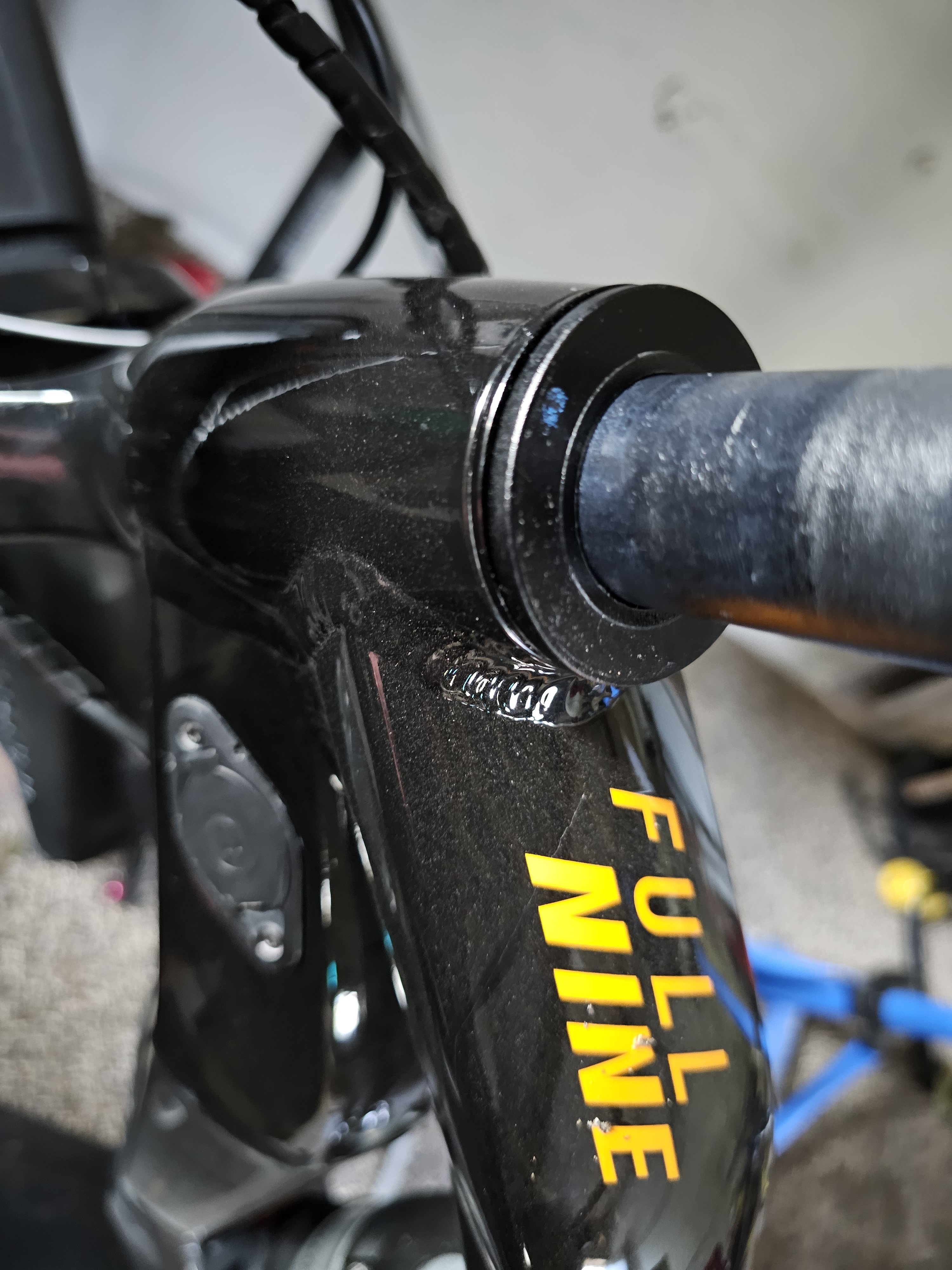

That's the thing I cant experiment with the current stem as the spacers are to big to put on top, also the stem cap has an angle
Spacers are like this

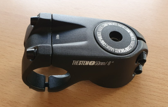

The thing is that this stem is not adjustable in height , it all doesnt fit and the stemcap has an angle that fits the stem.

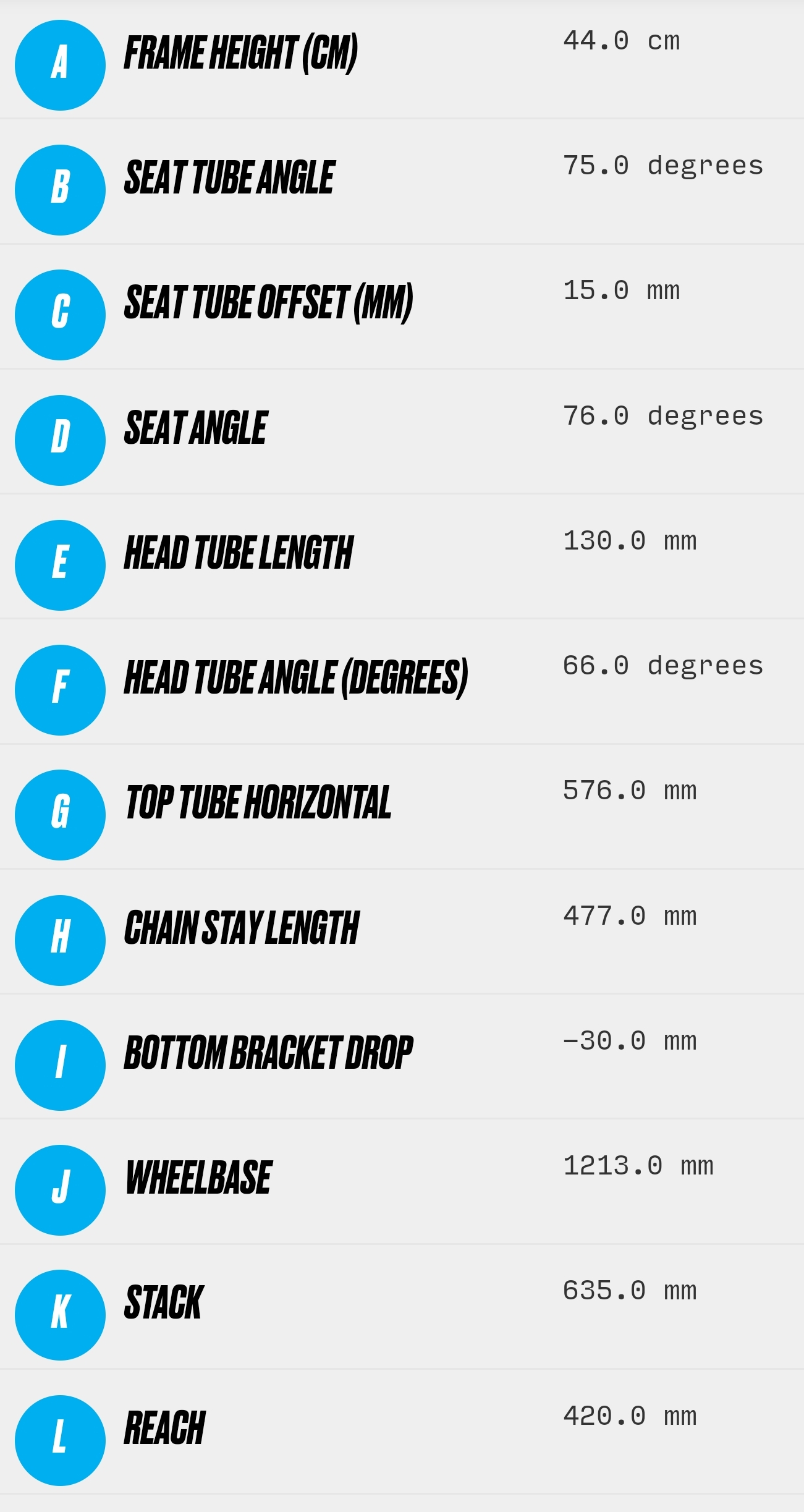

my seating position on the bike is pretty straight.
My height is 177cm, I ride a size M with a reach of 420mm . But I feel like a want a bit more reach.

The only thing unusual there, is that top cap.
Loosen the stem, lift it up straight off the steerer (if your front tire is off the ground the entire front fork is going to fall out of the bottom of the headtube), place the smallest spacer you can find between the frame and the stem, then place all of the rest of the spacers on top until the steerer is about 3-4 mm below the top spacer.
Just buy a standard top cap from the local bike shop or from Amazon. They are standard. What is weird about the your current cap you have, is that it protrudes down requiring you to run extra spacers so that the cap doesn't bottom out on the steerer, before you get the steer tube tightened up. So just ditch that top cap.
I do agree that a 420mm Reach is much too short while standing for a 177cm tall rider. They probably built it oddly short because the STA is slack and they didn't want the bars to be too far away while seated. That's one of the problems with these old school geos, you can have the right reach while seated, or while standing, but not both.

I don't think I want to use the current stem as the current spacers on top of the stem will look awefull
14,001
20,757
You should just be able to get some normal spacers to go on top of the stem - the big ones are weird on top !
Ultimately, as you're dropping the stem and moving more spacers on top (to accommodate the length of the steerer tube) you can use the existing top cap whilst you're testing.
If you're happy with things, you can bash down the star nut (which is higher than it should be) and cut the steerer down to the correct size - as you don't want excessive spacers above anyway from an injury point of view. You might still be able to use the original top cap in this situation once the star nut has descended 1cm.

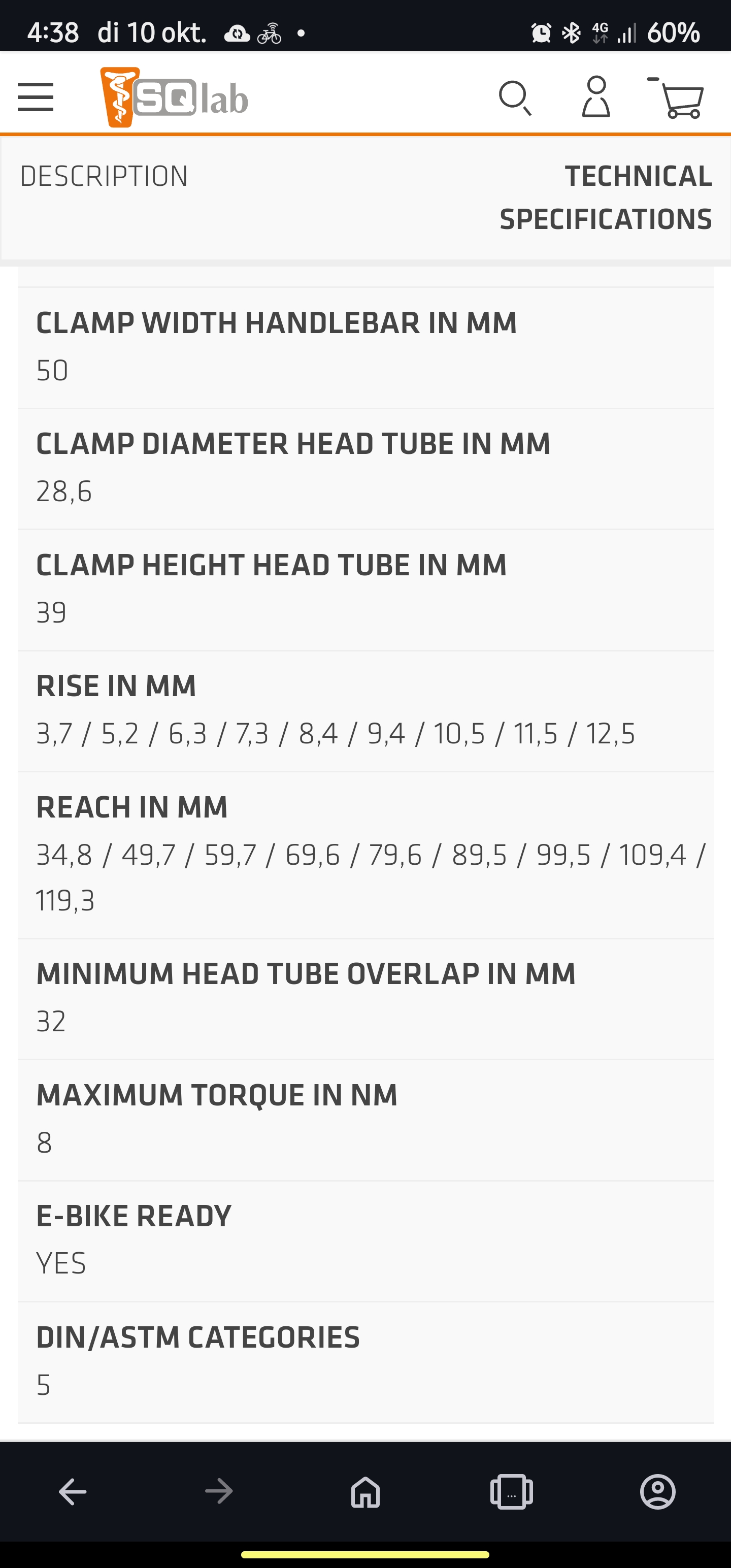

So I found a sqlab 80x stem that I want to get.
First: I don't know if I need a new upper headset for that( I don't have the knowledge of stems headsets etc.)
Seccond: the steerer tube length is 59.1 mm. How much spacers would I need and what size.
Specs of the stem:
Also dropping the stem will increase reach. But should I get a 60 of 70mm stem instead of 50mm, or just stick with the 50.

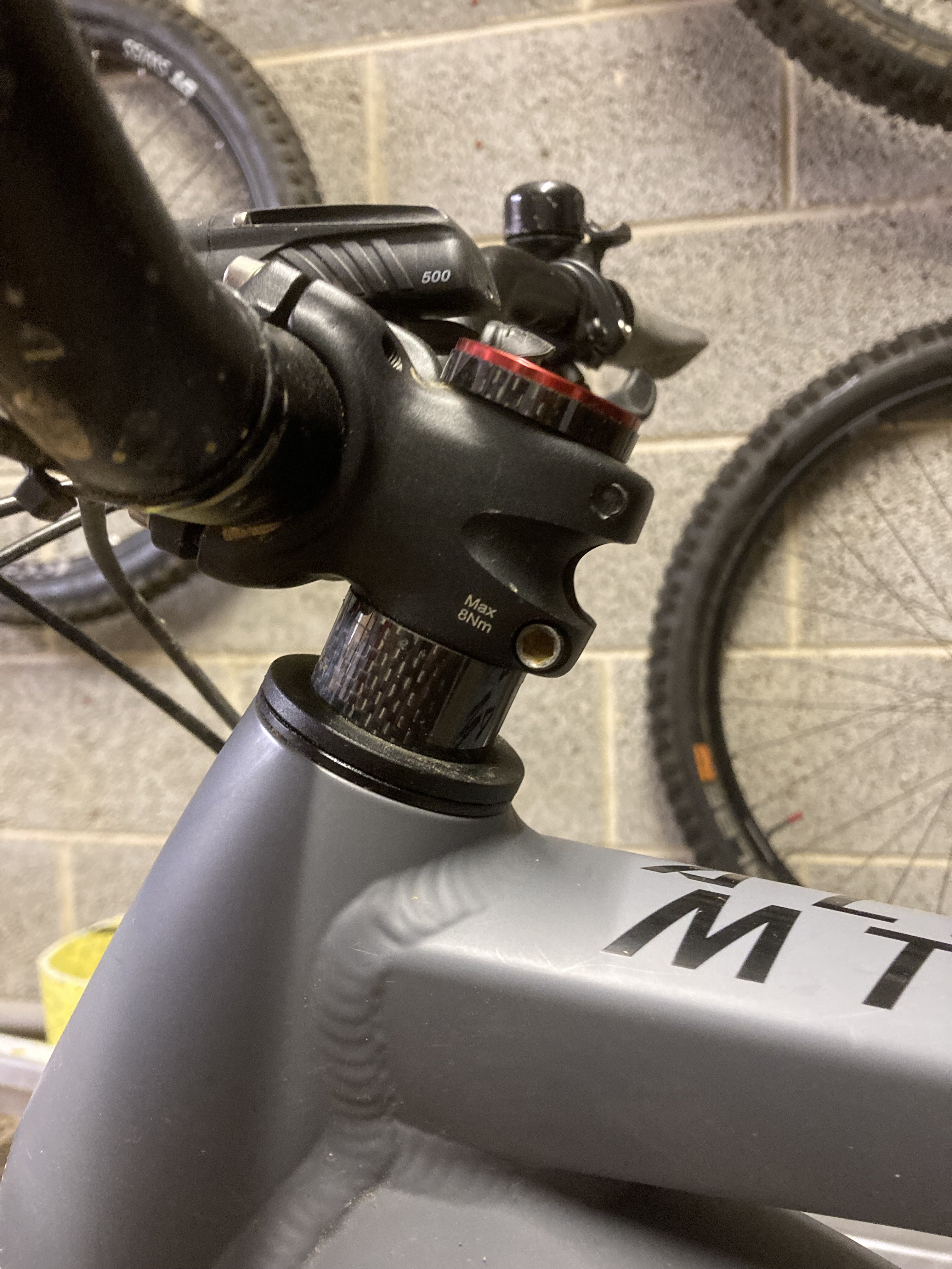

I got some 5mm and 10mm spacers yesterday. The bike feels completely different. Before I get a new stem I'm gonna try out this one on different configurations.
Is this stem cap safe enough to use on spacers?

The top flange on a top cap is usually flat not wedge shaped, I'm guessing it is that shape because of the shape of the top of the stem, I assume the thick side faces forward? If so the flat mating surface on top is recessed and you'll need a suitable spacer (not one of the wide ones) underneath or it will load the headset bearing unevenly. If that works then the cap should be fine but might look a bit odd.

Hello, I have two Haibikes and I put longer stems on both of them. This Haibike stem doesn't have the top seating surface perpendicular to the fork post, so the spacers above the stem won't seat straight with their entire bottom surface, it will flex and not have the needed strength, which is wrong. The stem cap has an inside diameter smaller than the inside diameter of the spacers, which makes it difficult to center the cap. Because of the cable I had to use a PRO Koryak Di2 stem
If you plan to use standard spacers, I'd suggest to get a stem with a flat top, and use a regular top cap. Basically use only compatible stem, spacers and top cap components.
Some time ago I fitted my Moterra with a new stem from Hope and used standard spacers and top cap from Wolftooth. Very happy with this setup.
Good point, I suspect the top seating surface on the OP's stem is flat and parallel to the bottom (why would it not be?) but is recessed which is why the top cap is wedge shaped, to fill the recess neatly. If a spacer won't fit in the recess then, obviously, you can't flip the stem as it won't seat correctly. The top cap is there to preload the headset bearings and once the clamp bolts are done up tight should not really be necessary. That said I still wouldn't ride without one.
Just to make it clear I was suggesting trying inverting the stem to test the riding position not as a permanent solution.
