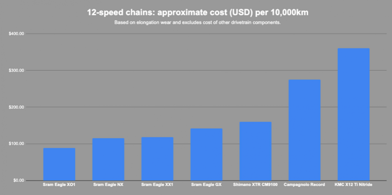

Here's a link to chain test Finding the best bicycle chain: What over 3,000 hours of testing revealed - CyclingTips

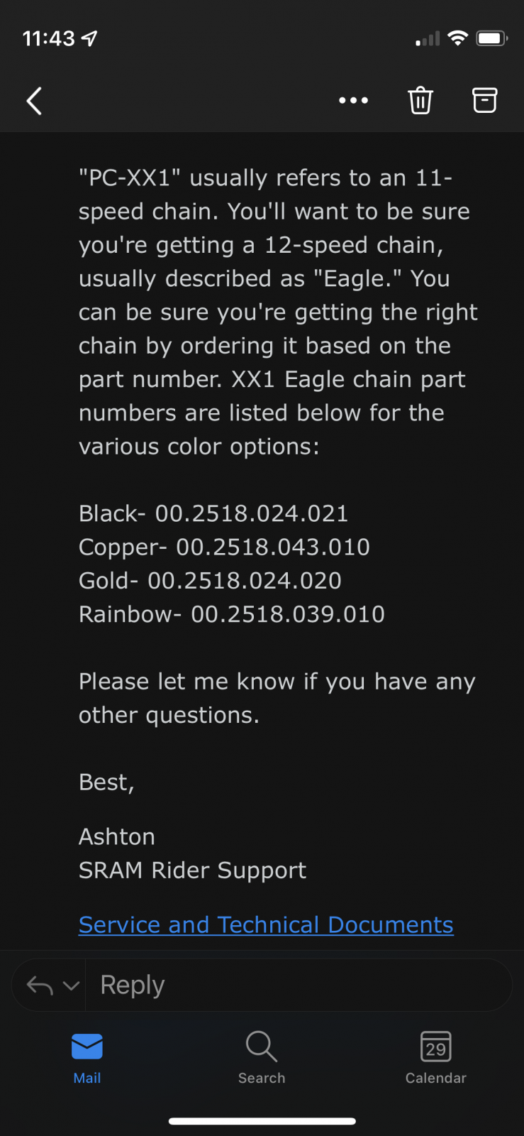

Now who knows what the “PC” stands for in some listings of the XX1 chain.

You sure are an advocate for the inferior GX chain. Thanks for your feedback, but I’ll be going with the XO1 or XX1 chain. Every test shows the higher end chains will outlast the GX chain by about 2x.
I’m betting you will comment again trolling this thread that you don’t care about facts as shared in post #10 and how the GX chain makes you go 35mph. Do us all a favor and preach your GX chain theory somewhere else.

Im pretty sure PC stands for Powerchain; the difference, I believe, is the Powerchain’s have chrome hardened rivet pins.
