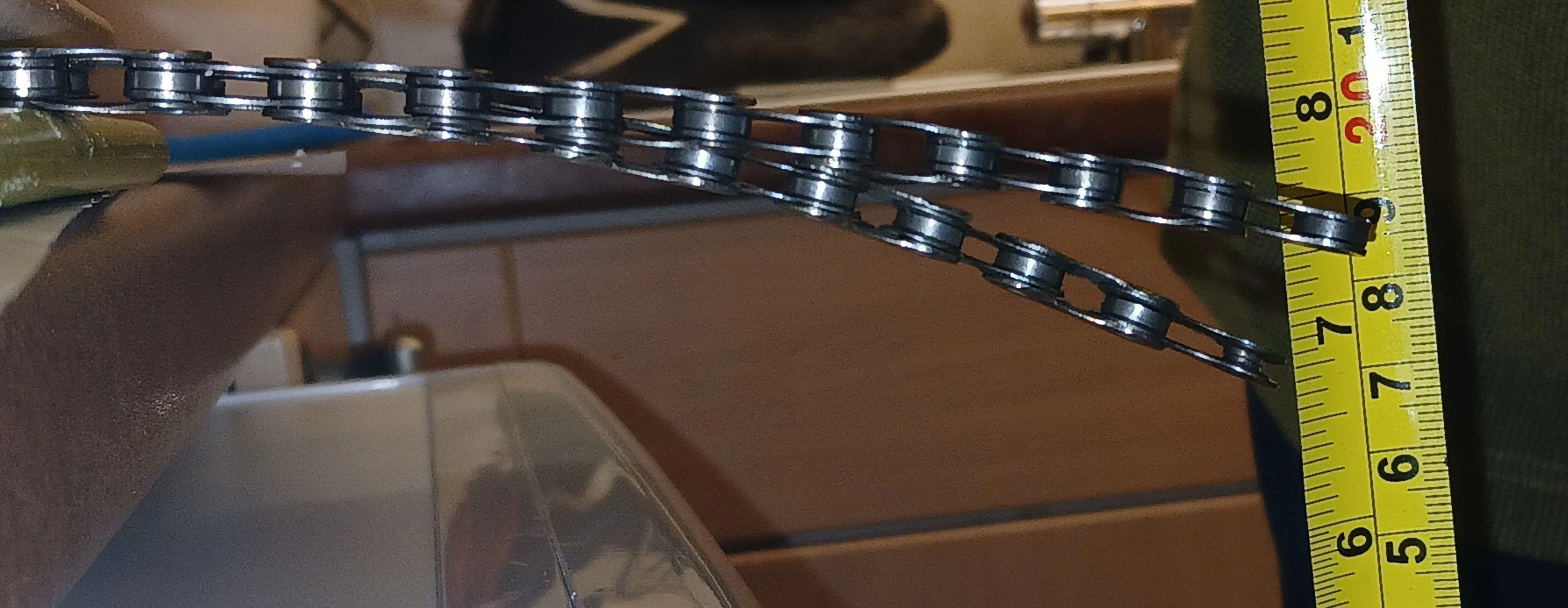

The difference being a T type chain rollers are a larger diameter than on an Eagle chain but the pitch is the same.....so only the T type chain checkers will be accurate on a T type chain
and there is no official chain gauge from sram, only one for eagle and below. go figure why
--> you are supposed to run the system to the ground
apart from Park tool CC4.2, or Pedros chain Checker, or SRAM's CHTL8058000
these measure the distance between the backside of 2 rollers rather than between 2 rollers...hence the thickness of the rollers makes no difference to its measurement.
the first 2 are 3rd party (hint: no official SRAM product), the CHTL8058000 is for all SRAM chains that need to get changed after 0.8% elongation (hint: all chains but t-type)
