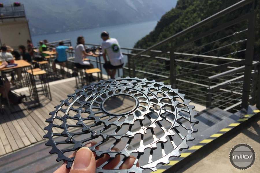

You can change the big ring on SRAM 11 & 12 spd cassettes, you may be able to do the same on EX1.
I'm pretty sure the big four gears are machined from one piece of hardened tool steel, it's the four smaller ones that are replaceable individually :rolleyes:

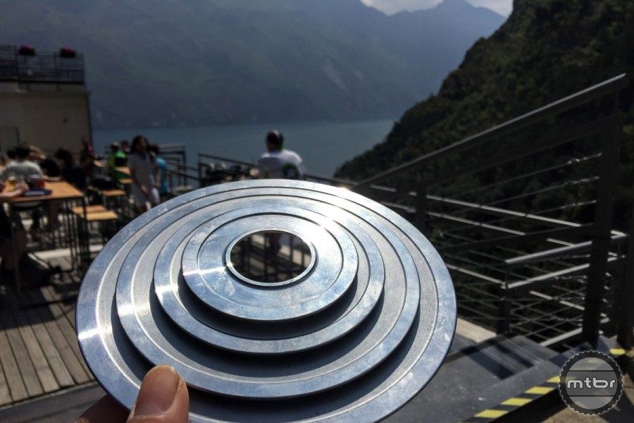

But I will check :D
Japuserid
Jan 18, 2018
293
252
Cornwall, UK
:eek: you can kind of see why its so expensive, a lot of work in that....
