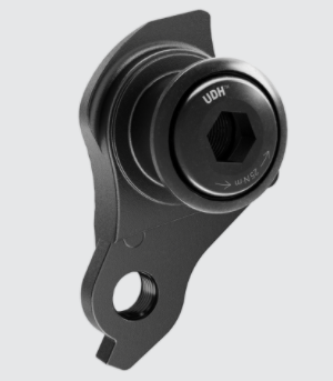

Levo Gen 2. Levo SL Gen1 Not compatible as not UDH - your bike needs to look like this :

Levo Gen 2. Not compatible as not UDH - your bike needs to look like this :

If it is it will literally say “UDH” on the hanger.

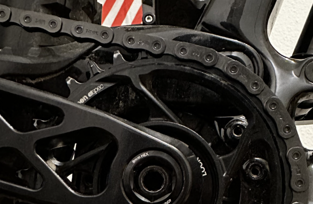

I am running XO transmission on Trek Rail 5 with original e13 chainring which has a 52mm chainline, rather than the recommended 55mm
Neither the chain ring or the chainline are causing any problems as far as I can tell
Having said that I will order a SRAM T-Type chainring as soon as they are available to make sure it is running the best it can
I do have an installation problem in that I need to run a lot of micro adjust, I suspect this is due to the wheel hub rather than the transmission. I have a Hope Pro4 hub rather than the Trek original. I will report if I work out what is wrong.
Also I asked e13 if their chainrings are compatible with T-Type, they said they are still testing

As long as the Hope hub is the correct size, it shouldn’t matter.
Hmm, if the Hope hub is correct then the SRAM derailleur is way out (about 1mm)
I don't think that is likely, I expect SRAM calibrate it in house to much less than that, each micro adjust is about 0.2mm so it should be accurate to that.
Fortunately the Hope hub measures wider than it should be (about 148.6mm) so the derailleur is probably close to nominal and most of the error is in the hub.
I am trying to work out why, it could be that I have the wrong end cap since I had to change the free hub from Shimano micro spline to SRAM XD which requires a new end cap and I couldn't find a definitive answer to which end cap was required, I am waiting for an answer from Hope.
In the meantime I can run it with the necessary micro adjust so all is good other than not knowing why it is out.
I need to know!!

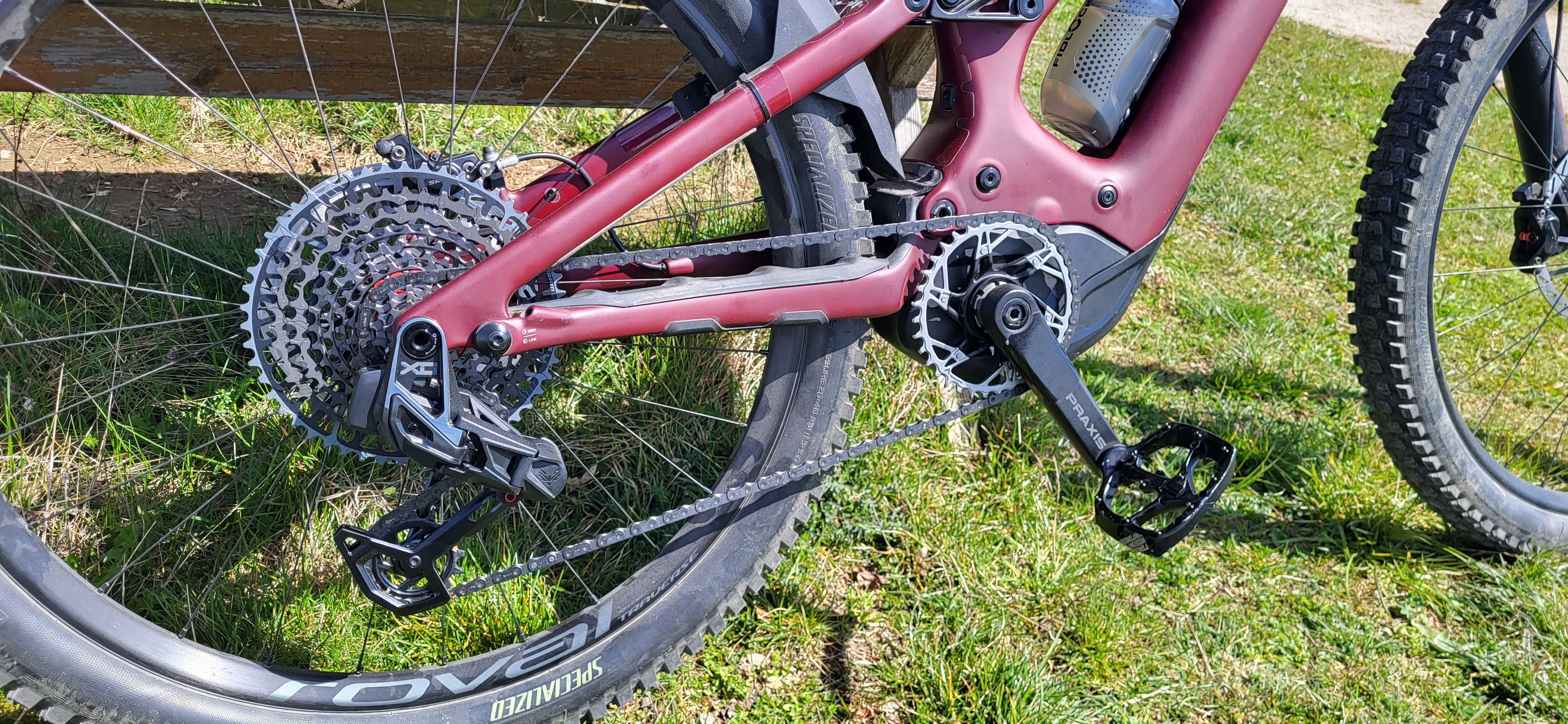

Installed XO derailleur, XO cassette and XX chain on my Gen3 Turbo Levo Pro. Still running stock chainring due to lack of availability. Everything seems to work fine despite supposed incompatibility of chainring.

Yeah really the only requirement is UDH which is basically the majority of any modern bike.
