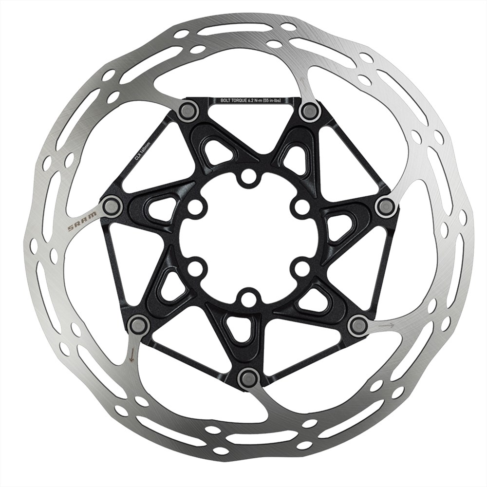

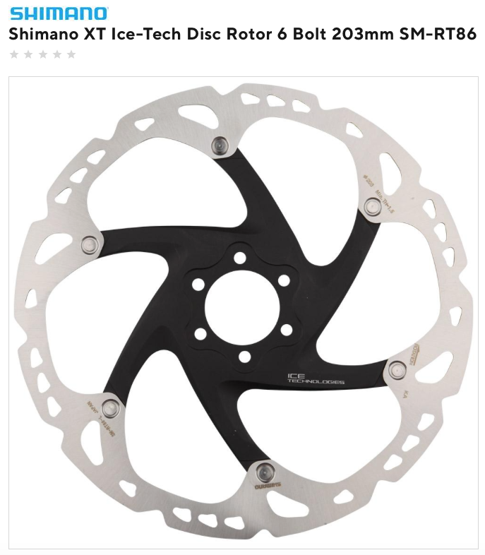

I don't have a squeal/honk issue on my bike. But I did have an irritating intermittent Zinging sound coming from the rotors. The brake system is a Tektro Orion 4 Piston set. Definitely not the pads or anything else other than the 203mm Tektro rotors would resonate every time it glanced lightly on the side of one of the pads while coasting.
I was able to solve the problem by changing over to Avid rotors (I already had those). Didn't touch the rest of the system, just the rotors. The Avids still glance the pads on occasion, but it doesn't zing. Resonance frequency is different.
If that didn't work, I would've tried the Shimano XT Ice Tech rotors next. The 6-bolt flange/spoke centre is aluminium with a steel rotor ring riveted to it. Aluminium should vibrate differently to the steel ring so they should cancel out their inherent resonant frequencies and act like a vibration damper - well, in theory anyway. I almost had wished that the Avids didn't solve my problem, because I really like the look of the XTs.

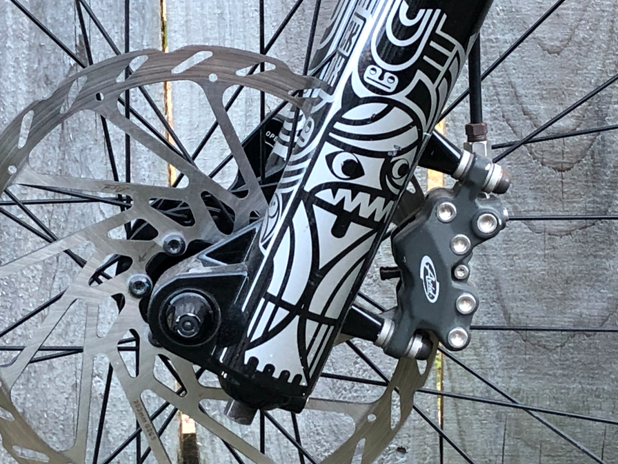

Back in 2006, I bought a free ride bike with possibly the earliest Avid CODE 4-piston brake kit (before they became SRAM)... I still have the bike in storage. If I pulled hard with one finger on that it will lock-out a Maxxis HiRoller even on pavement. Depending on where you put your butt beforehand, it'll either flip you OTB or flat spot your tyre. At first it's terrifying, but then once you get used to it's power and adjust your finger pressure (just light pulls), it's very very controllable and the modulation is superb. If you look at the two halves that make up the caliper block, they are held together by four bolts (the Tektro only has two). I could be wrong about this, but I was always under the impression that the pads are pressed by only two pistons to begin with, followed by the other two (in fact I'd laugh if there were 6 pistons in there - I've never opened it to find out). It's always been my benchmark when it comes to brakes. I guess I mentioned this because my appraisal of any brake system is always going to be tarnished because of how much I love this thing.

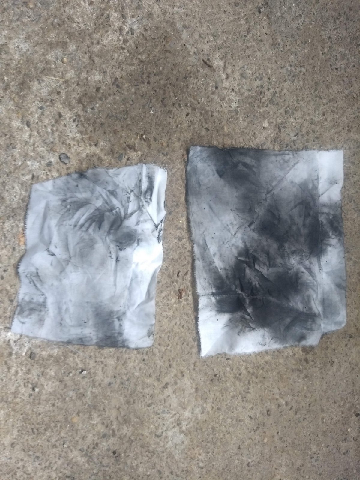

It's been a couple of weeks since I tried the cleaning and sanding .. so as we're starting from "simplest" again .. I thought I'd give it another go and be a bit more thorough ..
Started with @GrandPaBrogan's minimum contamination system, stripped naked and used White Vinegar to clean the disks .. Quite impressive what came off when you consider I cleaned the bike yesterday.
Right cloth, both sides like that, first clean. Left cloth, both sides, second clean ..
Vinegar is your friend ..
@outerlimits & @Rusty probably uses it as a nice after dinner digestive as they chat on Skype about the good old days of cast iron frames..
Stripped and cleaned the pads and calipers. Sanded the disks and calipers with 150 this time instead of 800 last time.
So will go for another drowning session later, try to bed them in again and see how we get on.
