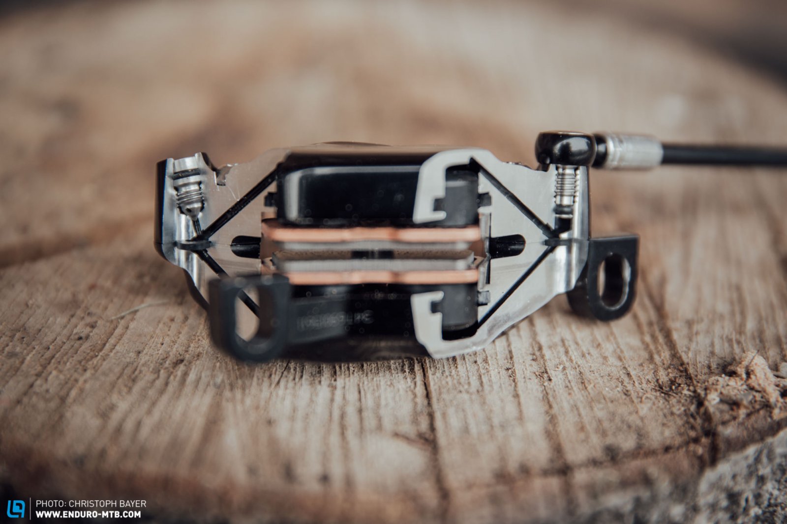

And just because : the inside of a Code R.
