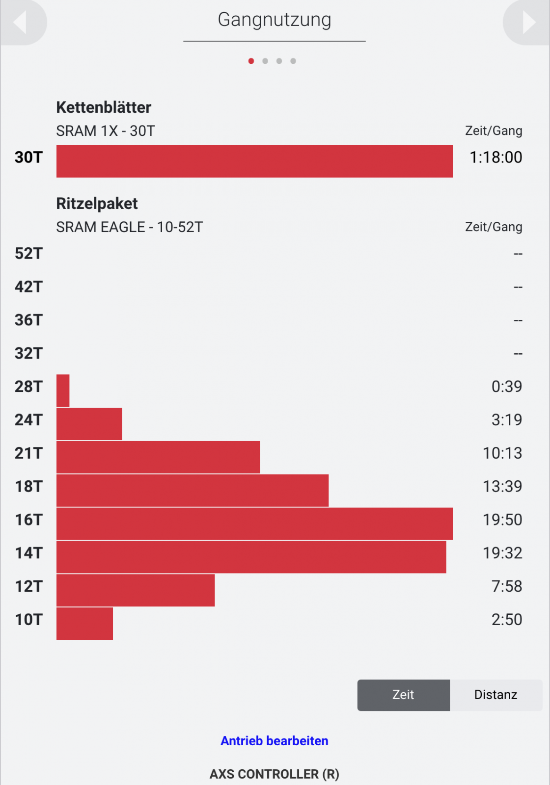

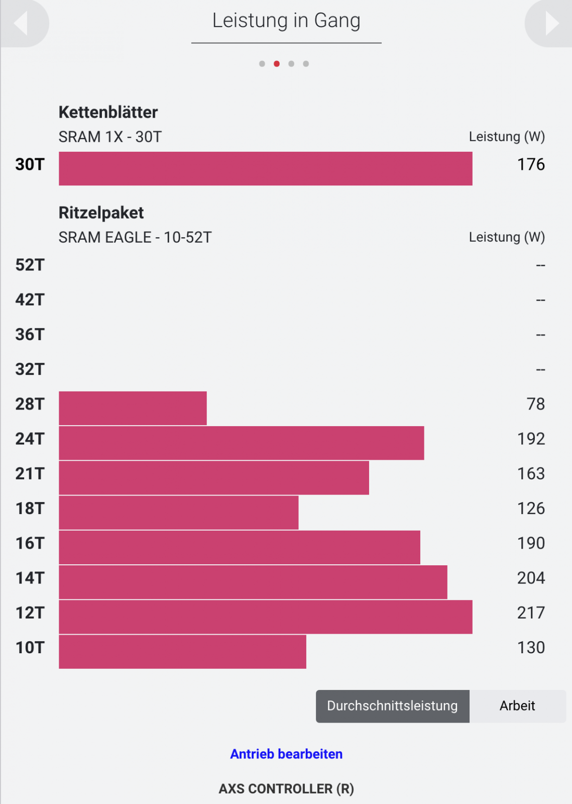

If you are a big data geek, then maybe the AXS shifting is quite interesting.
For this ride, I could also use a bigger chainring ;-)

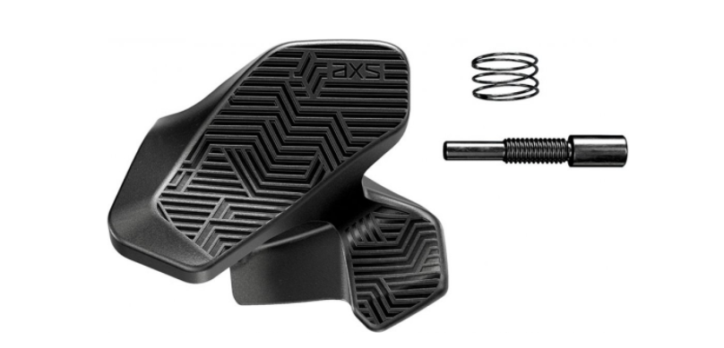

But the actual feel vs cable, personally I think cable still has the edge. I think with a more ergonomic shifting paddle and some tweaks to the feel of the actual shift (maybe with some haptic shifting feedback?) then it'd be close to perfection *(other than cost).
There is a new paddle available based on the traditional lever positions through obviously it doesn't change the 'clicky' feel;

This is great data. I looked on mine but it didn't record. Can you see more than the last ride? I'd be interested how much you use the 42/52t
so far, I did just 3 rides with the AXS and can see all. But I was using a Garmin Edge 1030 during the ride. The AXS is connected via ANT+. Then my Garmin Account is paired with the SRAM Account.
Here is a howto but in German: ▷ SRAM eTap AXS Test » Connectivity der el. Schaltung
I hope it helps.
BTW: During this three rides I never used the 42 and 52 :confused:
