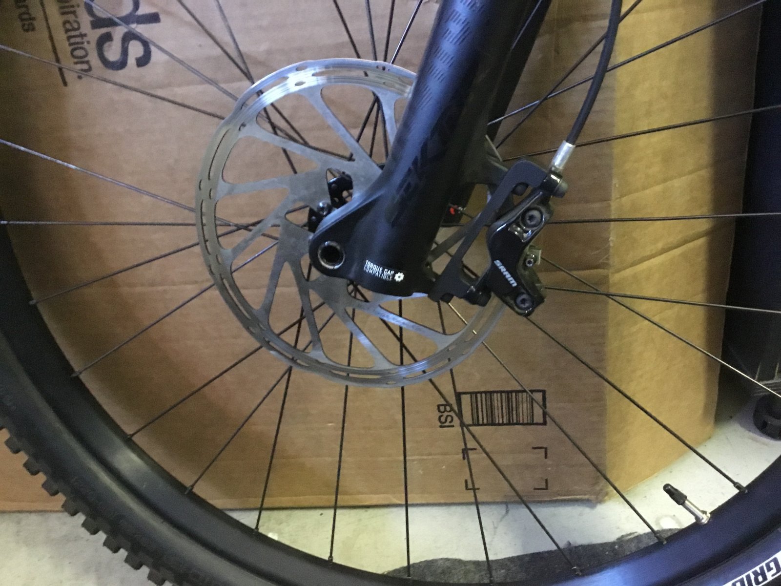

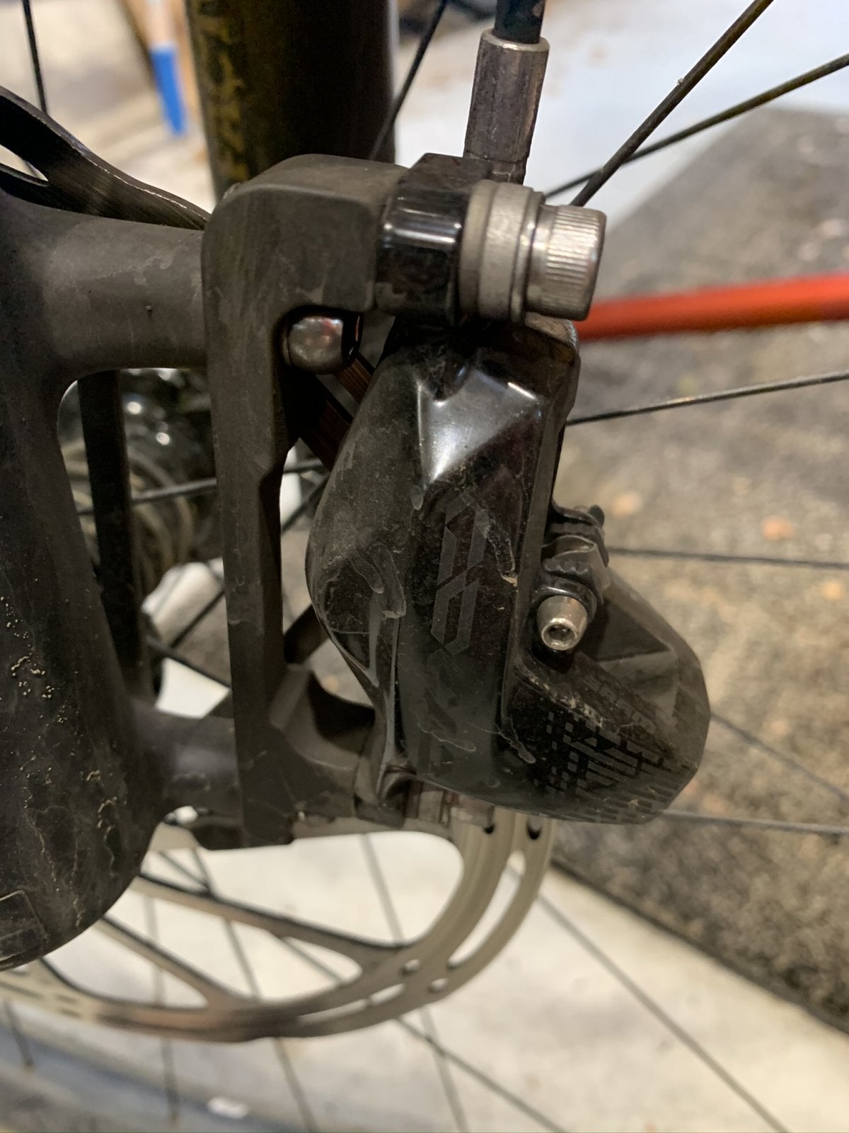

Here is my setup. It is working just fine but there is a chance that I have not installed it correctly. One pic shows the adapter I am using. Note that there is another type that just consists of spacers. The rounded head bolts came on the bike. The knurled bolts are the 30mm M6. The other pic shows that the 30mm bolt just fills the threads on the adapter. I only have the cupped washers on one side so 30mm works for me. With cupped washers on both sides 35mm may be correct but the spacing to the rotor may not be correct.. Since the bolts are lock tighted in I did not want to take things apart to measure the length of the original bolts.
Let me know if I have screwed something up.

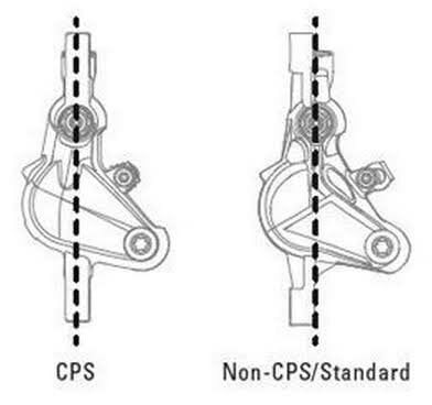

Huh, this now confuses me even more. AFAIK cupped washers should be on both sides of caliper holes (to have proper caliper to rotor aligment function) but from your picture it looks like the radial position of the caliper is about right (judging by traction marks on rotor) and adding washers will probably lift the caliper too much. Did the S-Works came originally (with 20mm adapter and 200mm rotor) with cupped washers only on one side? If yes, then your 220mm assembly is apparentelly spot on, but I guess mine will need washers on both sides of the caliper (I have TL Comp 2020 with Guide RE calipers) as I now have them with original 20mm adapter.
EDIT: Just found hi-res photo of S-Works and it looks like cupped washers are only on one side ...
looks spot on to me!cheers buddy ?my back calliper on my new sx meta power has as similar mounting as yours though that doesn’t have the cupped washers.

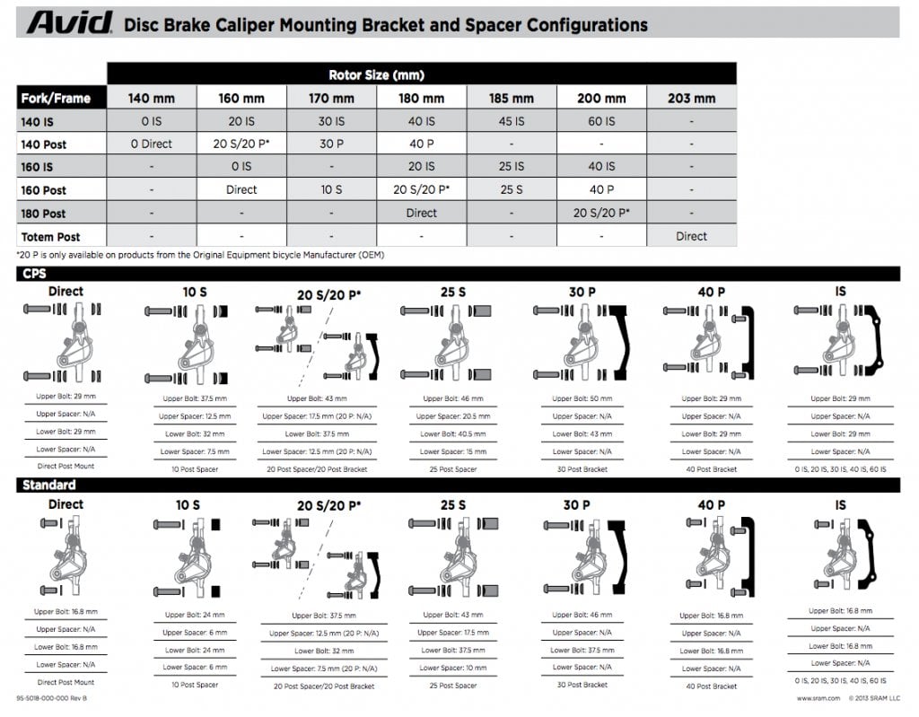

Much more confusing indeed :ROFLMAO:
Luckily I have just came across this SRAM CALIPER MOUNTING SPECIFICATIONS document, which nicely explains all my and maybe even your questions about which adapter and bolts are right for your SRAM brakes ...
Brilliant find buddy?
Mine was originally the 20p mounting (the same as teds original setup,the 40p shows like teds but without the cps washers so I suppose amalgamation of the two teds setup is right,looking at these cps washers though there only for if the bolt isn’t square to the mounting face it’s fastening too,I’m going to do the same as teds setup but try without them after without..as my rear 200mm frame mount is the same as 40p in the illustration ?

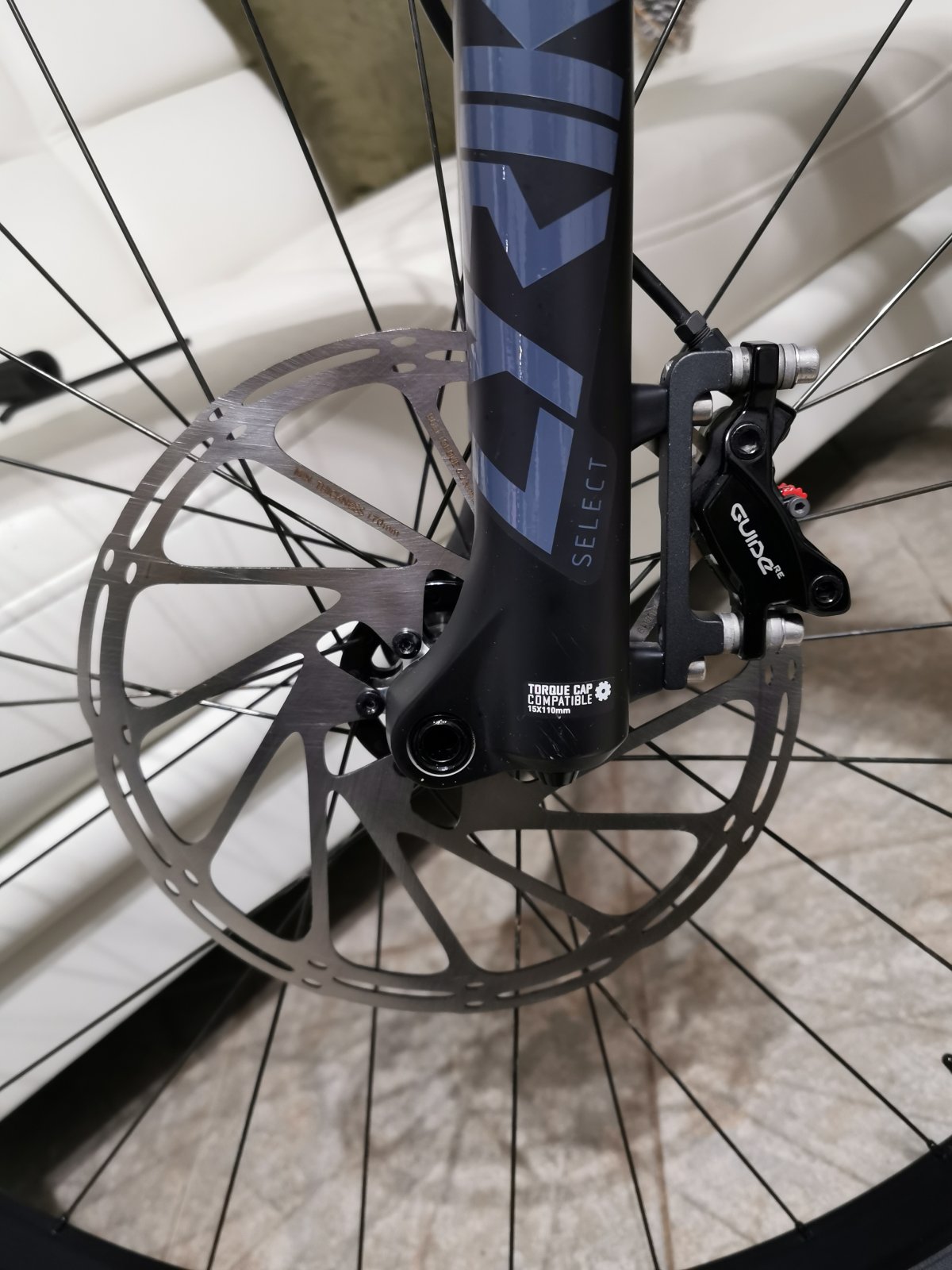

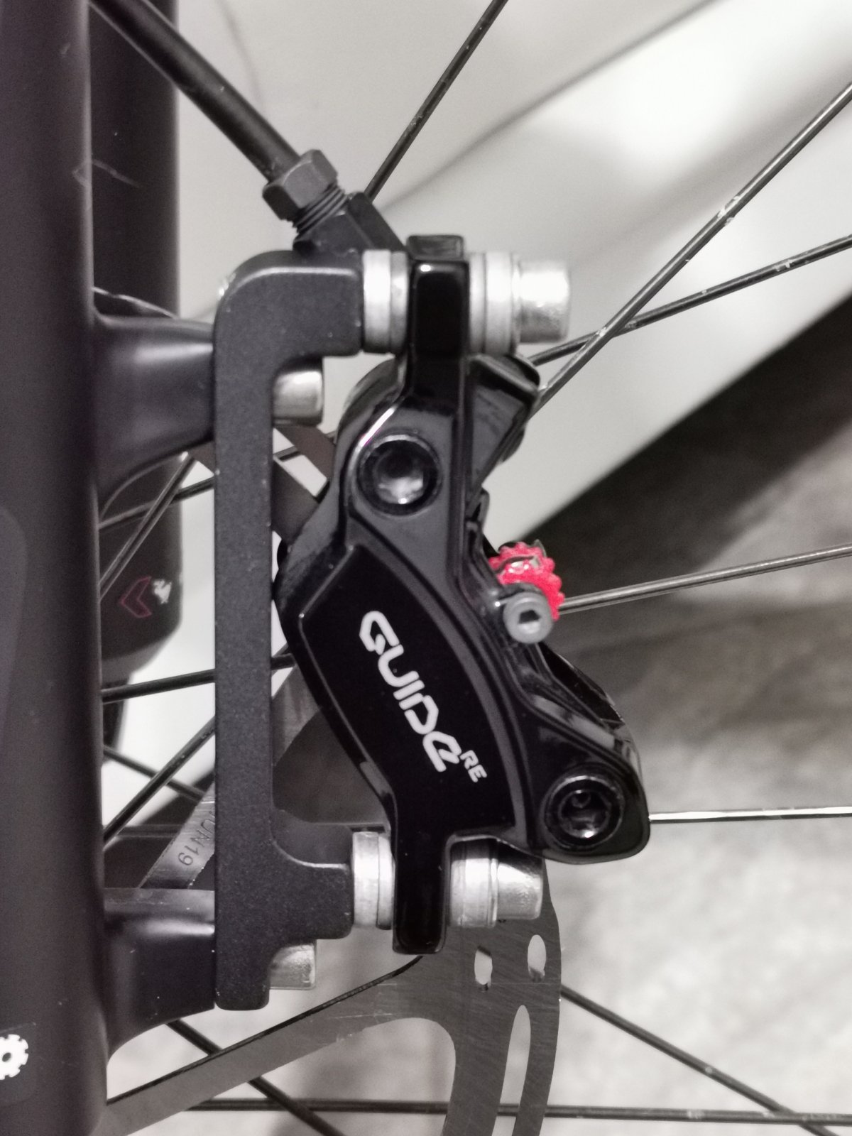

Today I finally upgraded the front rotor to 220mm. Used two stainless steel allen head M6x20 bolts to mount adapter to the fork and two M6x35 bolts (also M6x30 is enough per specification, but 35mm nicely fills the hole to avoid mud to go in) to mount caliper to the adapter, usage of cup washers is requred for Guide RE (as per any other CPS caliper) as you see even with washers the caliper body touches the middle of adapter ... Also replaced the pads for organic Kool-Stop pads. Today I only bedded-in the rotor, tomorrow is the first ride ....
View attachment 23670 View attachment 23671
Nice work!nothing wrong with a snug fit?

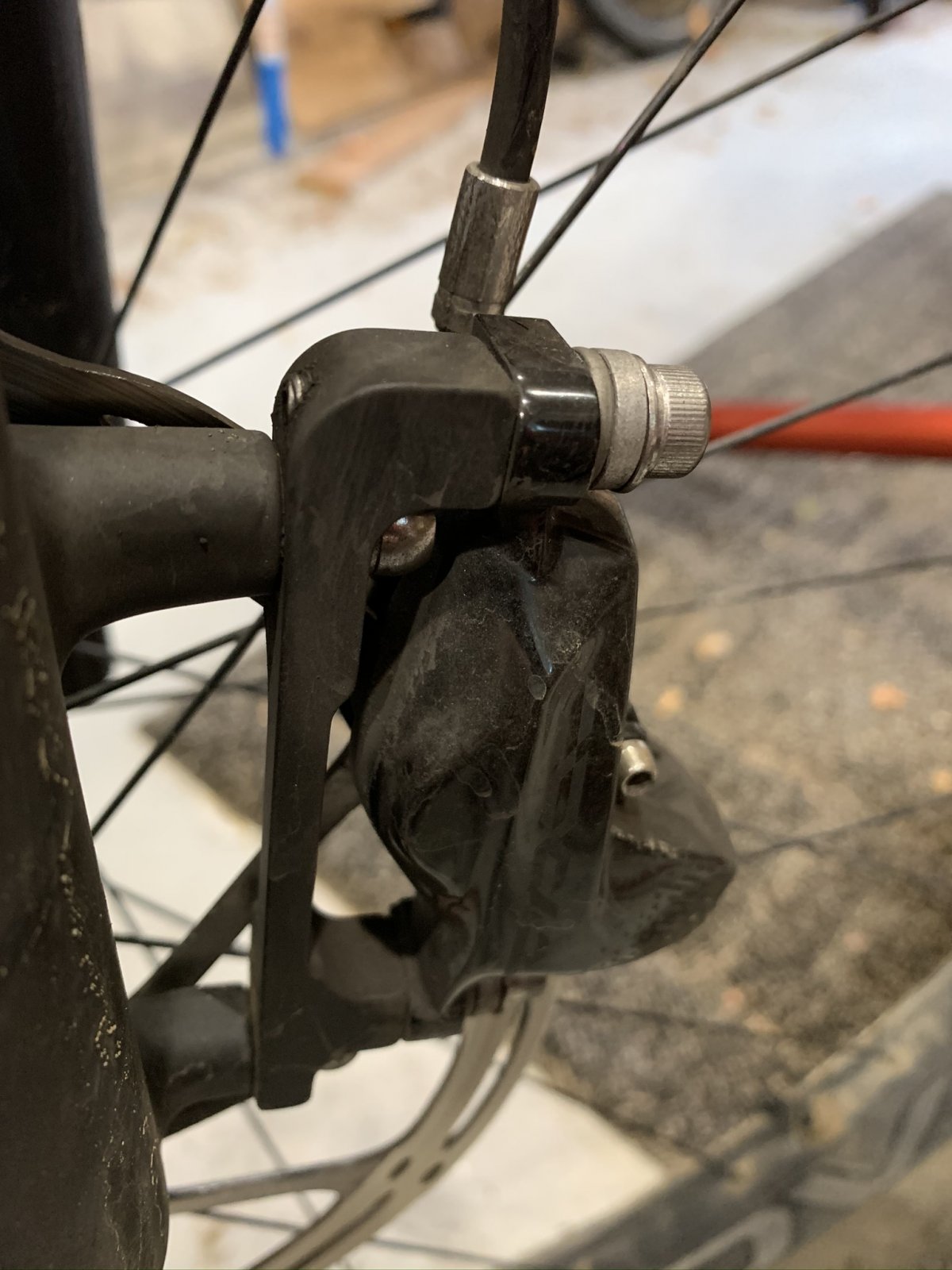

I have a 2019 base Levo with stock fork - pic attached. From the way I am reading the thread, I should not need anything other than longer bolts as I have no cup washers or spacers or will the caliper hit the adaptor? Thx
9,190
I would check with Rocksox that the Sektortor can take a 220mm disc - it will physically fit, but I would check the fork is rated for it, even on my Lyric Ultimate I immediately noticed that the extra power of the brake with a 220mm rotor causes the fork to flex more under heavy braking
Looks like you already have the 40p adapter on you’re Caliper running the disc you have now as the fork mounts look shorter,I’m sure you’ll find some spacers to bring it out though.?
