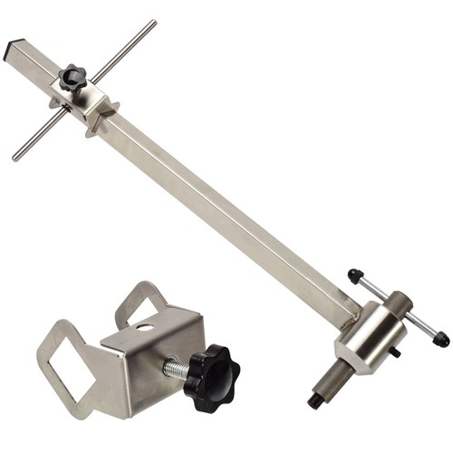

Just googled the hanger alignment tool, I can make one of those if I figure out how it's supposed to work. Also that won't help with a bent derailleur though will it? Because I suspect mines a little bent somewhere, and not the lower cage.
Watch the video on how to use it and all will be clear. The device is simple, but the technique is important.
You are correct that it will not help with a bent mech, but unless you straighten the mech off the bike you risk bending the hanger! The tool will ensure that the hanger remains unbent.

Watched the Park video, easy enough to use then. I found a clone of the Park tool version on eBay for £29 so for that price it's not worth me spending time making one. It's all stainless steel and looks fairly good from the photos so we'll see when arrives if it's tight enough and doesn't have too much slack in it to be effective.

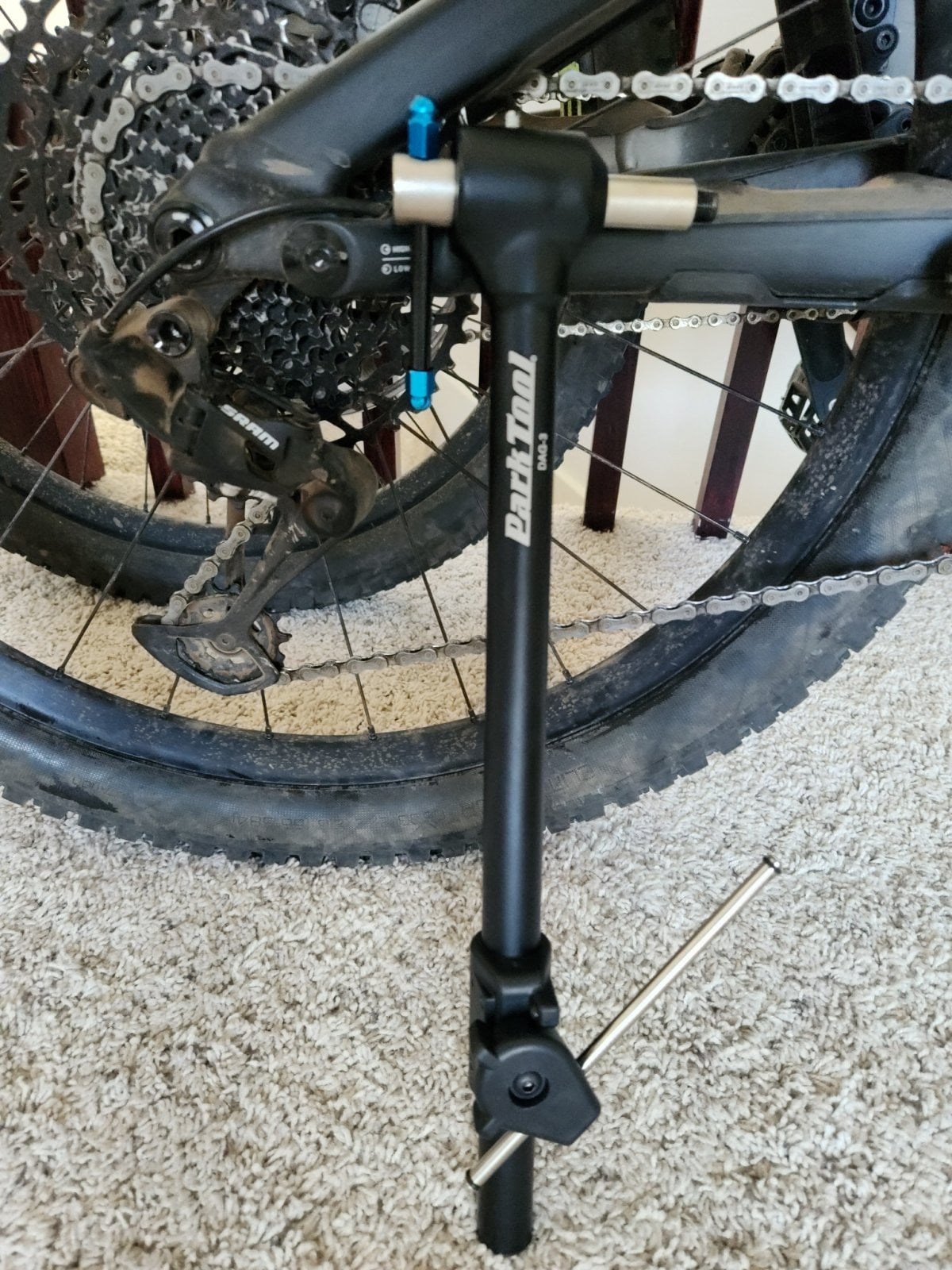

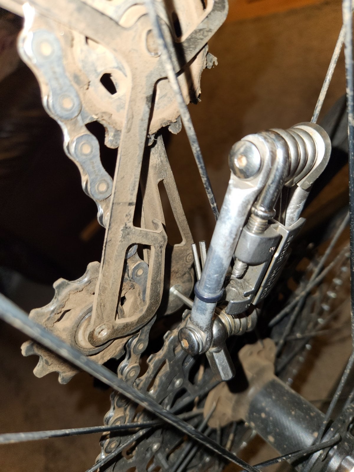

Thanks for the info on the 12 speed eagle guys. I've had three Levos and a Kenevo, all had 11 speed SRAM. A bent derailleur is common and easy fix for those bikes. I do my own bike work. However, I have a new Levo with the eagle 12 speed and the monster 50 on the rear cassette. It will not hold 6th gear. I've almost given up trying to get it to work correctly. It's been to the shop mulitple times and has never worked since new. I didn't know about adjusting the derailleur at the sag point. Thanks for that valuable info. I'm going to order the tool and try the adjustment at sag. I'm not sure if it is just the low level SRAM components that are on the Comp Levo or not but if I can't fix it I'm going to convert it back to 11 sp like my other bikes. I did change the chain ring from 34 to 36 but I had the shifting problem before that change. Thanks and I'll post back with my results after I try to get this fixed.
Utah Rider
Jul 4, 2019
165
198
Utah
I got great news on my 6th gear ghost shifting. Ordered the SRAM Eagle 12 sp guide and the DAG 3.0 Park tool. For some reason the bike shop could not fix this new bike so I pony'd up and bought the correct tools. Never needed them for the 11 sp SRAM but the 12sp is just too finicky. Anyway, the derailer hanger was out horizontally and vertically. The "B" screw was way out. It had to be set at sag like mentioned earlier. I set it at 30% sag and the larger 36 tooth chain ring also effected the b screw setting. Thanks for the help.

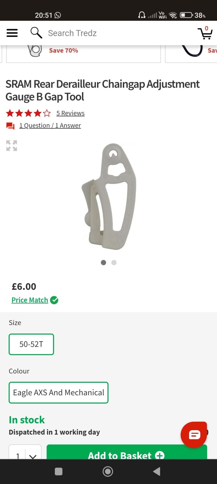

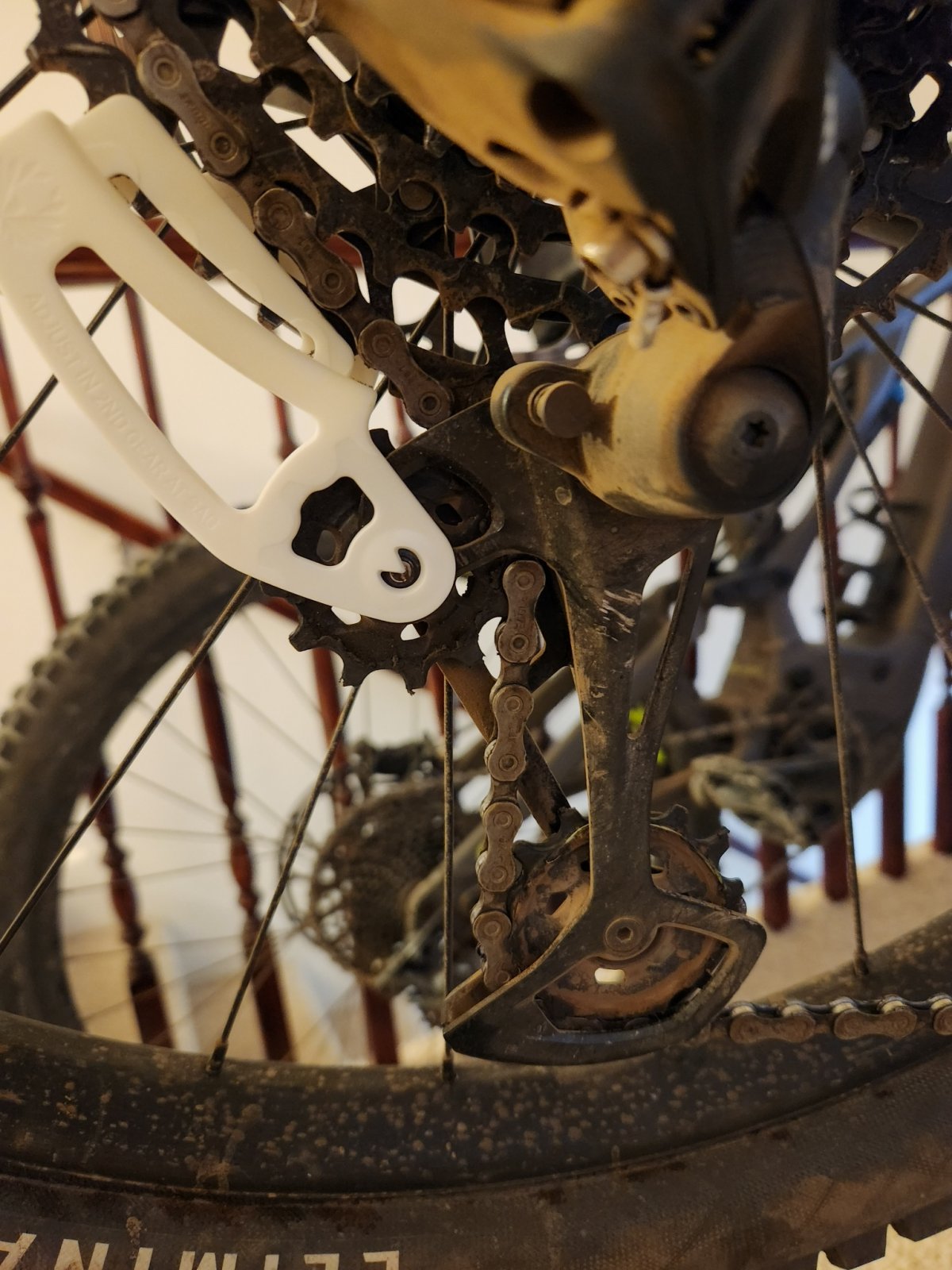

You can set the b-tension on 12spd sram without the tool , just follow the sram setup guide for how to without tool . I recall its a 3mm gap between the pulley wheel & 2nd largest cog (in sag position) . Guides available on the sram website .
More like 12-15mm. Big difference.
