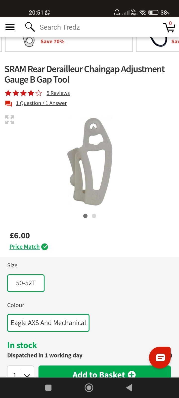

You can set the b-tension on 12spd sram without the tool , just follow the sram setup guide for how to without tool . I recall its a 3mm gap between the pulley wheel & 2nd largest cog (in sag position) . Guides available on the sram website .

Or do it properly for £6 + postage 🤣🤣🤣
