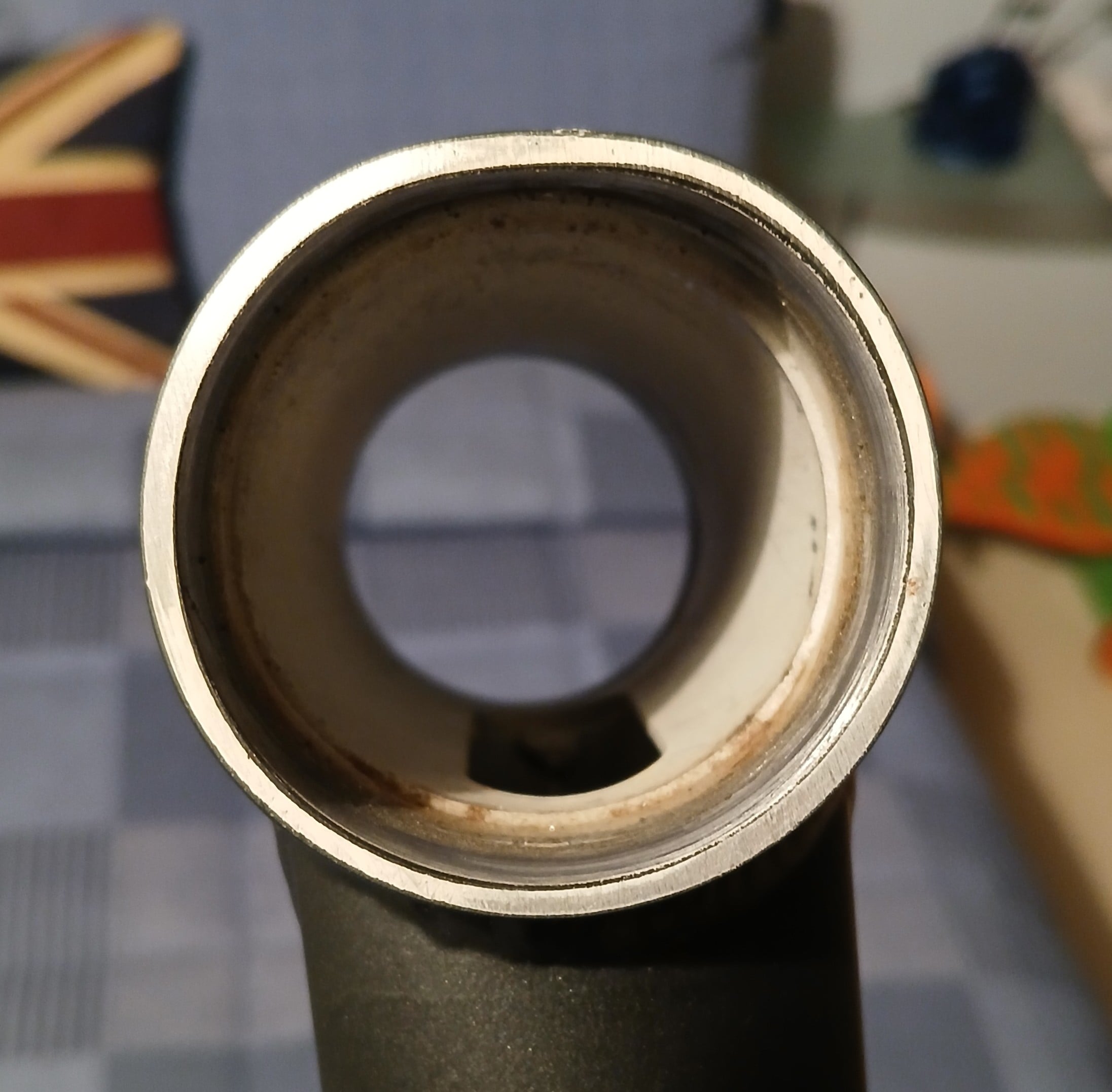

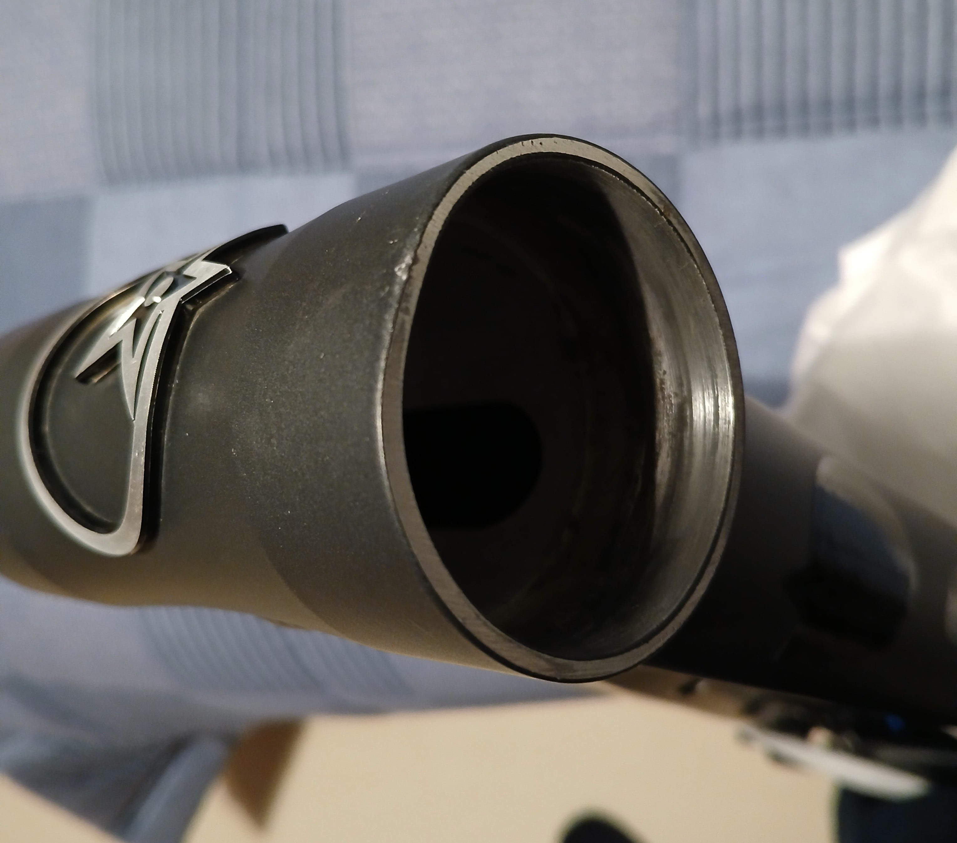

An hour passed and I removed the frame from its box and gave it a really good inspection and I saw this:
Yes, it looks like the frame has been dropped and the top of the head tube has been dented. I have messaged the seller and included photos, no reply yet. I can almost see the response: "Well it was OK when I shipped it!"
I was already planning to visit the LBS on Thu am anyway, so I thought I'd take the frame in to get his opinion. Surely a stiff and strong steel bearing will press in and move aside the soft aluminium. :unsure:
I measured it just in case it was an optical illusion!
It wasn't! the bottom of the top tube is 49.3mm dia all the way around. (To fit a 49mm dia bearing, upper and lower).
The top is 49.3mm dia most of the way around, but the dented section measures 48.2mm at the lowest. The dented area is about 25mm across.
So, it's definitely had a bang!
1.1mm (or 0.060") is a lot to shift just by pressing in a bearing. :unsure:
Any ideas?

you can buy (ebay) pipe stretching tools for restoring exhaust pipes and I'd start with one of these - no help to you that I have one in my tool stash but if you were closer🤭
also heat the area in an attempt to anneal......

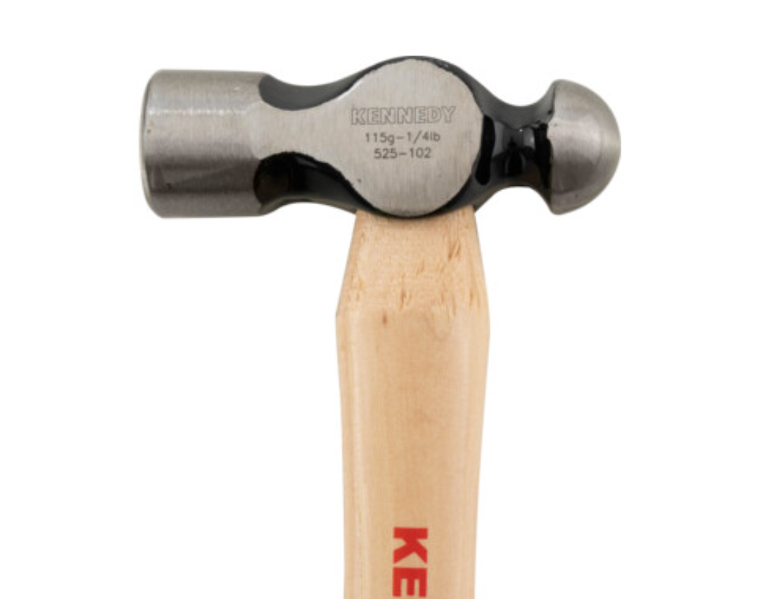

Please don't think I'm taking the piss Steve, but I'd try 'gently' working on the inner edge with the ball end of a ball pein hammer.

It appears that a small section of the edge has “folded over …therefore not allowing the bearing cup to sit properly.
Hmmm …what would I do?
The muffler pipe sounds like a good idea, but you run the risk of distorting the bearing pocket in other areas. Also the circular metal may flex or relax. (I think this method or tool would have to be specific.
A direct hammer blow or tapping runs the risk of damage to the edge, which needs to remain parallel to the wall(s) of the bearing pocket.
A large socket-extension tool (8”) might give you a better, and controllable angle, while lightly taping the damaged area. You could check for fit after a number of taps until the fit is perfect. You’ll have to chase the deformity with the round socket extension end while holding it in position.
I would place the frame between my legs, rather than a vice. You’ll need some patience but I don’t think you will do any more damage. Don’t over-do-it and good luck 🤞.

If that was mine I'd get a piece of dowel and hammer it back into shape
The Ali is soft enough just take your time matey

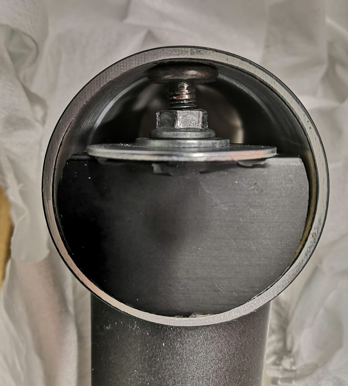

I spoke the LBS. They had never seen anything like it, so that's the end of my fantasy of them saying "oh yes, that's a doddle, we'll do it while you wait!" ;)
What they did say was that they would get the local machine shop to make a tapered shaft and press it in, from the bottom for preference to push any lip outwards in the opposite direction to how it was made. But they have never done it before. The guys I spoke to both agreed that it was fixable, but would only attempt it if I gave them a free pass (ie at my own risk).
