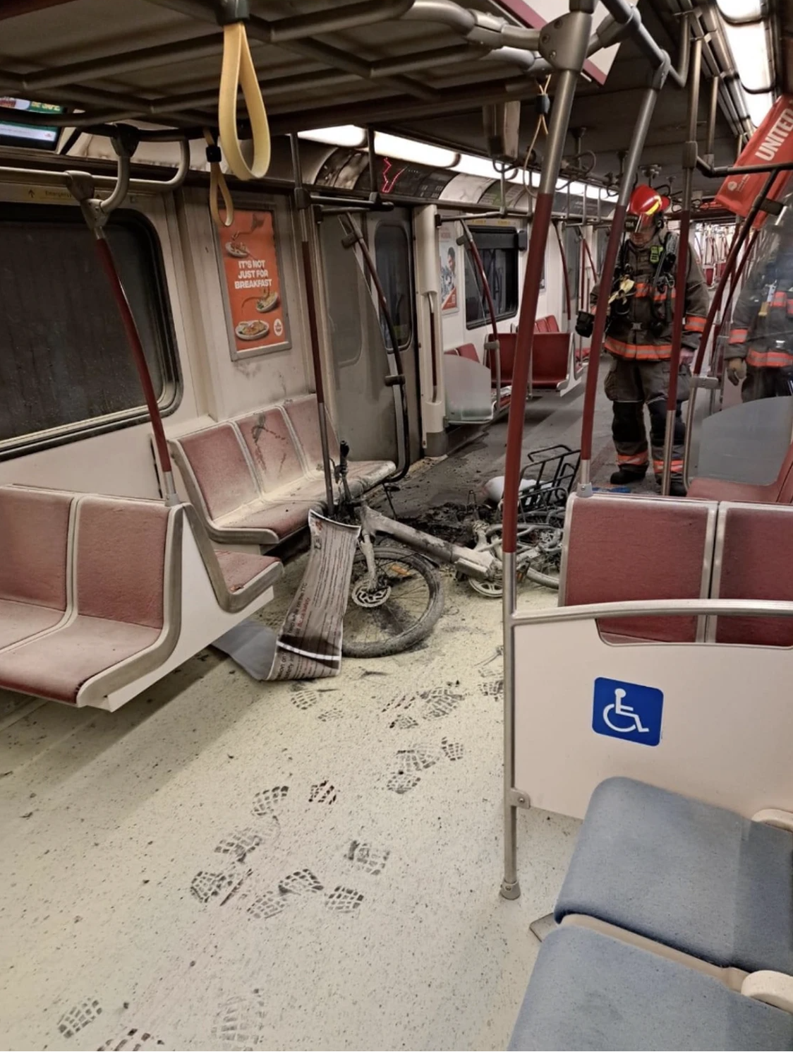

Spontaneous e-bike fire on Toronto TTC (subway).
Very scary.
I store my Trek Powerfly battery inside my apartment over the winter.
Could anyone possibly discern from the photo the brand of the e-bike? Hope it is not one of the major brands.

It looks like something made up with power tool batteries to me.
I wouldn't worry about your Trek battery as it's full of electronics designed to prevent this sort of thing. But I still wouldn't store or charge it near any exit doors.

whatever caught fire looks to have been on the rack at the back of the bike.........its not a mid drive motor and does not look like a hub motor either so maybe not an ebike at all. Probably a modified Tesla :p :ROFLMAO:

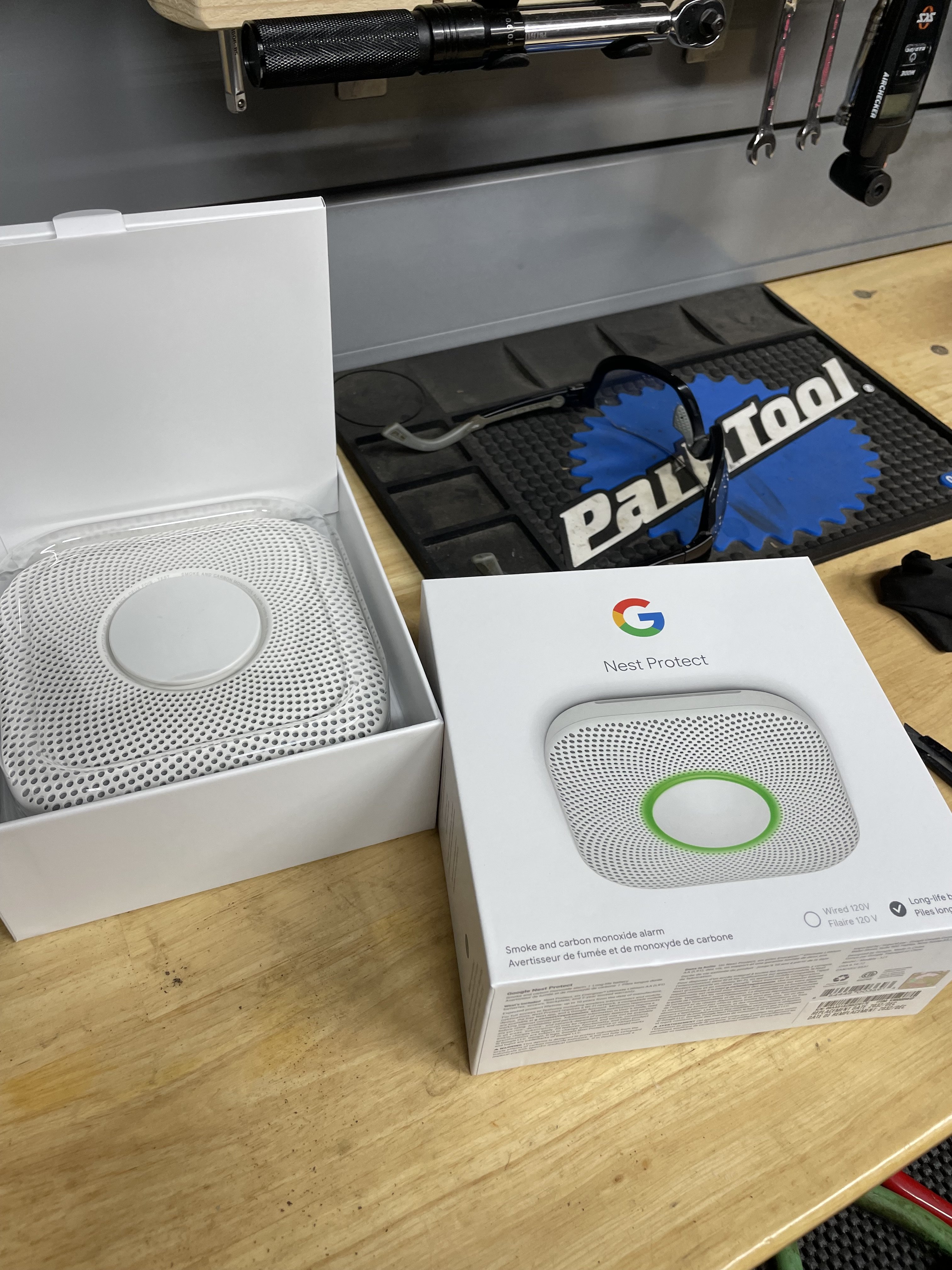

I have three of the Nest fire detectors which are hardwired and ‘talk’ to each other. (I think they’re Google now). But I don’t have one in my garage/shop where I store and charge my bikes.
I’ve been procrastinating about getting a 4th. I better get another before I regret it. 😳
Yeah, I just purchased a fire detector for the room where I charge my battery.

Spontaneous - not when charging or in use. And it's a big bike to be permitted into middle section of a metro carriage beside the disabled seats. It would be useful to get the fire service report.

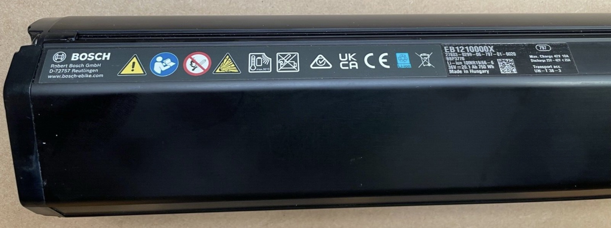

proper brand ebike batteries should only be at risk when charging and they will cut out if a battery starts to get hot.
If it's aUL certified battery they are supposed to be designed to avoid "propagation of fire" which I'm guessing after a quick google should mean they can't spread a fire, or cause something to combust.
I think inside the battery there are plastic chunks that melt and cover a cell if it gets too hot, and also if it's UL certified it's supposed to not have thermal run off, which is where one cell causes another to start a chain reaction
I'm guessing that subway fire was caused by something like a cheapo chinese battery having crappy soldering etc and one of the cells got shorted, those bateries have no safety certification and are built as cheap as possible

This from Cyclingweekly.com​
UL AND CE LISTED E-BIKE BRANDS AS OF MAY 2023​

I think even though your specific bike may not be on the list, a code or symbol may be present somewhere on the battery. Your country may have different certification's, but UL or CE seems to be a good standard.

Cube and Haibike are missing from the list? 🤔🤦‍♂️
the list is kinda dumb they could have just done it by the brands that make the batteries.
Every Bosch ebike should be full UL for the whole system.
not sure about the older ones, most other big manufactures didn't start doing UL until recently and do it only for the battery, which is the high risk part anyway.
Even without UL any of the big bands will no doubt be using the best cells and will have really good QA for any wiring/soldering and no doubt every battery is physically inspected .
Virtually every ebike fire you see in the news will be chinese grey market imports.
I think a few years ago bosch did a battery recall for a small batch of dodgy batteries though.

UL 2849 is whole bike evaluation and testing procedure, not just the batteries. The test details are described in the above video by Ark.
UL is an independent testing system whereas CE is a self-certification system by the manufacturers
I will be replacing my 2021 Merida with a UL compliant and I have contacted UL (they invite contact through their website) to obtain confirmation if the replacement candidates are UL2849 compliant.
