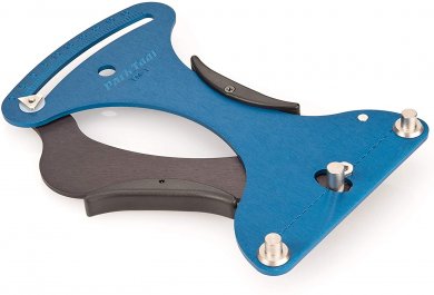

  1. PARK TOOL TM-1 spoke tension meter 94 EUR

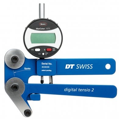

  3. DT Swiss Spoke Tension Meter Tensio Digital 1042 EUR

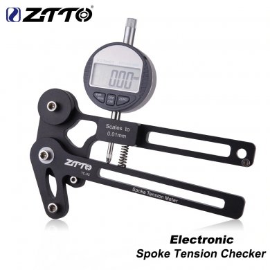

  4. ZTTO spoke tension meter digital 50 EUR
Park Tool

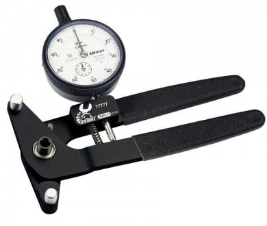

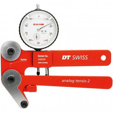

DT Swiss analog

ZTTO digital

View attachment 56104 View attachment 56103 View attachment 56102 View attachment 56101

As mentioned above, I bought one (Park Tool) and found it inconvenient and awkward to use, and it greatly slowed the wheel building process. So I don’t use it.anymore.
