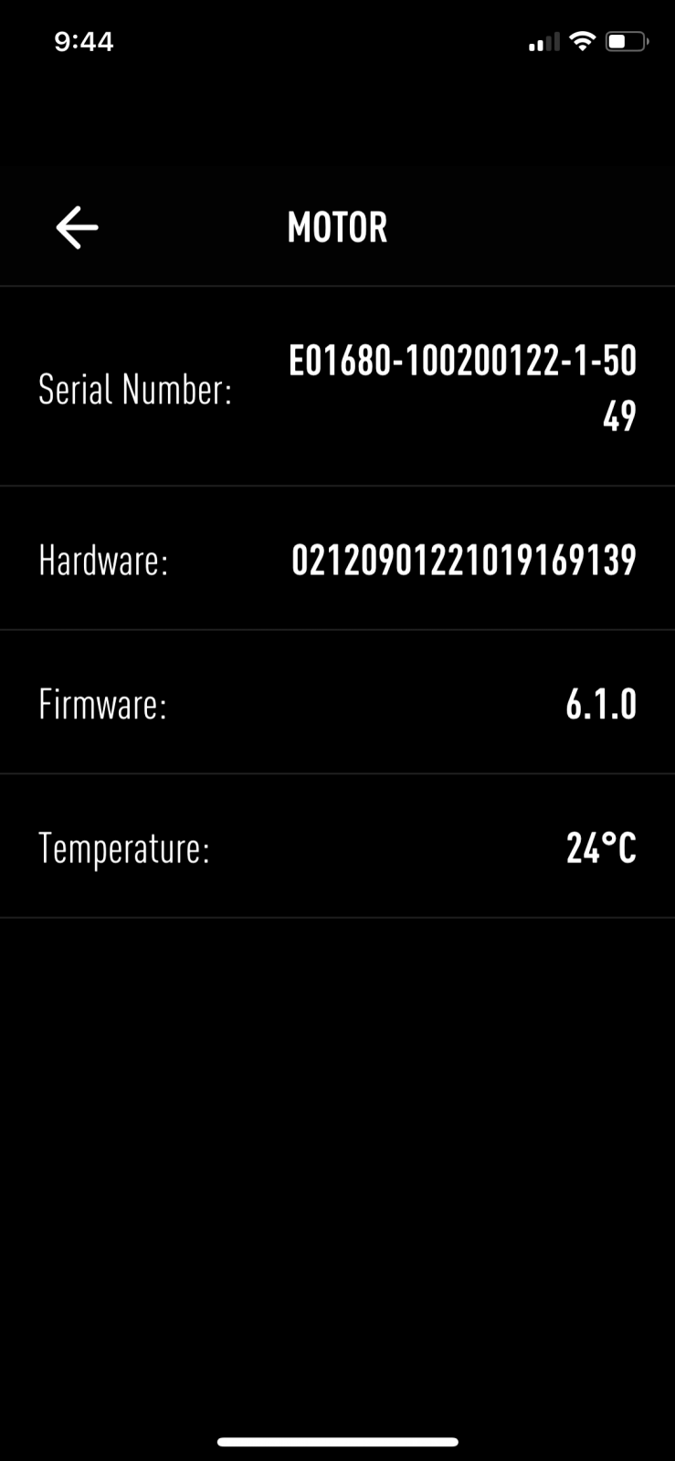

I'm hoping my new motor has the updated sprag bearing. Otherwise I will be back to the dealer in another 500 miles. I believe motors manufactured starting in January have the updated part. I'm going to take off the cover to see if I can find a date stamp of any kind. The new motor is somehow louder than the original. My wife's new '20 is quieter.
Murch
Aug 9, 2019
226
201
United States

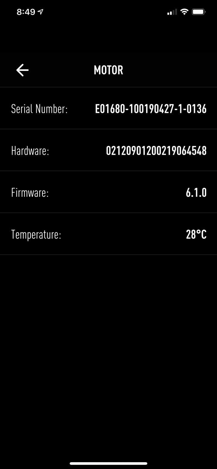

Your new serial number has the date code in it, the middle between the dash last is the year, month, and day from what I was told and seems to match my three motors serial numbers. This is my first motor 190427 is 2019/04/27

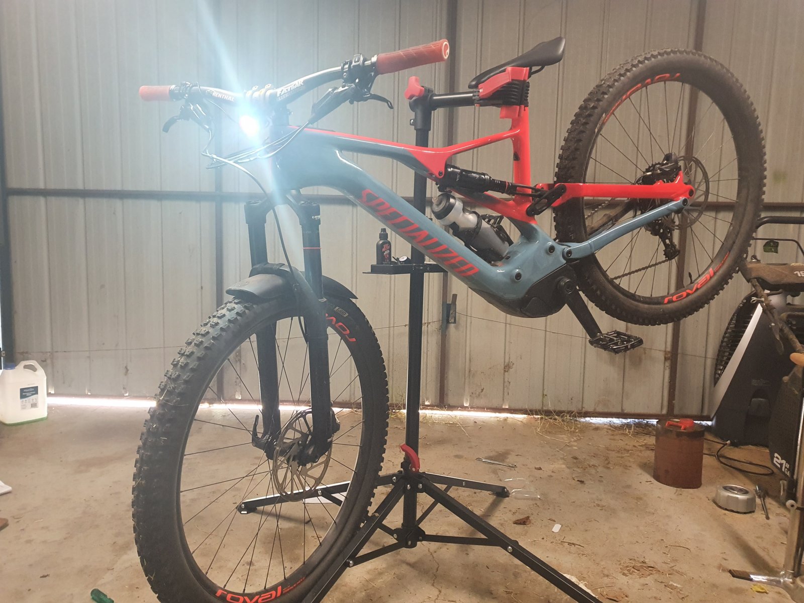

I have a similar maintenance stand but I hang my bike on the top tube between the shock mount and the seat tube. The bike hangs more level doing that.
Yes I broke the seatpost clamp tilting it up , could easily have been the end of the carbon frame

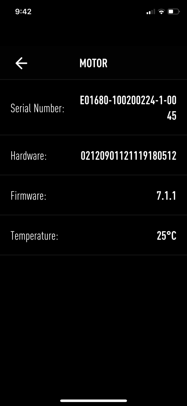

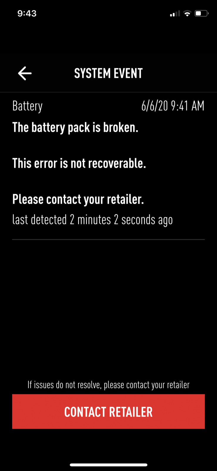

Thanks. It looks like 1-22 and 2-24 so I should have the updates parts. The app also let me know my battery pack is broken so that’s awesome ??‍♂️ It still works. Thoughts?

It will be interesting to see my current motor is 200109 so yours is even newer. I am hoping mine wasn't too early in Jan. That sucks about the bad battery, hopefully it's a quick turn around on a replacement.
