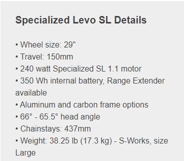

So if we take the Levo power modes, they roughly work out to this, on default settings. Obviously you can tune trail / eco to over up to 560 watts, but this might give a real rough guide:
Turbo Levo
Turbo 560 watts
Trail 340 watts
Eco 170 watts
Levo SL
Turbo 240 watts
Trail 150 watts
Eco 80 watts
Like I mentioned, these are rough guesstimates, but based around mission control 100 / 60 / 30 settings in motor power.

I remain a bit skeptical about the claims that a Levo SL can go as far as a Turbo Levo...
@TheBikePilot and I used almost exactly the same battery. He was on the Regular Levo with 700Wh battery, I was on the SL with the range extender so 480Wh.
On a 23 mile ride we both returned with about 50%. Approx 3000ft of vertical.
Brose uses 21 amps
SL motor uses 7 amps
I was a bit lighter as he had a backpack with camera gear.

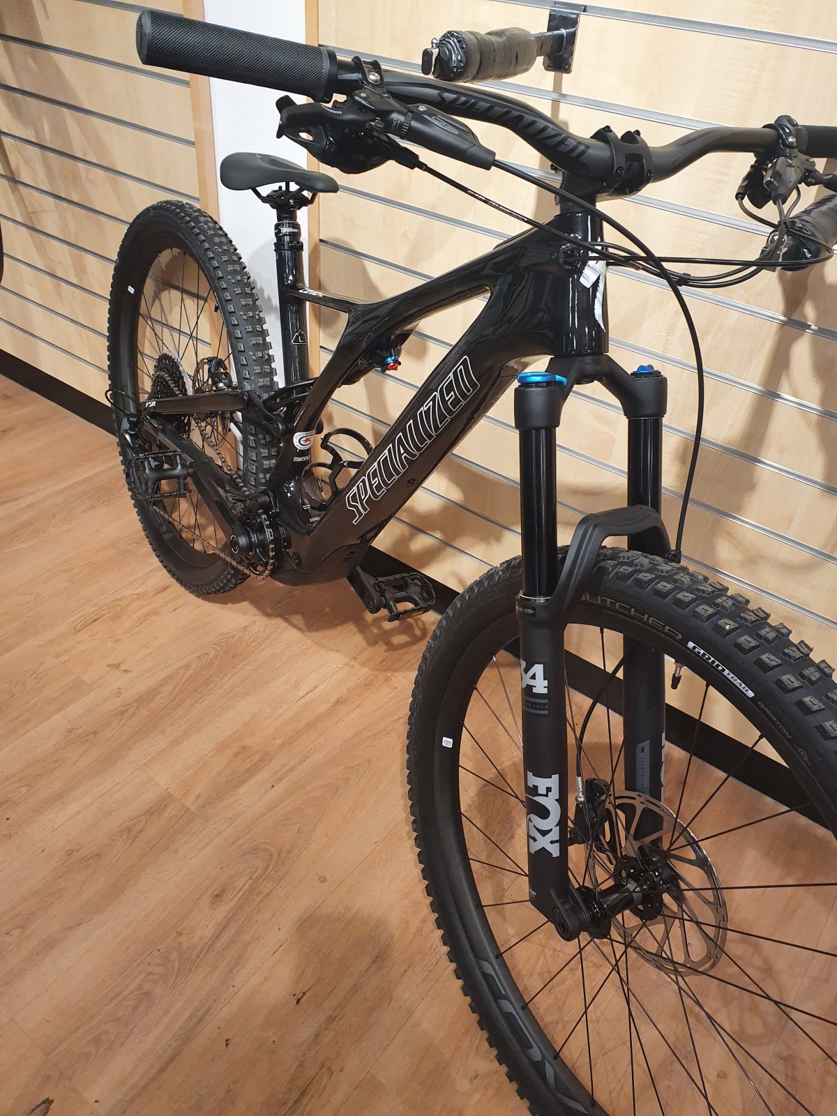

So went into EBC today to size up the SL bike as geometry against my current bike placed me somewhere in the middle of a M and L. After a sit on both bikes and a wee cycle in shop L is more my size. Demo booked for this weekend
Do they have all the sizes? I’d love to try and XL to satisfy my curiousity!
