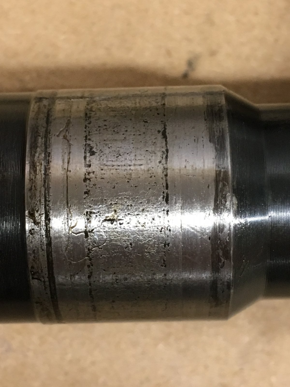

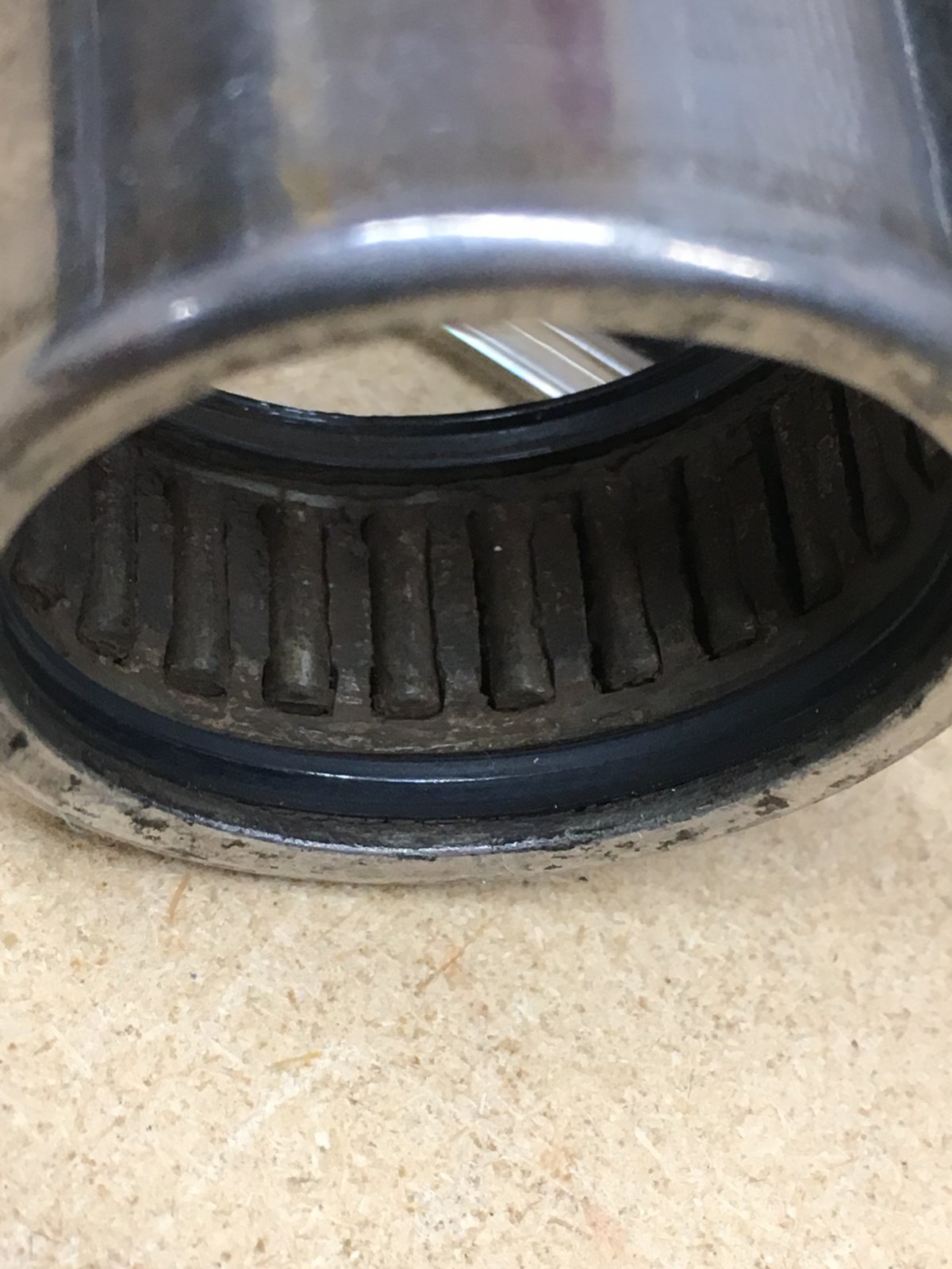

Hi Lolp, The bearing that is causing your issue is the small crankshaft needle roller bearing. I am sorry it has taken me so long to reply to your post because one thing I was going to say is DON'T put your bike on its side and tip oil in the bearing!
This will, temporarily, make the bearing feel better, but you haven't solved the problem. This bearing starts to seize and become stiff because water has got into it and rust has started to develop. Yes, you will ease it with oil but the bearing is still damaged and now coated with oily rust.
Any oil tipped into the motor (even very small quantities) will now contaminate the interior of the motor. If any of this clean or contaminated oil makes its way to the sprag clutch bearings or drive belt, that's a bad thing.
Sorry to be the bearer of bad news, and I do not want to scare anyone, but sadly I have seen many people do this trick on many different motors and it never ends well.
If a bearing is stiff, it is already full of rust and failing. Putting oil on it is only prolonging the inevitable. Unfortunately, when the bearing finally gives up altogether you may find that the rust damage and contamination has damaged your motor beyond repair
As luck would have it, I have another motor in for repair with exactly this problem. You can see the rust on the bearing in question and you can also clearly see the damage to the bearing surface of the crankshaft. If this crank is used again it will just cause the next bearing to fail prematurely :cry:
As luck would have it, I have another motor in for repair with exactly this problem. You can see the rust on the bearing in question and you can also clearly see the damage to the bearing surface of the crankshaft. If this crank is used again it will just cause the next bearing to fail prematurely :cry: View attachment 12761 View attachment 12762

Hi Lolp,
@Bearing Man
looking at your pic No1. Can you please tell if the needle bearing is equiped with sealings ?
The blue-grey area between the outer bearing ring and needles looks like a sealing lip.
Yes, this bearing has a seal both sides, not that it does much good. This is why we are looking at fitting a secondary seal before the bearing.

Peter...thanks for the update... i did the 'repair' when i got your first message and my cranks turn without friction and with no perceptible 'play' to the axle. I'll just have to ride it til it gives up but your mates extra 6months and still going is encouraging.
Bearingsman... your advice is also most appreciated and if (maybe when?) i need a full on repair ill be in contact...i presume you are in the UK but can you give your website for more contact details please...just in case!
Yes lolp I am based in the UK, you can find all my contact details on my website The home of e-bike motor parts -
As for the grease, yes, this works for some motors, but not really the Brose. I think my seal fix will be good but I have to wait until next week to find out?
