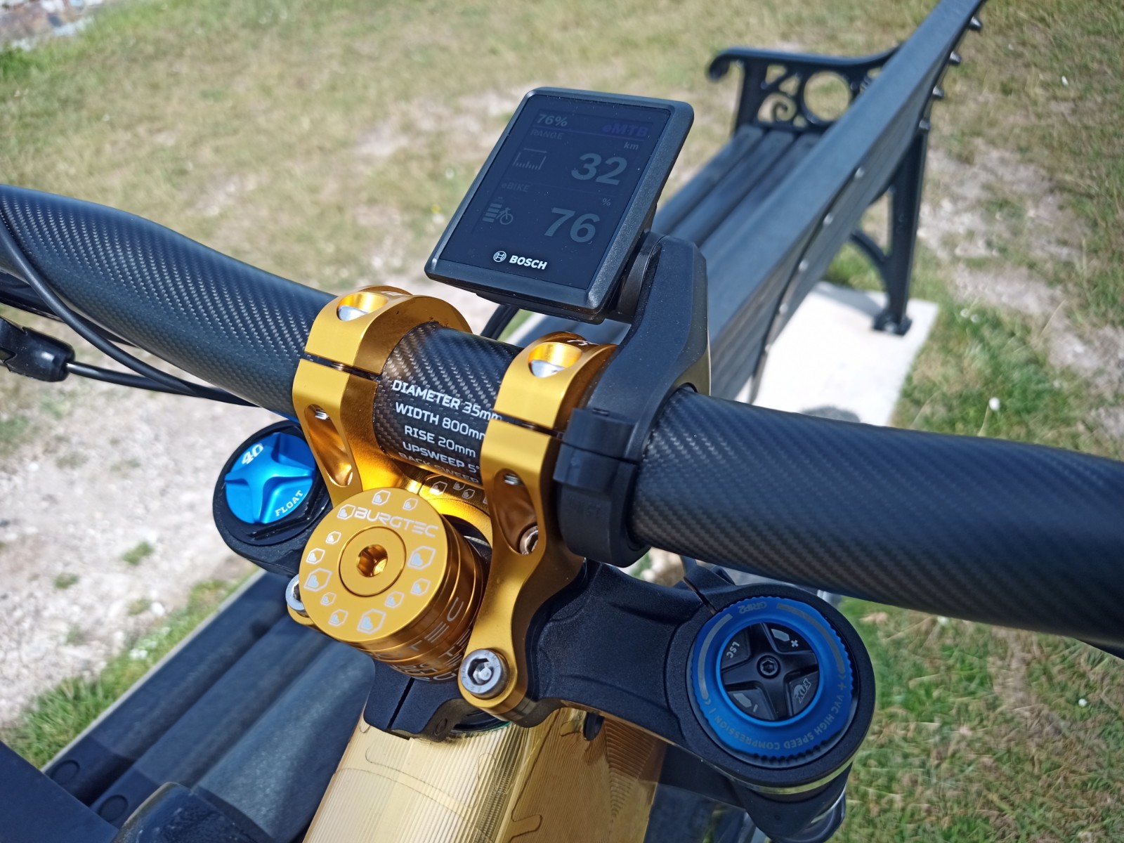

I always put the fork in uncut with the headset, spacer then mark the cut just bellow the top cap? Also I like to leave it tad longer - say 25mm - then use more spacers on top of the stem? You can always cut the steerer tube again at latter stage and you've got options for mounts, increasing the stem height etc in the future (plus easier to resell the fork in the future with a longer steerer)? Hope headset Doctor is better than a star nut - much more civilised and removable!
