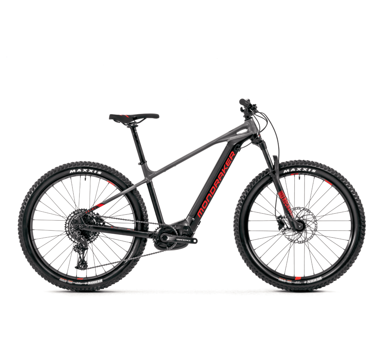

I would be tempted by one of the new Mondraker hardtails that are coming out. There are two models, one with the new Bosch motor with a 630wh battery which is removable, and one with the Shimano E8000 motor that has a non removable 630wh battery, and also a removable 360wh piggy back battery to extend the range.
I would definitely get a 29'r whatever you go for
Being Mondrakers the XL sizes are big.
Mondraker Thundra R 29" Bike 2020
Mondraker Prime 29" Bike 2020

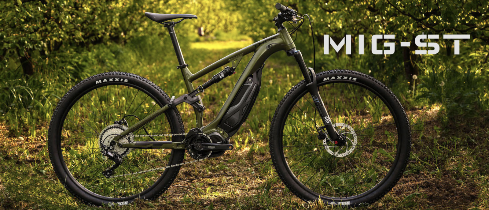

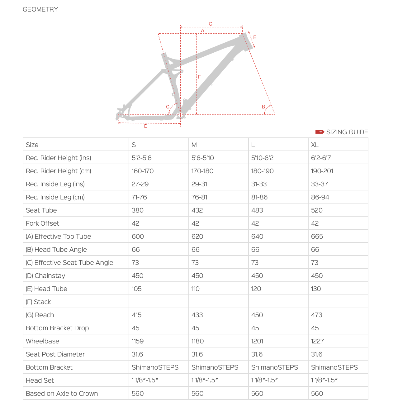

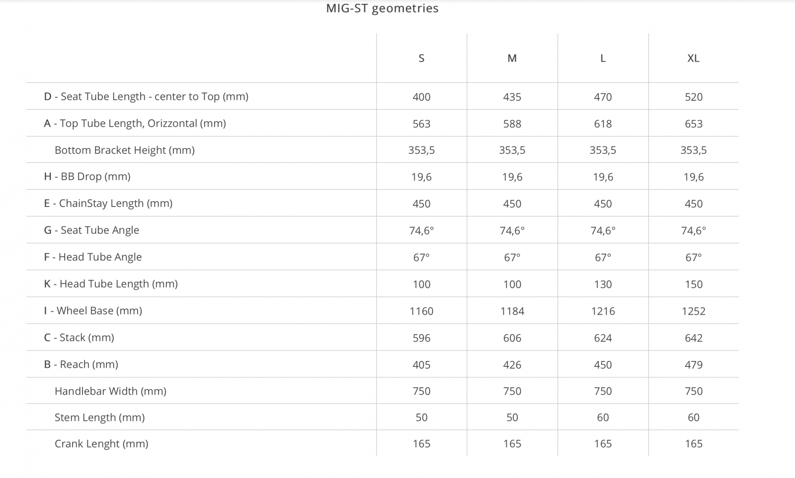

Also might be worth looking at the new Thok Mig ST, its a short travel 29'r running the Shimano Steps system - they do an xl but dont know if it would be XL enough for you. As a bike to commute on, but throw in a bit of offloading too, I reckon a good bet. Doesn't come with a dropper post but you could add one
https://www.thokbikes.com/en/thok-mig-st-ebike

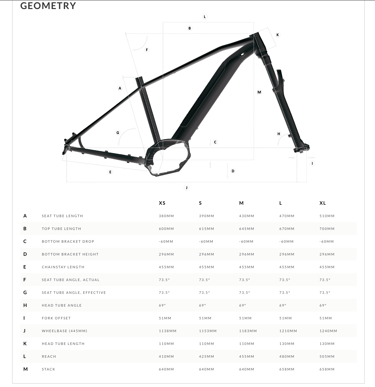

I also thought about the E-Sentier, but looked at the Geo chart. It seems that the XL reach isn't that long at all, less than the XL Levo in fact.
