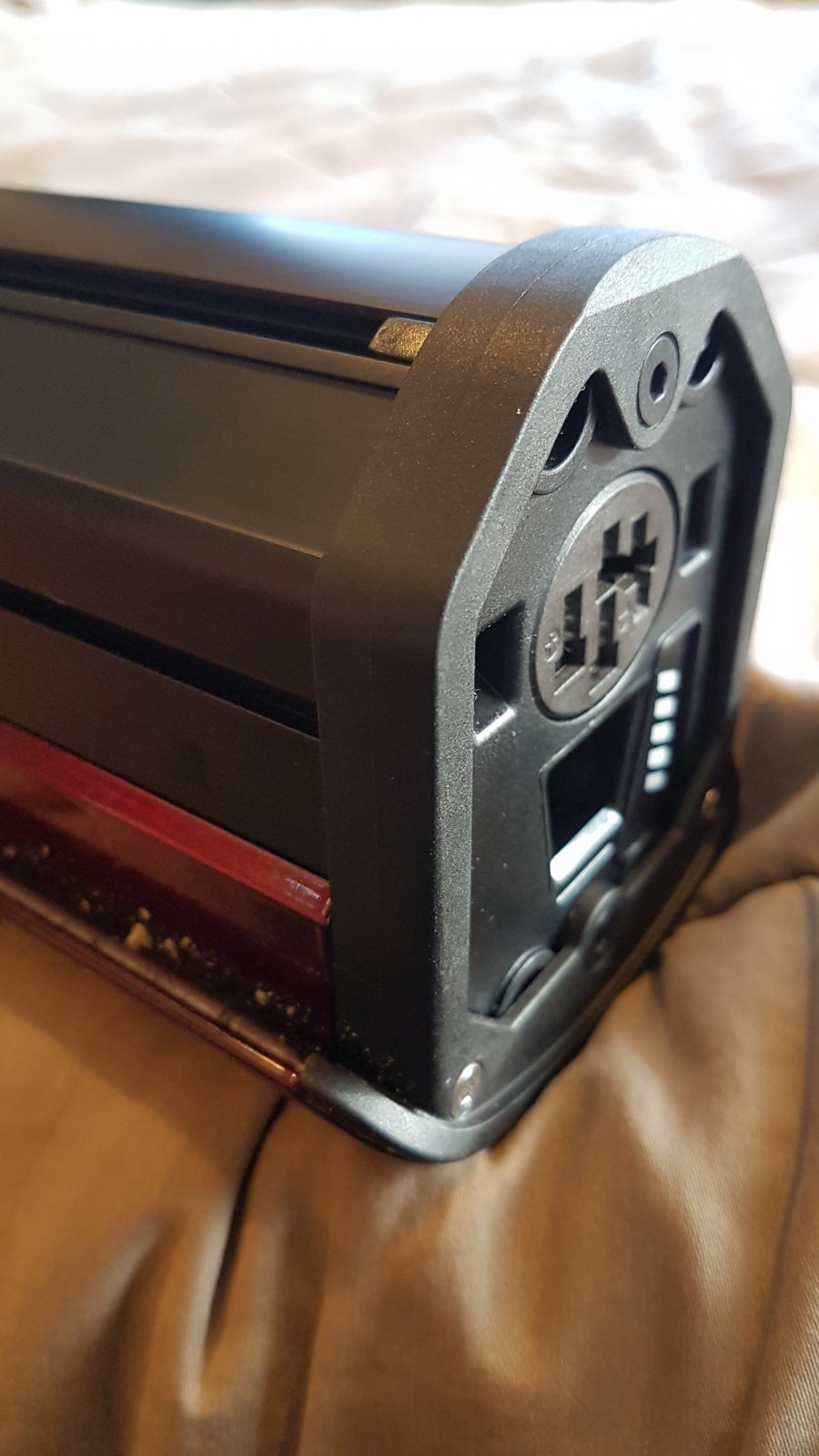

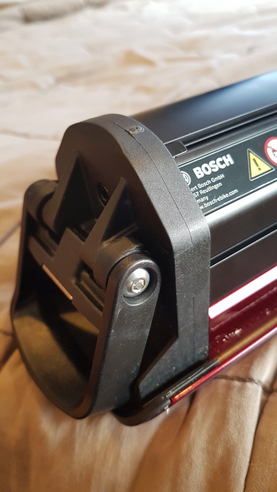

1. Is it possible to ride without the battery, and just use a spare battery cover?

You could ride without the battery, but why would you want to? Spare covers are available, but it won't be cheap! And not something your LBS will have. The idea of the spare cover is so you can have a spare battery at the ready, not as a cover when there's no battery.

Two reasons for riding whitout battery. Or three.
1. If I am traveling by plane and can't bring the battery.
2. If I am to participate in an enduro contest.
3. If I am trying to beat someone on strava.
So the cover doesn't need a battery to attach to the frame...!?

no, battery not required. The parts that latch into the frame are just end caps that screw to the battery and to the cover plate . Don't know if the caps come with the cover, separate part numbers. Have a look at the parts diagrams pinned at the top of the Trek forum ?

Although now I think about it, i would say the battery does provide some structural rigidity to the whole assembly. The cover probably won't latch in as firmly without it. But you could hold it in tight using straps

I only have the battery. But understand that I need an extra cover, and a 500w-spacer. And a lot of other stuff obviously. Is there some kind of kit that's possible to order from somewhere?

I think you would need to order that through your bike shop or contact Trek directly. As you say, you will need the cover, the spacer, and the two end caps. It may be sold as a kit? You could also get all the part numbers from the parts diagram and do a web search, see what comes up.
