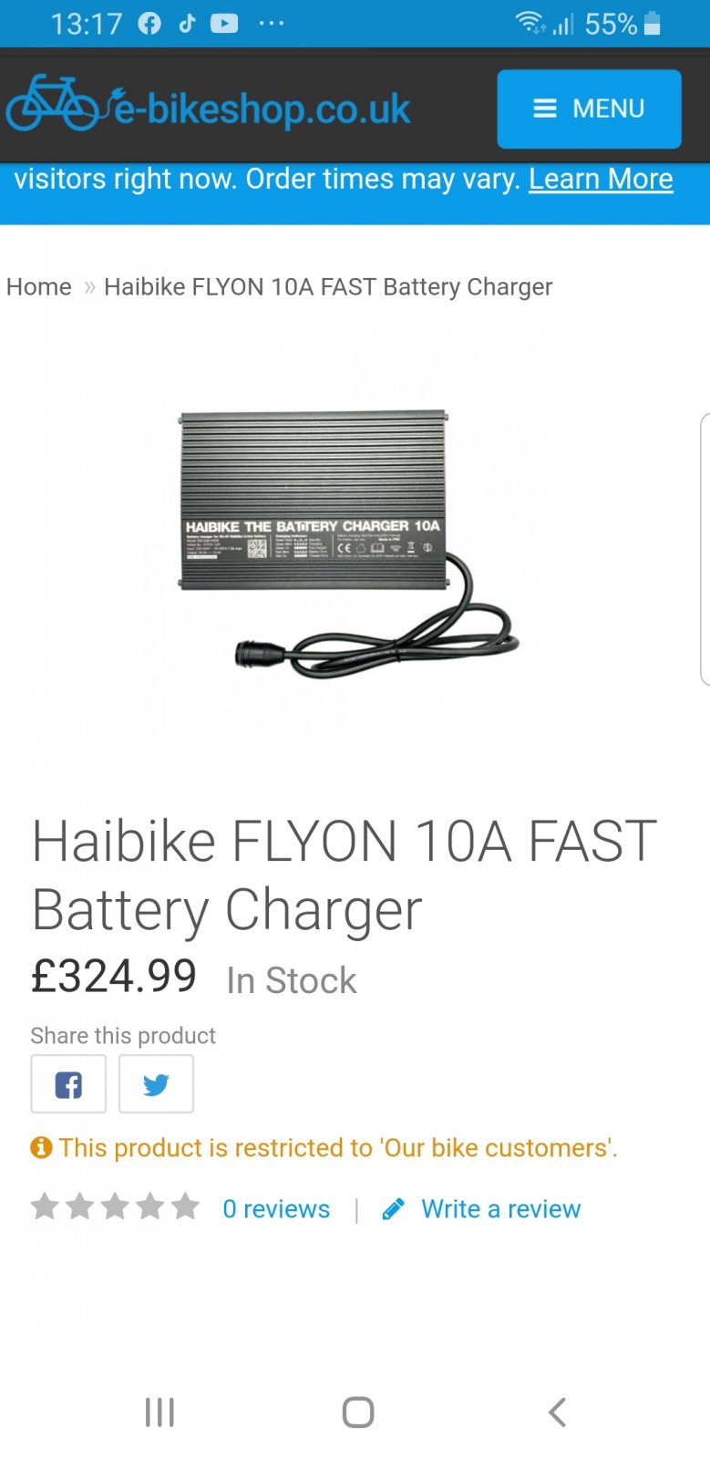

Haibike offer a 10amp charger option with there flyon bikes, do they use different cells?
I would buy a 10amp Bosch charger if they made one. Would only use when quick turn round is required.
Slapbassmunky
Aug 1, 2020
284
293
Isle of wight
They might do, 2700 cells can handle higher currents than 18650 sized ones so that might be how they're doing it?
Given their specs, the haibike pack is a close match for the Bosch 625. So around the 17.5Ah mark at 36V. EDIT. *conflicting info online. TQ say 56 cells and 48V. 56 cells would be a 14S4P pack using 18650 cells with 3450mAh capacity each at 52V.
Again looking at the data sheets for most cells 0.5C is the preferred charge rate but they can go up to 1C if temperatures are low enough. I'd be extremely surprised if you could take the flyon pack straight off the bike and have the charger blast 10A into it, I would imagine it throttles well and it's charge rate is heavily pack temperature dependant. However, even at 10A, you're well under the 1C rate.
But please bear in mind this is all an educated guess, without one to test properly I can only speculate.
And have you seen the cost of that 10A charger? ?
14,021
20,794
I've just noticed the cost ..a bit on the heavy side ..
Careful ... you're giving us EMTB'ers a bad name ..
"We want and need faster charging" ..
"OK, here's a 10a fast charger" ..
"Ohh, it's expensive, slow charging works for me ... "
:LOL:
It does leap off the page as expensive doesn't it .. but with shopping around :
€255 :
€209 : (Unsuprisingly, Out of stock)
Compare that to a standard Yamaha charger
€189 :
Bosch 6ah
€160 :
Bosch 4ah
€127 :
Comparably, it's only about the same price as a 10a car charger : (€250-€300)
I suspect if we had a survey thread "what would you like to pay for your battery charger" .. it would be €50 ! :) Despite all our dreams of fast charging/slow charging/long battery life - it's just a little box which isn't exciting and doesn't make you think your bike might go faster if you bought it.
