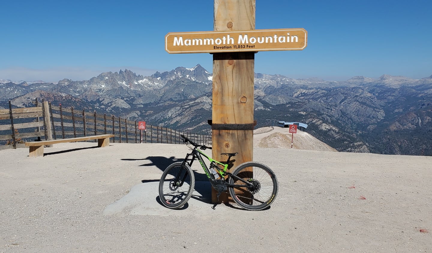

I’ll say with 100% certainty that at 11,000ft you’ll feel the beginning of hypoxia.
Edit to say that, yes, that's my Levo and yes, I took that picture.
