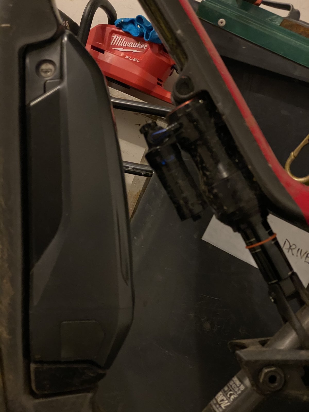

Also any chance you can tell me how tall the battery is 60mm below the upper mount flange? My shock reservoir is perhaps too close for this battery.
Thanks Alan
@Avyoung
Have you thought about turning your shock upside down? Is it possible? I have same issue.

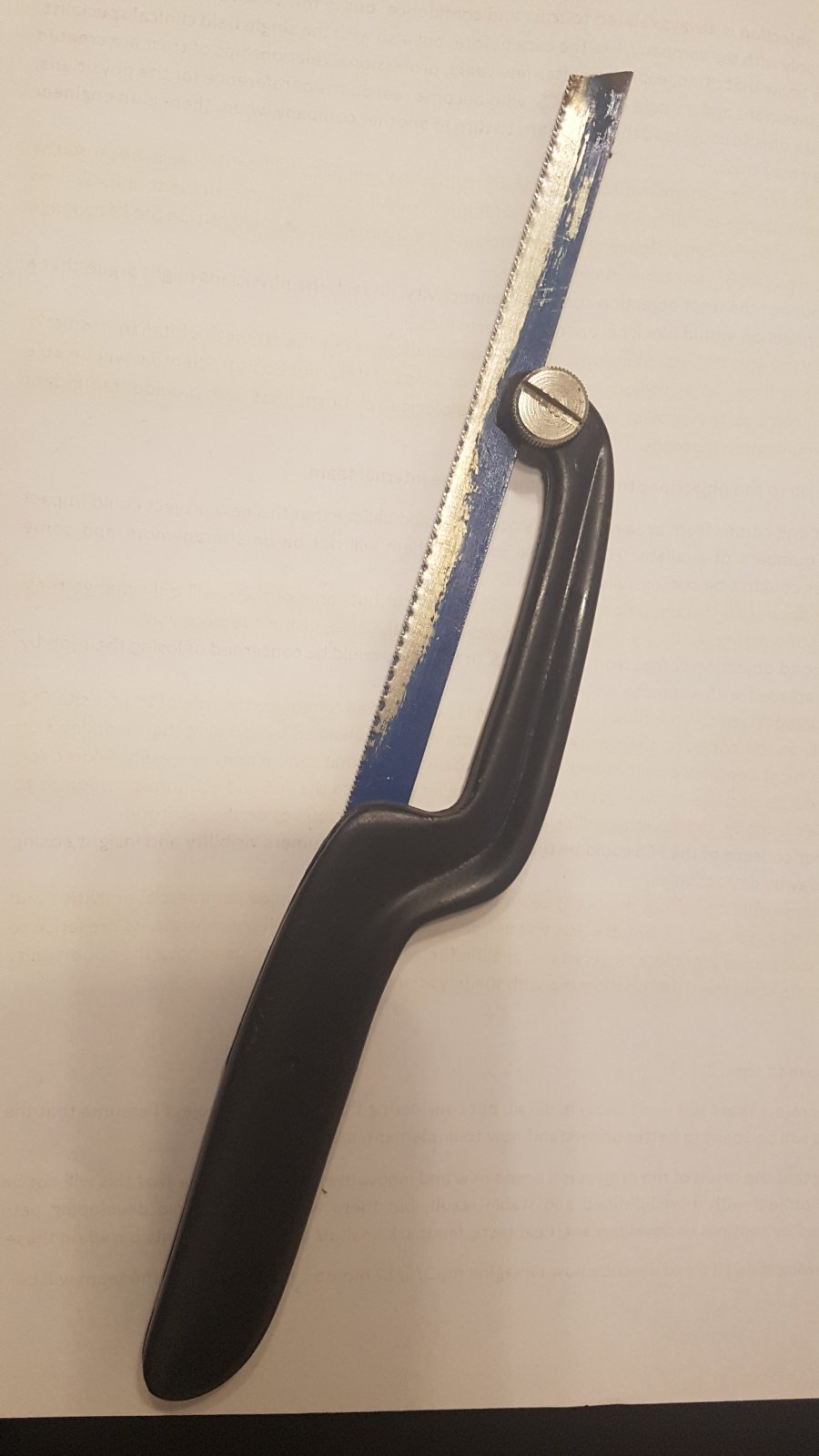

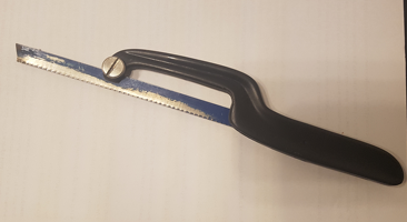

This hacksaw

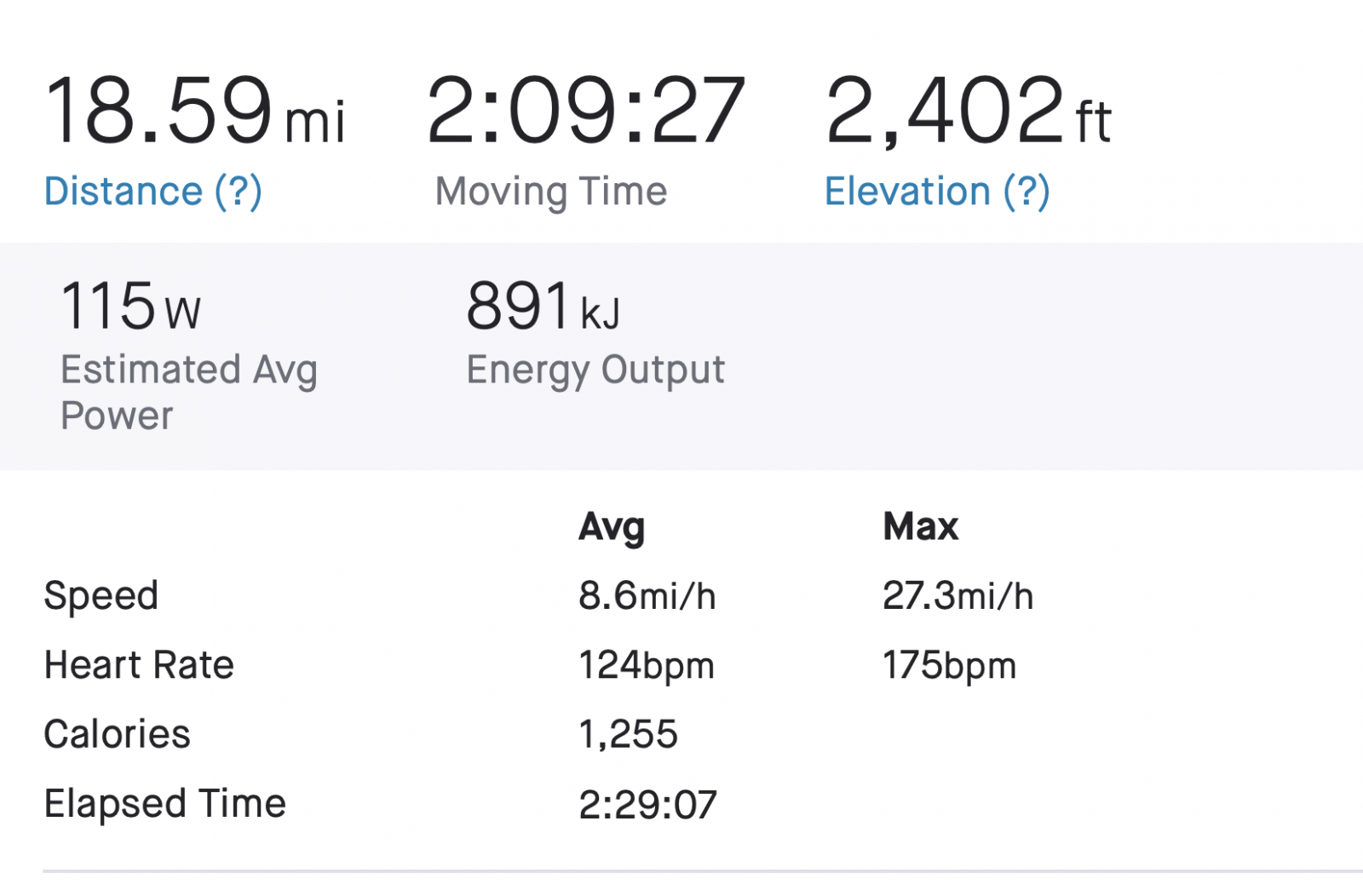

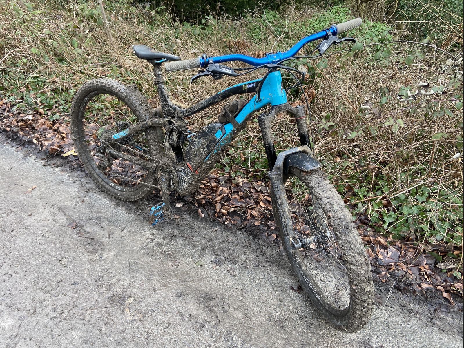

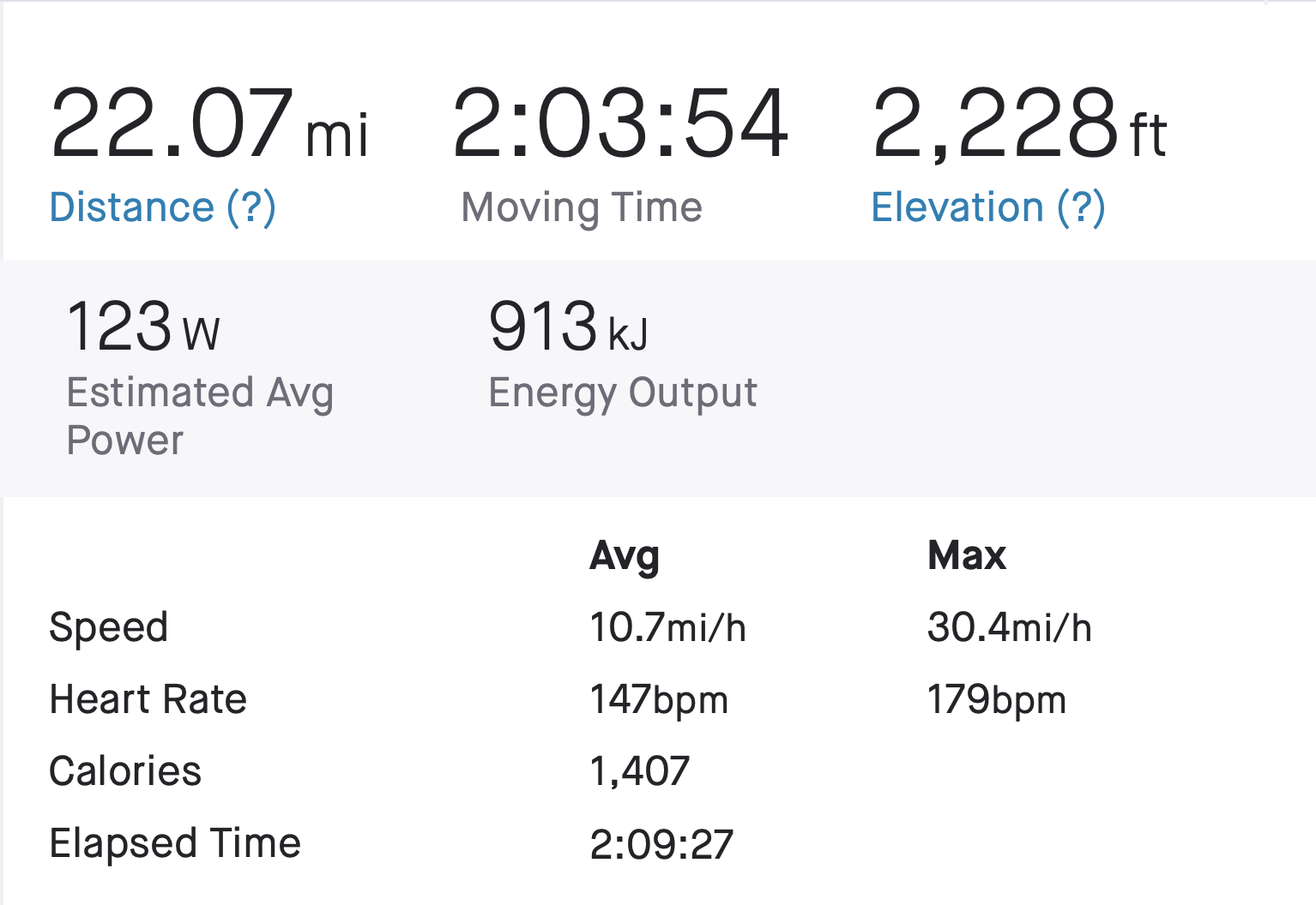

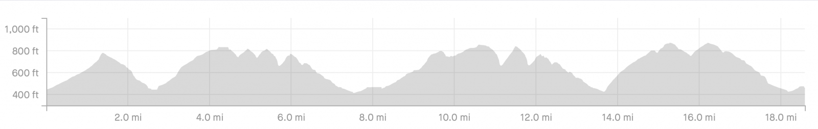

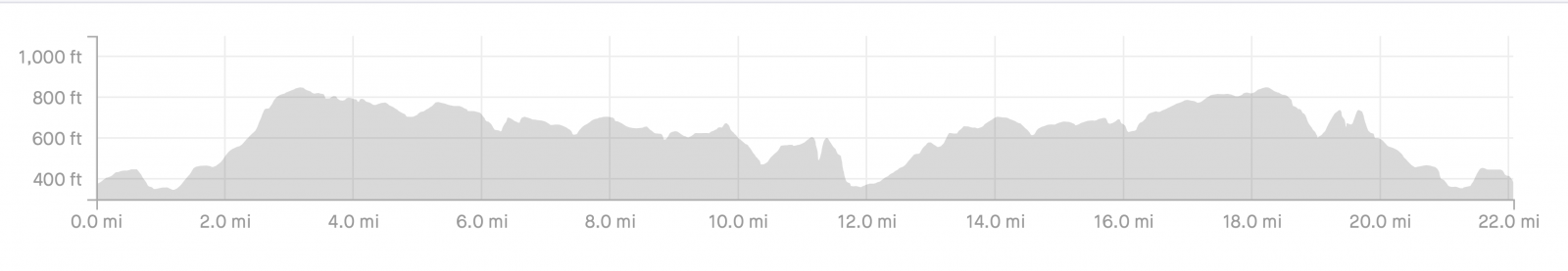

So I have the 630wh external now on my E-Sommett, modified the mount to get it to work as the new mount is out of stock.
Did a ride this morning, all in trail set to max assitance , mostly horrific muddy conditions, but quite a warm day and no rain. Finished ride with 10% battery left according to Garmin. It was a local blast with no consideration in my riding for conserving range.
Data below - the other ride posted is the last local ride I did where I drained my 2 year old 504wh battery, again all in trail. Not that much elevation in these rides but gives an idea of the difference.
