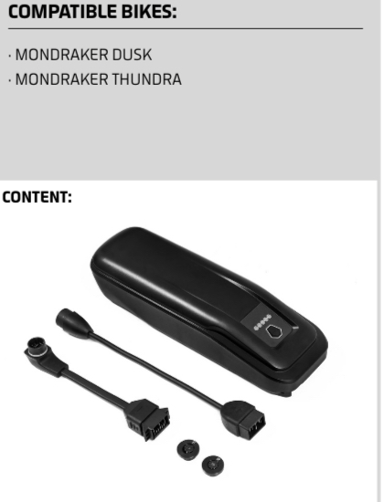

So I did a lot of digging about online, and I have found a trendpower/Simplo range extender 360wh that

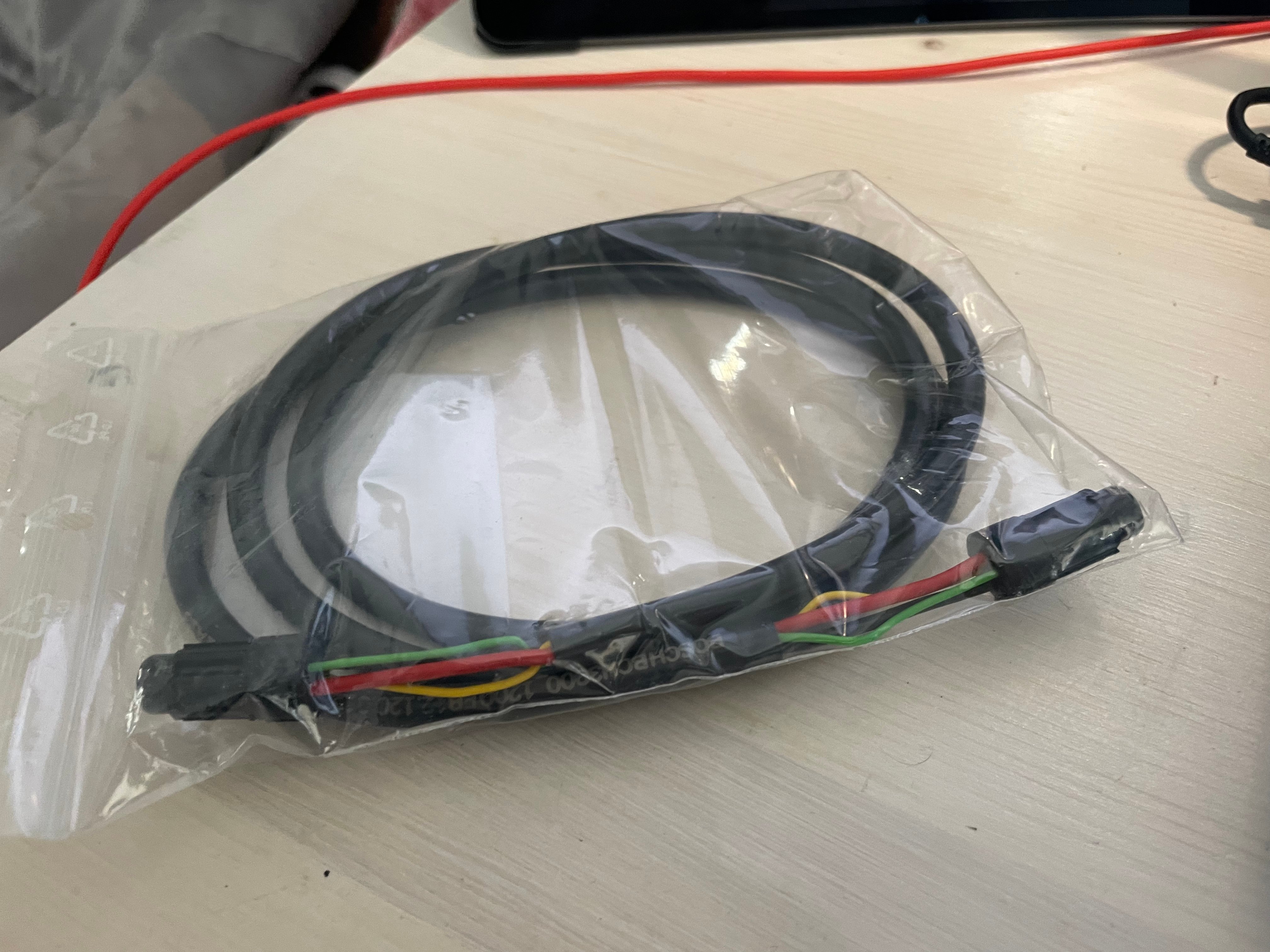

uses exactly the same plug/socket as my bike battery, and comes in a kit with the lead to plug the battery to frame port/socket.
Only snag is it's sold for a Mondraker bike with Shimano EP8 motor

I will find out soon as I ordered the 360wh Simplo range extender battery last night, probably take a little while to come as could only find stock in Italy.
I will report back once I get it with the results

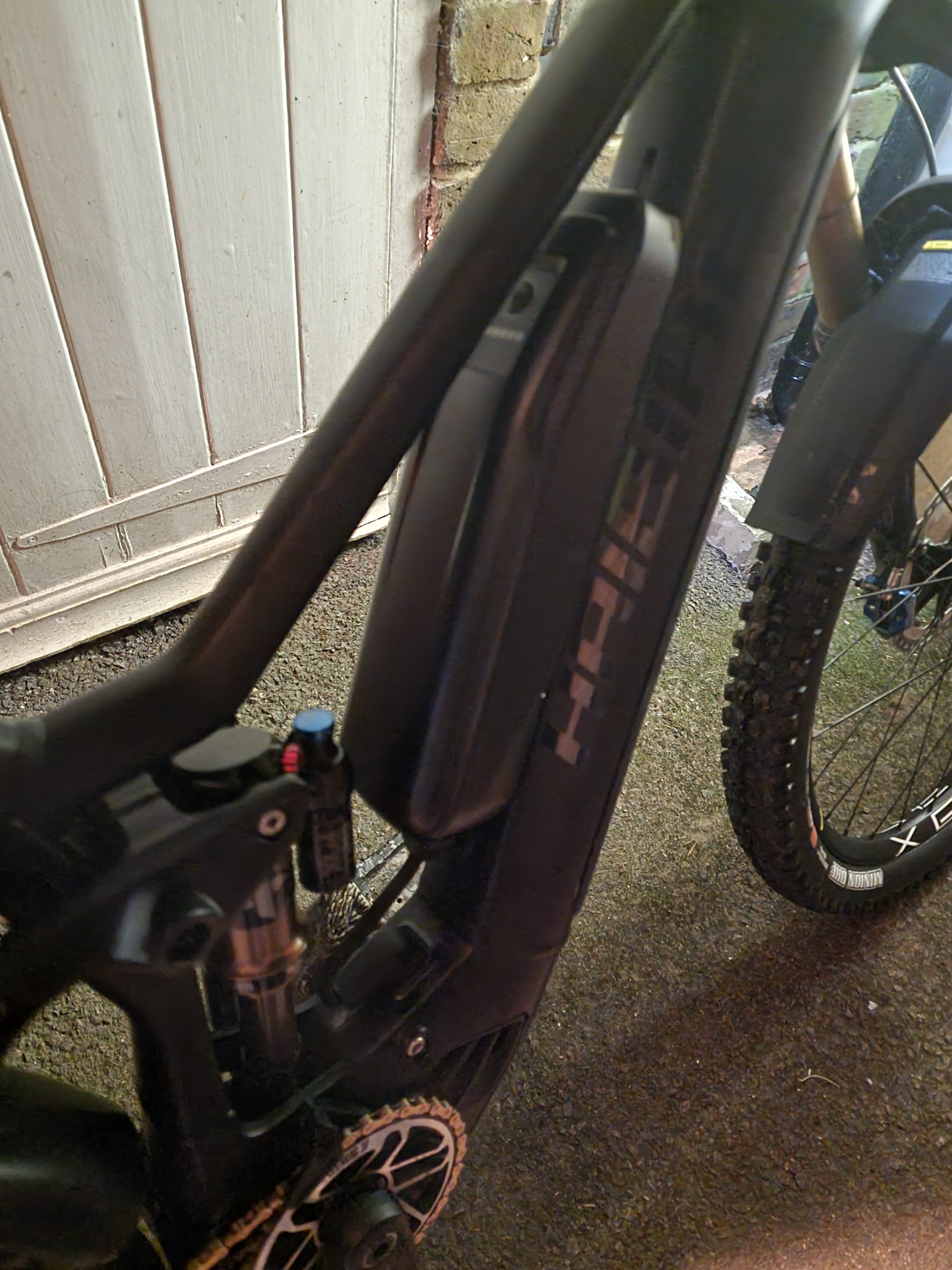

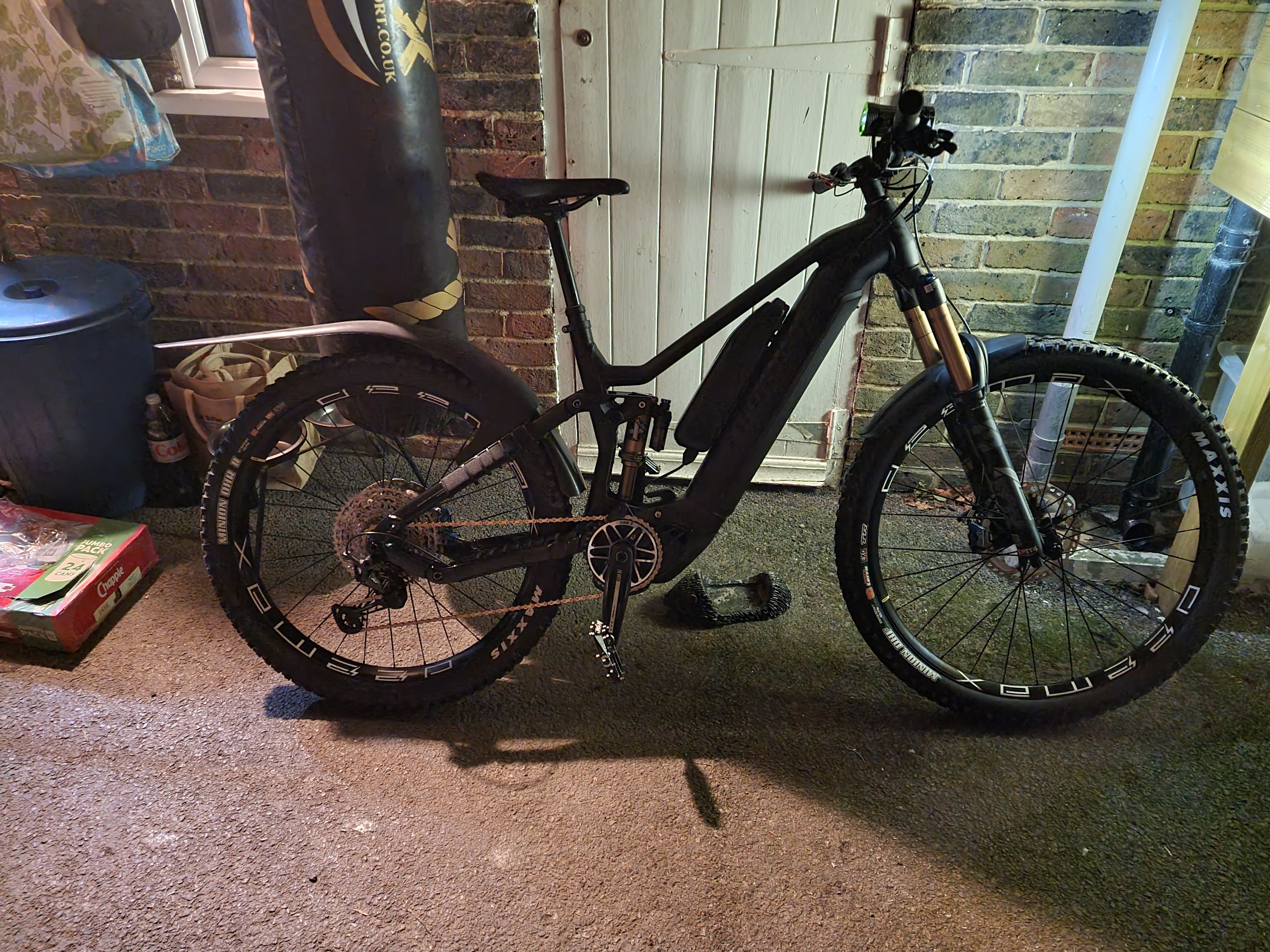

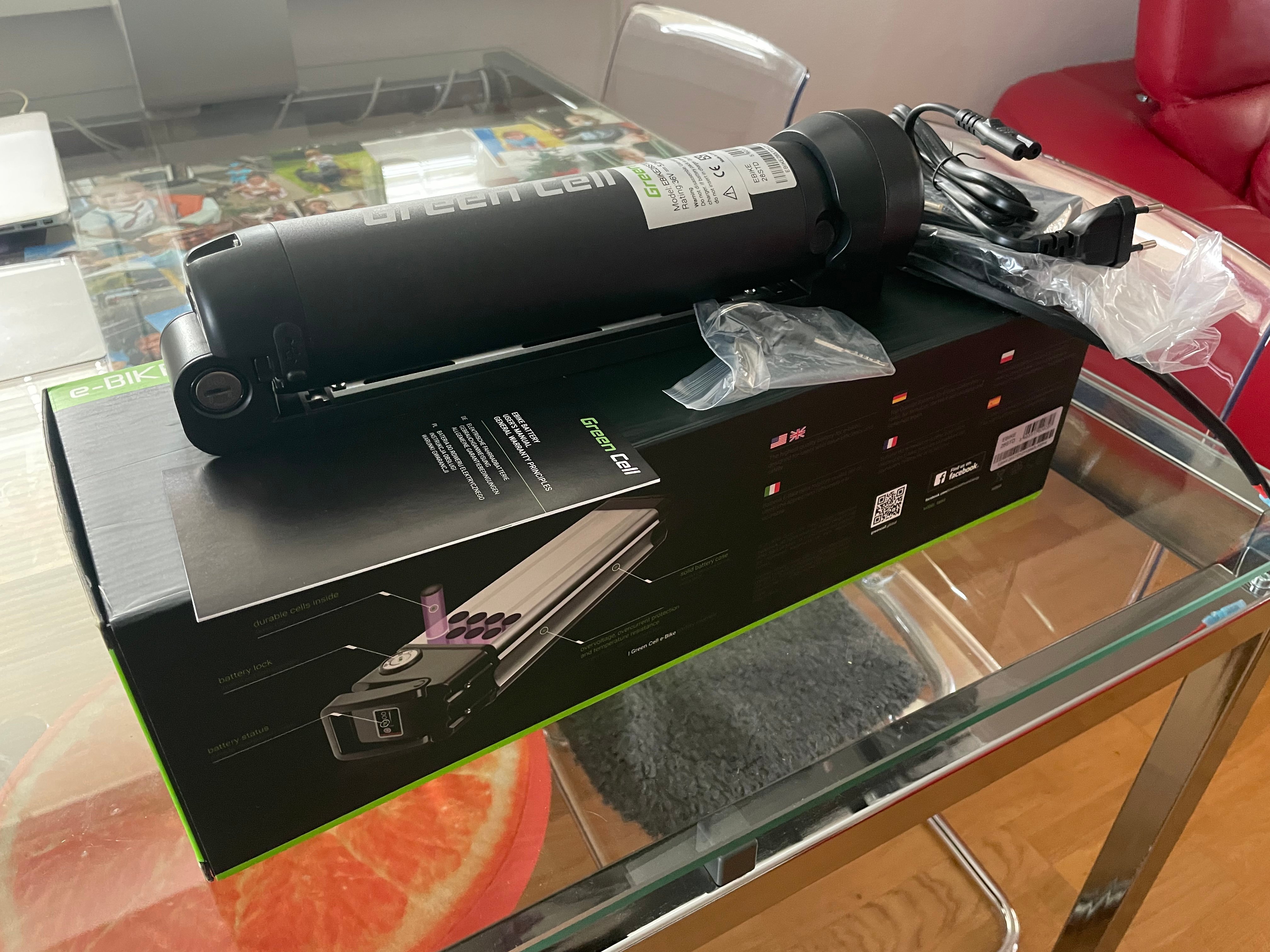

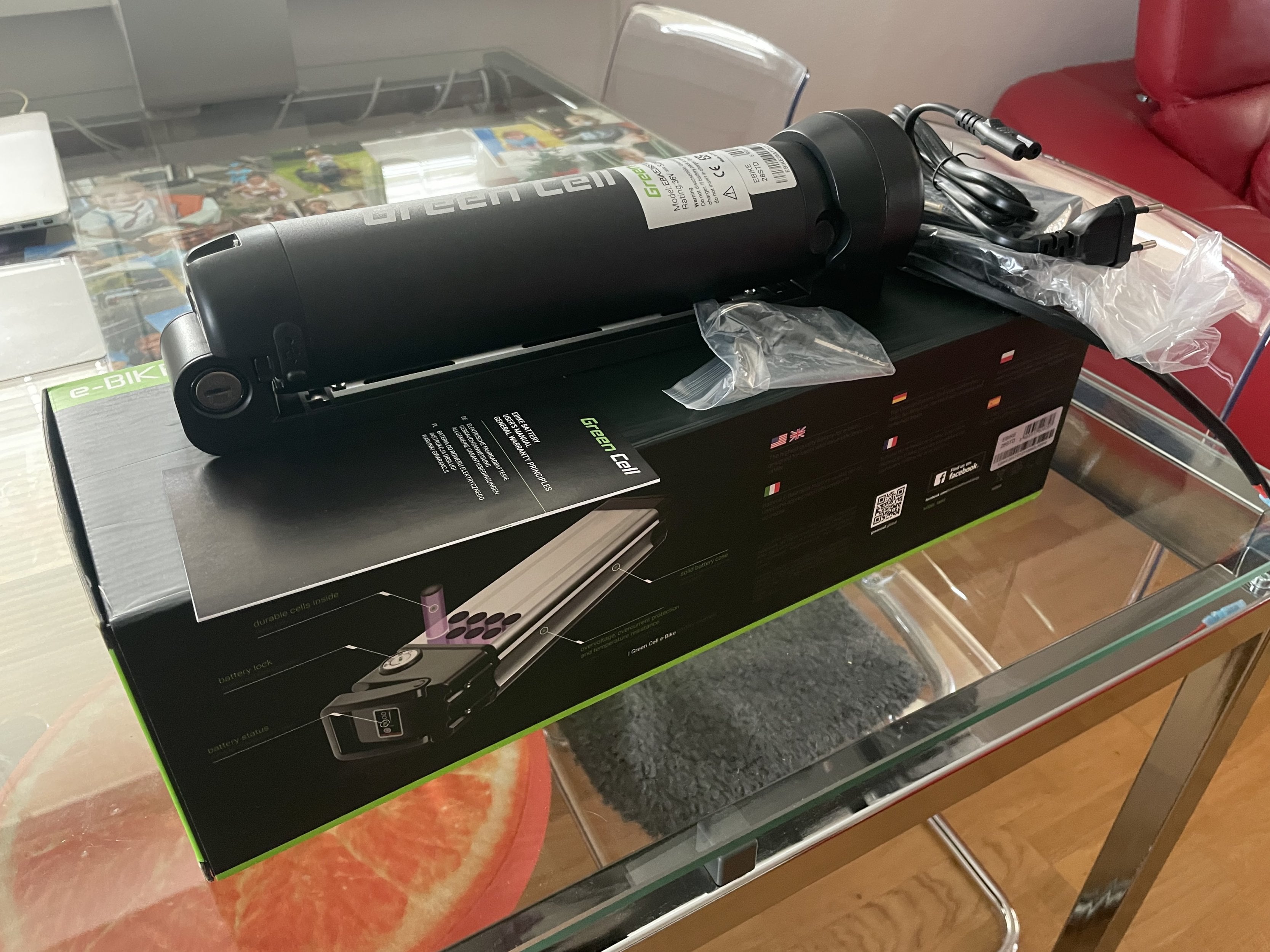

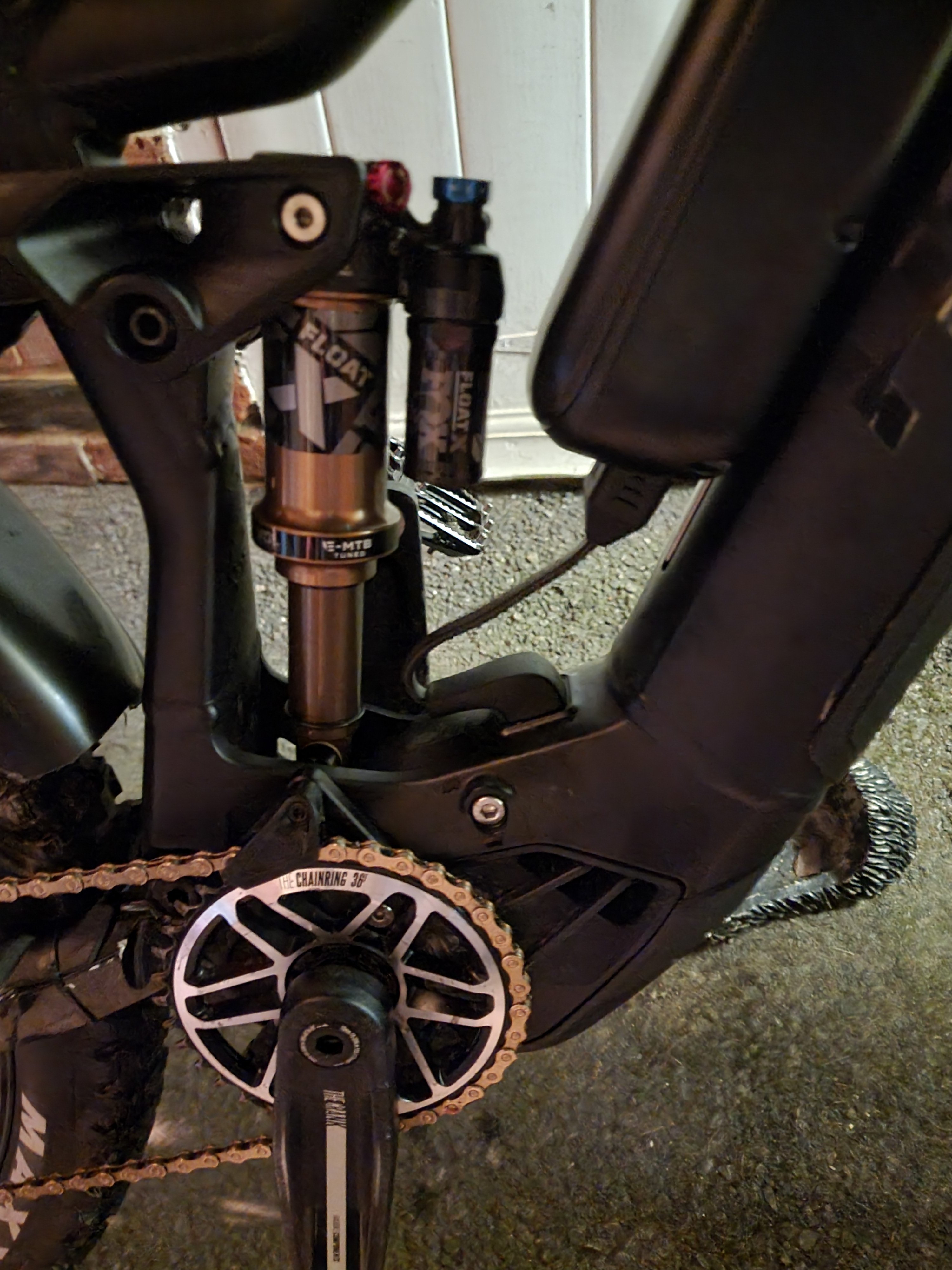

Battery kit came today, fitted it after work tonight.
Very close to shock, I need to double check it clears on full travel.
Is removing all the air best way to do that?
Not sure if it actually works or not yet, as no way to tell till I go on long ride, and hopefully find both batteries running down together.
I will test ride tomorrow after I've checked shock clearance
Chris808
Aug 17, 2020
51
31
Bolton
yes i think so , remove the air - only if you have a pump though to put it back..
hope its got enough space pal and eager to hear its working..
yes thanks for update.. nice pics, its nice a clean. Took mine Llandegla last week it was awesome..

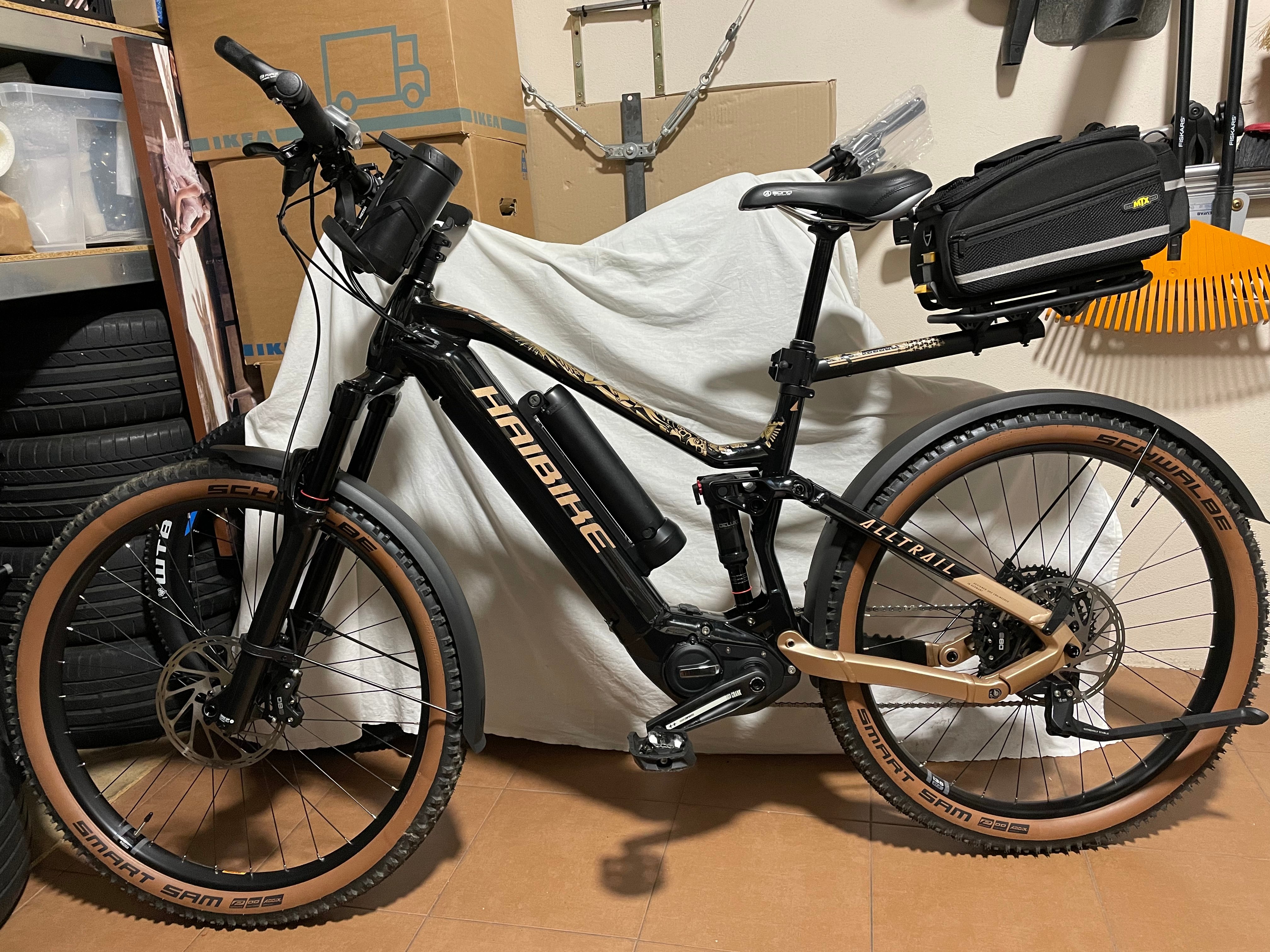

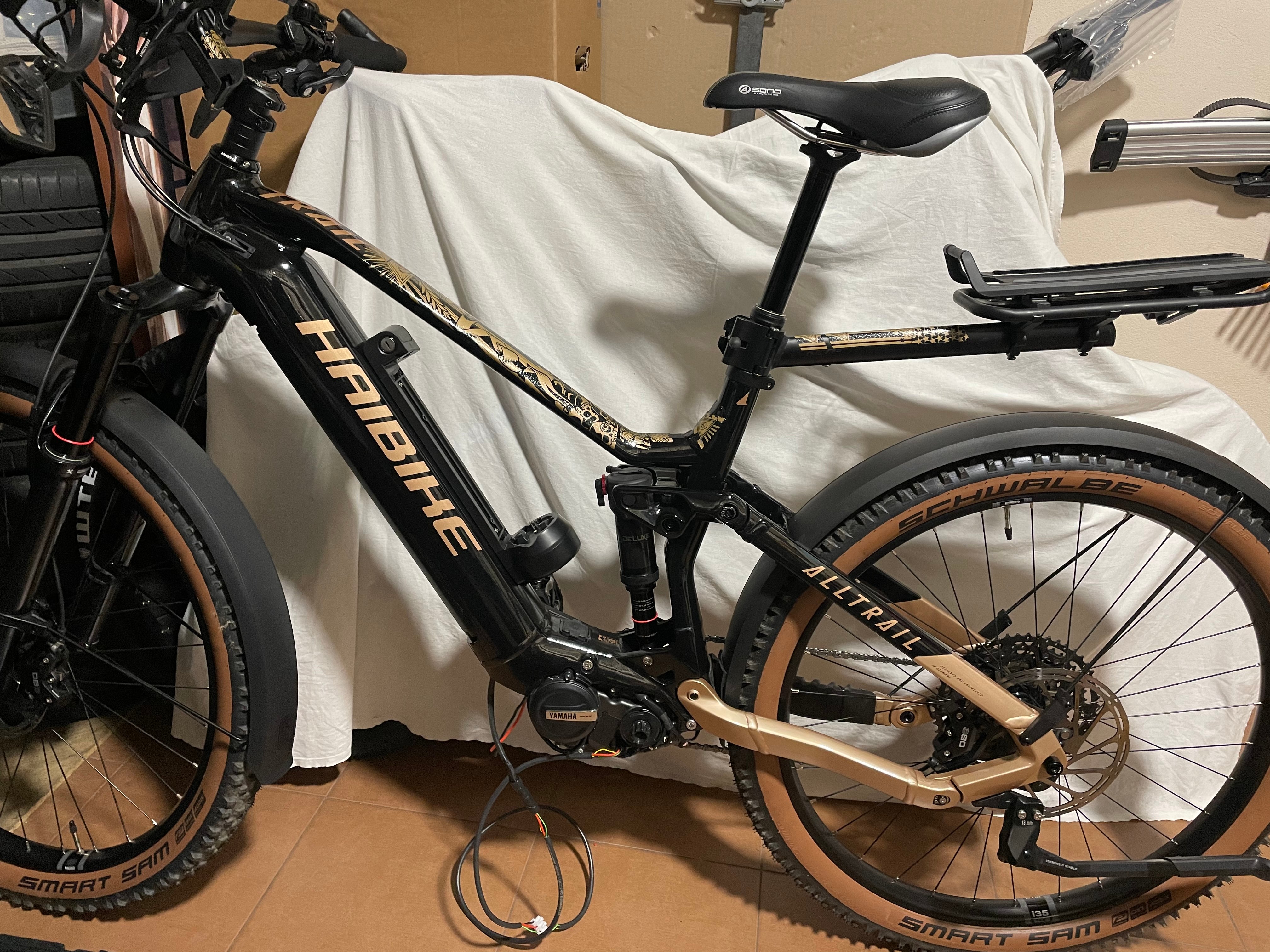

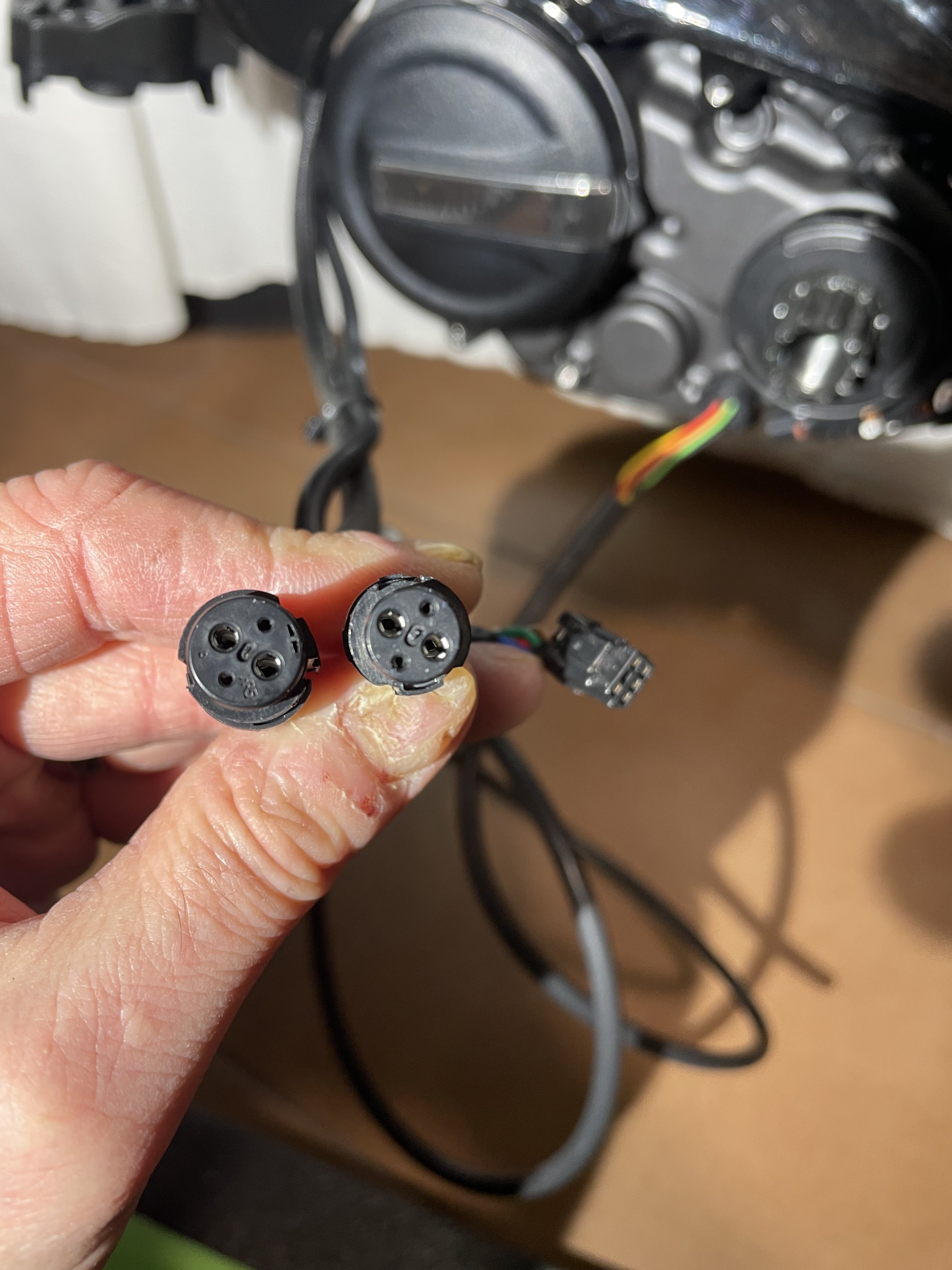

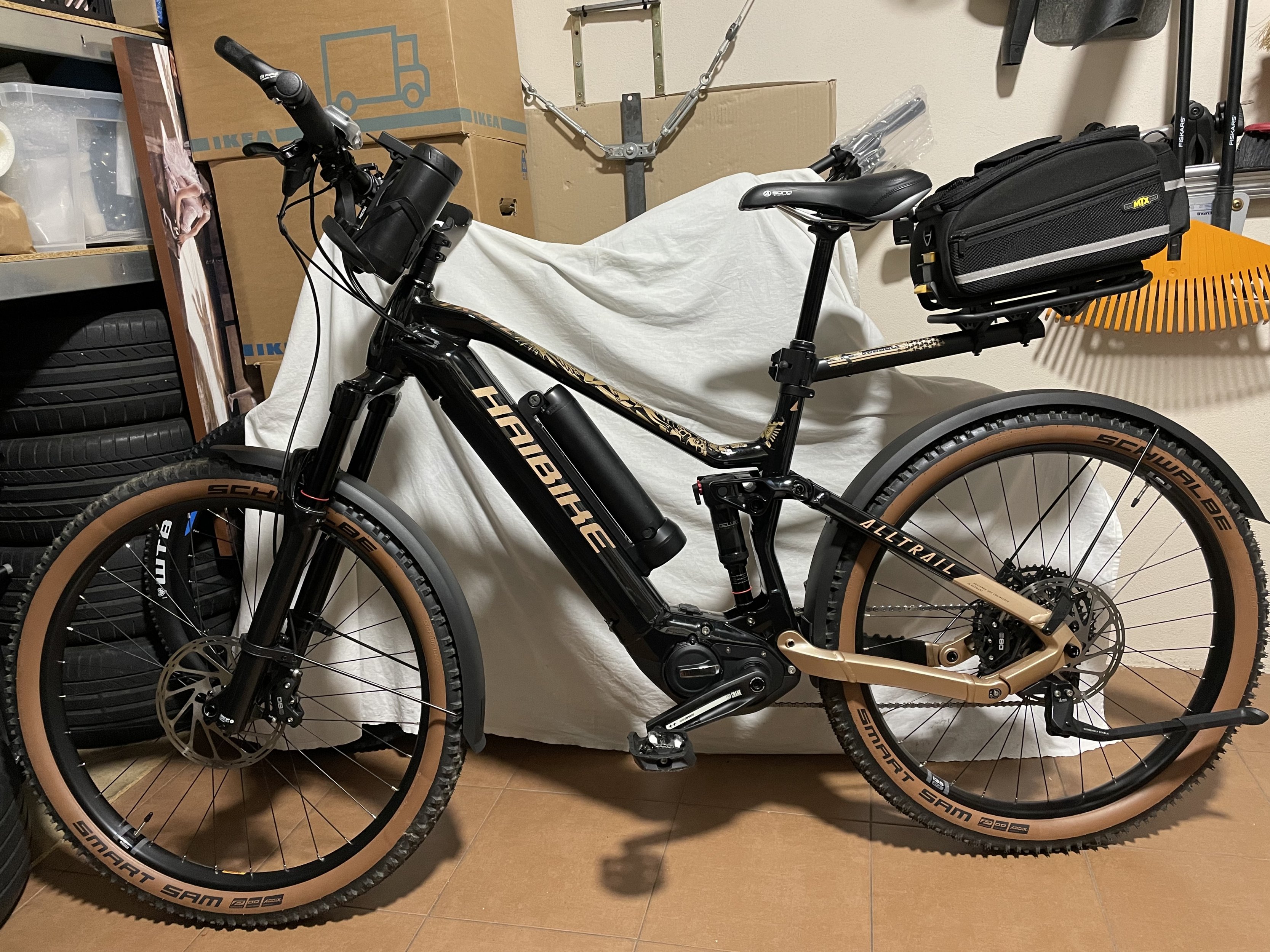

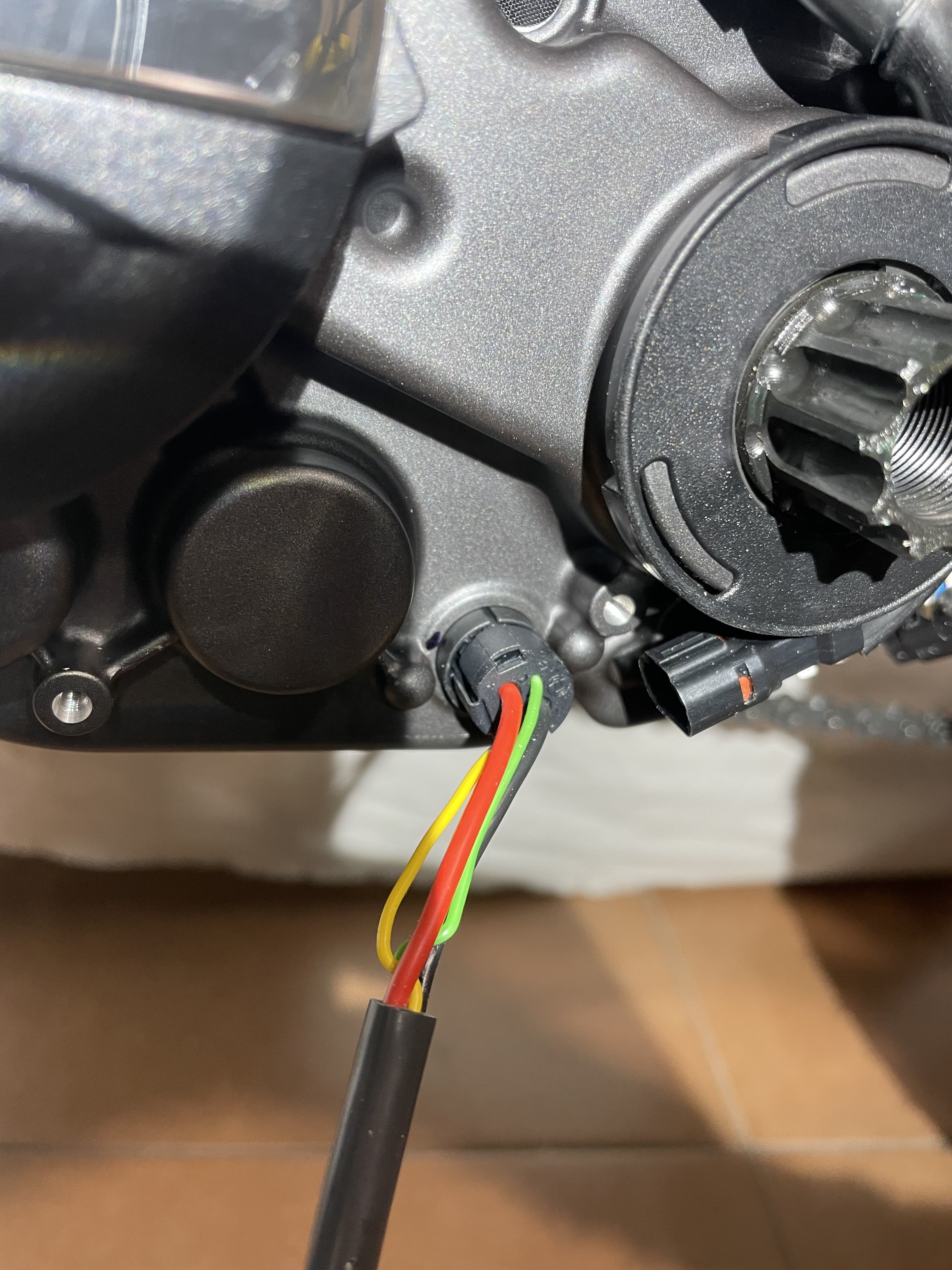

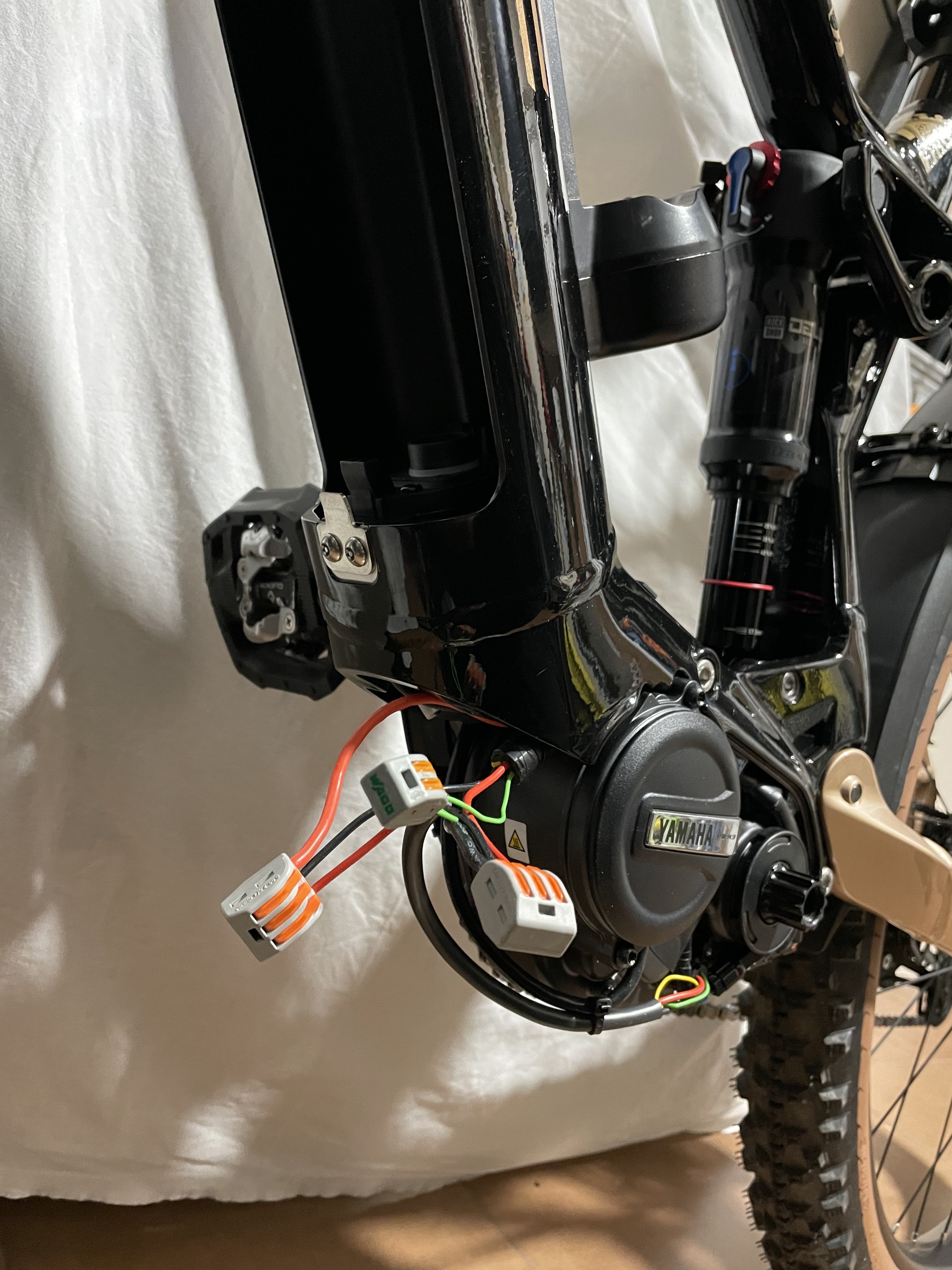

Hi, I'm trying to solve the same problem. I have a HAIBAIK Alltrail 7 with a Yamaha PW-X3 engine and a 720Wh frame battery. The original 360Wh extender is no longer available, and according to the manufacturer's response, there is a question as to whether it will be available at all. I am therefore trying to find a replacement. The solution you used looks really good. Can you please tell me if it works for you? If so, I would be very happy! I will try to attach photos where I tried to connect a 190Wh battery in parallel. Unfortunately, such a connection probably does not work, because after the ride the basic battery was almost discharged, while the additional battery remained fully charged.
3BF8CD6E-40A4-4C06-B6E3-511726B91C2D.jpeg DE1D4CCD-4B59-423C-8708-6A7C80FA711E.jpeg 8307C693-3A8A-48F5-B6FE-CCF6002277E1.jpeg DEE73E65-8EE8-404C-B42C-9A2612D3C0FF.jpeg 809AFACD-B58D-4DAF-B646-D5169716F653.jpeg C689C65F-0040-4074-A49C-2DC4938CB42F.jpeg D0318707-434C-46A5-8849-AC8B55F1925F.jpeg 0AAE174C-5DFF-41F6-B667-F64B98D3DECE.jpeg

Hi Vladimir
No not yet unfortunately.
I all connects up perfectly, but range extender battery won't lose any charge.

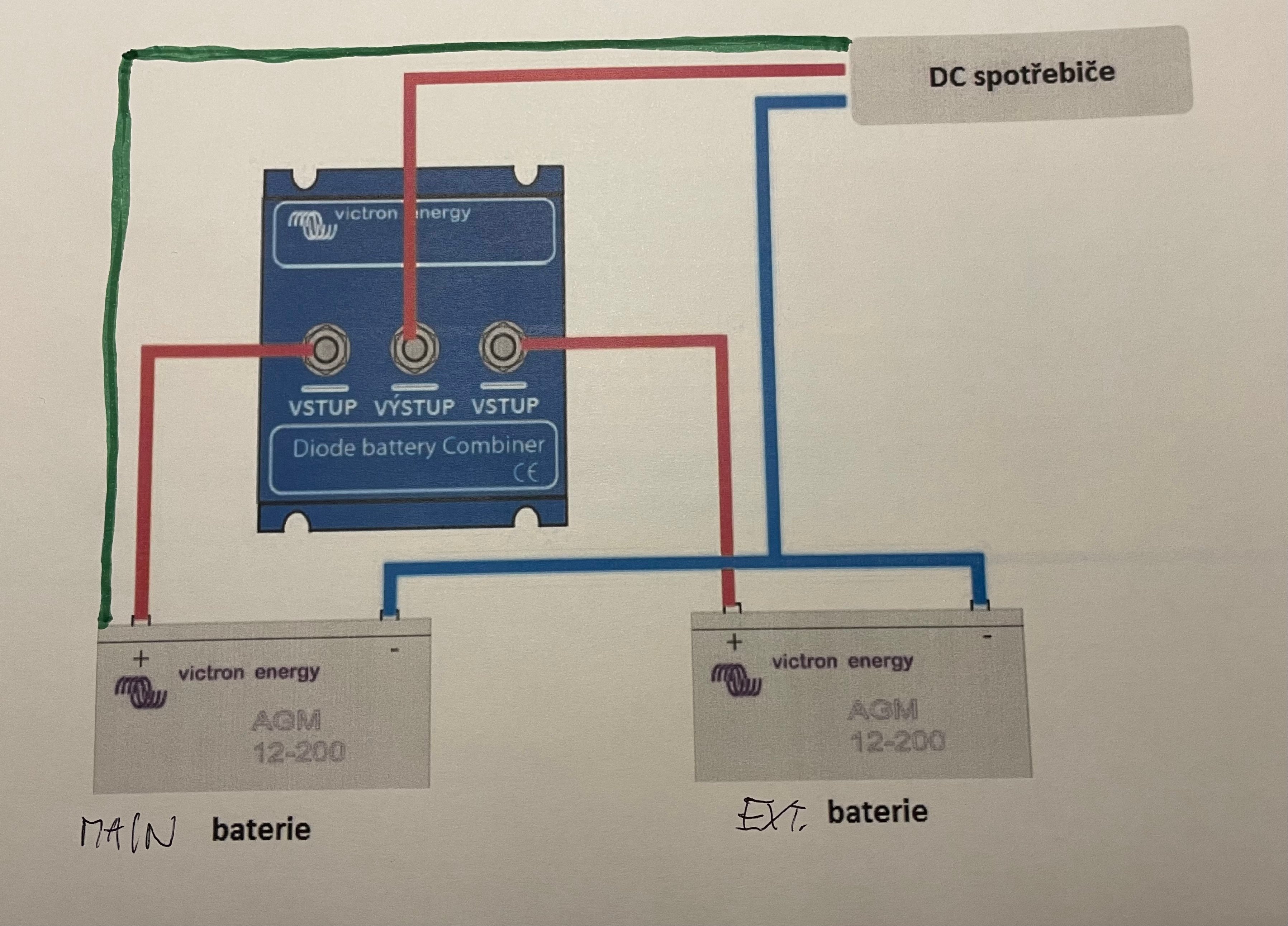

Vladimir Havalda
Feb 19, 2023
9
Slovakia
I found that the simplo batteries currently offered have the option of working with an extender
