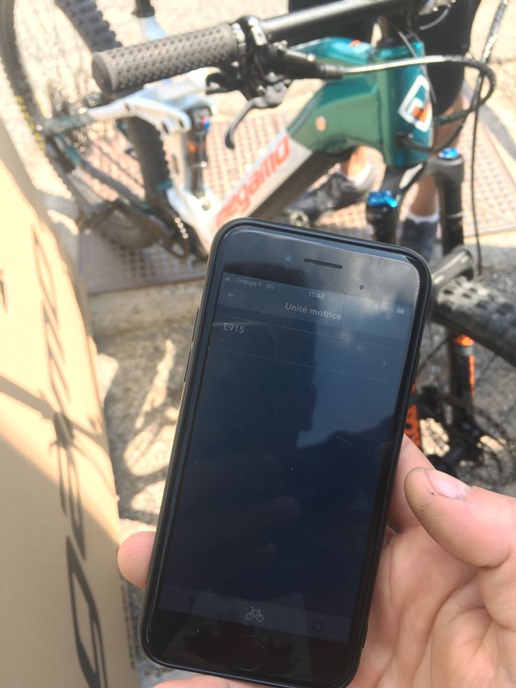

On 04/10/2023 I purchased the New Heckler 29 RSV XO with the new Shimano EP801 (latest edition)

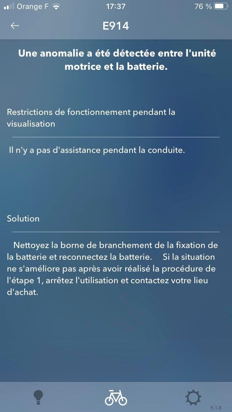

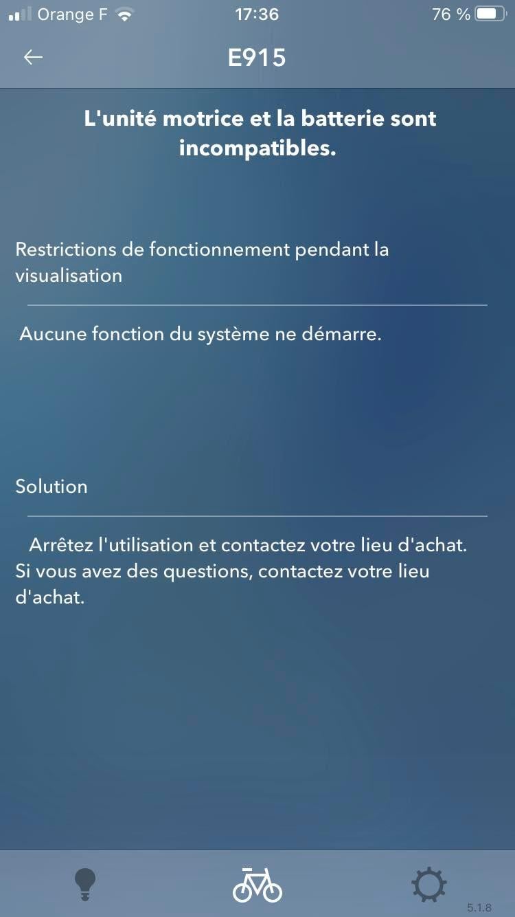

Yesterday, approximately 10 miles into its first ride, the bike displayed the following code: E914

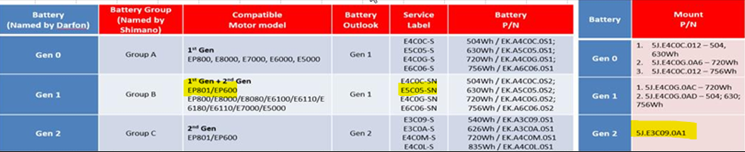

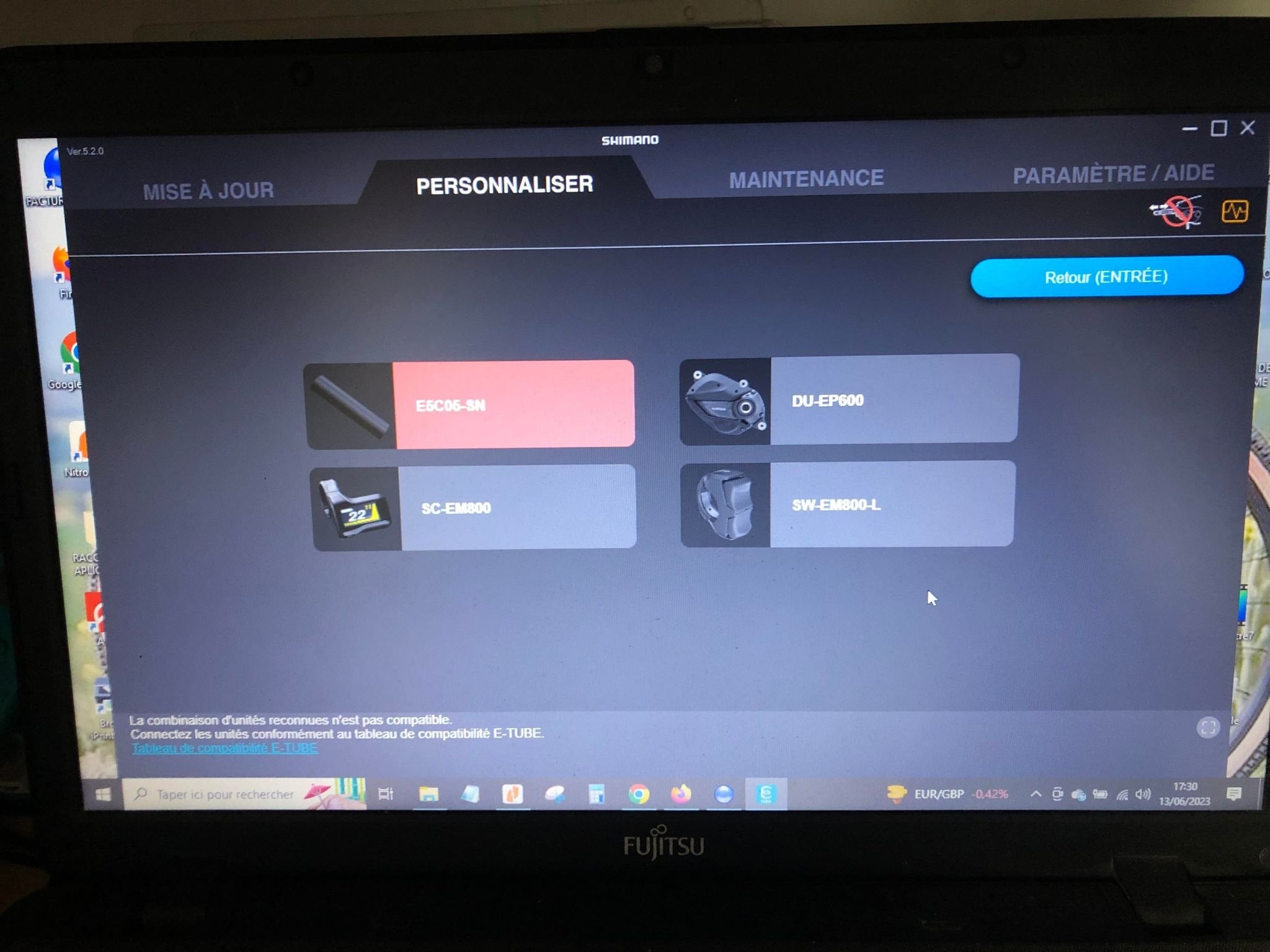

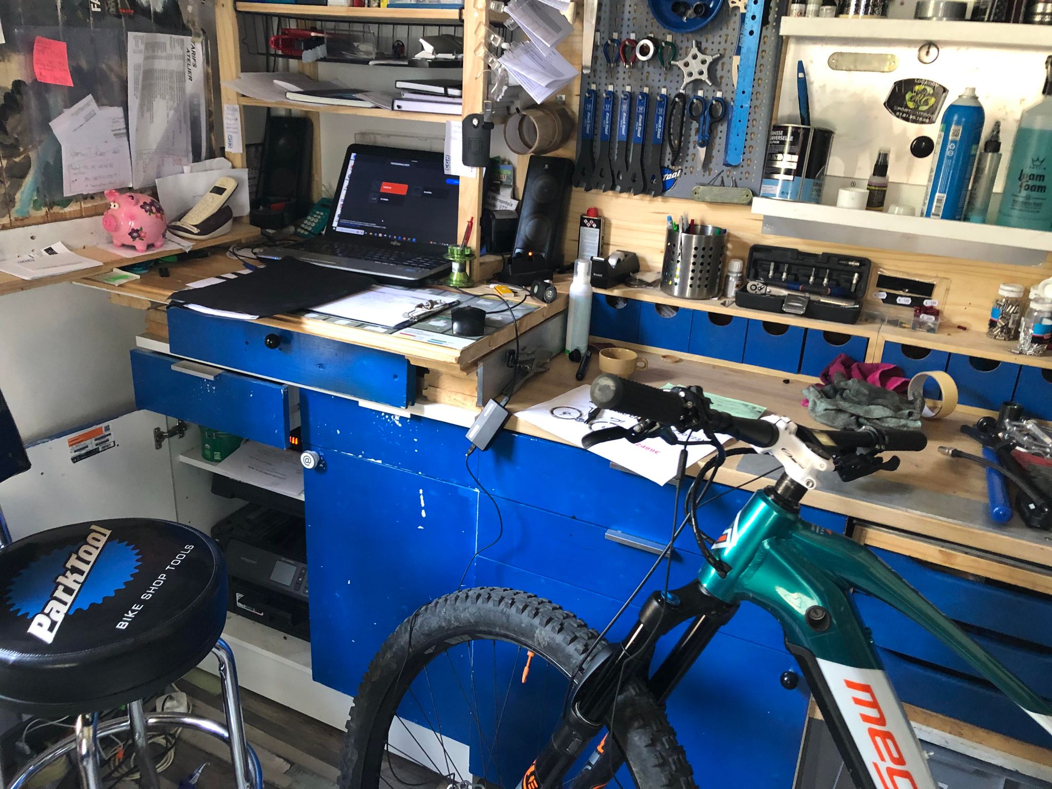

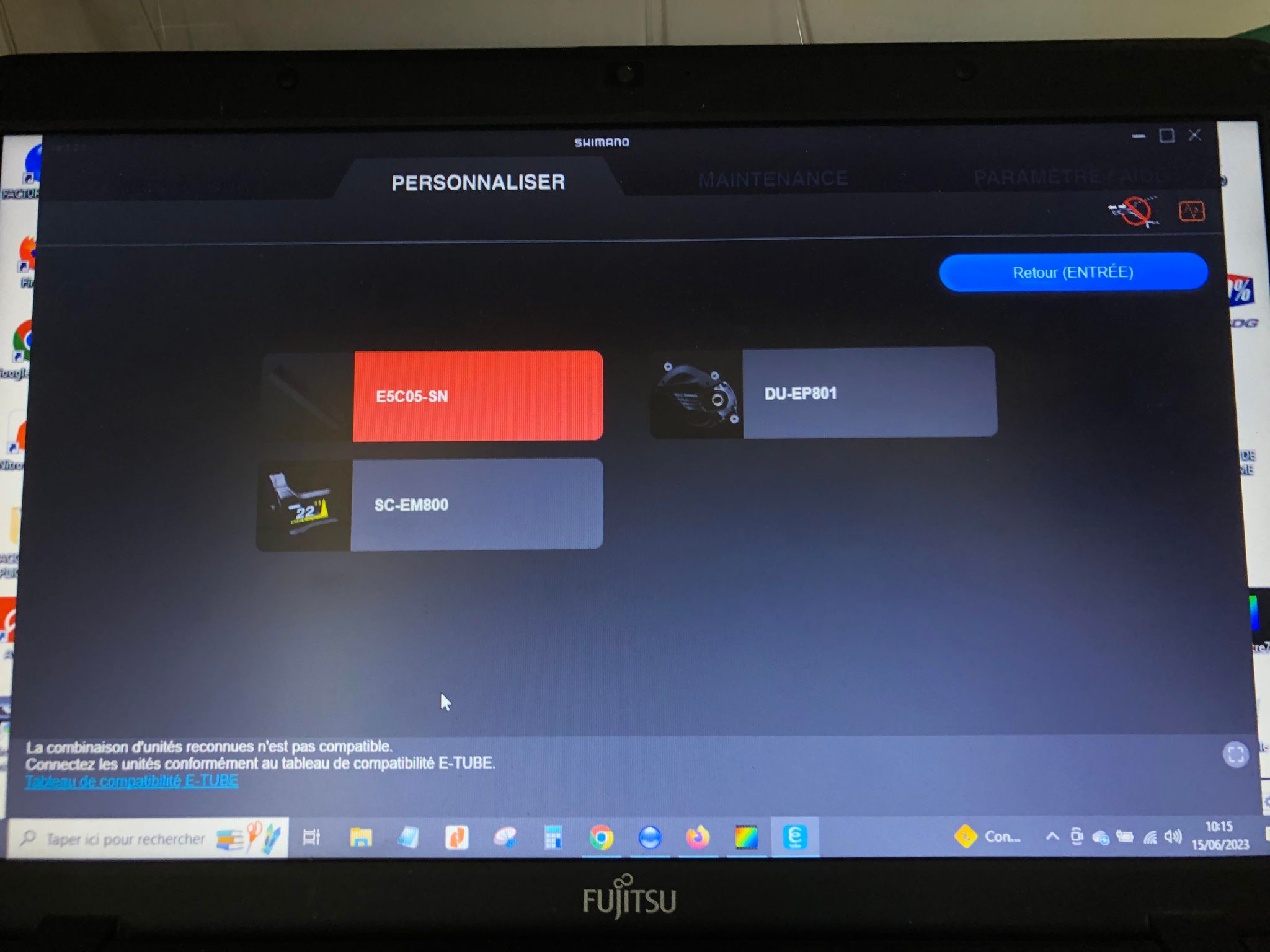

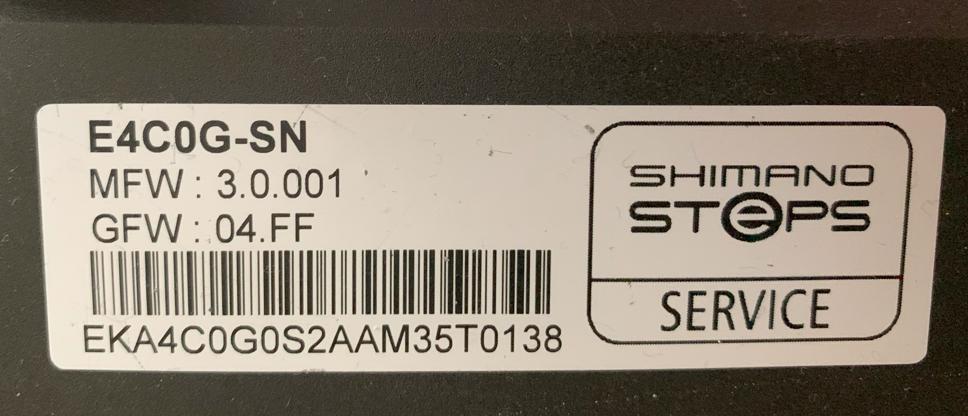

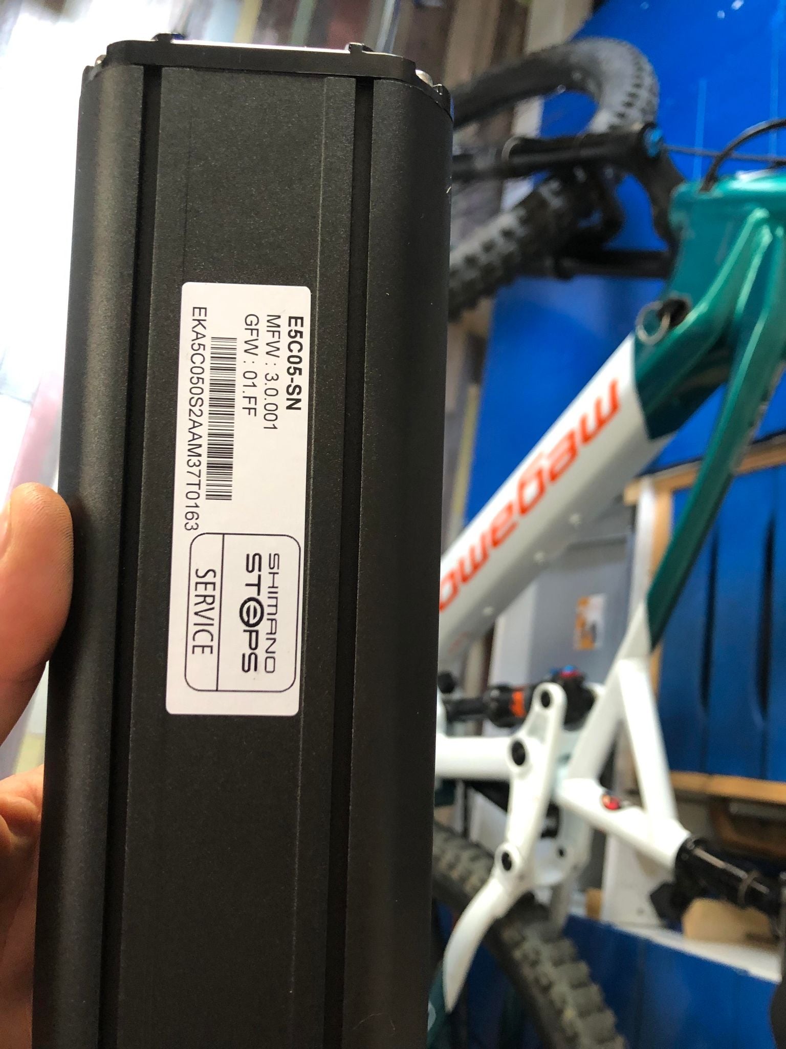

Hello, I'm Johan, cycle mechanic technician in my own cycle store in France. I have discovered for 1 week a problem on 3 ebikes out of 6 sold one of error code E915 -E914 DARFON 630wh battery associated with the shimano EP600 - EP801 engine on MEGAMO CRAVE AL mountain bikes
case in court with SHIMANO FRANCE and MEGAMO BIKES after-sales serviceTo find the problem I connect them to the shimano pro v5 software with the SM-PC02 and the battery and detected as incomptable = E915 and we cannot access the software system - it only works with the phone application:if the bikes like me are new, they run for a few km and this ends up creating the E914 code and cutting the engine (it goes into safety) seen with shimano the batteries that we reference E5C05-SN are a GEN2 which are compatible with the GEN1 = EP800
So the GEN1 are by conceqance incompatible
with shimano france we imagined that the problem might come from the DARFON battery support there is a connector reference compatible with EP600 / EP800 / E8000 / E7000 = GEN1
and the second
which is made only for GEN2 = EP600/EP801
my file is in progress, my it is a manufacturing problem which therefore comes from DARFON do not hesitate to create your after-sales service file with the photo of the bike connect to the shimano software the battery turns red and take a screenshot with your telephone it is necessary that one proves that there is a problem of world manufacture.
do not hesitate to contact me if you have any information or to send an email of your return from the manufacturer, this may make the problem progress in Europe.

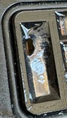

E914 is always a clear indication that there is a contact problem between battery and drive unit. This mostly is due to a contact problem (bent, dirty or corroded contact) at the connector from the battery to the receptacle inside the frame. Always take extreme care when detaching and attaching the battery from and into the frame and also never, ever use a high pressure water cleaner (not even a strong garden hose) to clean any Shimano STePS based bike - otherwise this most probably will ruin your day soon. Also check that the battery compartment is water proof and get some sealing if it is not. Ans also check that the battery sits tightly in its position and is not "wobbling around" when riding and so is wearing of the contacts of the related receptacle contacts.

what's the référence name of the ep801 darfon 720w ?
There is no "EP801 darfon 720w"!
There are many different batteries with a capacity of 720Wh of the Taiwanese battery manufacturer Darfon which are generation 2 types (which are necessary for the DU-EP801 drive unit), one of them is the "E4C0G-SN" type with a nominal capacity of 726Wh which is very often used by many bike manufacturers:
Also electrical energy (capacity) is always measured in "Wh" (watts multiplied by hours) not just "W" (power is measured in Watts), so please don´t forget the "h" in the physical unit to be a bit more precise and so avoid possible misunderstandings. ;)

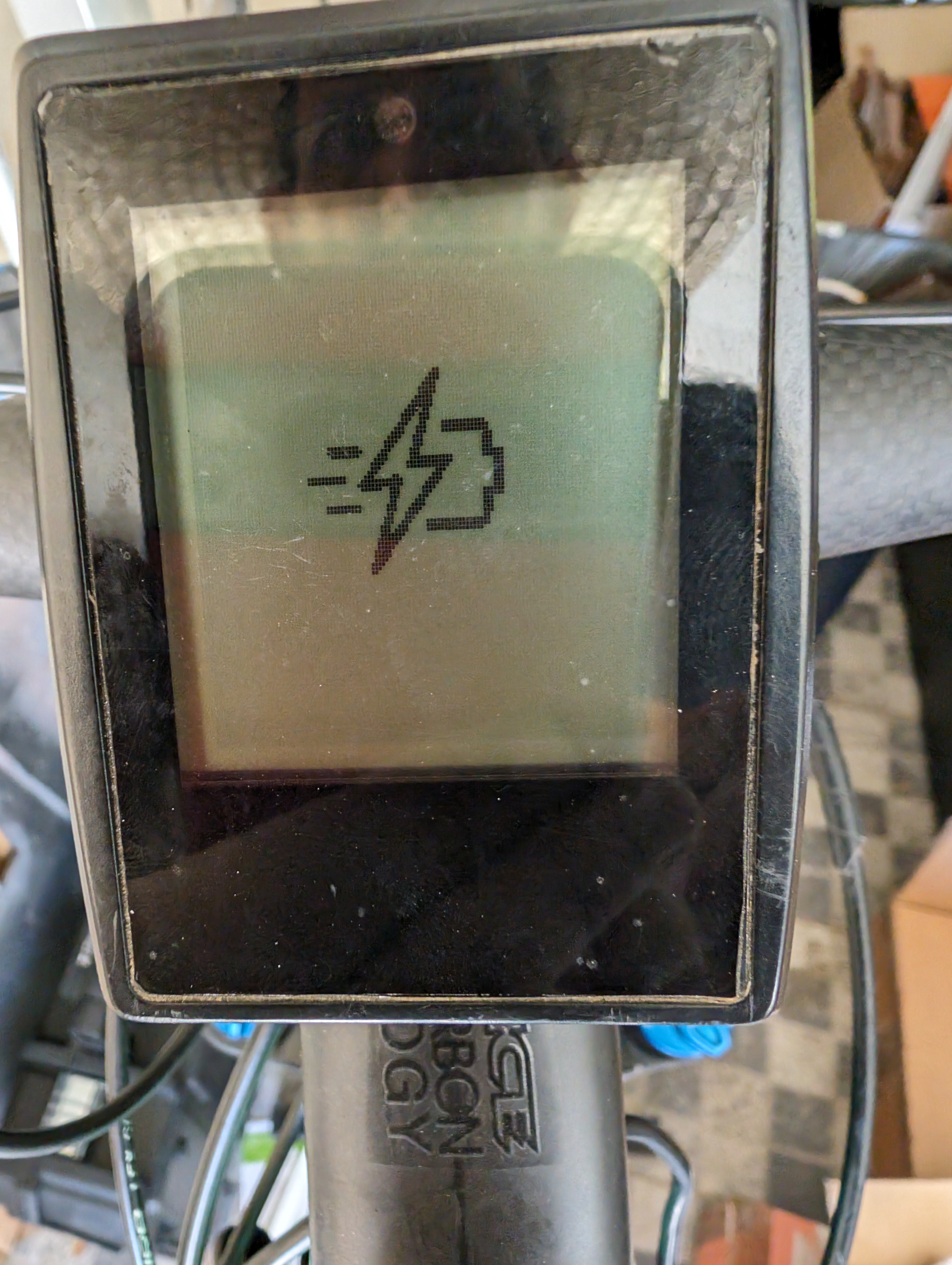

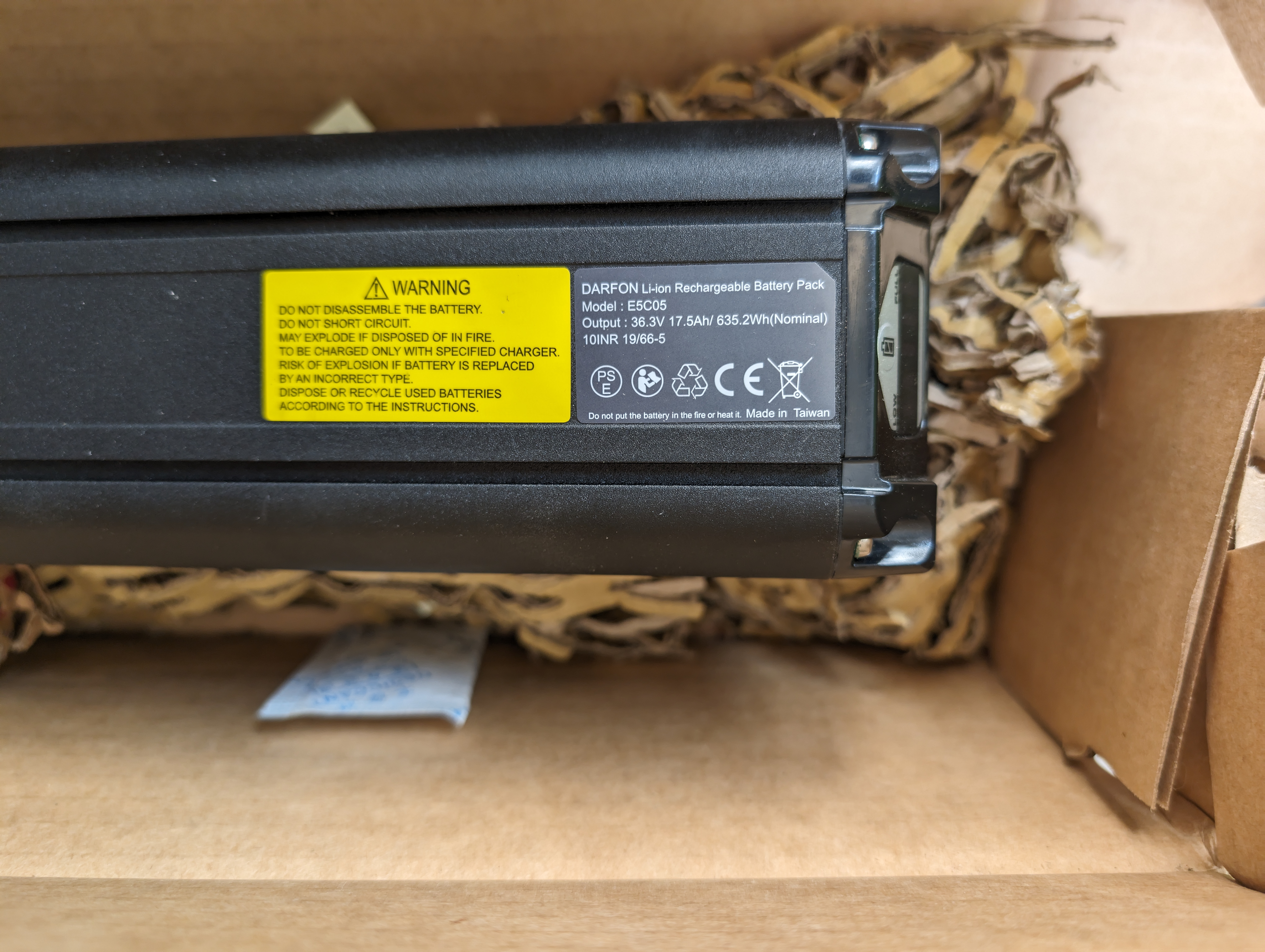

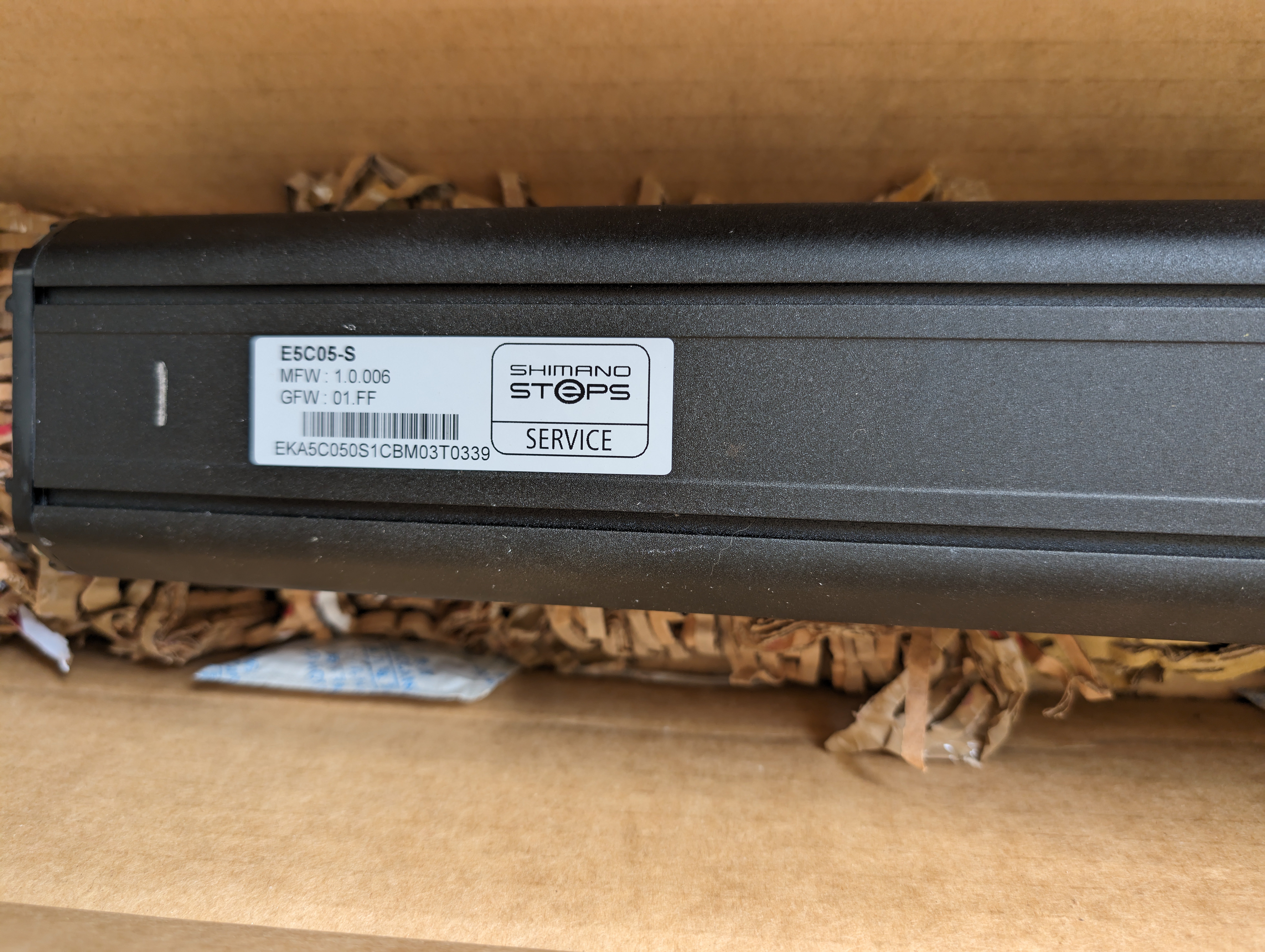

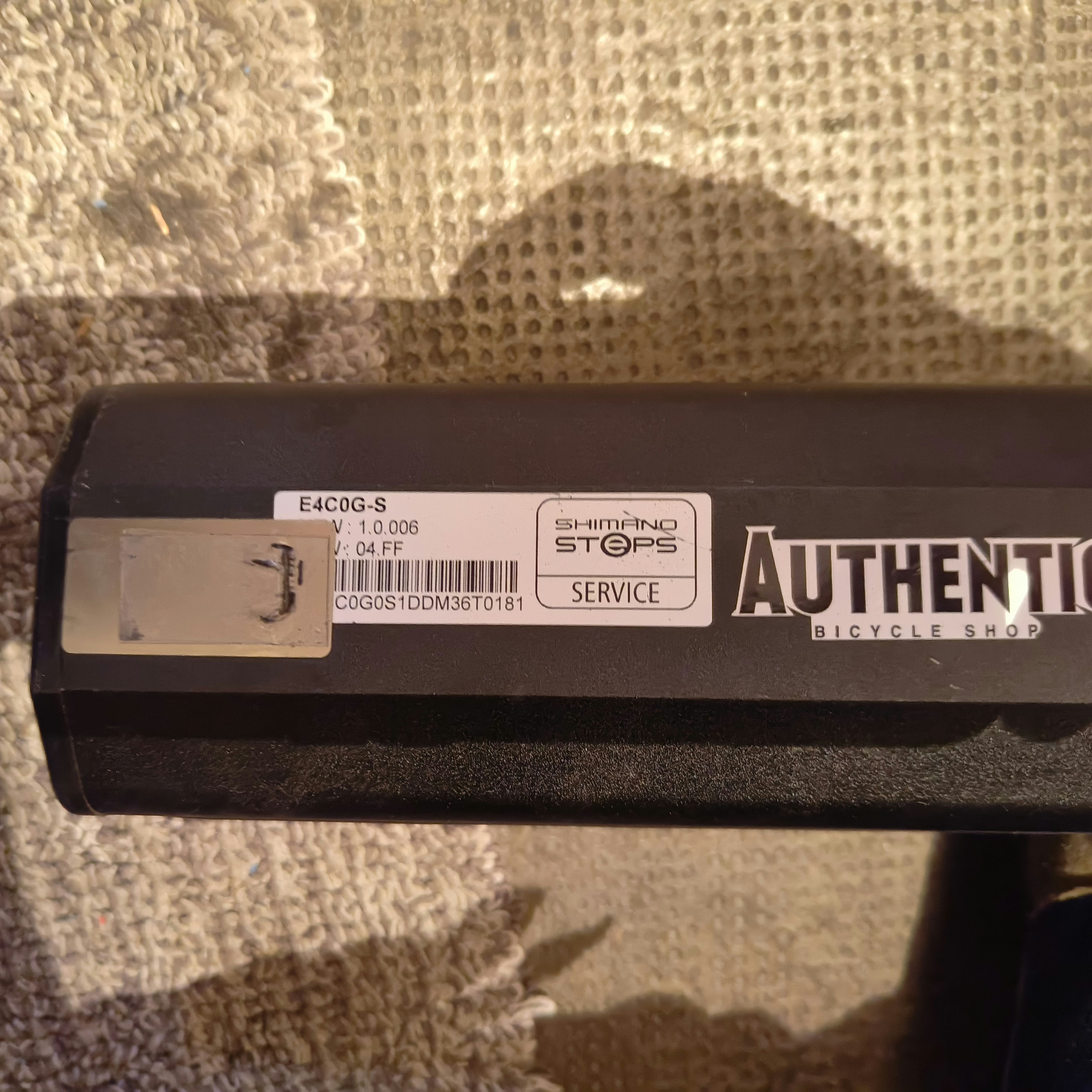

I'm new to ebikes. I bought a second hand Bianchi rebel 9.1 with an Oli Sport motor and a darfon E5C05 battery.
Decided to buy a used spare battery, same E5C05 that came with the bike but it shows the display error I attach. It makes imediatly the motor to work but I can't change the display in any way, choose level or turn the motor off (turn off all system is possible with the same button used to start it).
Is it a firmware issue? Can be changed?
View attachment PXL_20240422_102108869.RAW-01.COVER.jpg View attachment PXL_20240422_102305065.RAW-01.COVER.jpg View attachment PXL_20240422_102310474.RAW-01.COVER.jpg
View attachment 139066 View attachment 139067 View attachment 139068
These are 2 completely different battery packs (looks the same, have the same battery cells inside, but have a different battery firmware).
You cannot change the firmware of the BMS (battery management system, the electronics inside the battery) by yourself So most probably the spare battery (programmed for a Shimano bike) will never work with your Bianchi bike.
Sorry to say that...

The Heckler arrived yesterday and I’ve spent the morning installing apps, creating accounts, setting up the suspension, bolting on pedals and general new bike faffery 😂
With regards to the updated connectors to the gold style I don’t seem to have gold male terminals but there are gold female terminals within the battery. Is this the updated version?
Also added a smear of dielectric grease to the female terminals that will transfer onto the male as the battery is inserted 👍🏼

There seem to be different versions of the connectors from DARFON, see here.
Is there really a self adhesive seal on the female contacts of your new battery which you need to remove?
Or is that maybe some contact gel which needs to be there and should prevent E914 errors?
That looks really a bit strange to me (what is that???)...
However, enjoy your new bike :)
1210tech
Jul 11, 2024
15
11
It would appear that the revised version is the gold female terminals 👍🏼
The gunk on the terminals is dielectric grease that I have just added. It helps to stop dirt ingress and corrosion and prevent the E914 error, hopefully 🤞🏼
