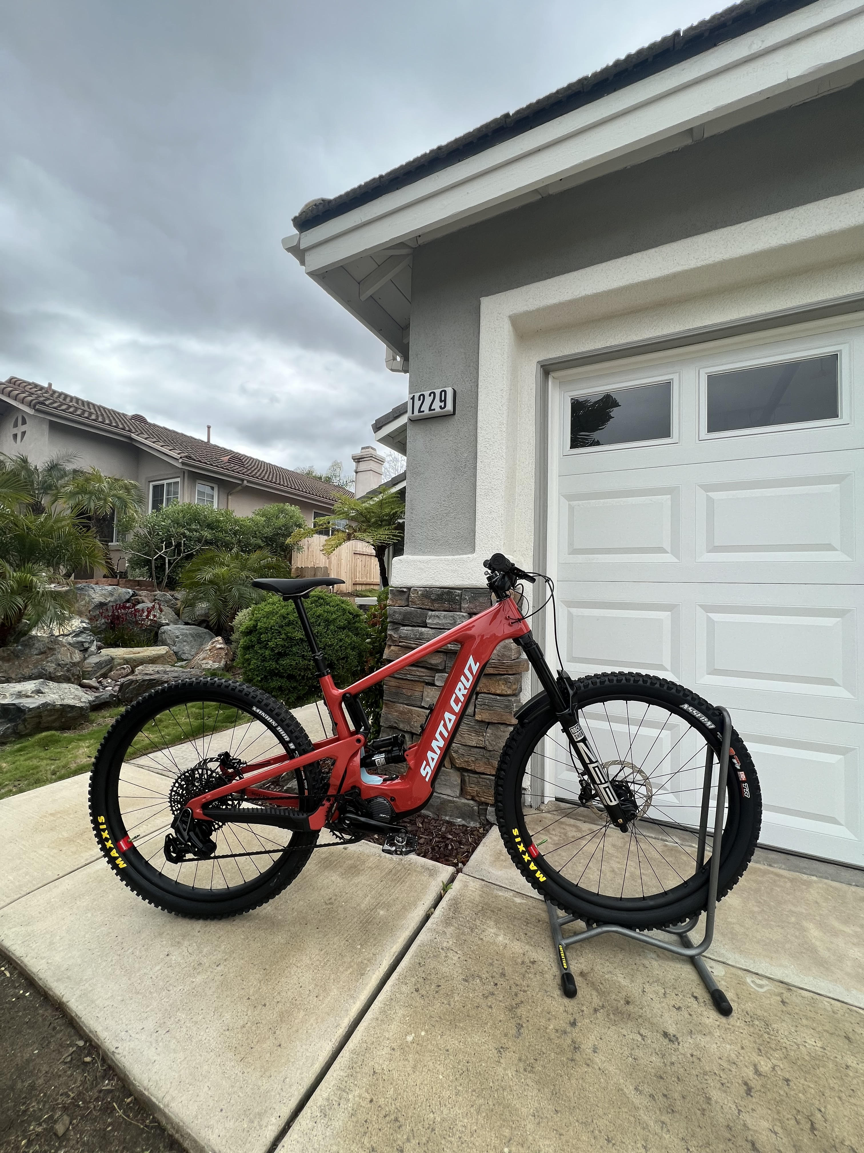

On 04/10/2023 I purchased the New Heckler 29 RSV XO with the new Shimano EP801 (latest edition)
Yesterday, approximately 10 miles into its first ride, the bike displayed the following code: E914
My initial research leads to cause of failure being an abnormal condition has been detected between the drive unit and the battery. Displayed operating restrictions, support will not be provided while driving.
Remedy - Clean the connector of the battery holder and reconnect the battery. If situation does not improve after step 1, stop use and contact the place of purchase.
I'm very annoyed having to post this. I'm hoping someone has feedback that has maybe already experienced this and has found the remedy.

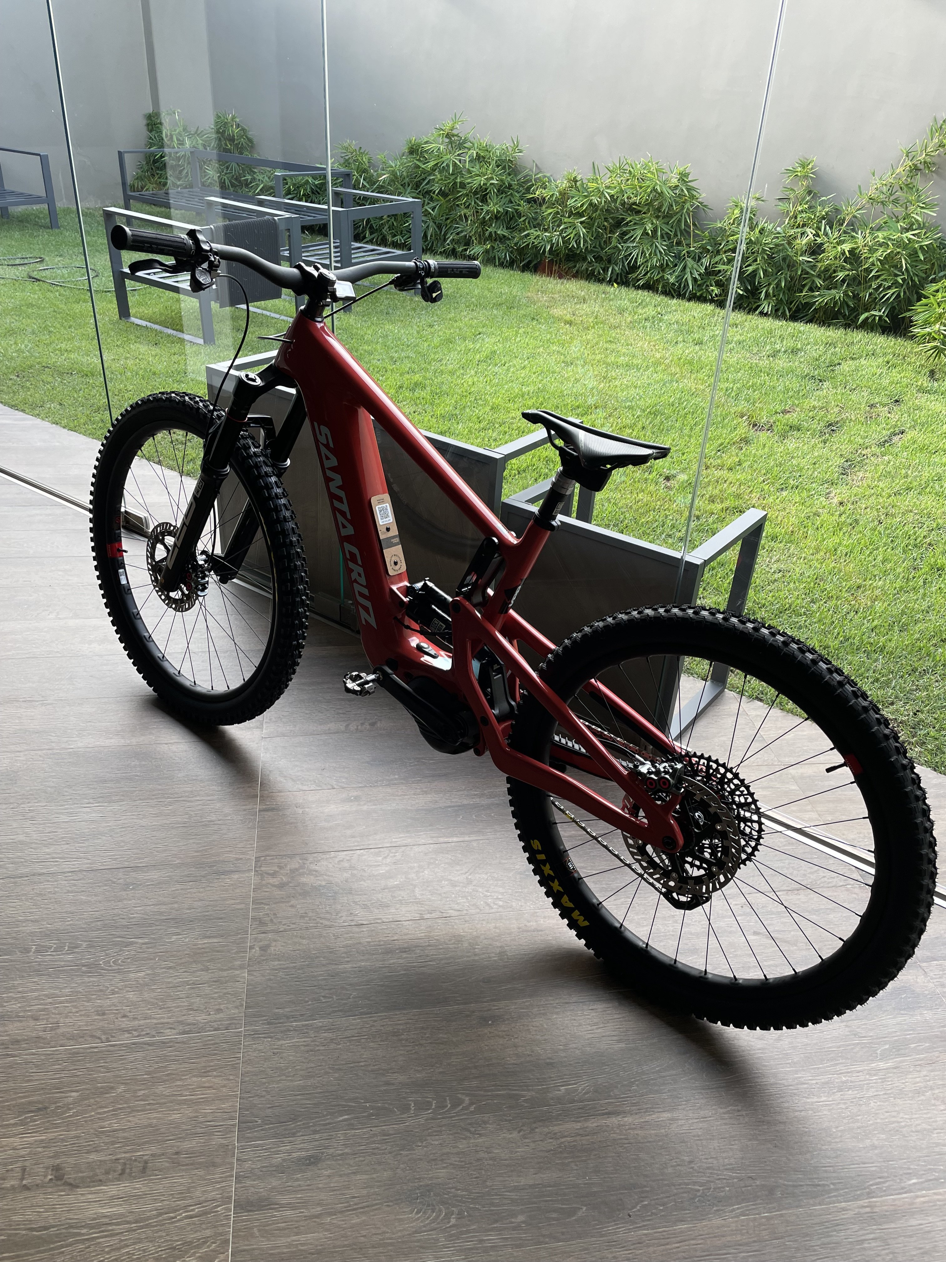

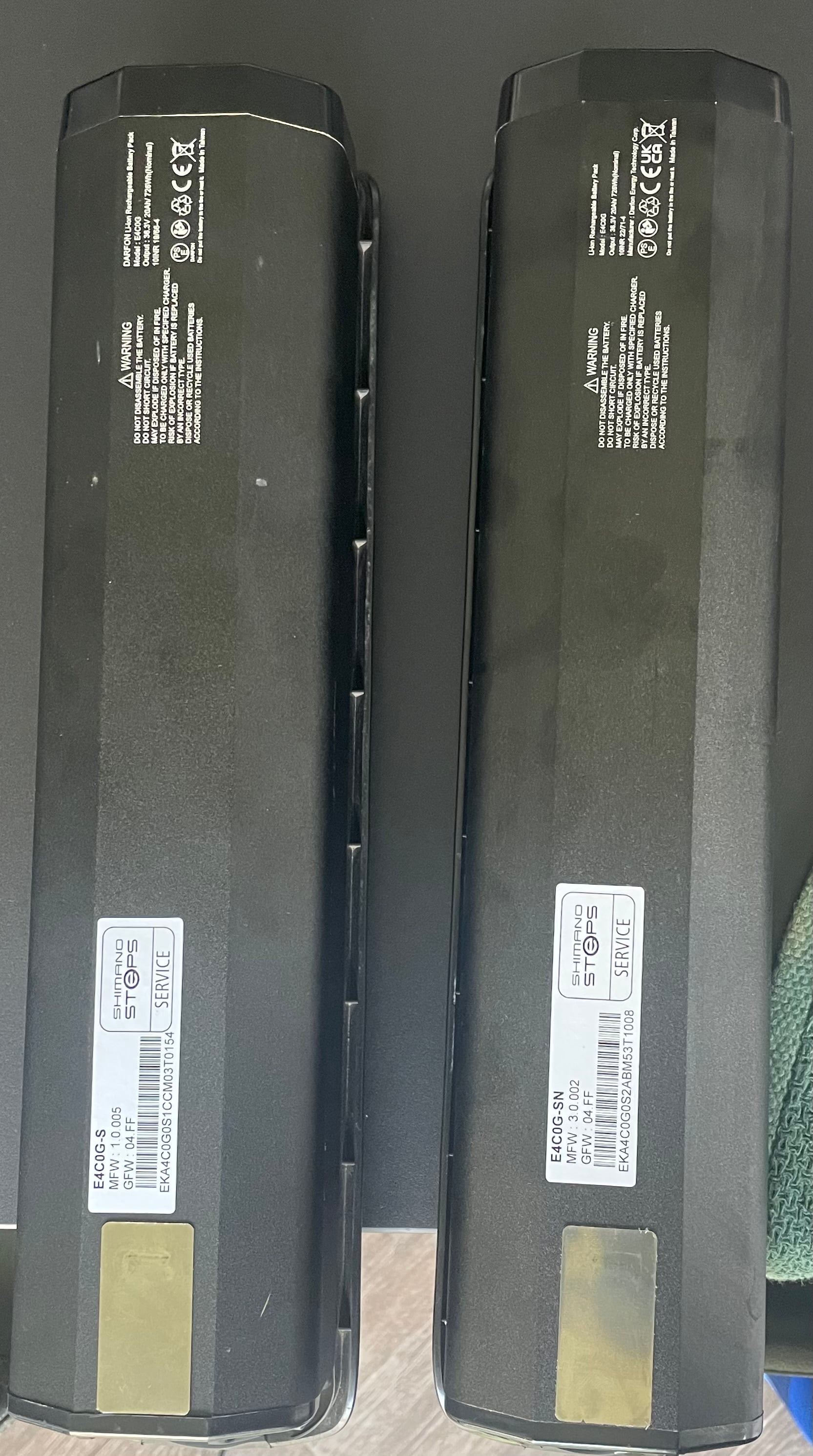

In theory the EP801 will only work with "gen2" battery system batteries (with some exceptions - the Orbea Rise's seem to be working for example with third party batteries).
I think the original Darfon 726wh battery was the E4C0G (3.8kg/397.6mm). The newer one is the E4C0M (4.1kg 410mm).
No idea which one they're using in this bike. Could be the older one on some and newer on others ?
Presumably as this isn't happening to everyone, maybe it was working and there was an EP801 firmware update which now means it's not working ? ... or well, a million other things !
Jorgeferrari
May 9, 2023
8
Miami
Hello, yes, that's correct. The previous model's Darfon battery fits perfectly in my SC, but it doesn't power it on because they have different firmware. In the picture, you can see that the battery on the left is for the EP8 motor and the right is for the EP801.
By the way, I encountered the E914 error again. I removed the battery, waited for 3 minutes, and then reinstalled it, and it worked without any issues. However, I'm not sure how long it will last.
