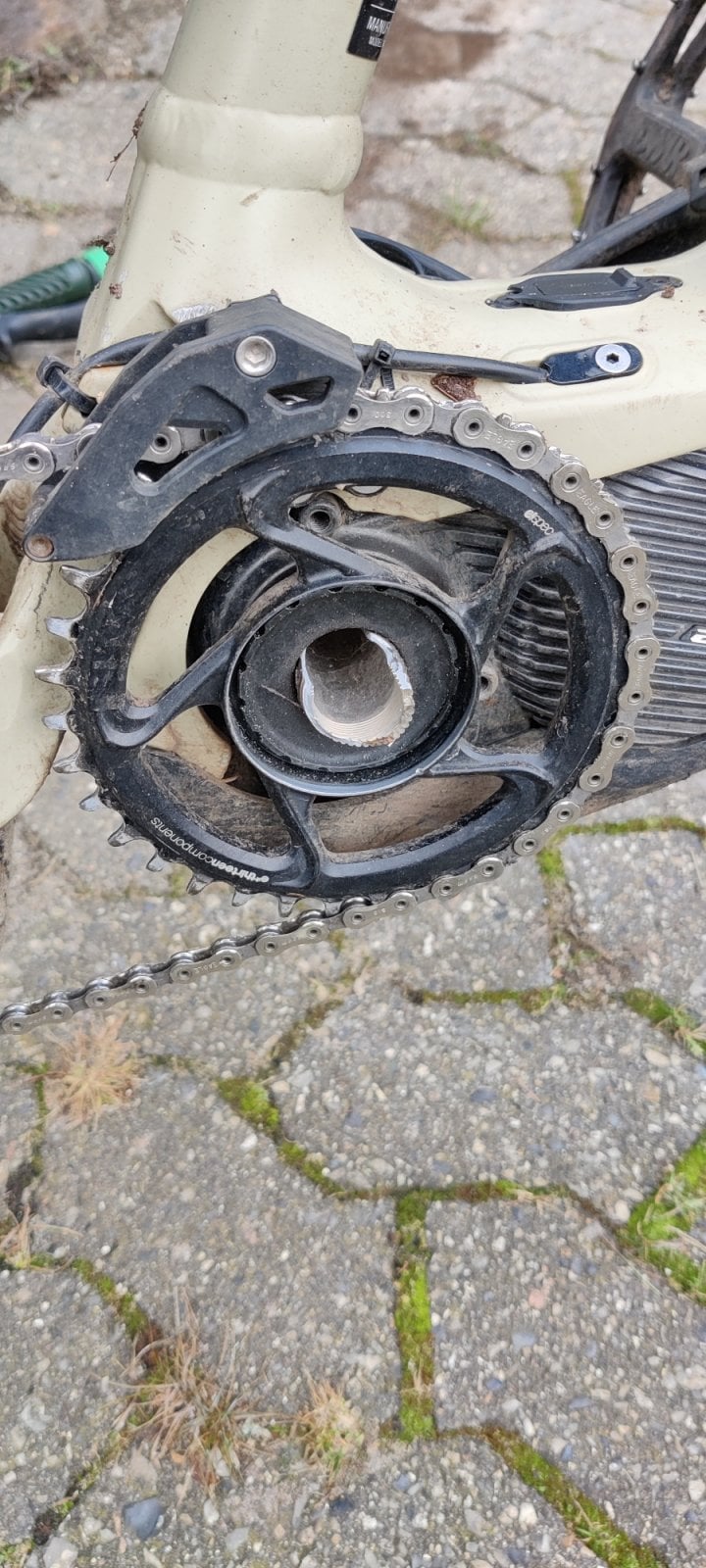

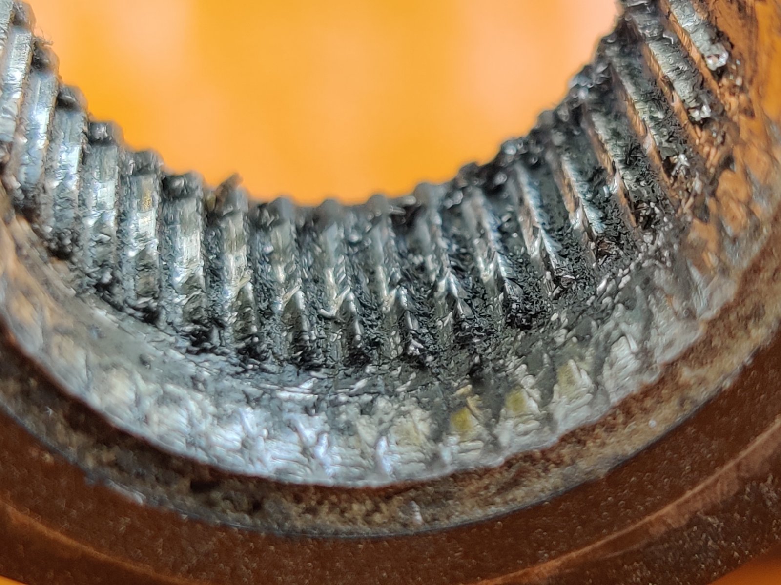

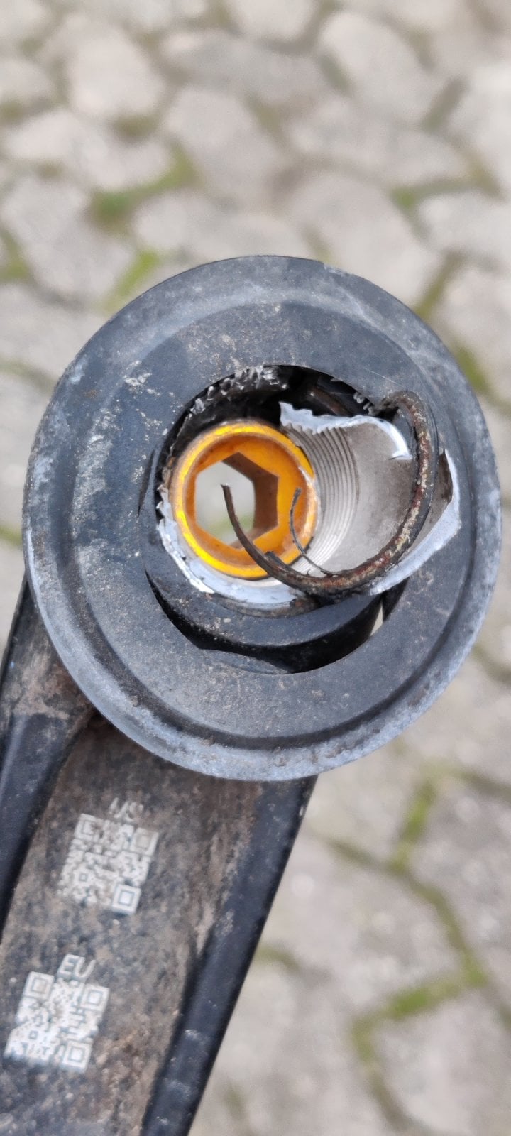

I had my spindle break in the drive side in december. It did cause a crash but luckily I only got minor bruises and cuts. It was during the take off on a small jump we I was preloading the bike.
The bike came with the E13 cranks.
I have had the left pedalarm fall of 2 times, but I have never had any problems with right/drive side.
Commencal provided me with a new motor and a set of shimano cranks.
My uneducated guess would be that the problem is the spindle.

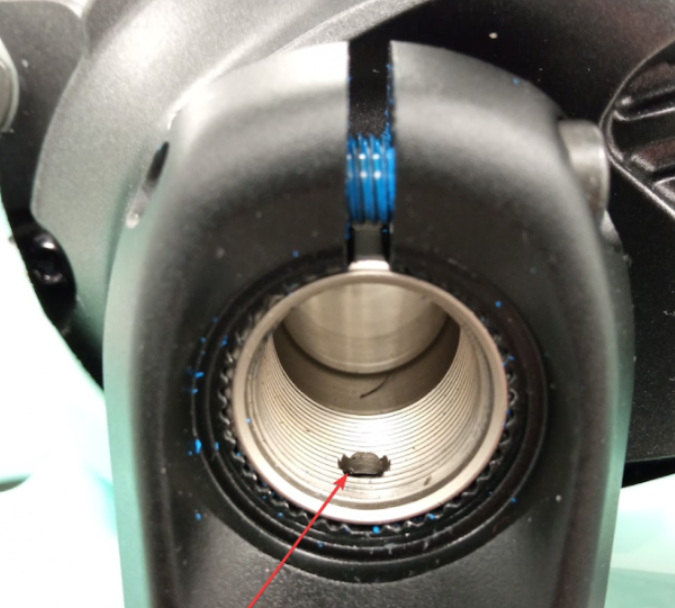

This is the official shimano crank that I had replaced under warranty. Luckily no cracking on the spindle that i can see, but doesnt look like the Shimano cranks are immune from coming loose and wearing out... Which reminds me, the actual warranty crank is still at the bike shop (i bought a replacement since I just want to riiiiiiiiiiiide) That Crank arm lasted about 500km.
