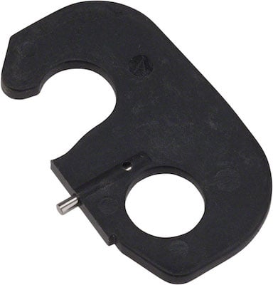

I cannot get the drive side crank arm off of my Rise M10, it moves 2-3mm, but will not come off, all videos I have seen show it just comes off after removing the crank bolt and the two retainer bolts...
Are they Shimano cranks? There's a retaining clip to prevent them from falling off if loose. You have to move it out of the way:
