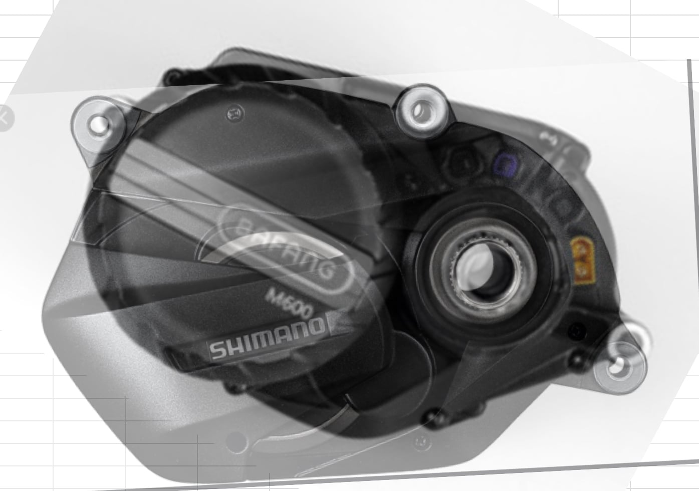

See the attached photo a Bafang M500 ghosted over a Shimano E8000.

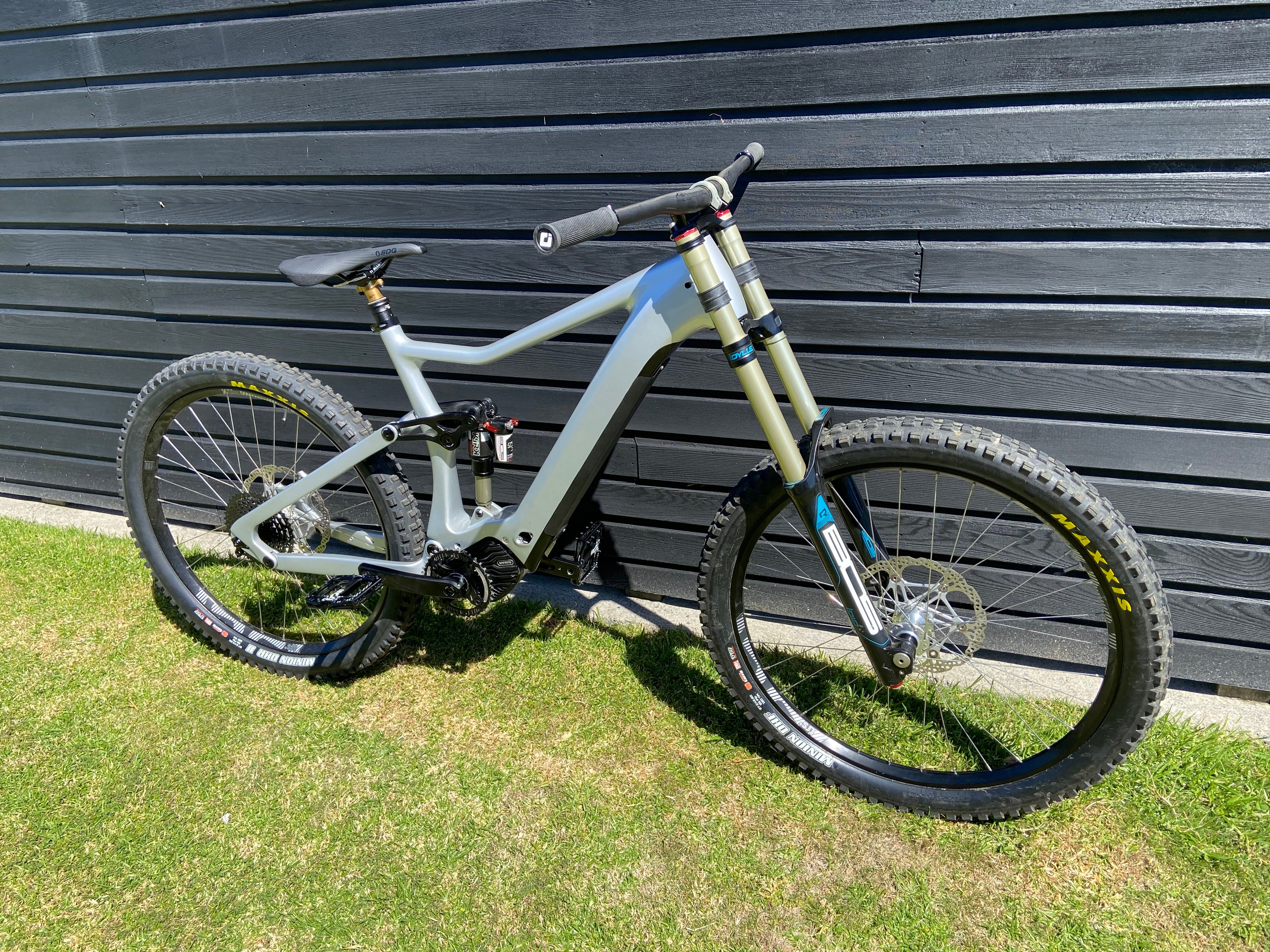

Also a photo of the bike I installed into that is designed for Shimano

Very nice, thanks. Where did you get the brackets made up? I've got a spare frame and would be interested in giving this a go
The Bafang motor has narrower mounting lugs, I made them using 3mm aluminium plates, I would say you need make them suit your frame but it’s pretty easy to nut out.
