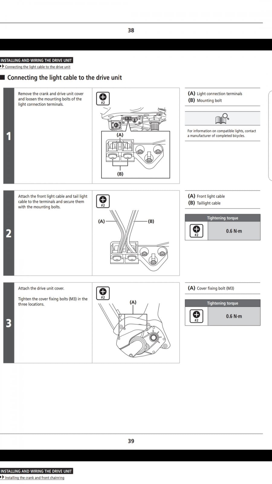

Edd
Dec 19, 2018
Thanks for the thought, I checked it out in the manual and it only mentions it being connected by two tabs on the motor.
