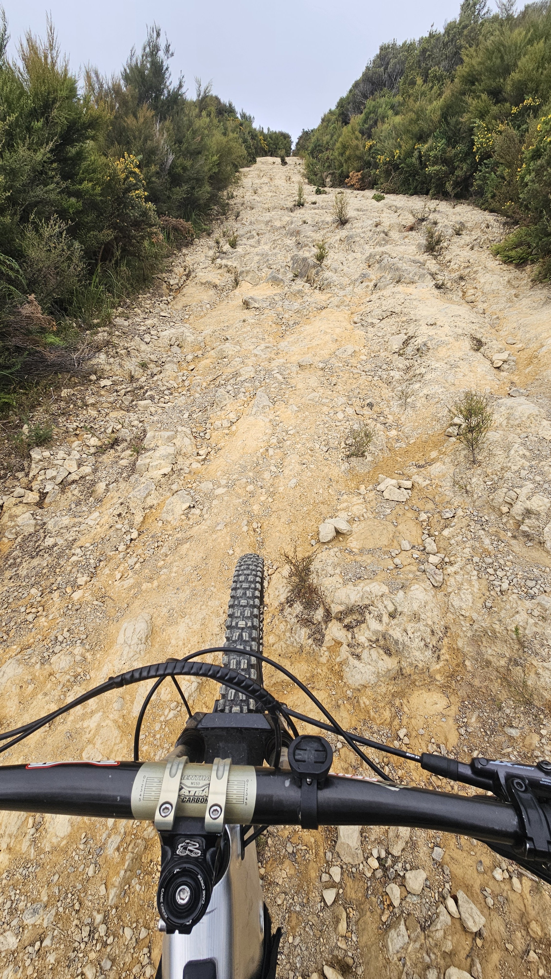

I ride a lot of steep ad indeed use my 34/50 combo. At those steepnesses and gear ratios looping the bike out in front of you isn't uncommon. That's the last time I used the 50t. Farken ridiculous. I loved it.
Ps 650km into link glide. Still rock solid shifting.
