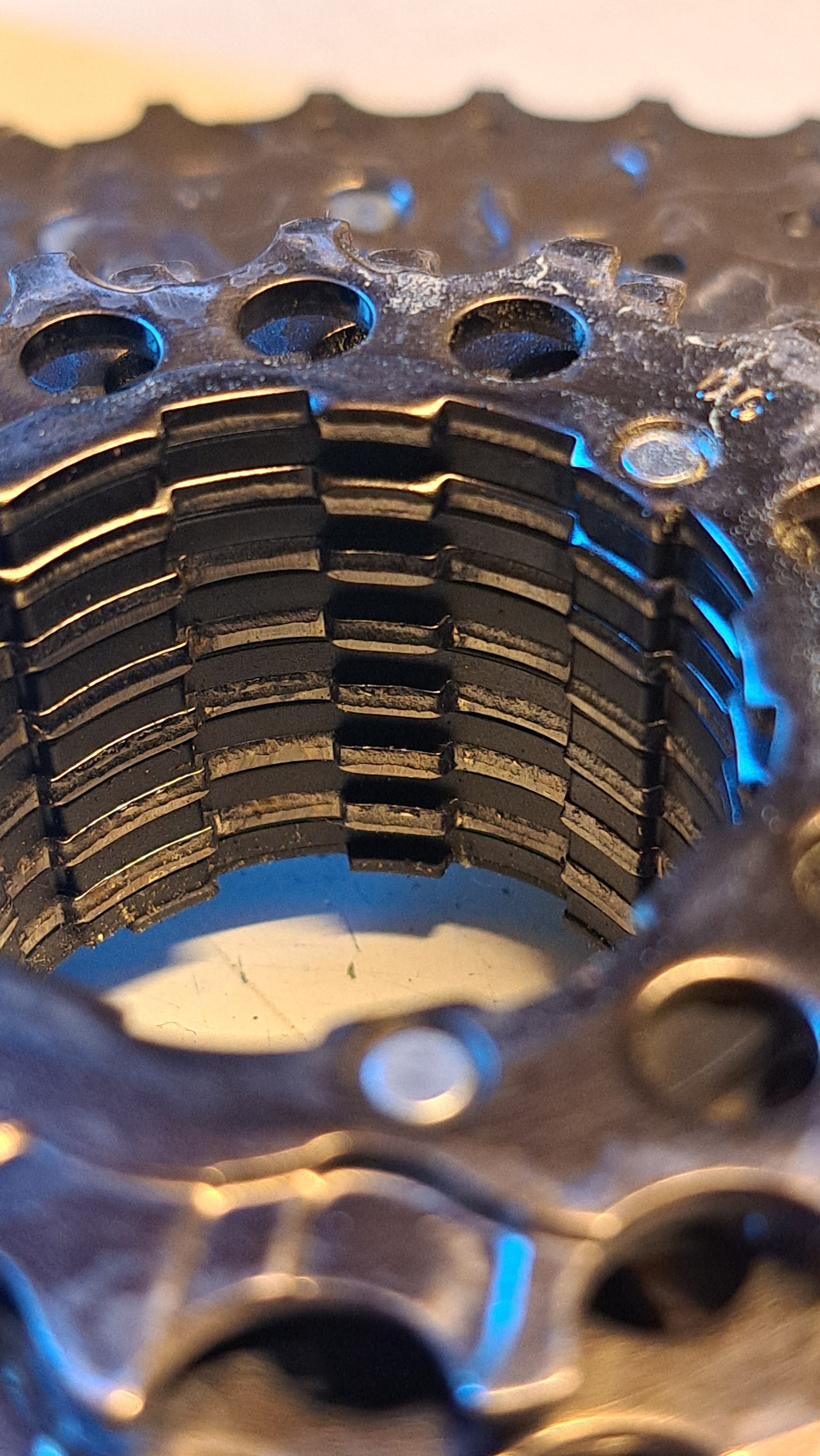

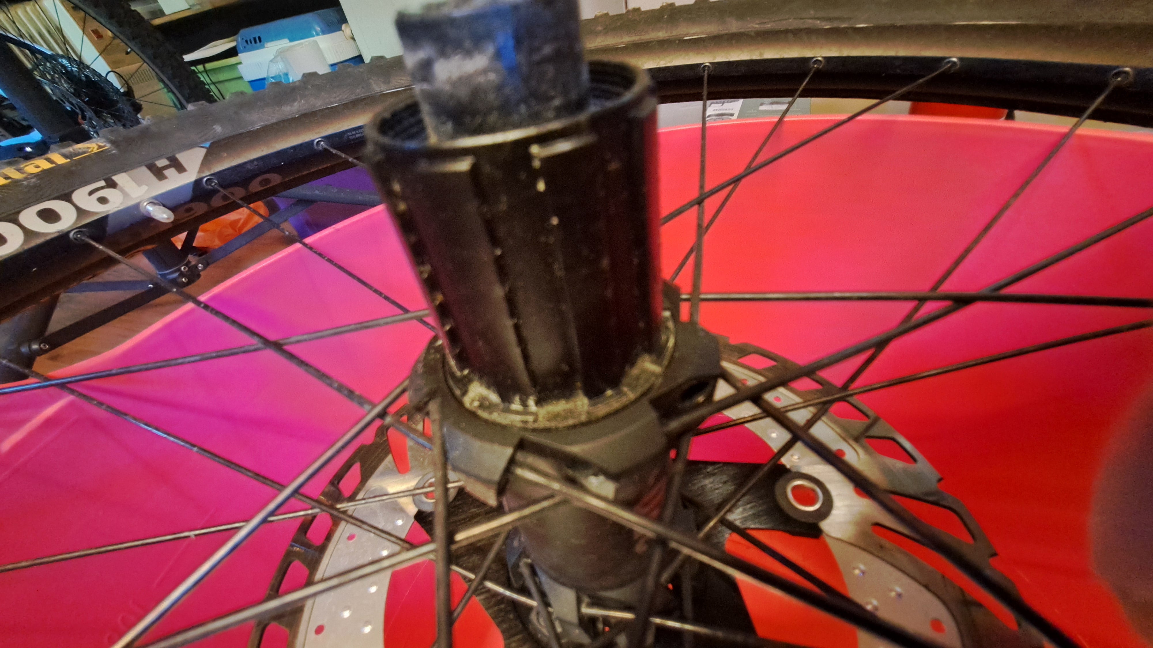

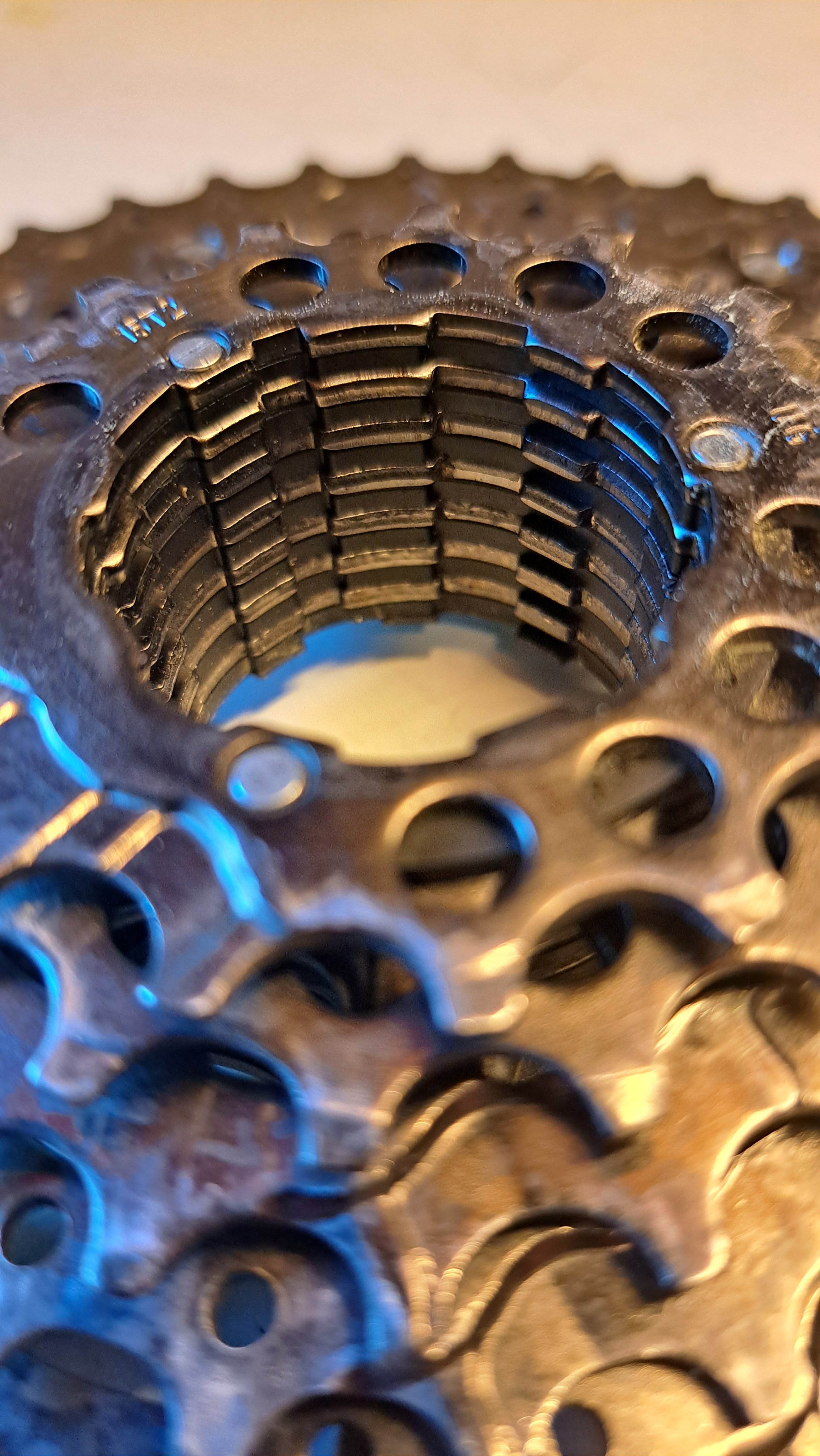

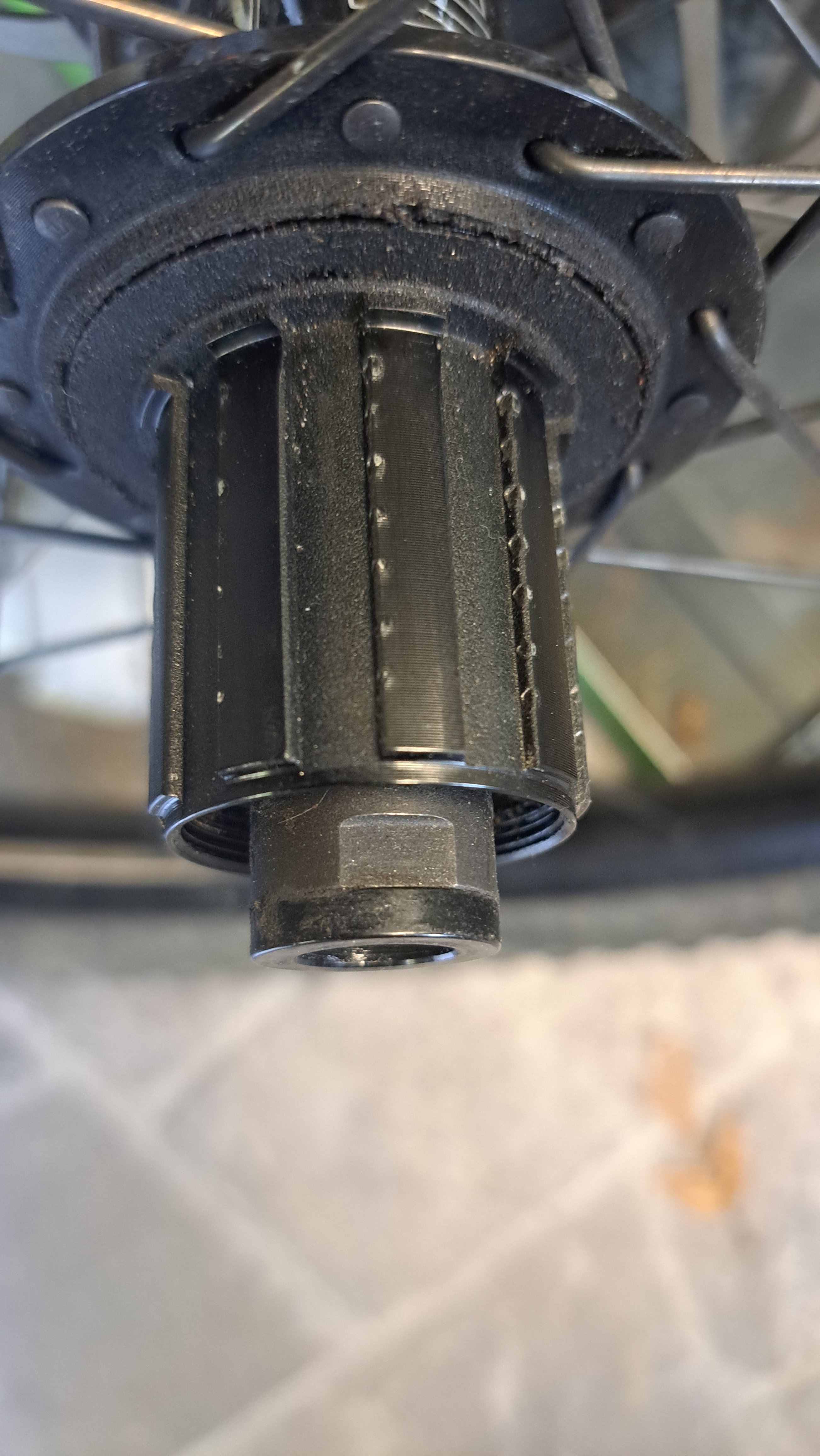

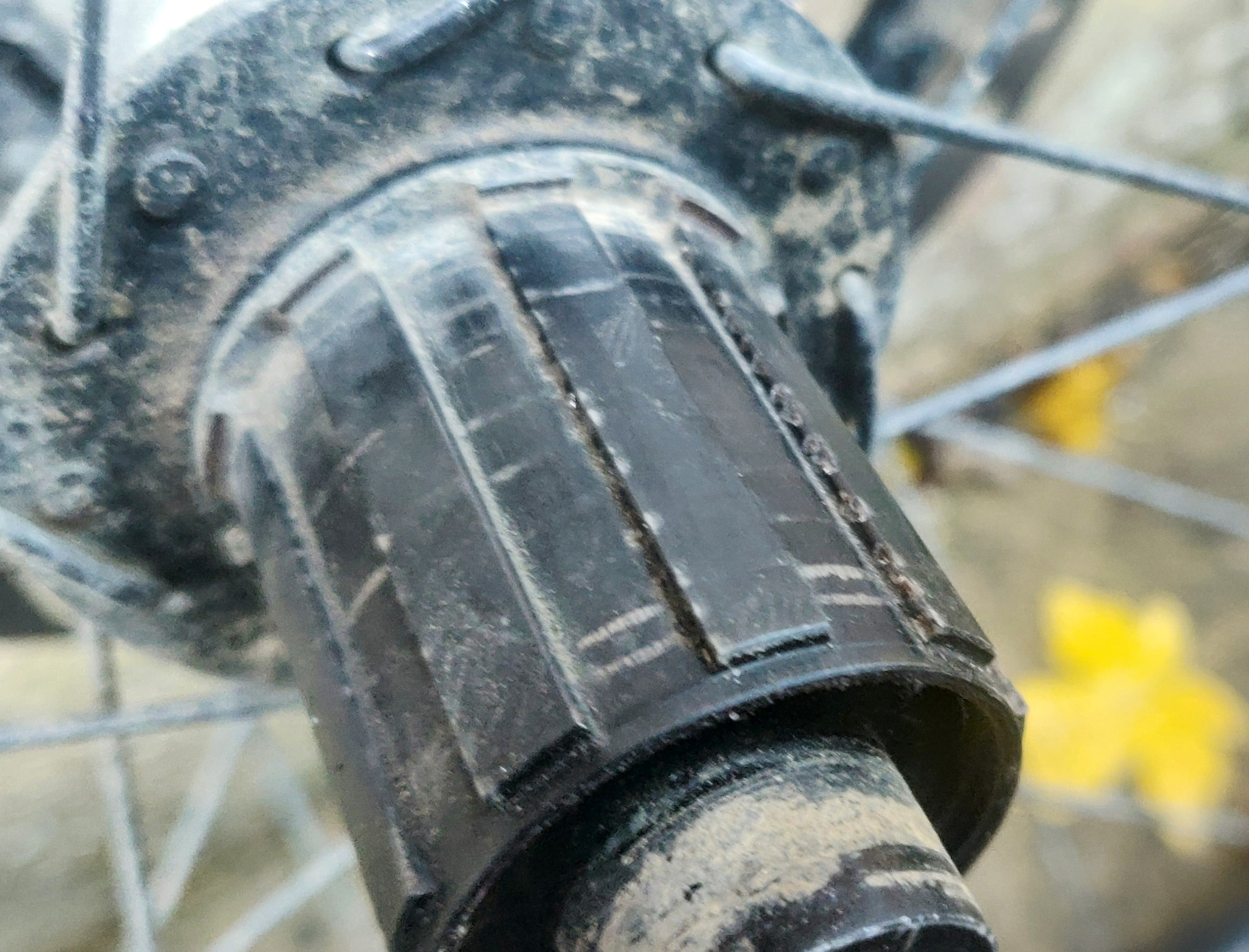

Has anyone noticed the wear on the freehub body with this cassette, i have one dt swiss h1900 wheel with a steel freehub and e thirteen espec wheel.

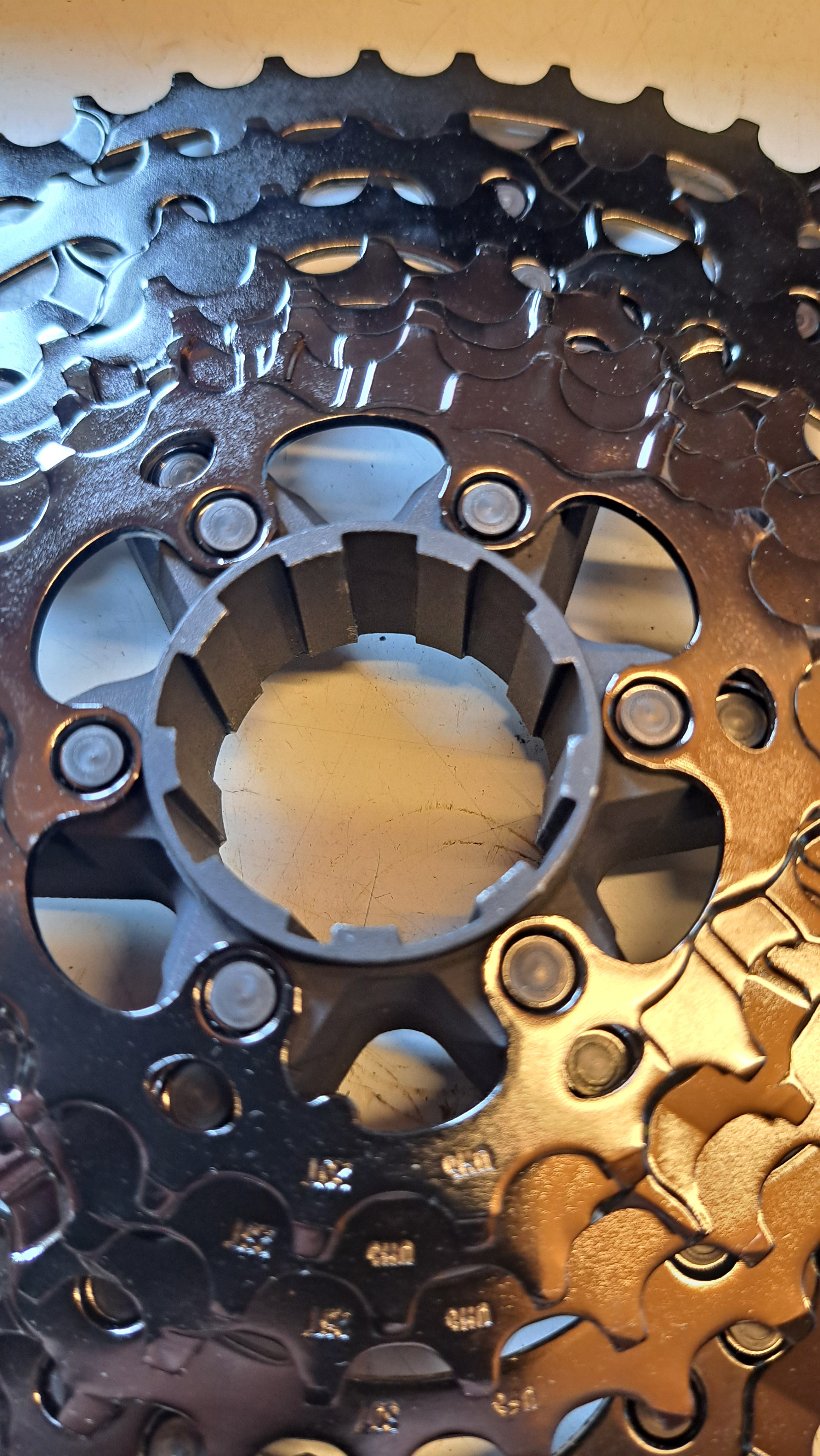

After just 70km on the e thirteen it has groves in the splines and even the steel hub on the dt swiss has small grooves after 230km, looking at the cassette there is plastic and metal that takes up the load on the splines and i dont think that is good enough on a ebike.
Never had this problem with other types of cassette
I have bougth the LG700 cassette because this has a aluminum spider without any plastic so it will not be so hard on the splines. Will put a picture here when i get it.
Ethirteen hub after 70km 20240519_160640[1].jpg Dt swiss hub after 230km 20240520_195959[1].jpg LG 400 20240520_195922[1].jpg 20240520_195057[1].jpg

The pics of the inner contact teeth of the two cassettes pictured above show a dramatic difference. My new CS-LG400-9 Shimano Cues cassette that I installed looks more like Ps71's pic. I wonder if different LG400 cassettes manufactured at different times or in different manufacturing runs account for that. Don't know. The first pic looks like a rabid beaver cut those teeth. Still even then, I'd think a steel DT hub would stand up to that much better. We're saying steel, but I think most know all steel isn't created equal.

The first picture in the first post is the ethirteen alloy after just 70km and the second picture is the dt swiss steel after 230km, both with marks in them but the dt swiss holds up mutch better.
Dont know if the design is different on other linkglide/cues cassettes but the way the LG400 is produced is going to cause a lot of wear on the freehub and i am sticking to the LG700 from now on.

The first picture is the ethirteen alloy and the second is the dt swiss steel, all the steel ones i used have been black

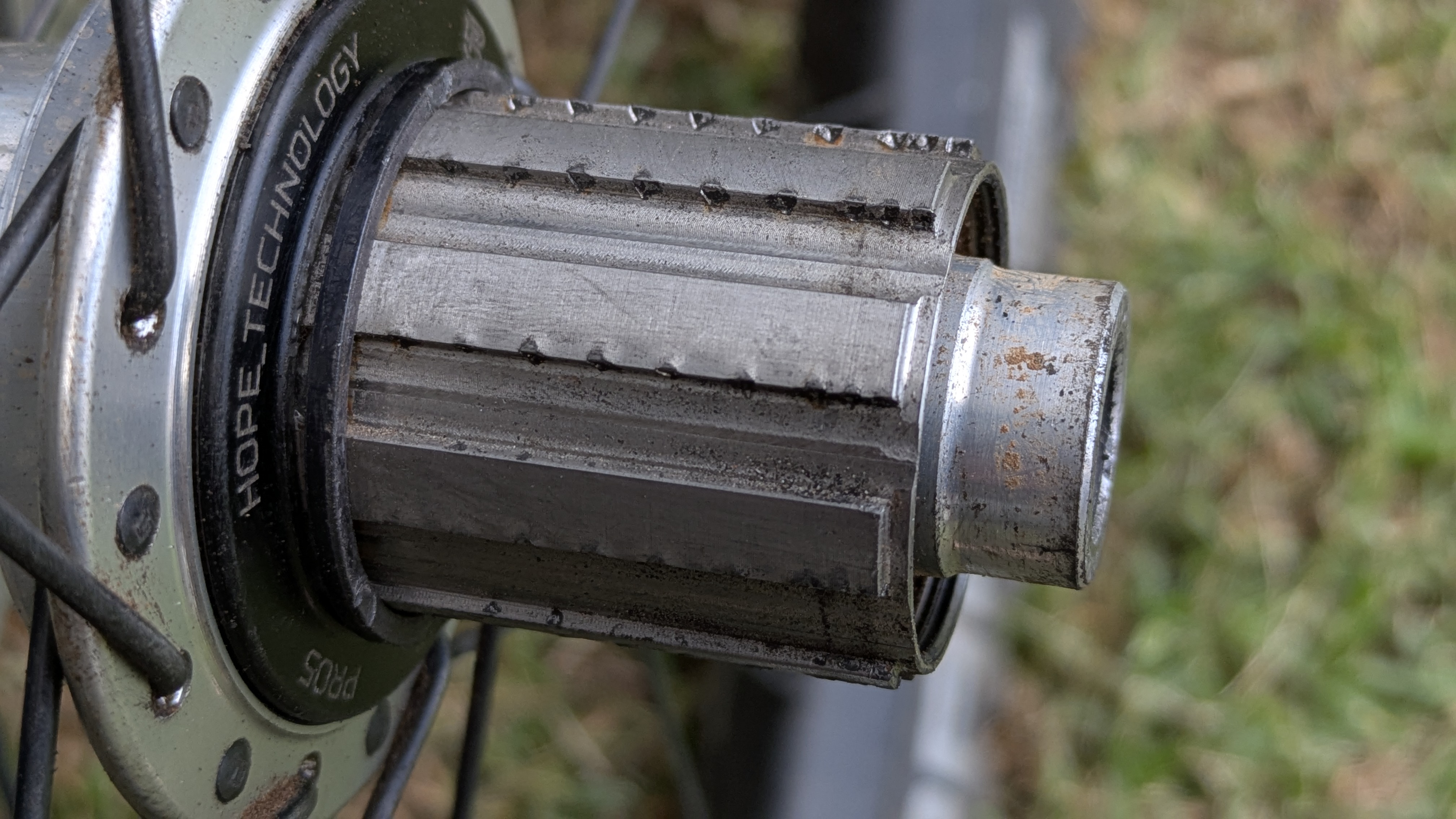

I swapped my lg300 today after a year. Mileage unknown, i don't track it.
Dt350 with steel freehub.
Pretty minor indents. Can barely feel them.
