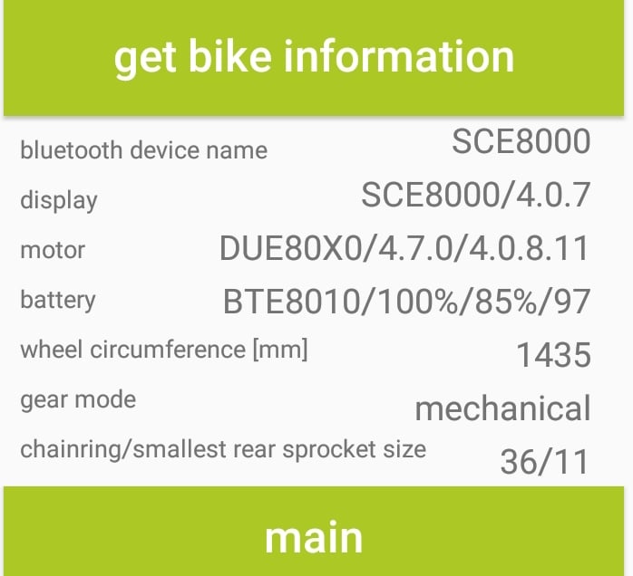

1) # of charging cycles 17
2) remaining capacity 100%
3) I use E6000 charger exclusively
4) Battery BT-E8010 504wh
6) 12 months old / ~ 900 miles
I store the battery between 15-20 degrees celcius in a dark chamber and try to only charge it to 100% when I need it and then only right before I leave for the ride. I also try to avoid to fully empty it if it's not needed and if it happens I charge it up as fast as possible.
When I store it longterm then at 30-40%. I ride almost exclusively in Eco/High mode with 90-100 rpm and Im fairly light (around 70kg with gear). Boost-mode feels to strong anyway with that weight.
Update
1) # of charging cycles 23
2) remaining capacity 99%
6) 14 months old / ~1500 km

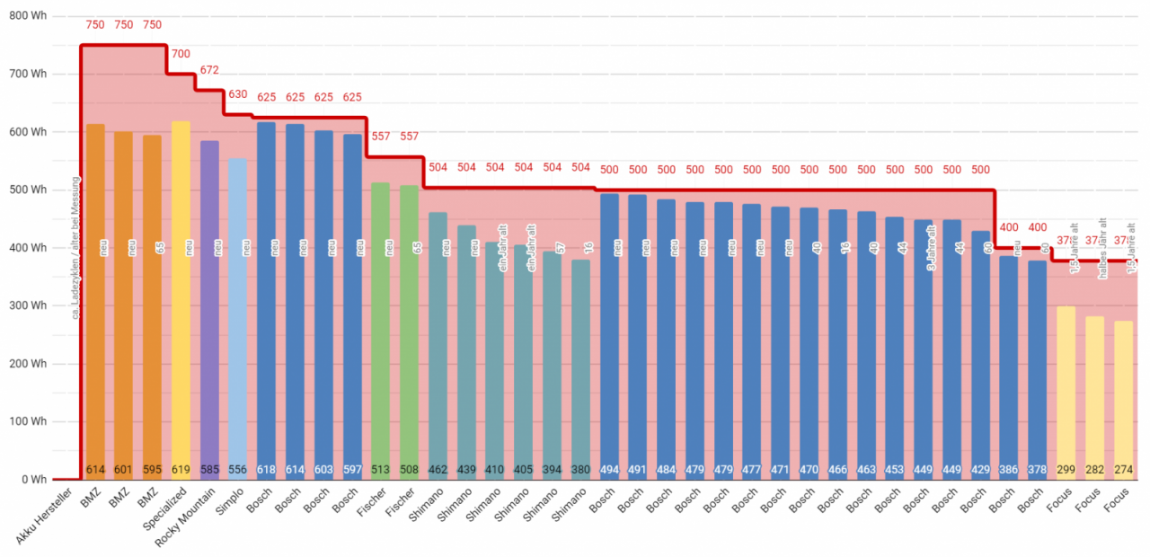

It would be interesting to setup a simple discharge rig to measure the actual capacity. And not that difficult given the output seems to be a direct connection to the battery itself. I may have a quick look to see how much a cheap voltage datalogger is.

Someone did that in this thread:
But I can't find it on mobile right now
Edit:
They talk about 460 to 510 Wh when the battery was completely empty. But you have to calculate the losses from the charger.

Cant do a translation on my phone unfortunatly, but guessing they measured the power in tothe charger? Thats not a bad idea to give a rough comparison of battery health over time actualy. It wont give an accurate idea of actual capacity, but for degradation it would work. especialy when people are seeing >10% degradation reported.

So here is what a few guys over there measured. They divided it through 1:17 to simulate the efficiency of the charger. This is not pinpoint accuracy but it gives some hints that not alle manufacturers operate with the same strategy. The batteries are either new, which means the measurement took place on the third charging cycle to get full capacity, or one year old or the charging cycle amount is mentioned. One source of error could be that the people treat their batteries differently. But the amount of batteries show at least some tendencies.

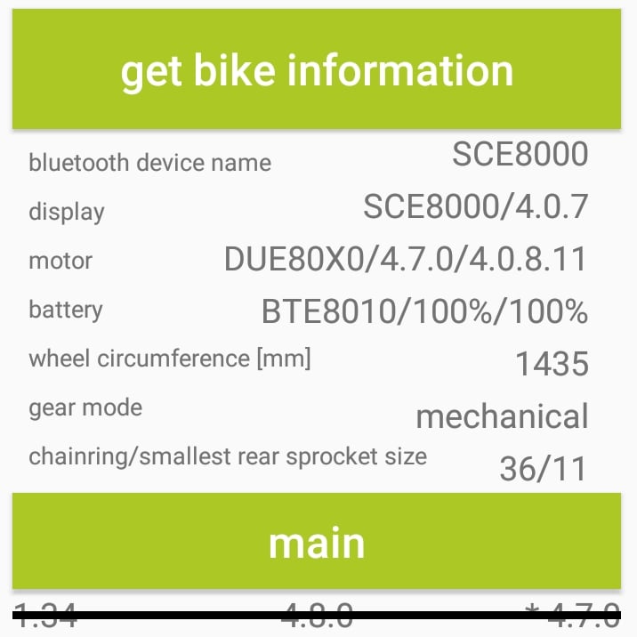

I have had MERIDA eONE-SIXTY 900-E size XL since March 2019, my beloved wife has had eONE-SIXTY M#RIDA METALLIC CRIMSON (RED LIGHTNING) size M since July 2019.
We use only the Shimano EC-E6000 charger,
battery 2x Shimano BT-E8010, Li-ion 36V-14 Ah-504 Wh.
Sometimes I use a battery from M#rida, which my wife rides on. So my battery has less km than my Merida, and vice versa.
Merida battery:
now 8.045 km / 5,012 miles approx
battery health 91%
charging cycles 66.
M#erida battery:
now 5.906km / 3,679 miles approx
battery health 97%
charging cycles 42.
So far, so good(?) We'll see how it goes.
