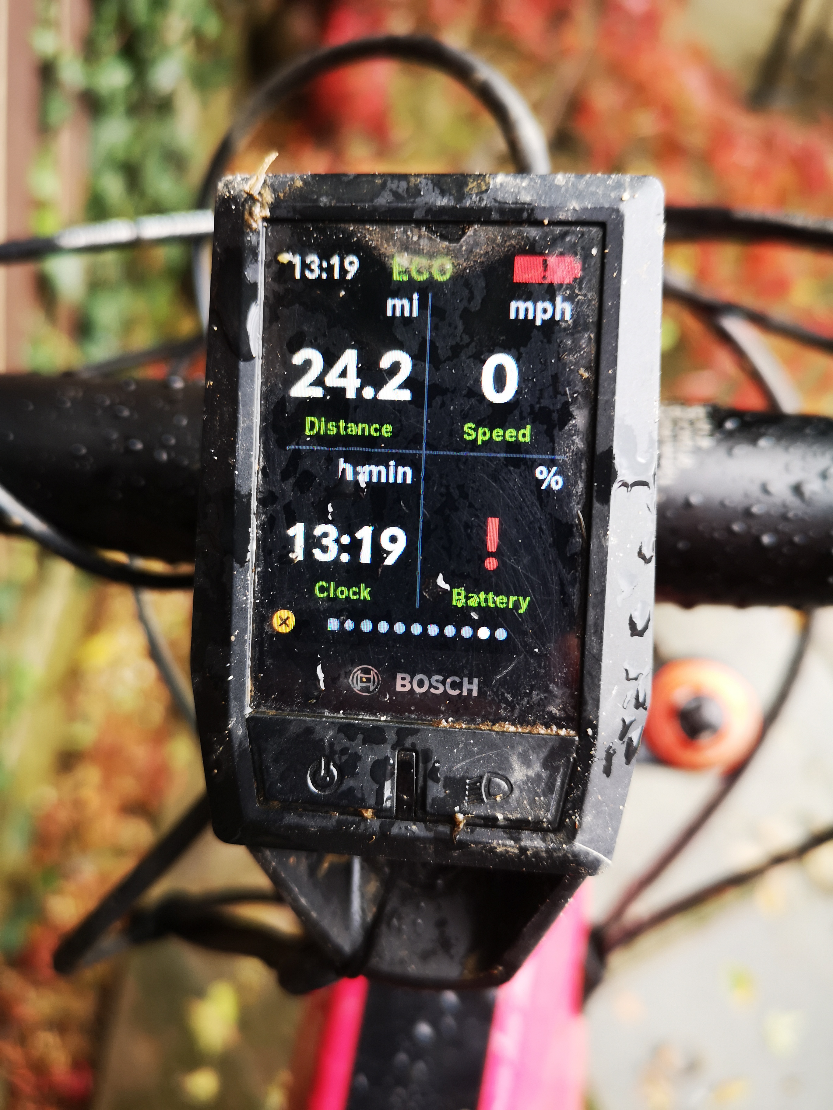

AHH you know what, I haven't actually ridden it until dead, it once went from 3% down to 1% but I was yards from home when that happened. What percentage does yours get to when it completely dies?
Deader than a dead thing 👍

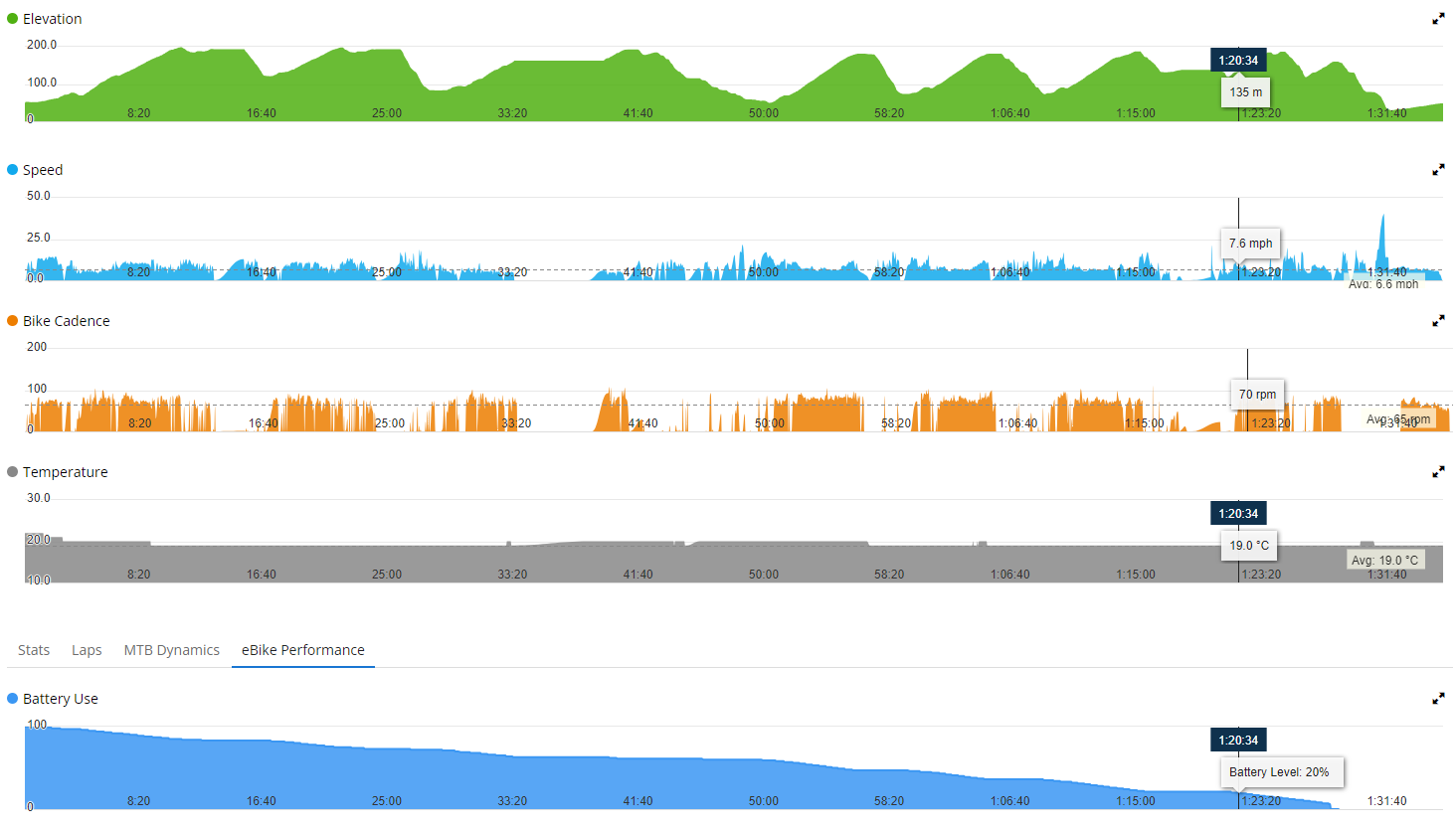

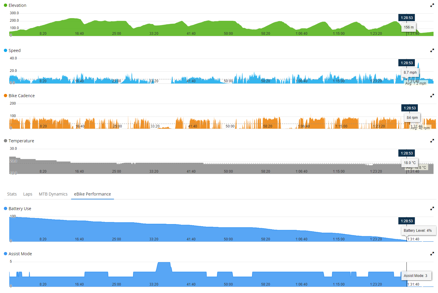

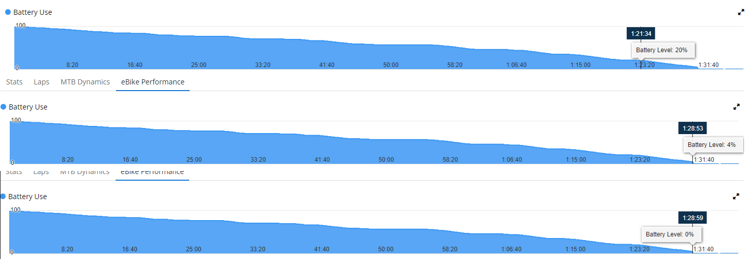

My older BT-E8010 batteries did the same thing. I captured the battery state with a Garmin 830...
Battery laster 1hr28.
Last 20% lasted only 7 minutes or so.
As you can see from the below times, the last 4% vanished in seconds.
This is a summer evening, with temp of around 19 deg C
I think the battery management system is just rubbish. When the battery is under load, I guess the voltage drops, so the BMS thinks the battery is empty. I'd imagine switching to eco would make it last longer.
Here are the whole ride stats...
Distance 11.45 mi
Time 1:34:53
Avg Speed 7.2 mph
Total Ascent 986 m
Here's another ride, same thing happened except battery quickly went from 7% to 0% in seconds...
Distance 10.39 mi
Time 1:34:03
Avg Speed 6.6 mph
Total Ascent 869 m

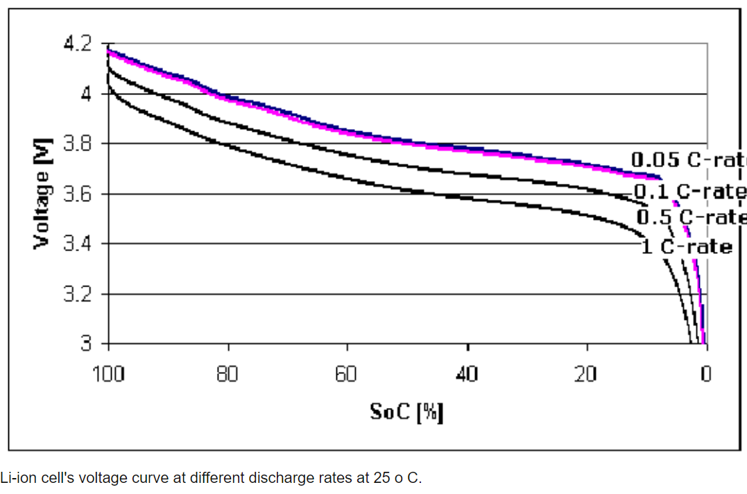

My Specialized is similar to this and has been since new. When it gets to 13% it is essentially empty, won't do anything over Eco and when I have had to carry on it cuts out entirely soon after.
This is inherent to all L-ion batteries to a certain extent. The voltage drops quickly at the start from eg. 4.25V to about 4V, then slowly drops down in a linear way to around 3V and then starts going off a cliff.
Battery monitoring goes off voltage and it is very hard to be accurate at the top and bottom. As the voltage drops, to get the same power you have to draw more current, so the battery really starts to struggle at the end.
Some brands, and some individual batteries may do better on keeping the reported percentage accurate, but I doubt your battery is really "faulty" as such.

Measuring battery charge with the accuracy you desire is not possible, shimano gives a clue when they decide to use the five bar indication instead of a percentage. To know if a battery is not working properly it should be tested by dedicated precision workbench by a dealer.
You may get reliable information about the capacity of shimano battery with third party software like ST unlocker. Mine are both at 84% after five years of use.

Glad mine isnt the only one then but this cant be normal, are you refering to any type of battery, imagine if all the mobile phones of this world has the same characteristic?? So in the real world this means if i buy a new bike im definatly going to need a 750wh battery to expect to get the full range that i would expect out of a 630wh battery.
My phone does this too. When it gets down to 15% or so that last 15% goes much faster than the first 15% did. When it gets to 5% it is moments from shutting down.
This graph isn't the best but it gives an idea. That last 15% or so is far from linear and predictions are hard to make. You DO still get all the energy claimed, but you probably had a lot more at the start than it seemed.
So I often find that 100% to 80% seems to take longer than 80% to 60%, which in turn is longer than 60% to 40%. I always work on wanting to get home with 20% left to be safe (or accept I may have to do all the work back up the hill home). So 60% is my half-way point.
