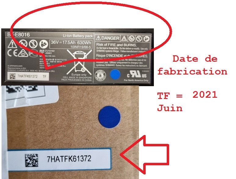

This old battery slept almost unloaded in Commencal's stock
for more than 1 year and 8 months and is now not in a good running order.
Commencal does not inform on its website about the advanced age of its batteries
Date_frabrication_2021_Juin_Shimano_BT-E8016_630WH_ livraison_02_III_2023.jpg

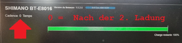

Question 1: the PC Shimano App eTube Connect V5 Professional, version 5.1.2.12 (last update),
don't register the number of loads. Is it OK ?
For the first load it is normal, it isn't a complete load. But with the next loads ??

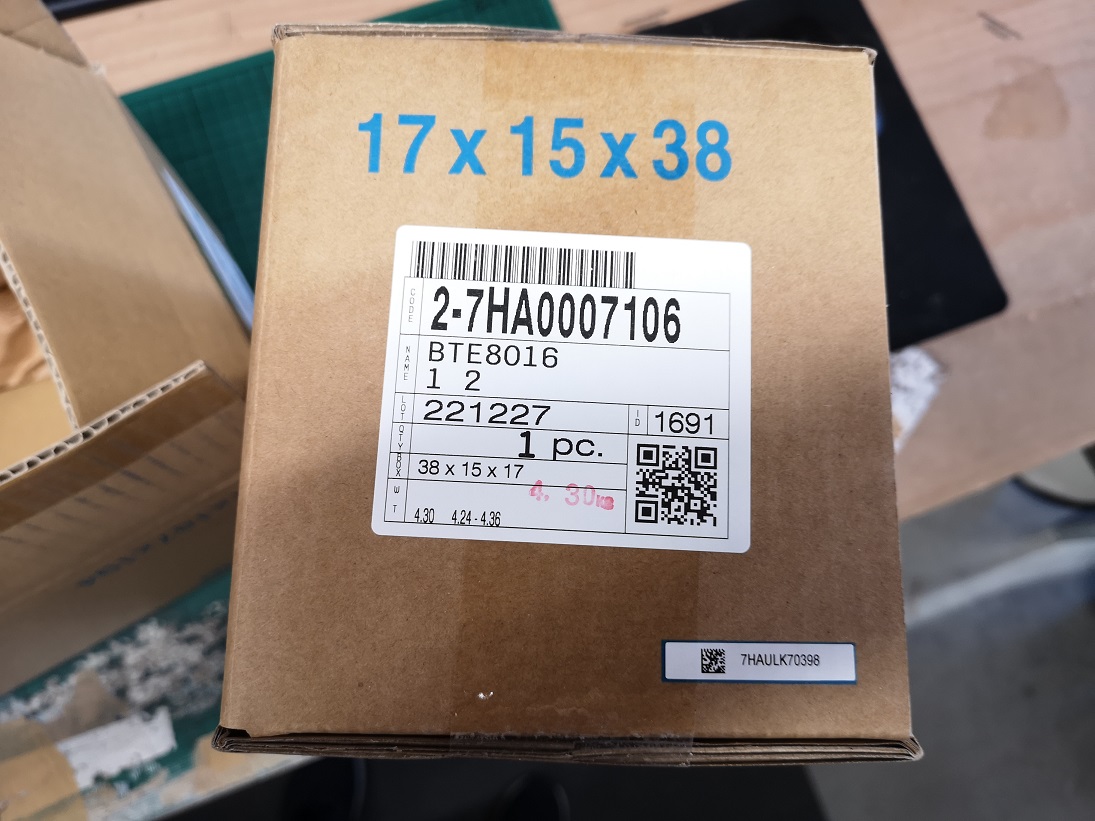

So, I decided to order another one by elektrofahrrad24.de in Germany.

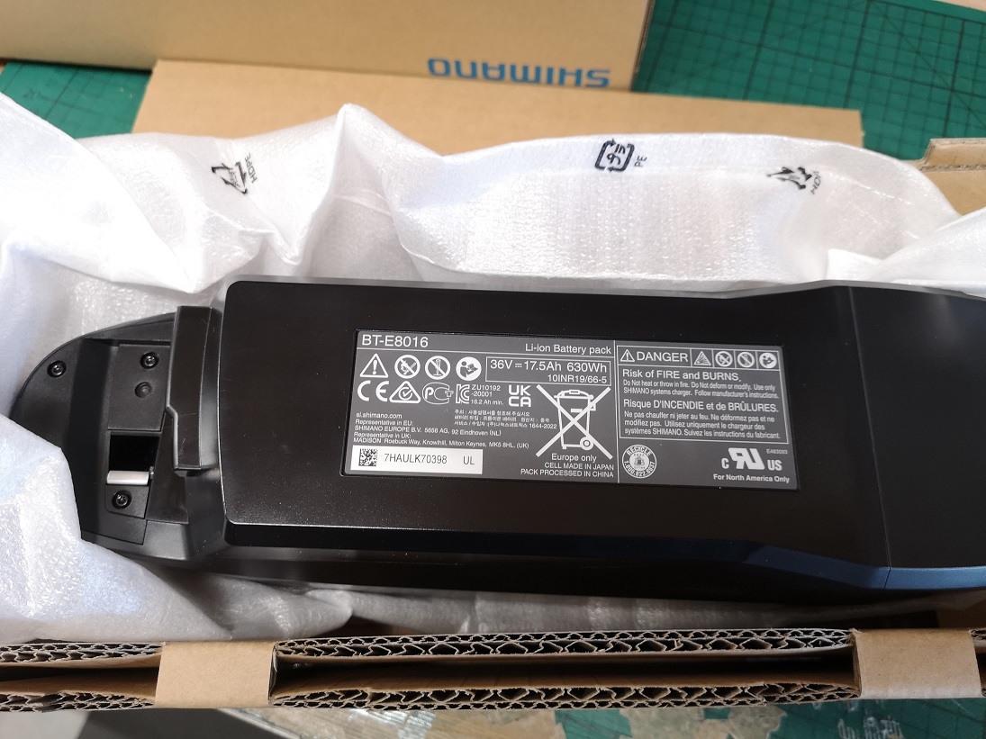

In the meantime elektrofahrrad24.de first sent me two pictures of the code of the BT-E8016 630 Wh
which are on the battery and on its packaging I wanted to by.
UL means manufactured December 2022.
Of course, elektrofahrrad24.de did send me THIS pictured battery with this Code and not an older one.
I recommand elektrofahrrad24.de

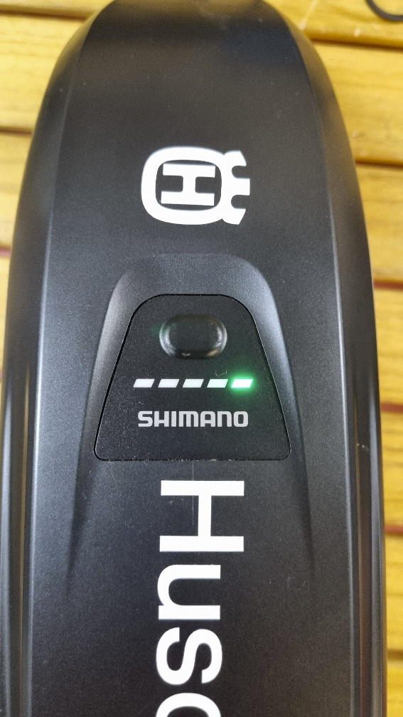

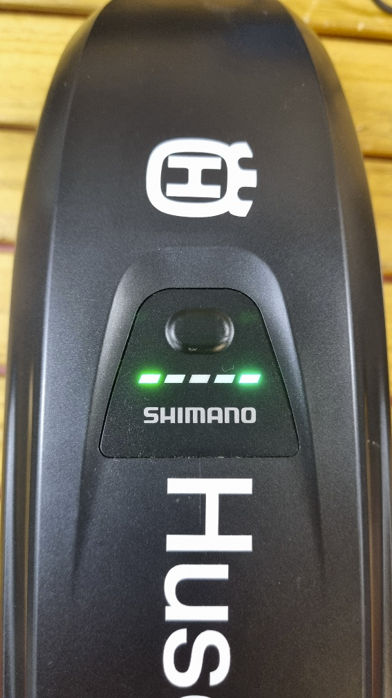

Yesterday I made 77,9 km, and 2 Leds remained ON. It is OK.
But today, by Walk Assist when leaving the garage, my Pedelec stopped and display had gone out.
I have now two Leds ON, the first is blinking.
I tried all what we can do, reboot with the battery button,
switch-on switch-off, in the frame, out of the frame,
but I even have two Leds ON, the first is blinking.
I tried also to fix it with my two loaders, but the problem remains,
and we can never turn off the Leds again.
As I'm afraid my battery will catch fire, I put it out on the balcony.
To be sure I tried it with my three BT-E8010 à 504 Wh, and all is OK.
And now?
( ps: Husqvarna stickers are from me )

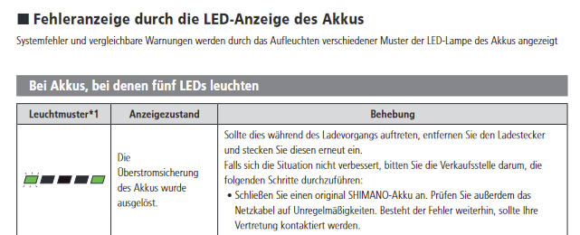

You can see the error code here:
But looks like it is:
Battery overcurrent protection occurred.If it occurs during charging, remove and reconnect the charging plug.
If the situation does not improve, have the place of purchase perform the following:
  • Connect a genuine SHIMANO battery. Also check the power cord for abnormalities. If the error persists, contact your distributor.

Question 2: does somebody know if the PC app eTube Project V5, last version, shows the number of full loads of the BT-E8016?
The App shows the number of loads with my three BT-E8010.
