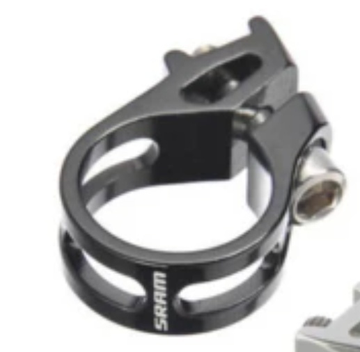

Does anyone know which Magura Remotemix clamp would fit the Specialized CommandPost dropper (or any dropper) lever?
I’ve used the Magura ShiftMix clamps designed for SRAM with my Bontrager Line Elite and OneUp remotes. For the left hand dropper lever placement, my preference is to use the one they intend for the right hand; the offset works better for me based on my brake lever distance from the grip. Not sure what’s possible with the remote supplied from Specialized.
Thanks coregrind, I’ll grab one and give it a try cheers ?

I used standard sram shifter clamps each side. I never liked all the matchmaker stuff to share a single clamp.

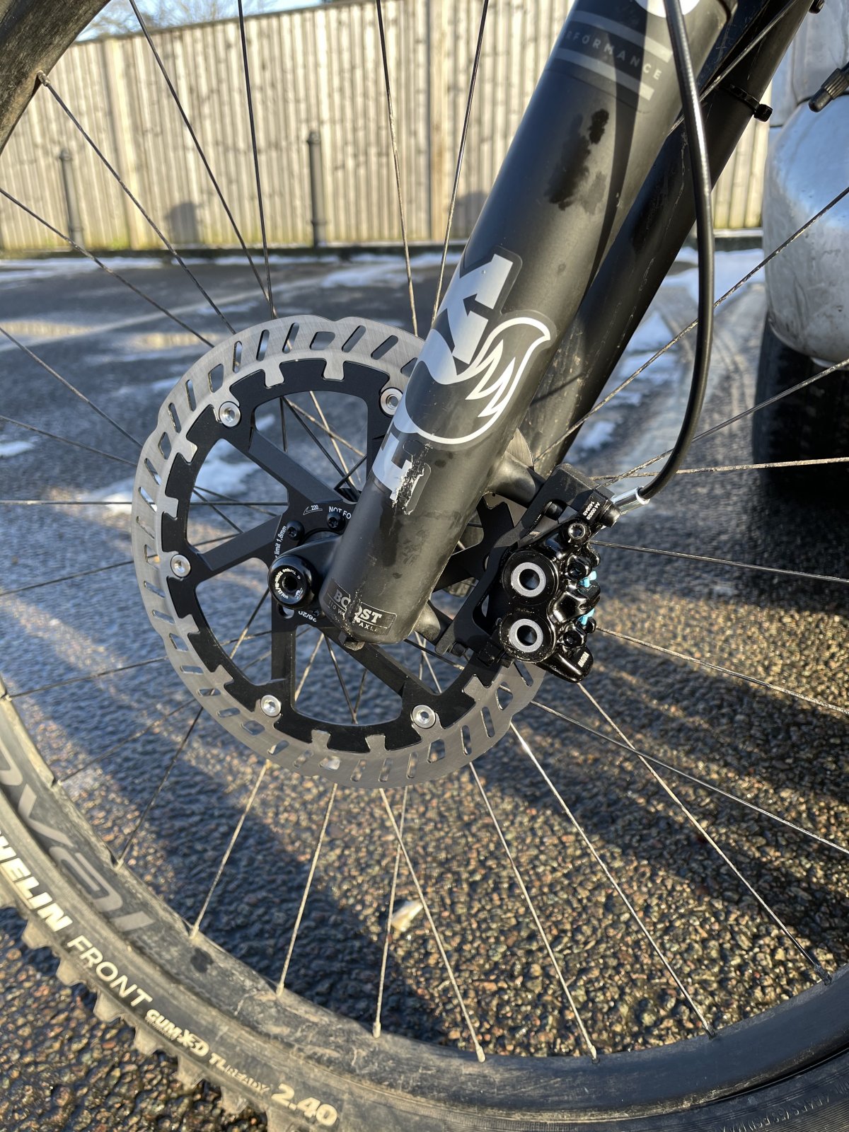

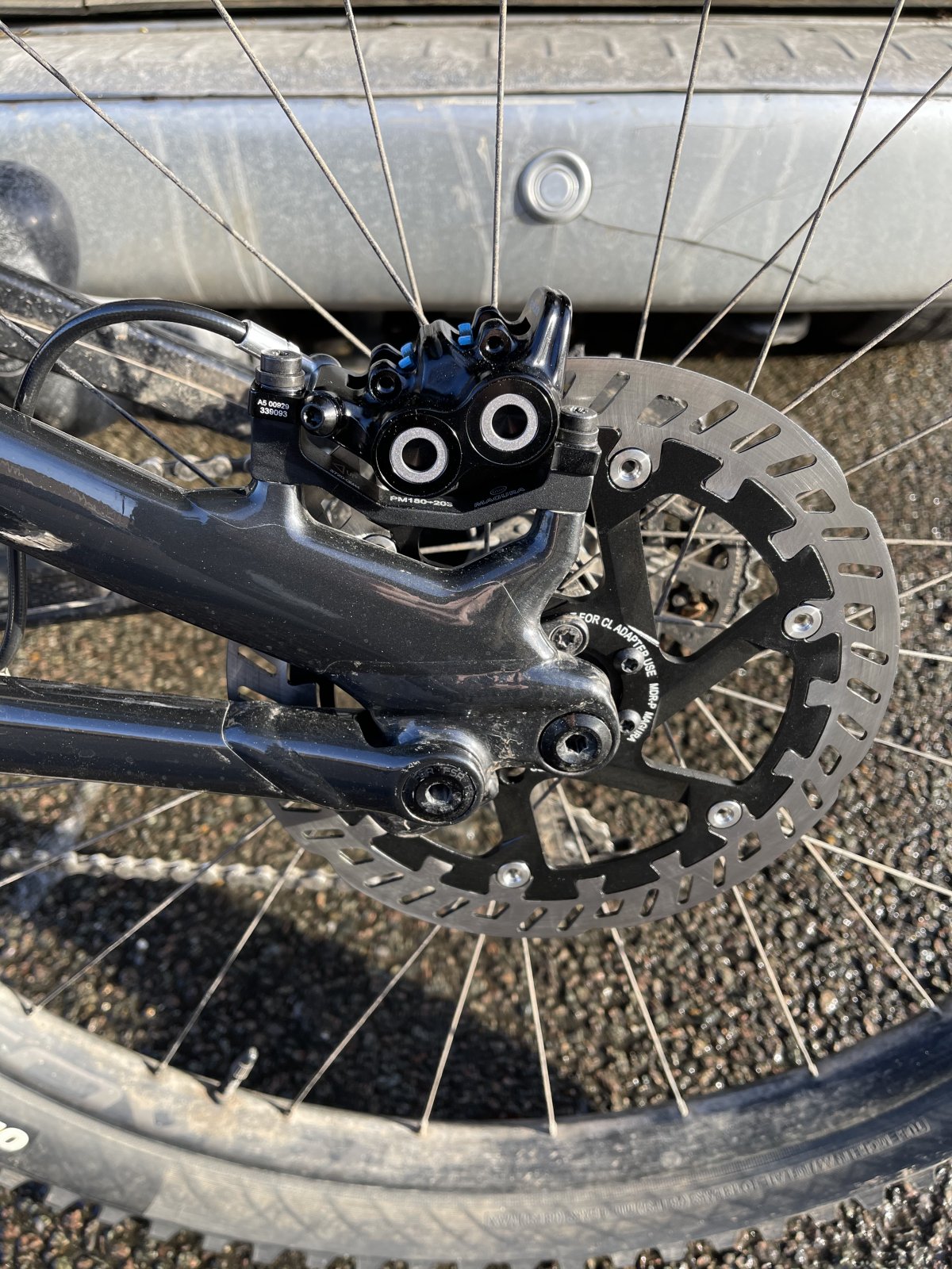

Insert brake porn here ?
MT5s with 1-finger levers 220front/203rear, uberbike ebike race matrix pads, fitted today thanks to Berkshire Bikes who got the whole job done in under an hour!
Ended up buying all the components from different places thanks to the ongoing supply shortages.
Now to bed them in and keep hunting for XT Levers.
Cheers again all for your help ?

Hi was just reading this thread and wandered why your front brake line is going around the outside of your fork leg ?
Not sure which is the correct placement tbh, Berkshire Bikes fitted it that way on both the Codes that came with the bike and the Maguras I had fitted afterwards. Haven’t had any adverse side effects to date, touch wood.
