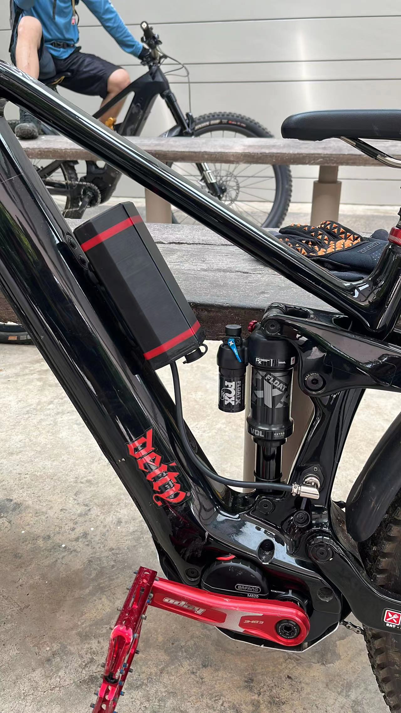

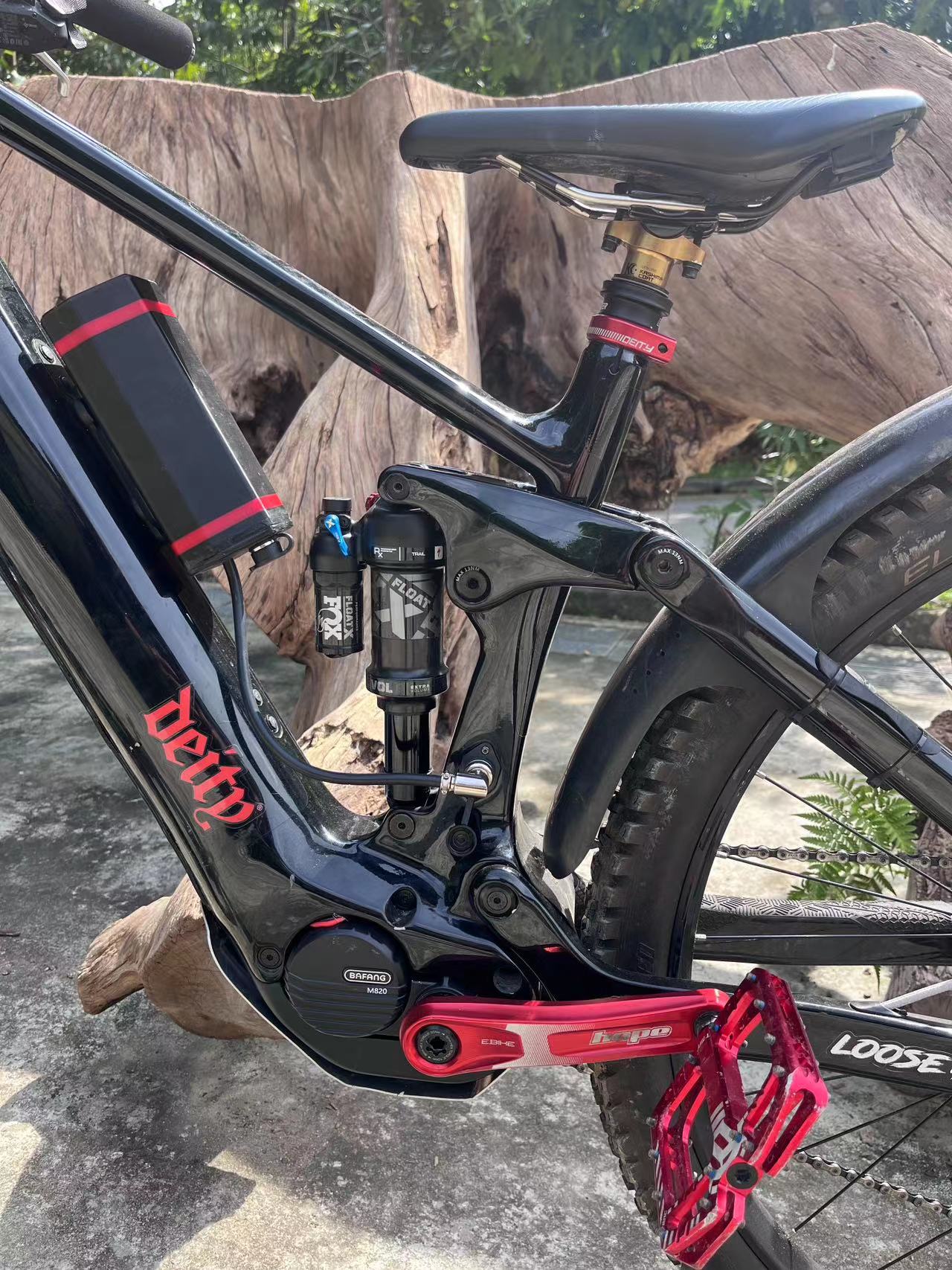

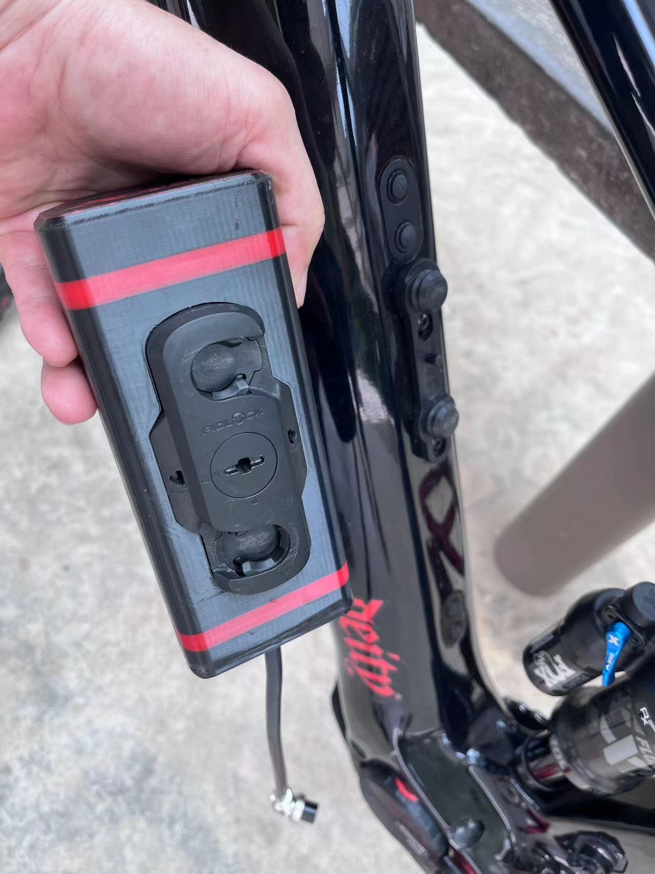

I'm curious on that extender as well. I have seen battery dxtenders mentiined in specs for some of these frames with the 820 motor but i couldnt find any size, price, or a place to select one for purchase mentioned.
Im also wondering what size battery is in the frame and if its a diy battery or ordered with the motor and/or frame?
BTW- sharp looking frome and builds in this thread

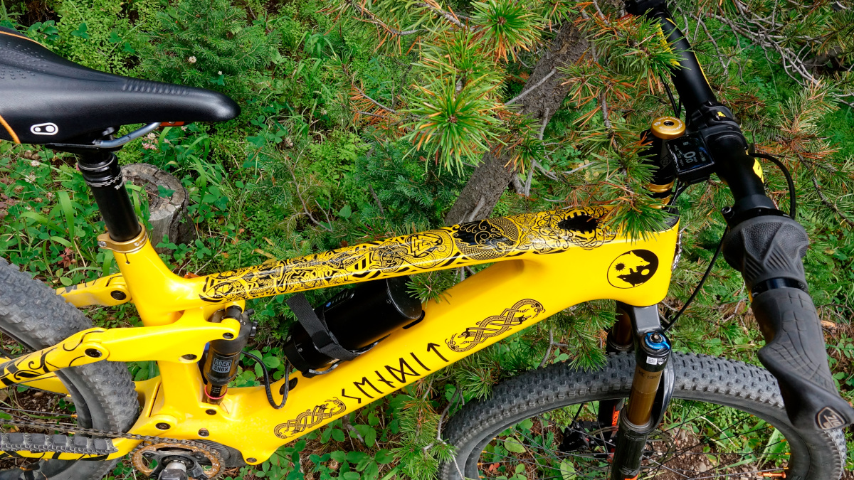

How does it feel , comparing air and coil? My bike was build using coil so I have no idea air shock feel like.
I really like riding a fork with a spring and a shock absorber with a spring. The bike rides very comfortably. The bike rides very steadily over rocks and roots

Hi Lanton,
Is that battery compartment a modification you have done or is it from the factory? If from the factory do you have a link - I cannot find it on their website, also the headset is that something you have made? Thanks.
LAnton
May 12, 2022
550
458
Russia
Yes, it's handmade. I hope that in the future it will be a factory modification. A lot of light bike manufacturers make removable batteries. Nukeproof Headset

it looks good, I have a Dengfu E10 frame with removable battery but the opening is to the front of the downtube which is vulnerable to water/mud ingress, do you have a link to the headset?

This is my modification. I bought the headset at a store in our city

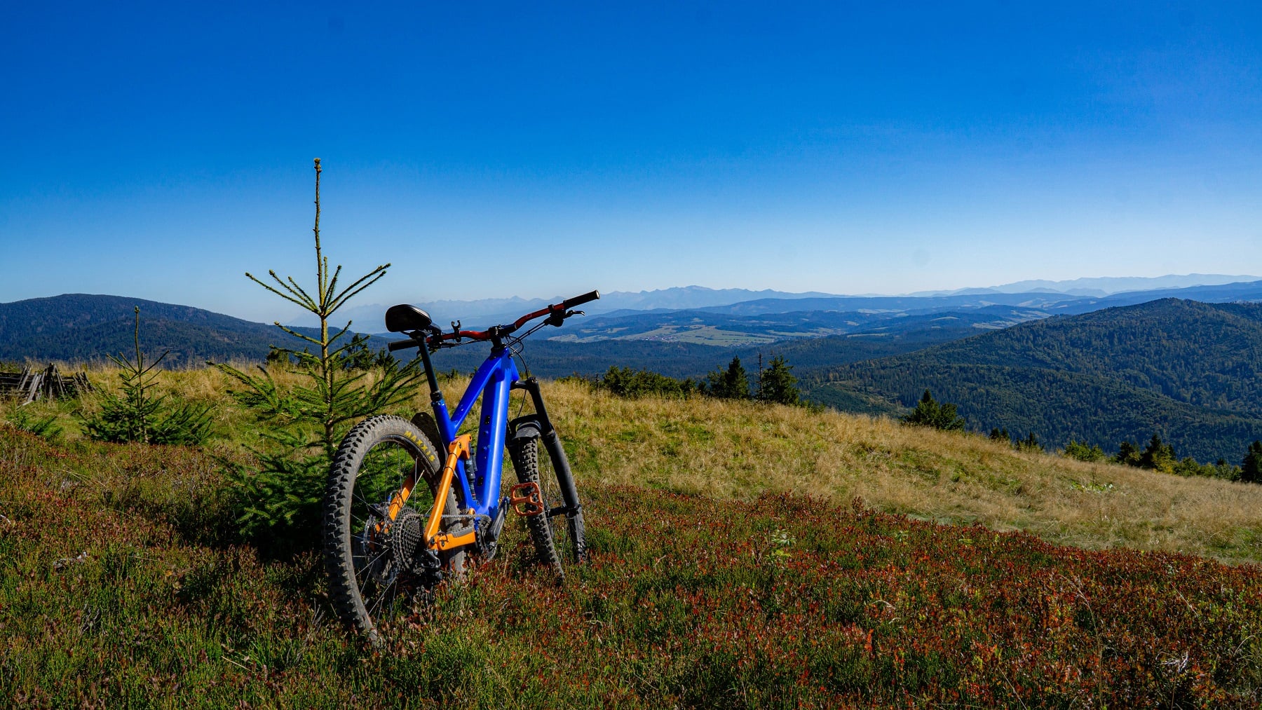

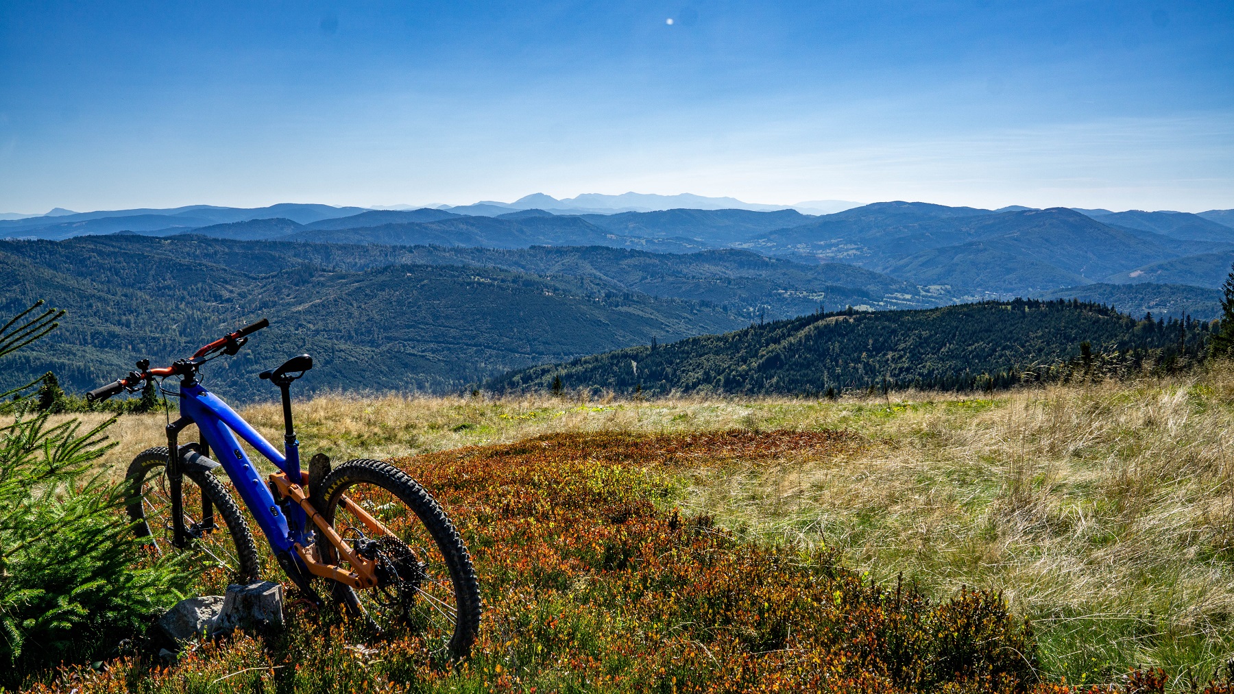

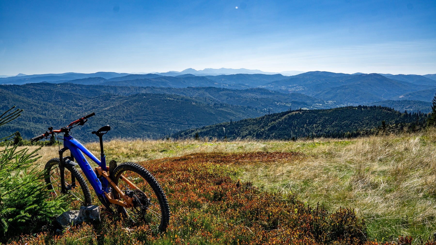

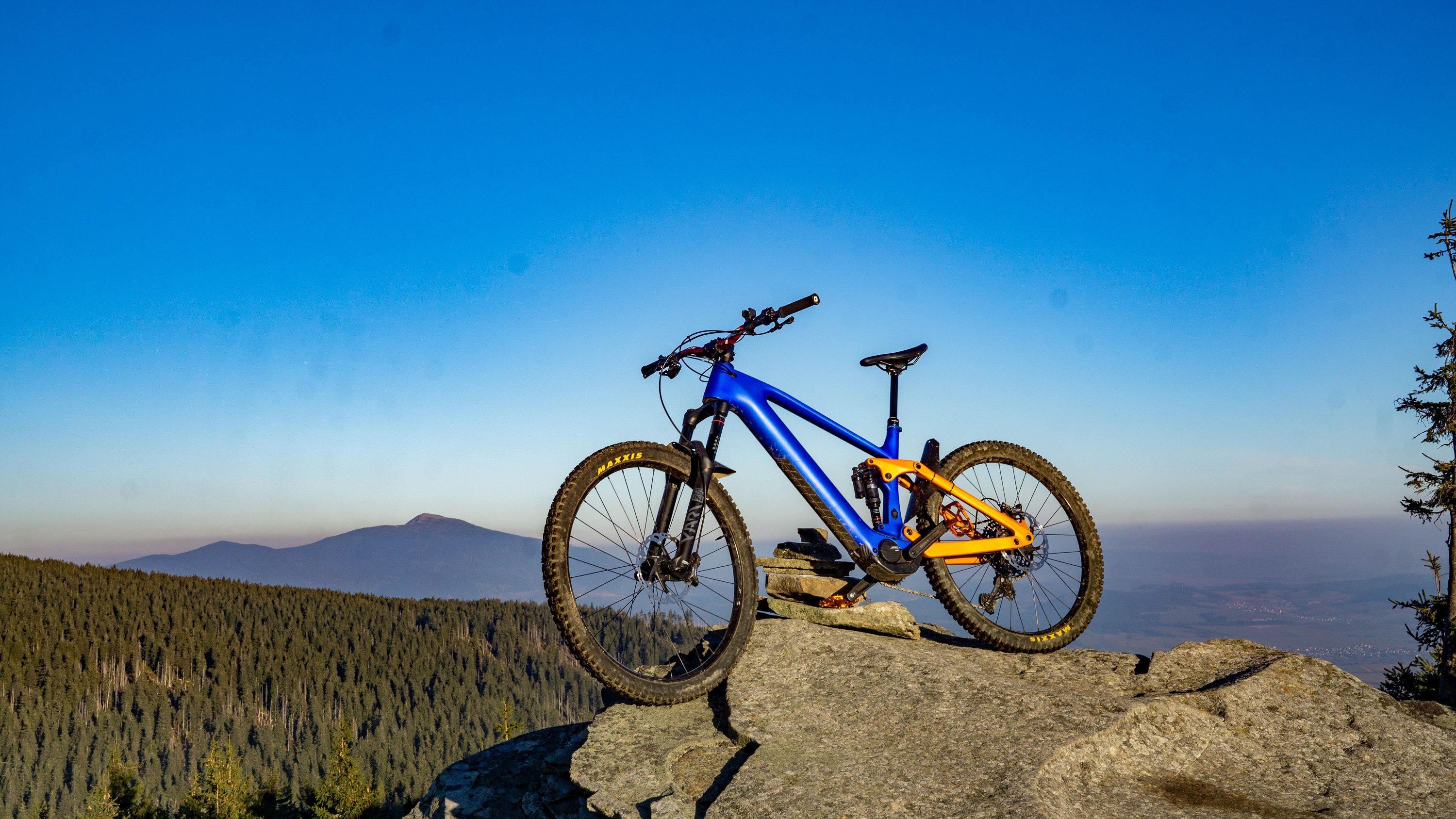

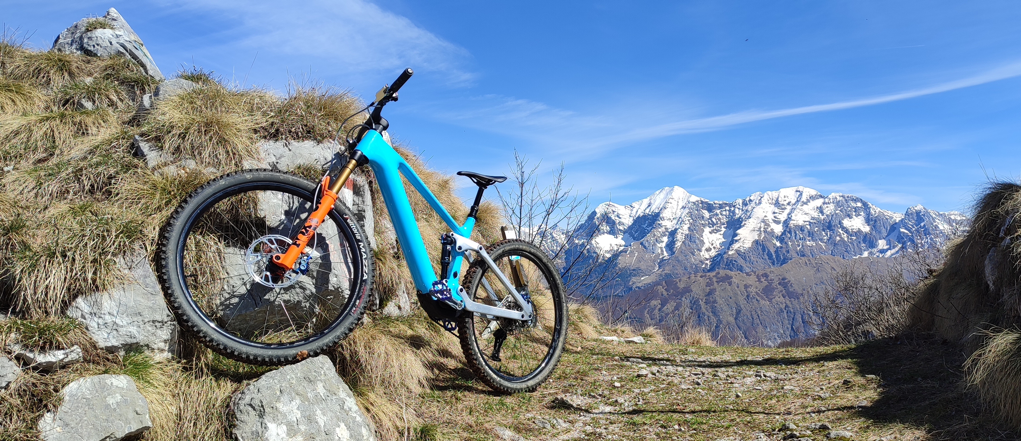

Hi my CEF50 @work in mountain @Beskidy Poland
Fork Yari 160 with charger 3.0
Damper Super Deluxe Ultimate 210x55
Brake Deore XT with Rt86 203mm
Battery 720wh@36V
Dropper Flayer 150mm
Saddle Fizik Aidon
Rim Blackjack
Derailleur shimano xt 11S
Maxxis tires front Assegai 2,5x29 maxxgrip, rear DHR II 2,4x27,5 maxxterra with tire inserts cushcore
Grip ODi
M820 firmware CRX30PC3615E102003.2-CR X30P.250.FC 2.1.bin
